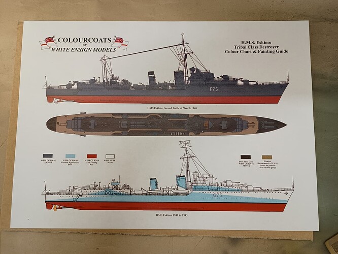

The colour callouts by White Ensign Models. By now, we all are familiar with the fact that the anti fouling paint is not red, but grey. I’m sure @Jamie can confirm that…

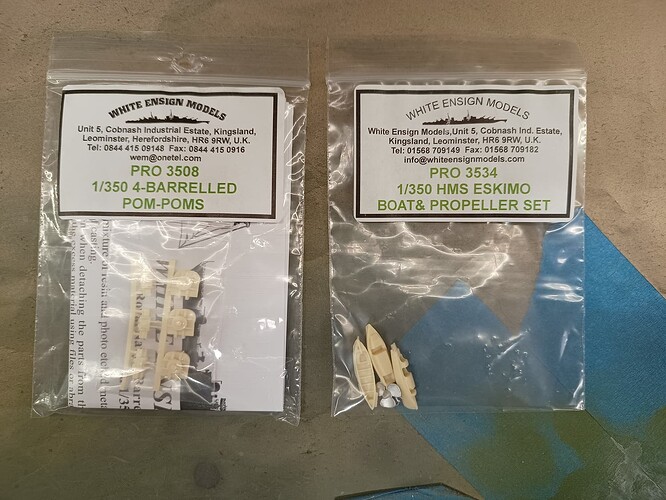

White Ensign photo etch
and 4 barrelled pom poms and boats and props to correct the obvious errors in the kit
Now, of course since 2013 there’s Micro Master offering newer 3d printed options, but I’ve bought these and my wallet says I must use them…
