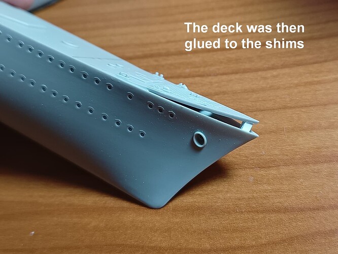

The final stages to leveling up the deck to be flush…
Next step is to move onto the bow and stern to correct the hull shapes there… :person_facepalming:

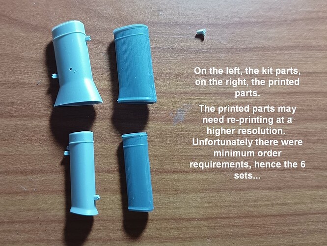

Ok, who else would like a set? :hugs:
I’m thinking I’ll get a test print run off to check the fit etc first, give you all a look at them, then work out if any changes are required, then put in a bulk order…
Let me know if you’re ok with that plan…
I’m interested in a set
I can’t help thinking, wouldn’t it have been easier to make a copy of that deck using plasticard?

Yes, that would have been my preferred option, but since it was already glued in I had to find a way to work with it that didn’t involve tearing the model apart :cowboy_hat_face:

Nice job correcting the deck, hope the funnels come out well.
Cheers, Si
Nice precise work sorting the deck out. Looks good.
Wow, Russell.
With your meticulous and precise work you will conjure up an excellent model from this inadequate kit.

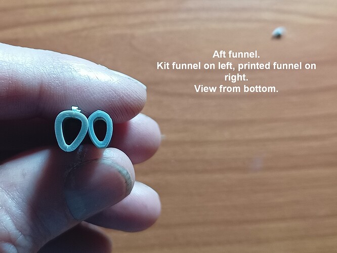

Hey gang… time for some more updates… Words in pics…
and now, the moment some of you have been waiting for… :wink:
So what do we think gang? Are the 3d printed parts worth the cost/effort? :thinking:
