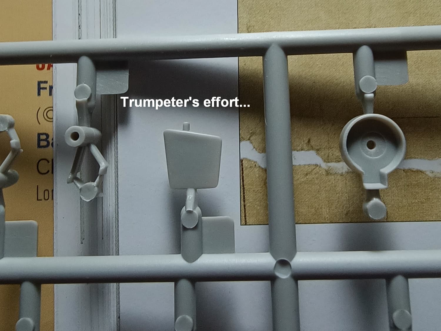

From what I can see comparing the pictures of the3d printed funnels with the kit and the Atlantic models parts, the 3d printed parts look to me to be a very noticable improvement on the kit parts. certainly worth the effort considering all the effort you are putting into the rest of the build.
Cheers, :+1: :beer: Si
Yes.
Not my scale so I have no personal interest in this,
BUT,
the kit funnels just look very wrong with the almost flat front,
almost as if they are triangles with rounded corners.
Misshapen to put it politely …
The base is only wrong if one knows what the real Tribals looked like,
for those who do know it would be an eyesore.

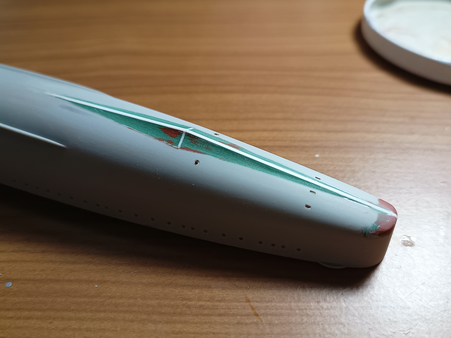

Beautiful work on the hull, and the funnels look great. PM sent to you.
Chris

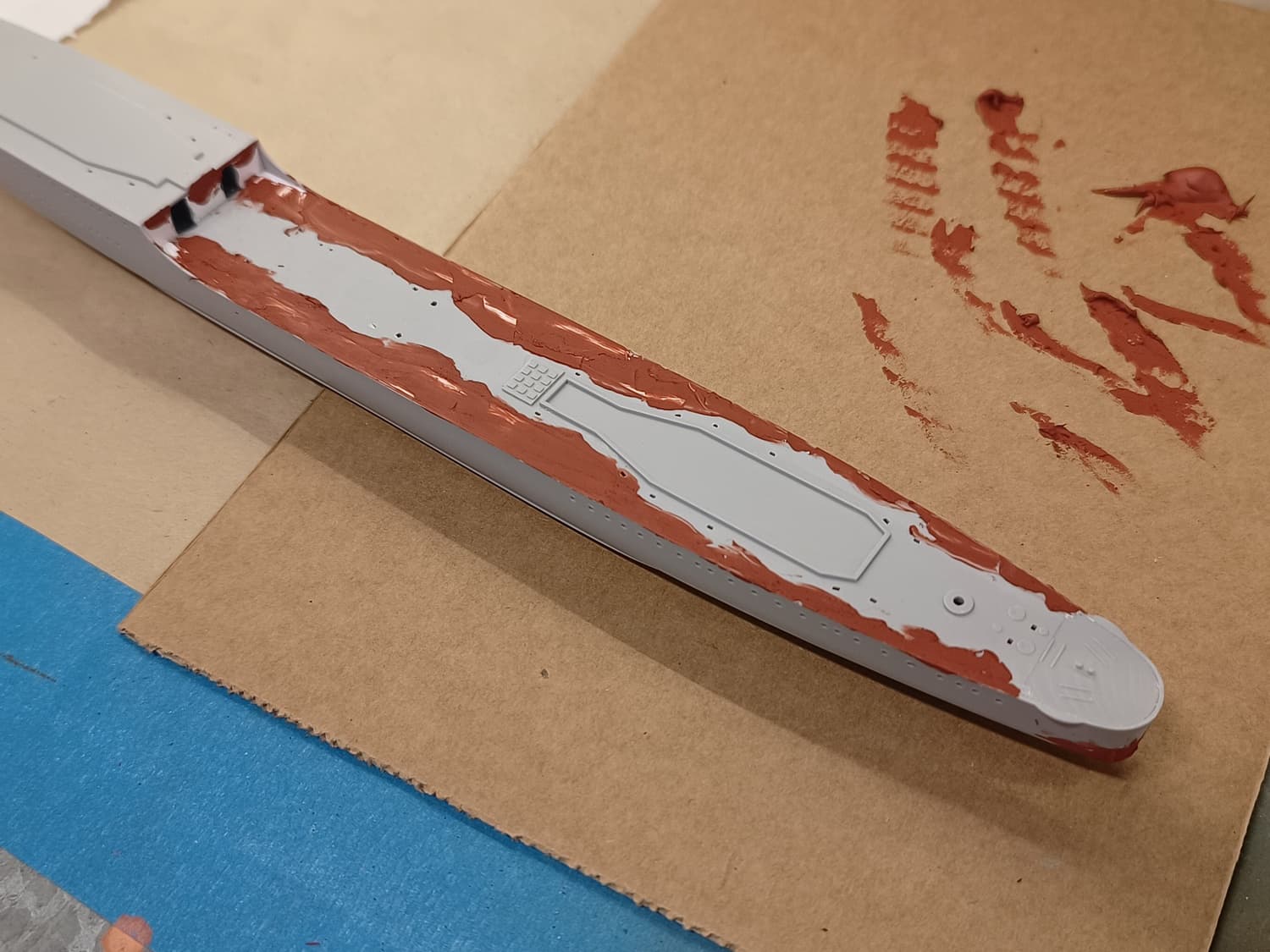

Nice work on that bow, Russ, the original flat kit rendition would have been ugly indeed. As for the funnels, I agree with the others - hell yes it is worth the trouble! The improvement is subtle and will only be noticeable to ship model geeks like us, but we’ll all appreciate the upgrade very much!

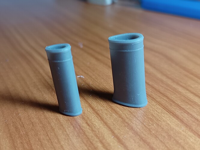

After having a good look at the printed parts, I think I am going to get them printed at a higher resolution. Additionally, I’ll tweak a few details give them a better definition once printed… Watch this space… :cowboy_hat_face:
Thanks for the update Russell - standing by.

Still waiting for the reprint at the higher resolution…

I think the newly printed funnels are much better at the higher print resolution…

Thanks Torsten… Just a bit of good old fashioned “model making” with some styrene sheet and some filing and filling…
The funnels are probably a bit extreme, but since I’m going to the trouble to correct the deck and hull I might as well correct the funnels as well :sunglasses:

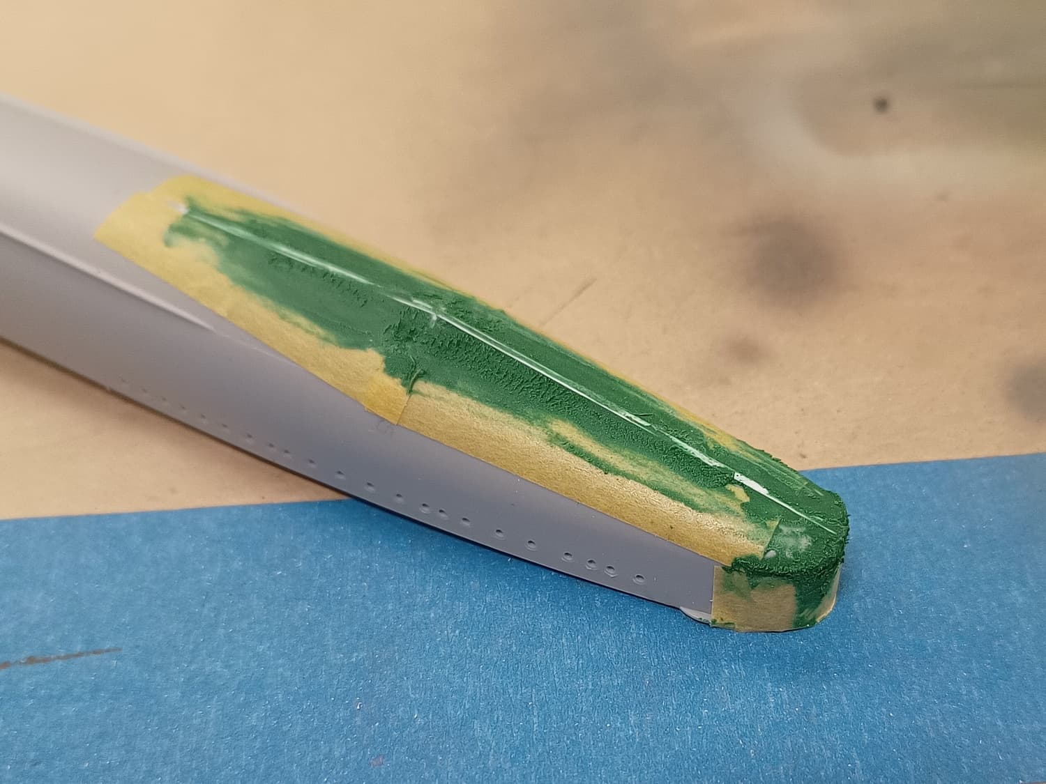

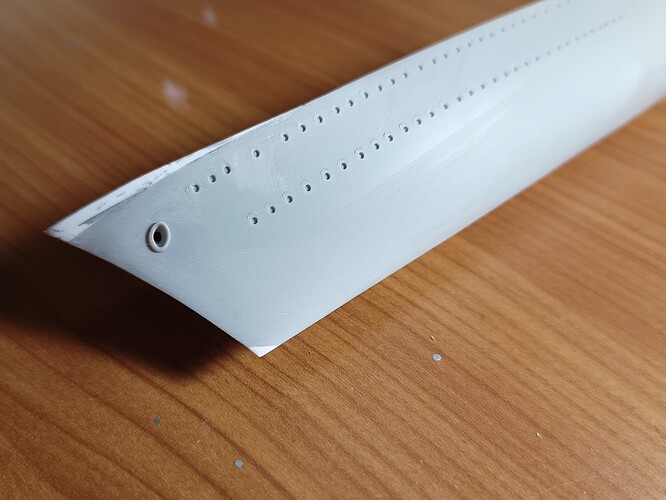

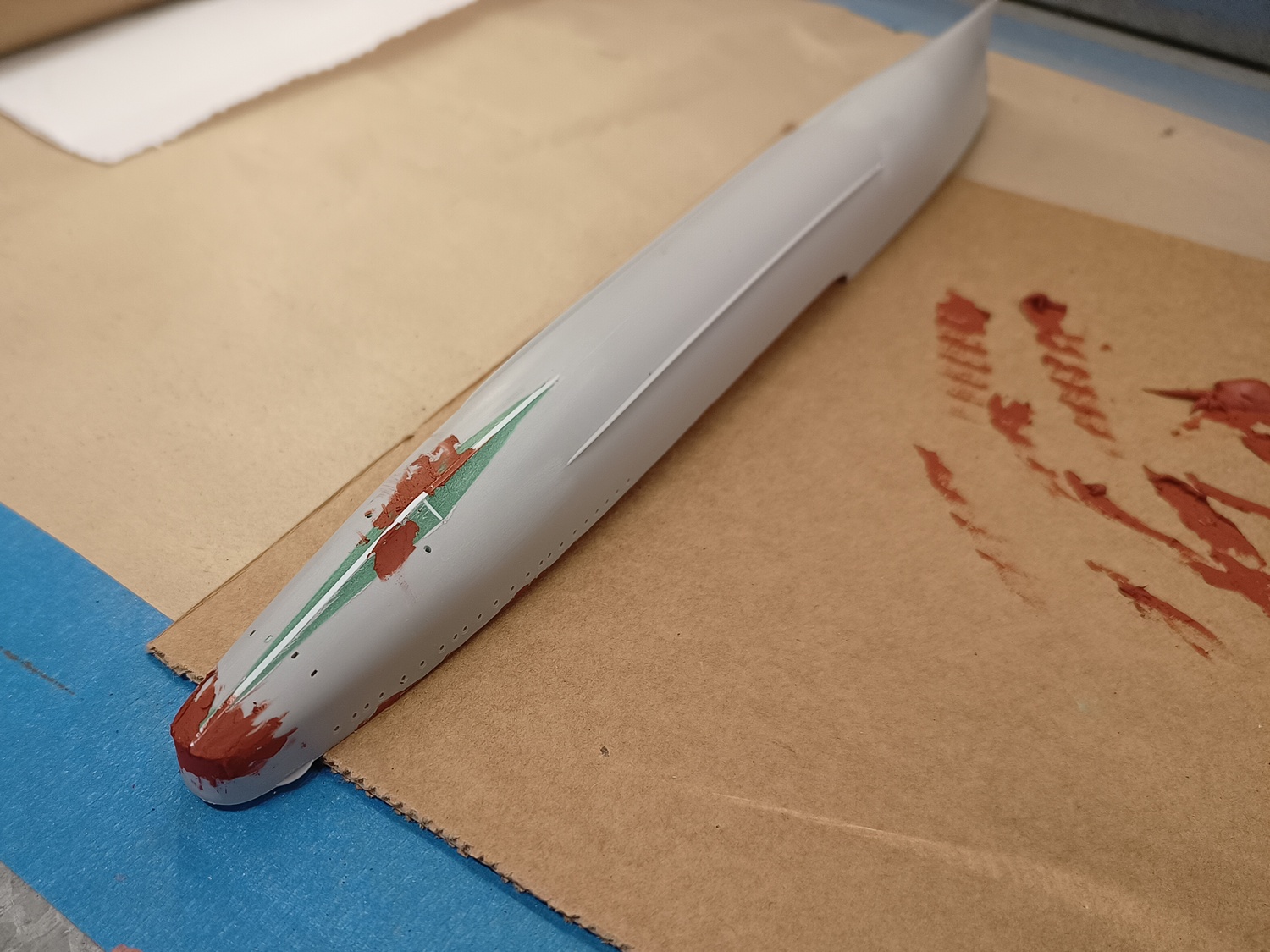

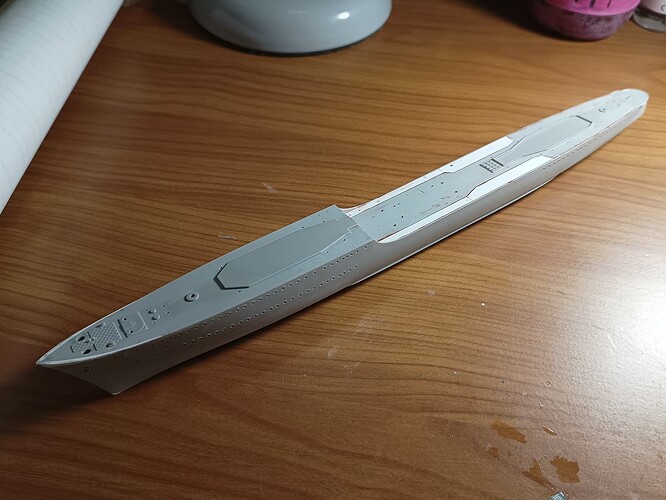

Excellent job on the bow, great start onthe work on the underside of the hull down aft looks a good start, great fan of the old masking tape to define the edge of the fix, saves a lot of cleaning up.
Loking forward to the next update.
Cheers, :beers: :smiley: :+1: Si

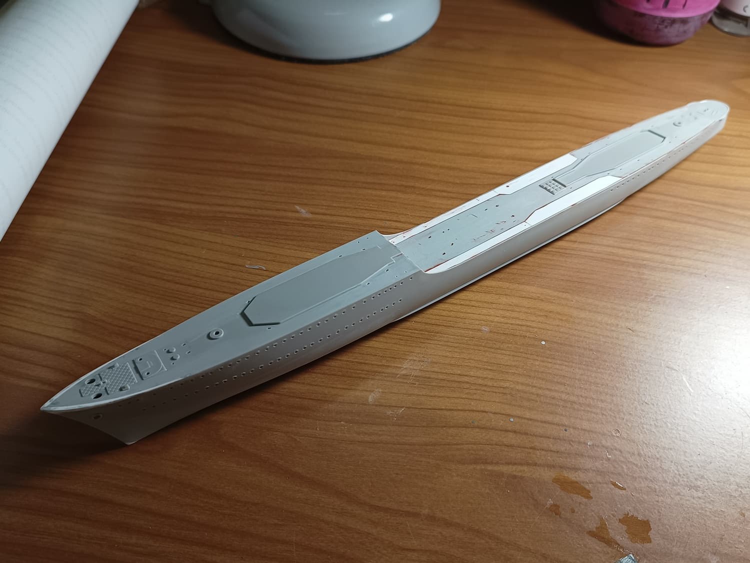

Some clean and neat work on the pointy end :grin:… it has been blended in very well. Good solid research on the blunt end :grin:, adds to the realism of it. And the new funnels do look better with the adjustments you’ve made, … Nice work as always.

Over the break I managed to get some time to fill the hull assembly and sand her back ready to fit the prop shafts and supports, and almost be ready to lay down some coloured stuff (paint)…
More soon… thanks for looking.
Very nice work Russ,
The reshaped lower hull and stern are a great improvement, comparing to My Eskimo sans bow, which I must get a base built for. Like the fixing of the deck walkways too.
Cheers, :beers: Si
Beautiful work Russell. :grin:

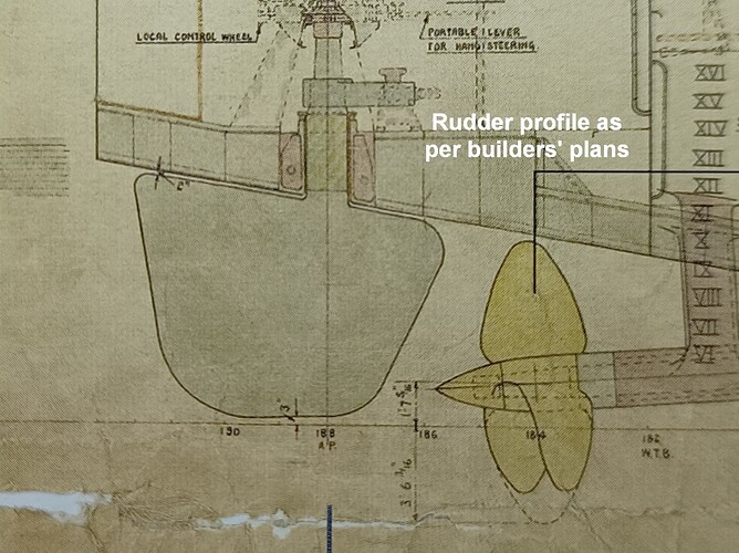

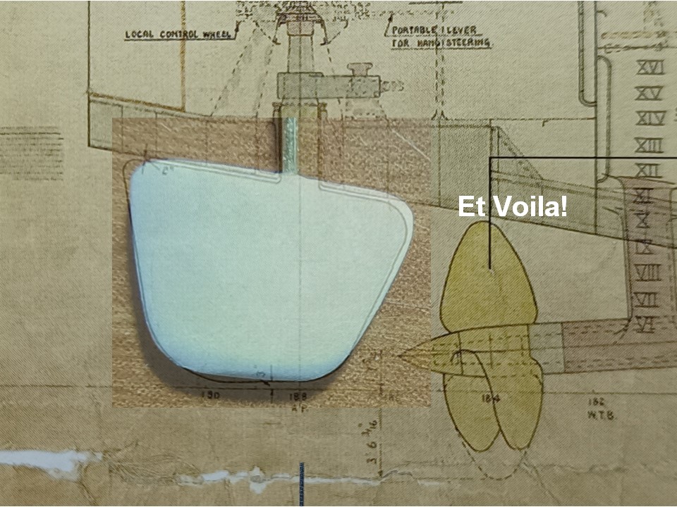

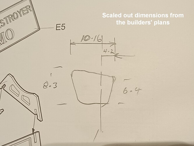

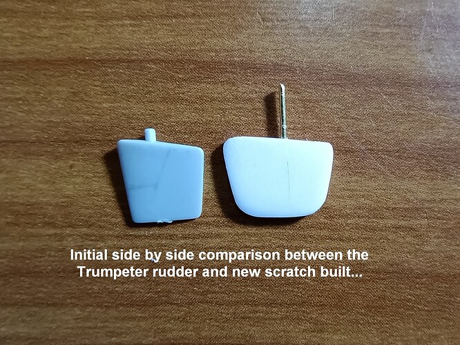

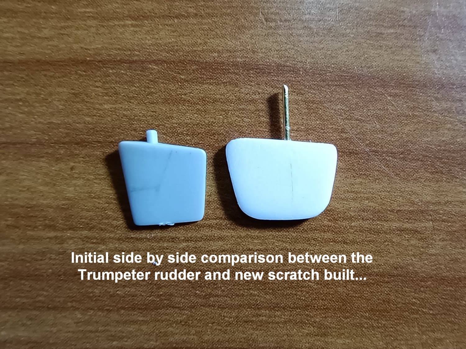

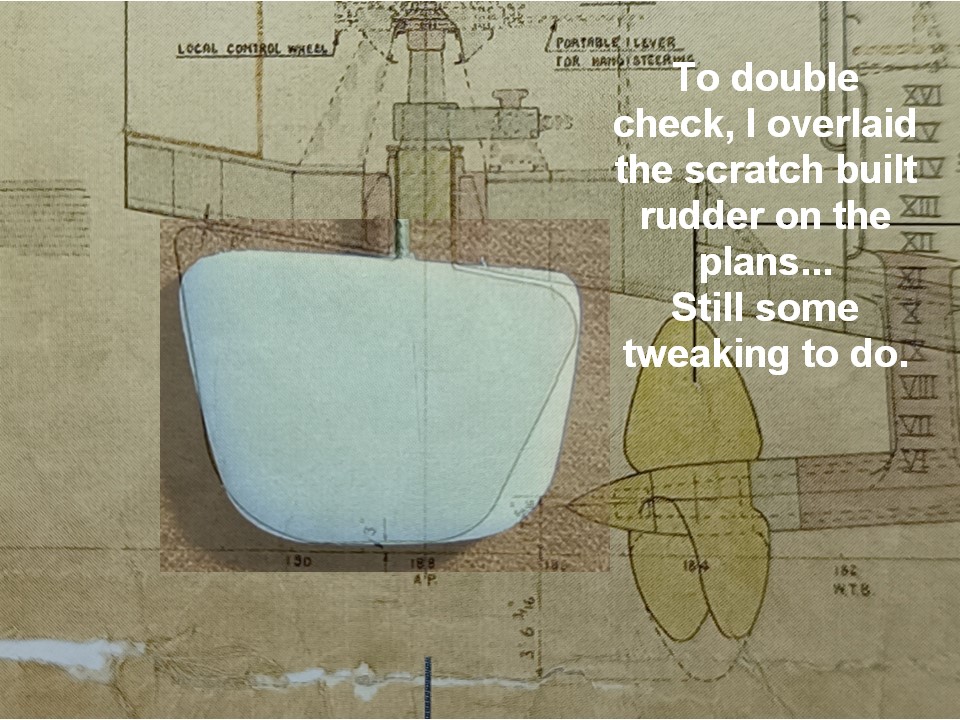

With the main part of the hull completed, I need to turn my attention towards the rudder and prop shafts.
First the rudder…
Now that’s been done, I can move onto the shafts…
Hi Russ,

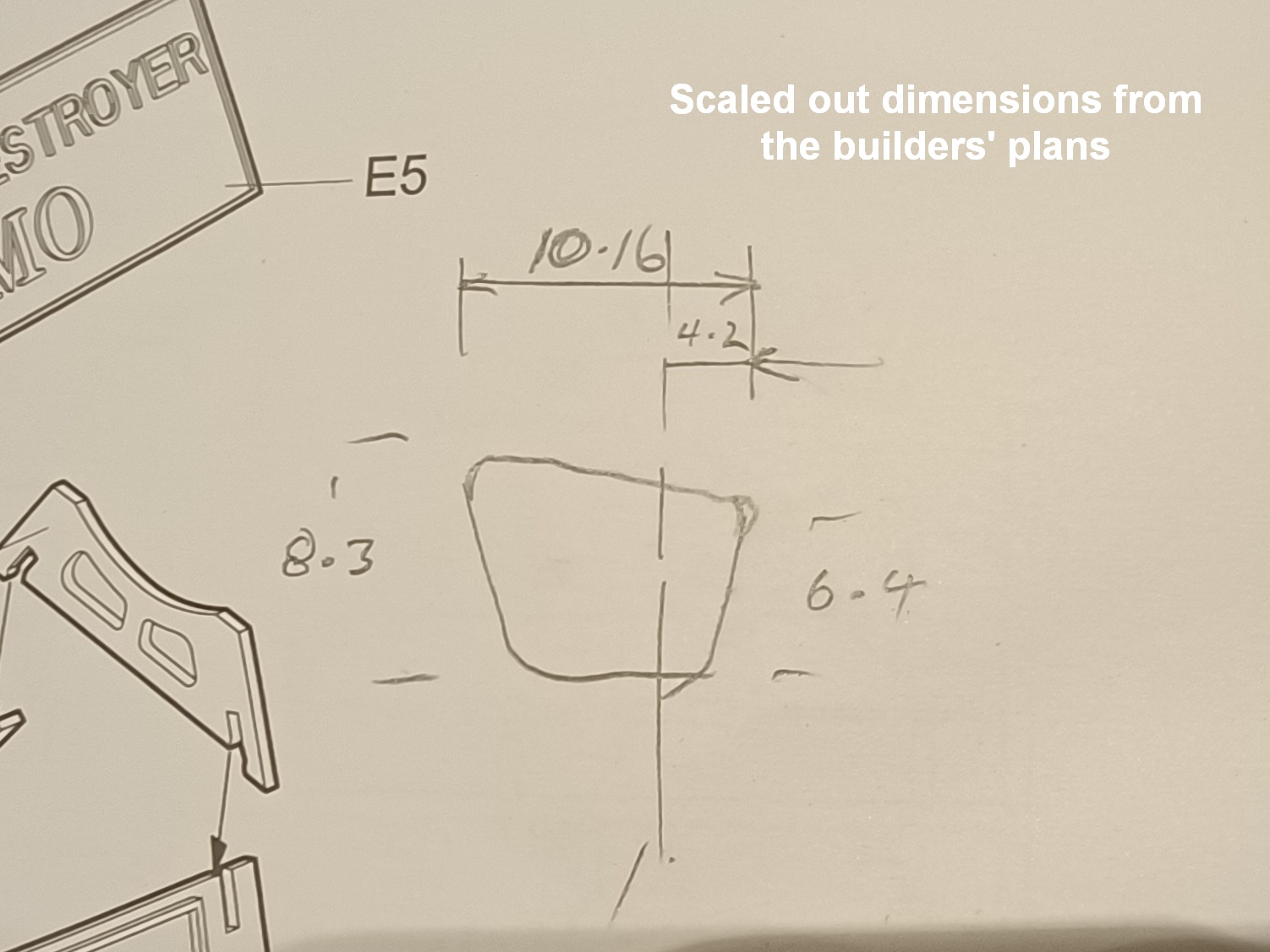

nice update! And really attention to detail - while I never expected Trumpi or whatever else company to put too much attention to rudder shape, I wasn’t really bothering… But once you’re on it, with builder’s plans, well, of course! Great fix!
