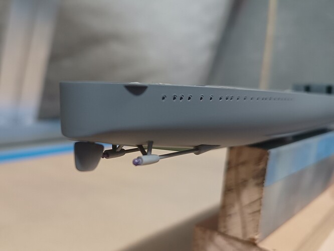

Thanks mate… Yeah, normally most details below the waterline can be a bit off but Trumpeter’s effort on the Tribals is way off and needs some fixing…
Not much to do on the shafts, but the props need changing from 4 blades to 3 blade units… :thinking:

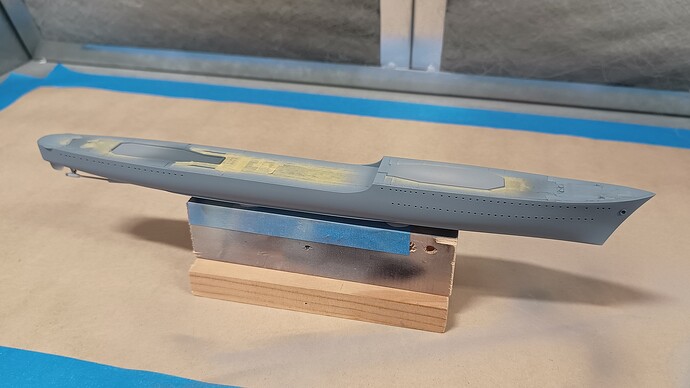

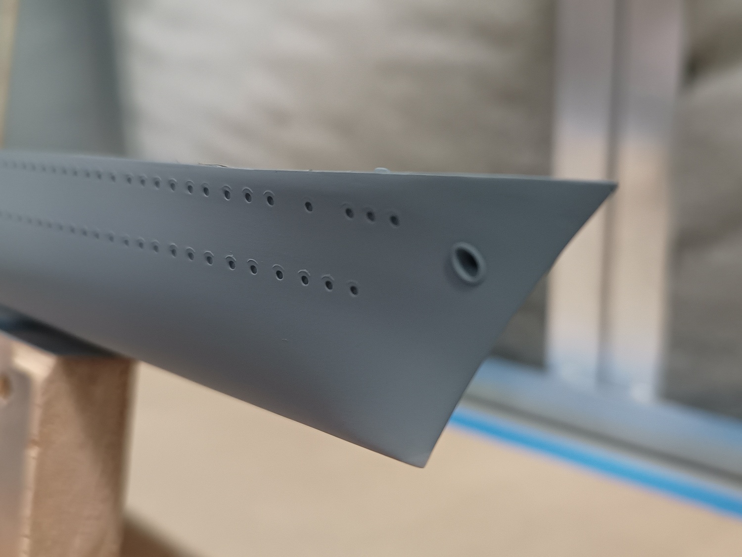

Just a small update today… adding more details to the hull…
I’ll add the rudder next and start the painting process…

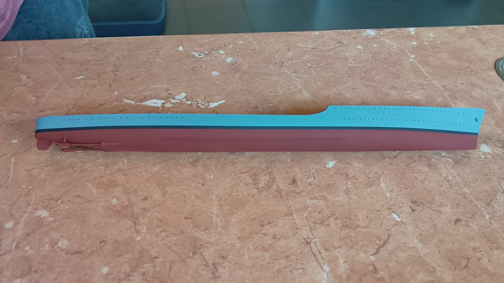

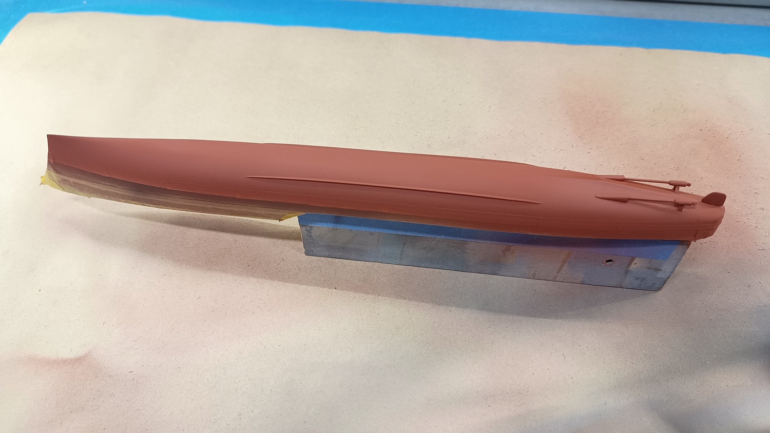

Well, the first colour is down. After a bit of scouring around, it seems there’s no definitive info on what colour the anti fouling should be. It seems it varied by ship yard and time period. There’s only 2 ships of the class that have evidence of colour choice and that is red. So red I will use for the anti fouling.

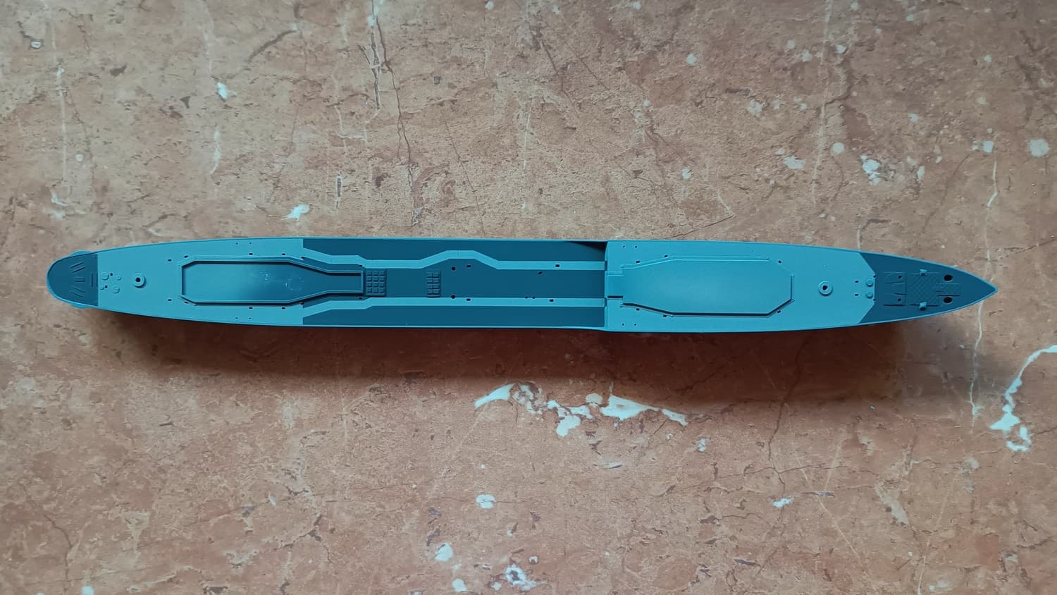

But first, I’m going to paint the decks and work my way down on this build. Punjabi like here sisters had a coating called Semtex (Cemtex) over the steel decks in certain areas.
Now according to John from WEM, Semtex/Cemtex right out of the can was grey.
According to White Ensign Models camouflage schemes HMS Eskimo, the Colourcoats paint to use is AC US 02 Dark Gull Gray.
Dark Gull Grey from Colourcoats isn’t currently available so I chose Humbrol Gull Grey which I think is pretty close… Of course I used the enamel… :grinning:
Next up will be masking off to apply the deck grey… :face_with_spiral_eyes:

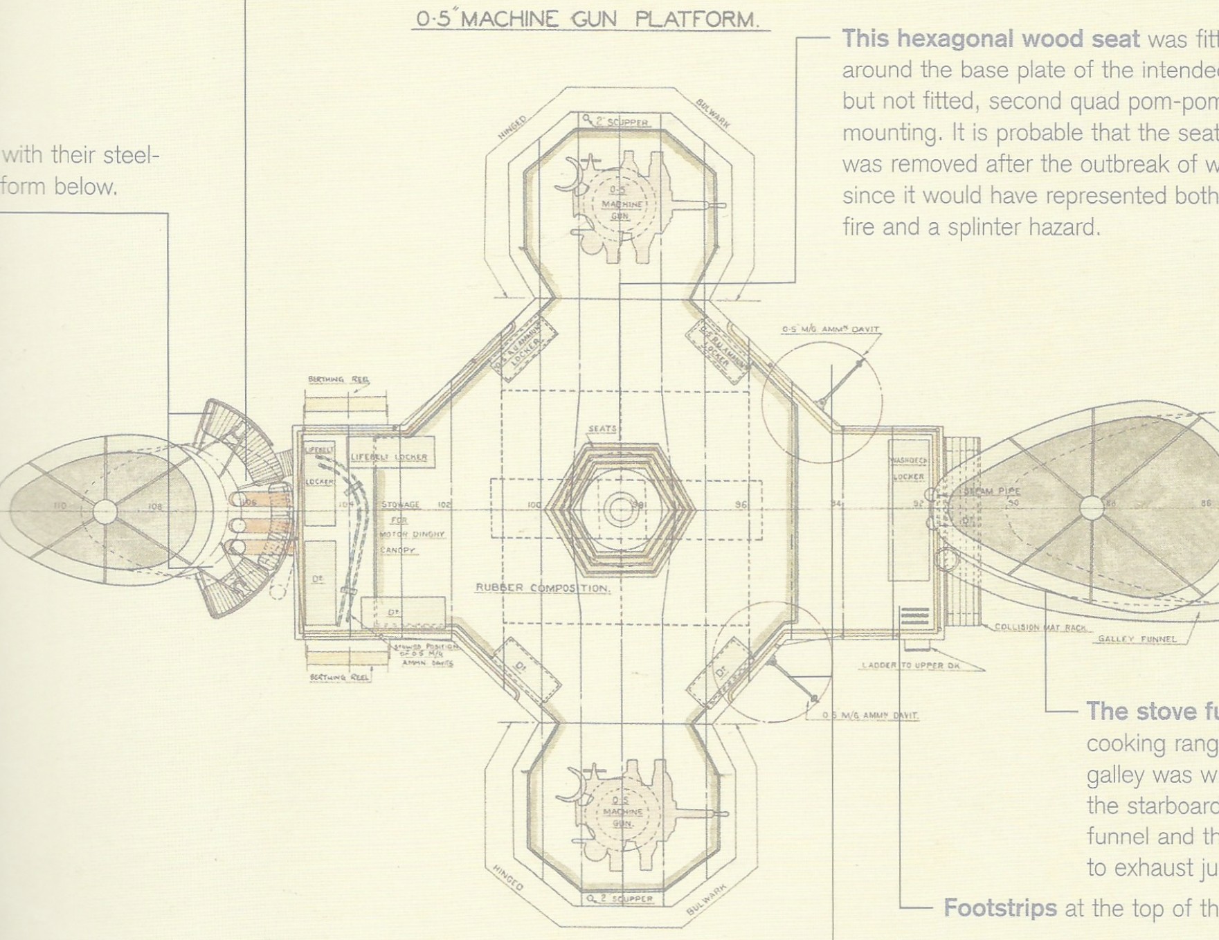

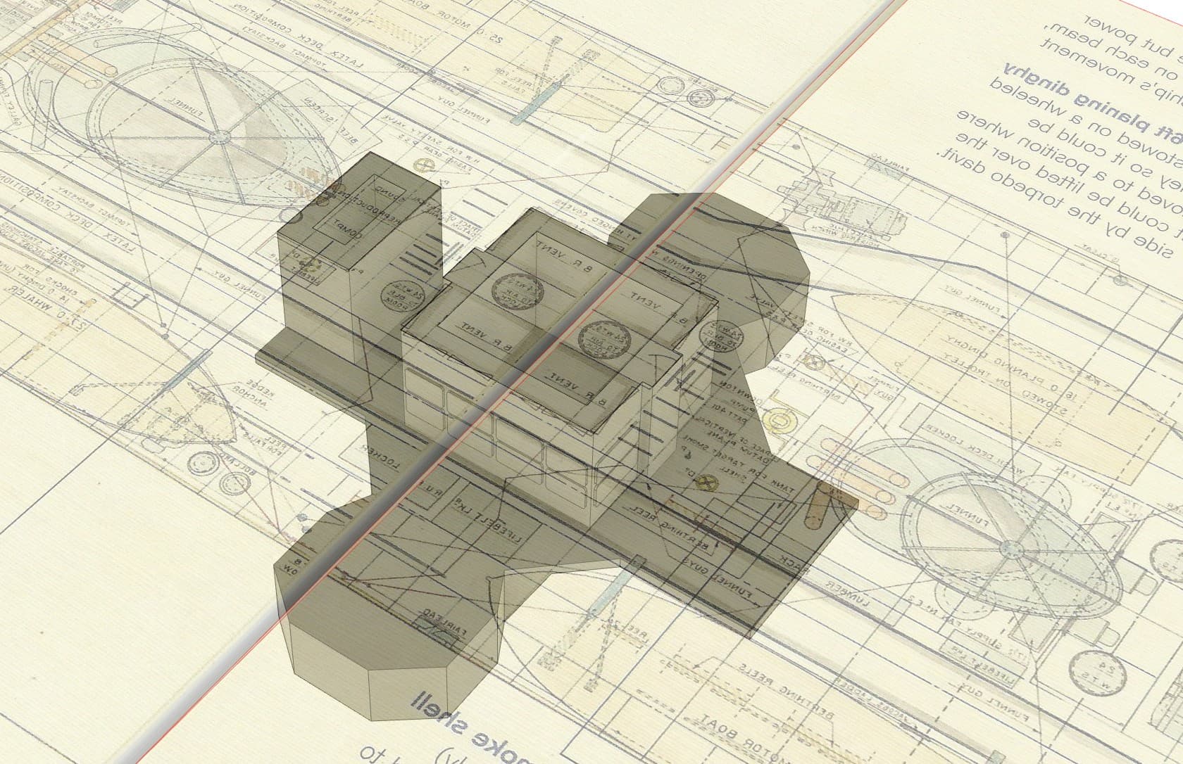

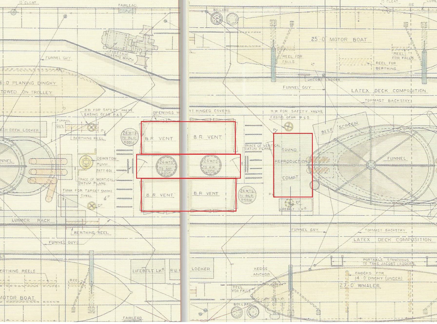

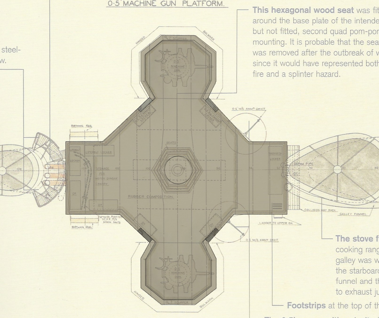

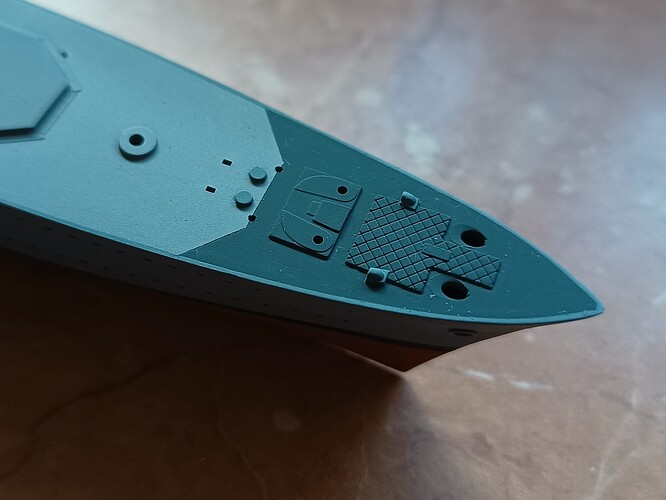

Ok, “Tribe” I need some help with the central anti aircraft platform: who else thinks that Trumpeter’s effort is way off the plans? :thinking:
Hi Russ,
Compared to the the drawings in "British Warships of the Second World War, by John Roberts, it is way off, below the drawing compared to the kit part on my HMS Eskimo sans bow, still waiting for me to build a base for it.
Sorry to rain on your parade even more, the pompom platform does not look too clever either.
Cheers, Si
I totally agree, Si: the structure below the AA platform is also way off.
Whilst I can probably turn a blind eye to the Pom Pom platform as it’s not too bad, that AA platform may be in need of some 3d CAD revision :muscle::blush:

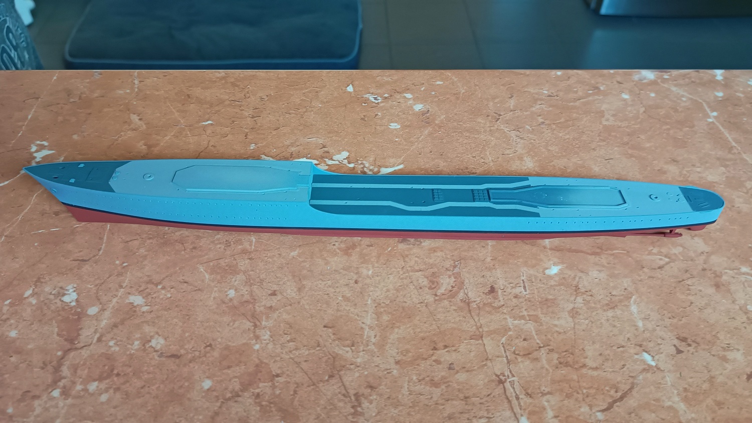

Well, it’s been a minute… :smile:

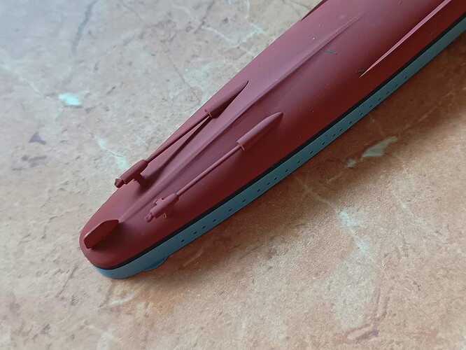

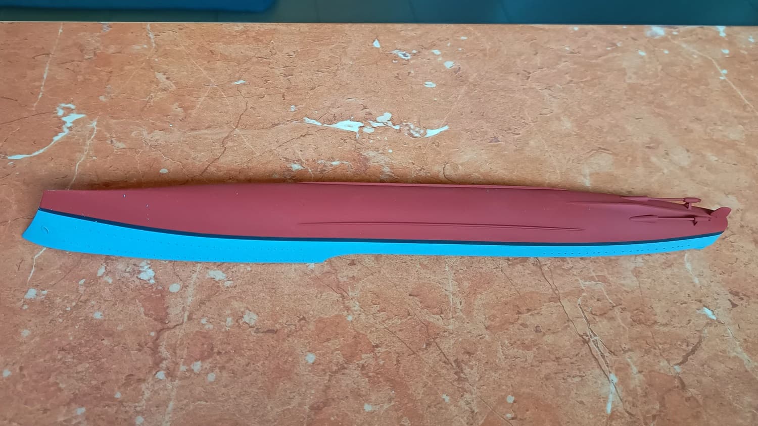

So, after painting the Semtex on the deck I masked off and laid down the dark admiralty deck grey

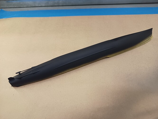

Then it was mask again and paint the wartime AP507 grey on the hull
I followed that up with the boot top
and then the red…
Perhaps the most rewarding part of any build for me is when I remove the masking tape to reveal the colours beneath
The carnage
After a bit of a rub with some P2000 to knock off the edges between the colours, the hull will be back off to the paint shop again for a clear gloss coat to seal it all in and provide a hard shell for protection during the build… If I can get some decals for the hull numbers and depth markers it will allow them to be added also

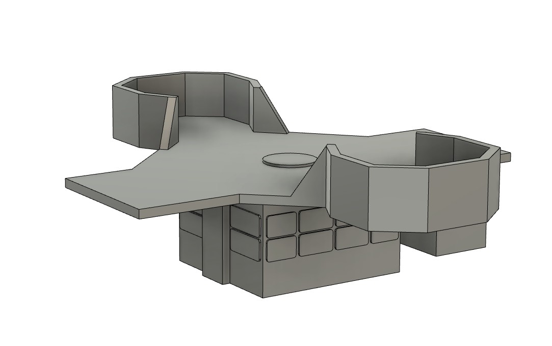

Over at the drawing office, I’ve been drawing up the 0.5" Machine gun platform for some 3d printing
The correct shape of the structure beneath the platform
The deck
and drawn up in 3d
There’s a bit of tweaking to do yet… but it’s getting closer…
