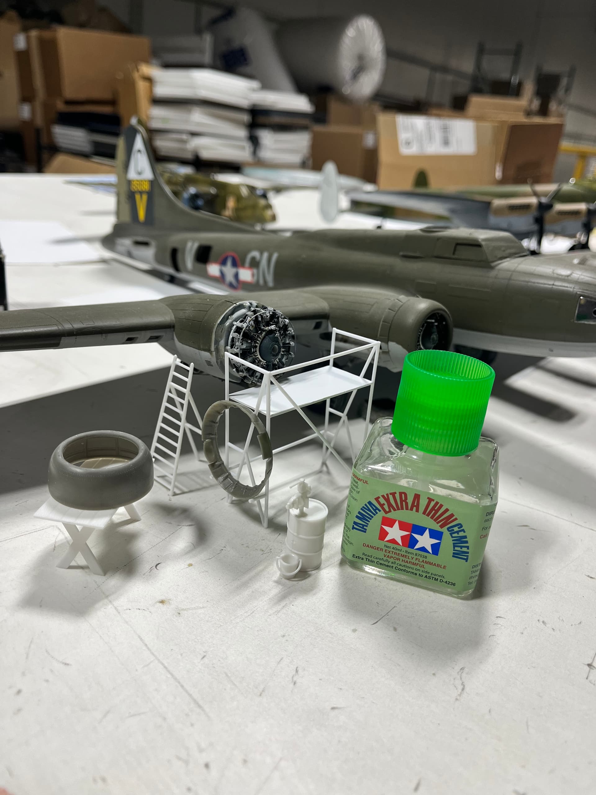

Already leaving his mark … (no punn intended) love the engine scaffolding — very precise and neat work.
Marks should be here to show his handywork!

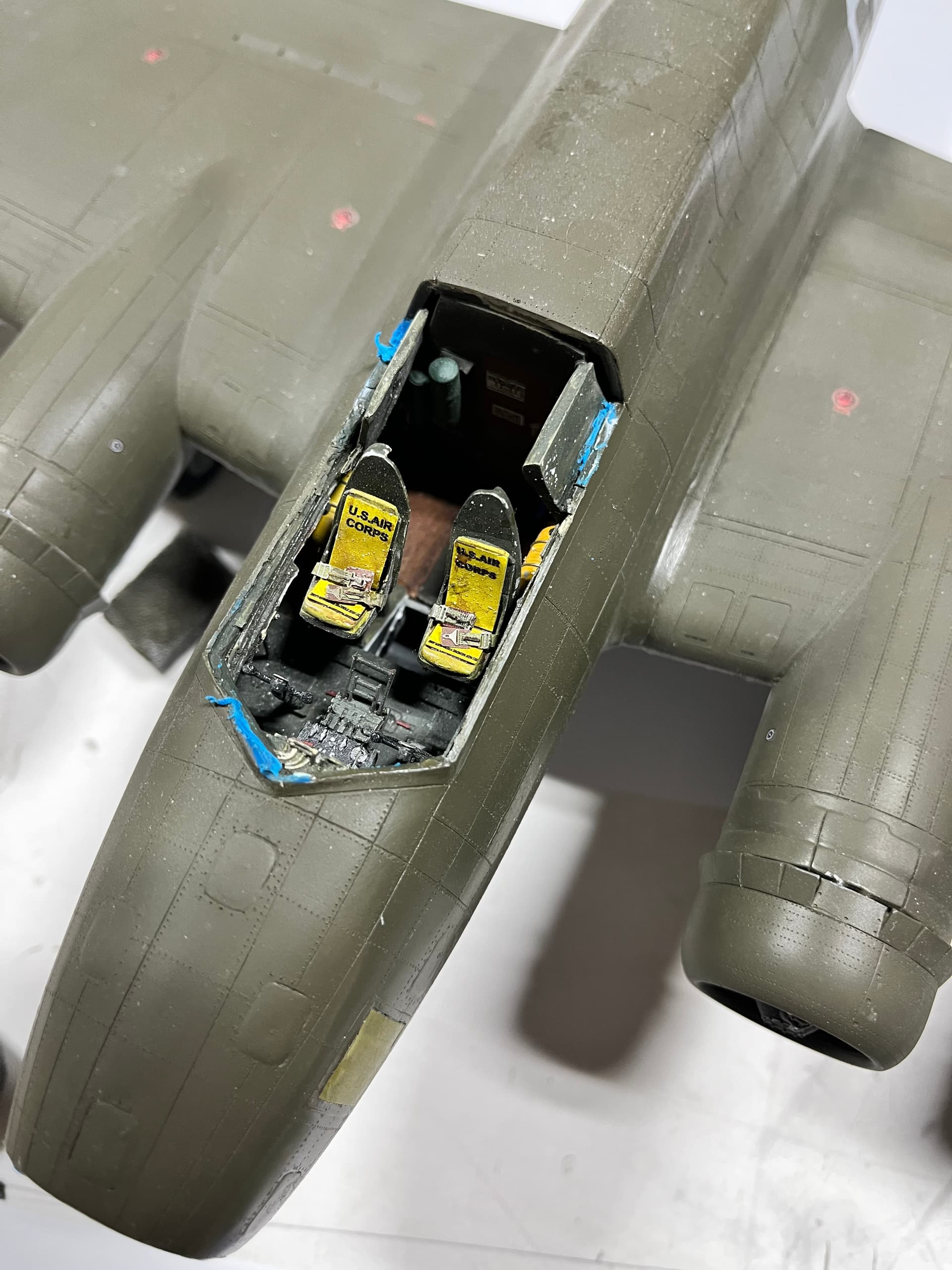

Marks is going to clean and touch up the obviously worn cockpit.
It’s had a lot of handling over the years!
Then the roof will FINALLY go on.
PERMANENTLY!!
He will position open windows on both sides, taking advantage of H.G.'s excellent work opening up the main windows. The rear of the cockpit will be visible because the top turret will be removable.

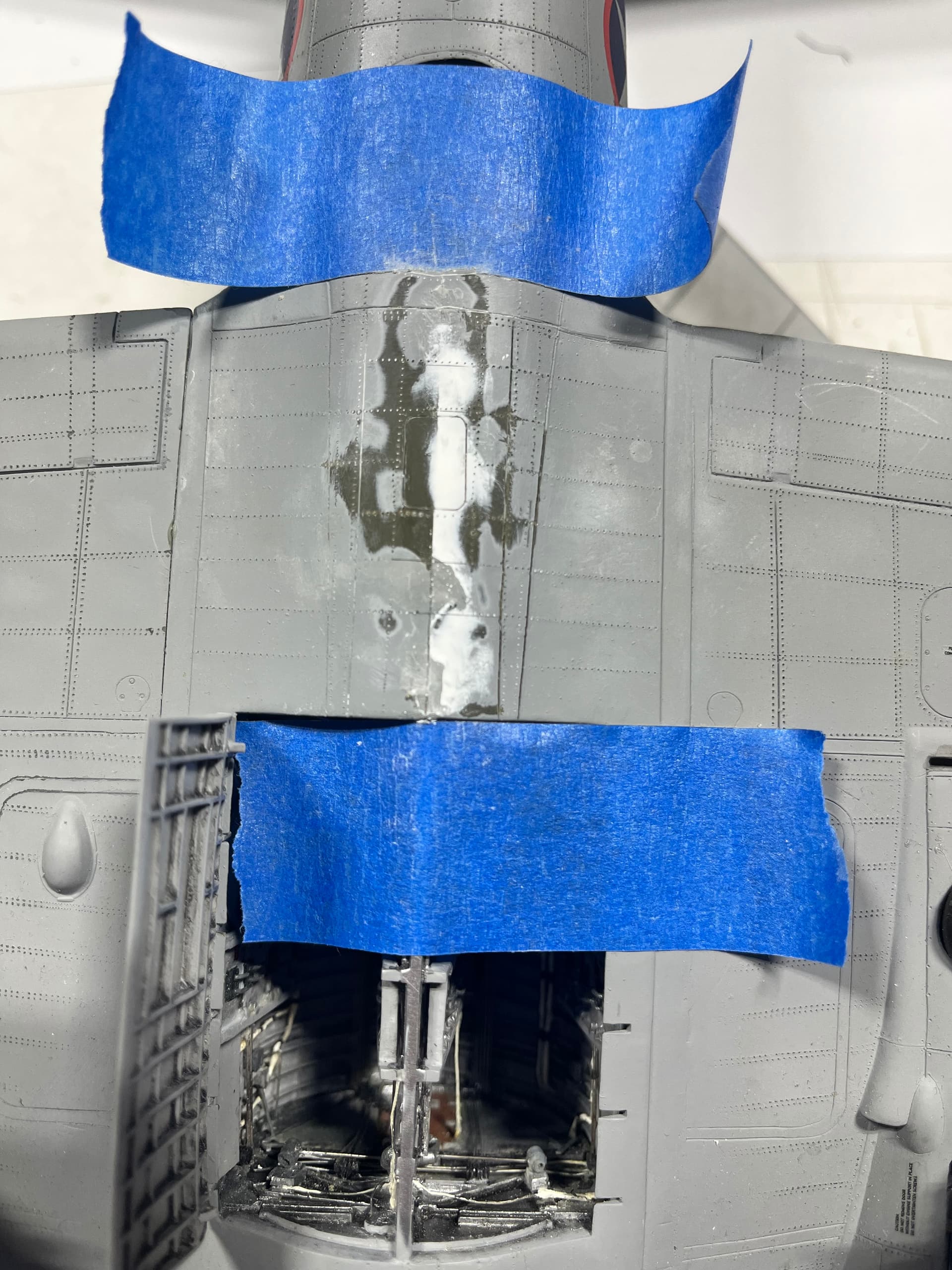

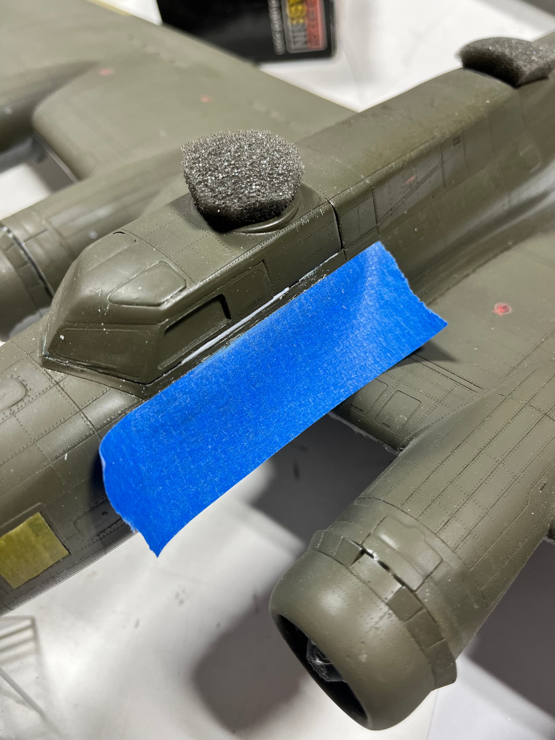

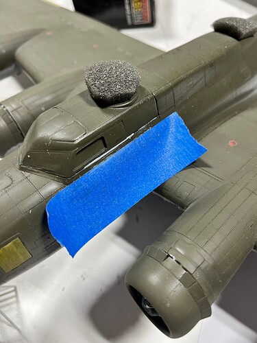

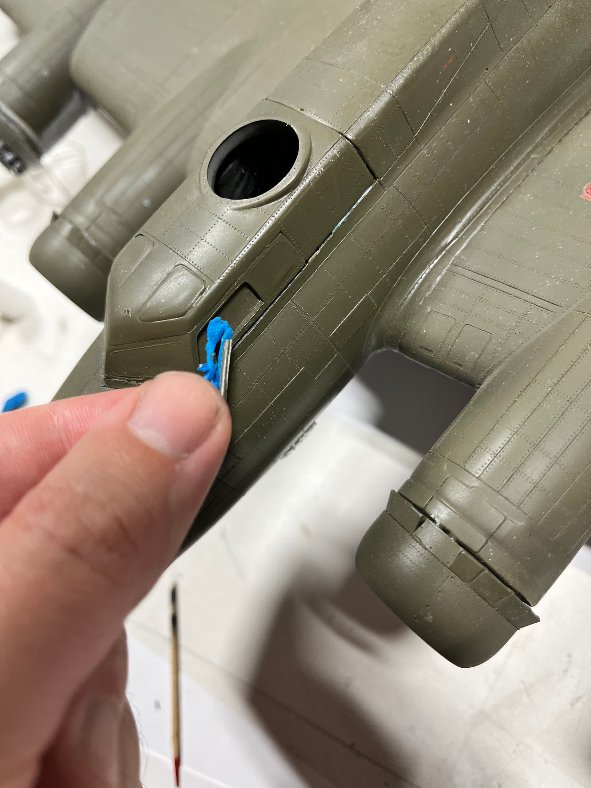

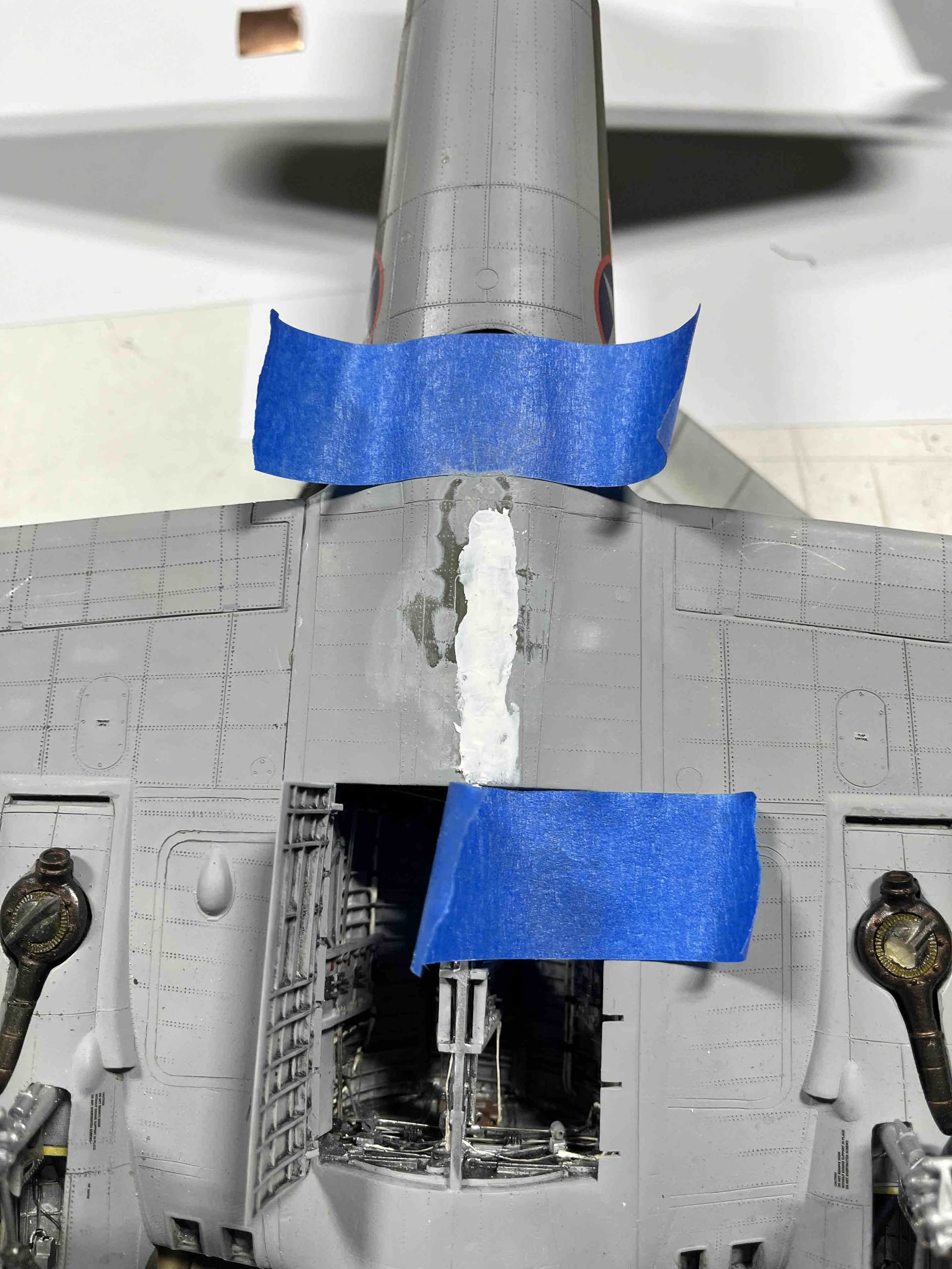

The area aft of the bomb bay split apart, and was covered with crazy glue by H.G. prior to repair.
Marks has put his own sealer on and is now rescribing the area.

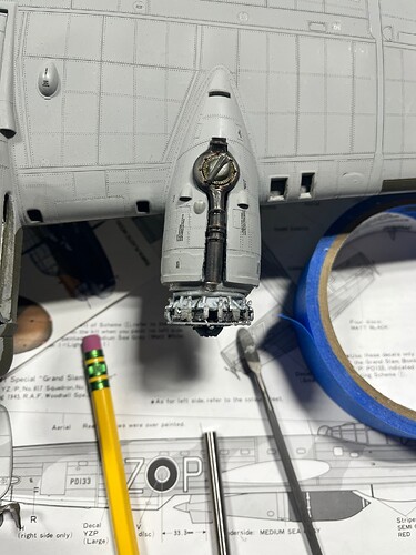

Go up to the first picture, and you will see the turbocharger turbine on the right is damaged.
As if by magic, it is corrected, “like it never even happened.”
Edit: Oops, my bad. That’s the outboard engine!

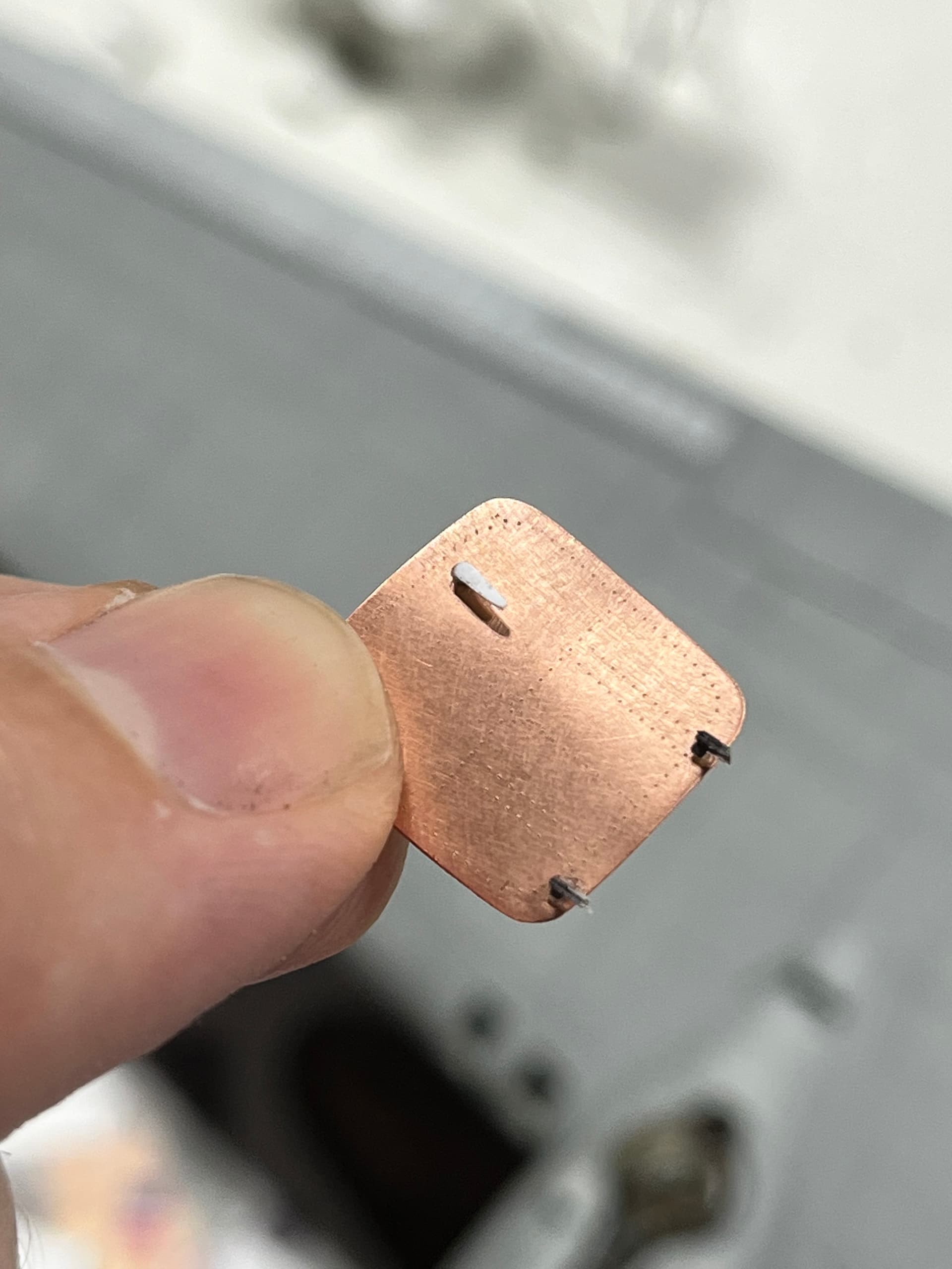

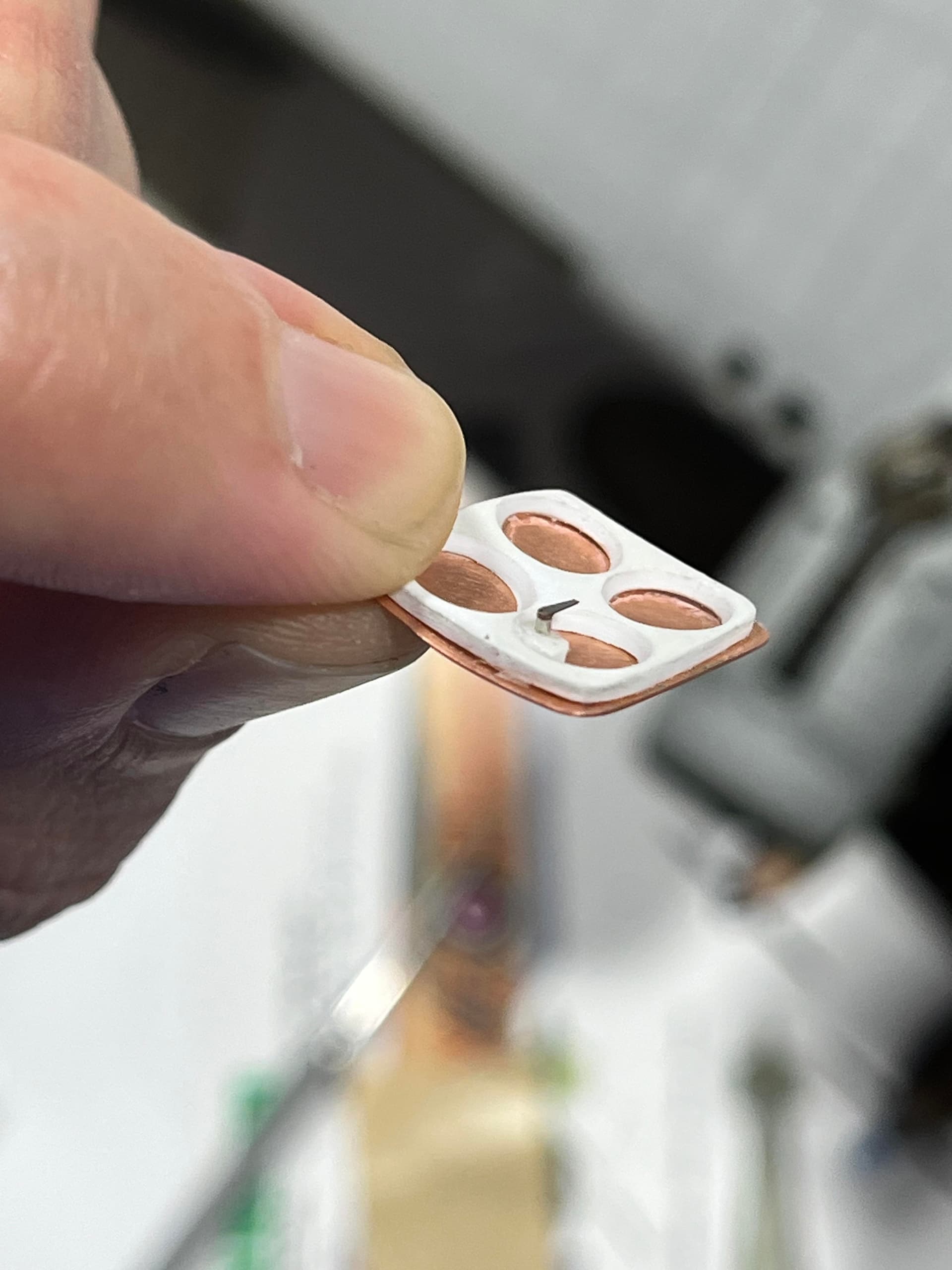

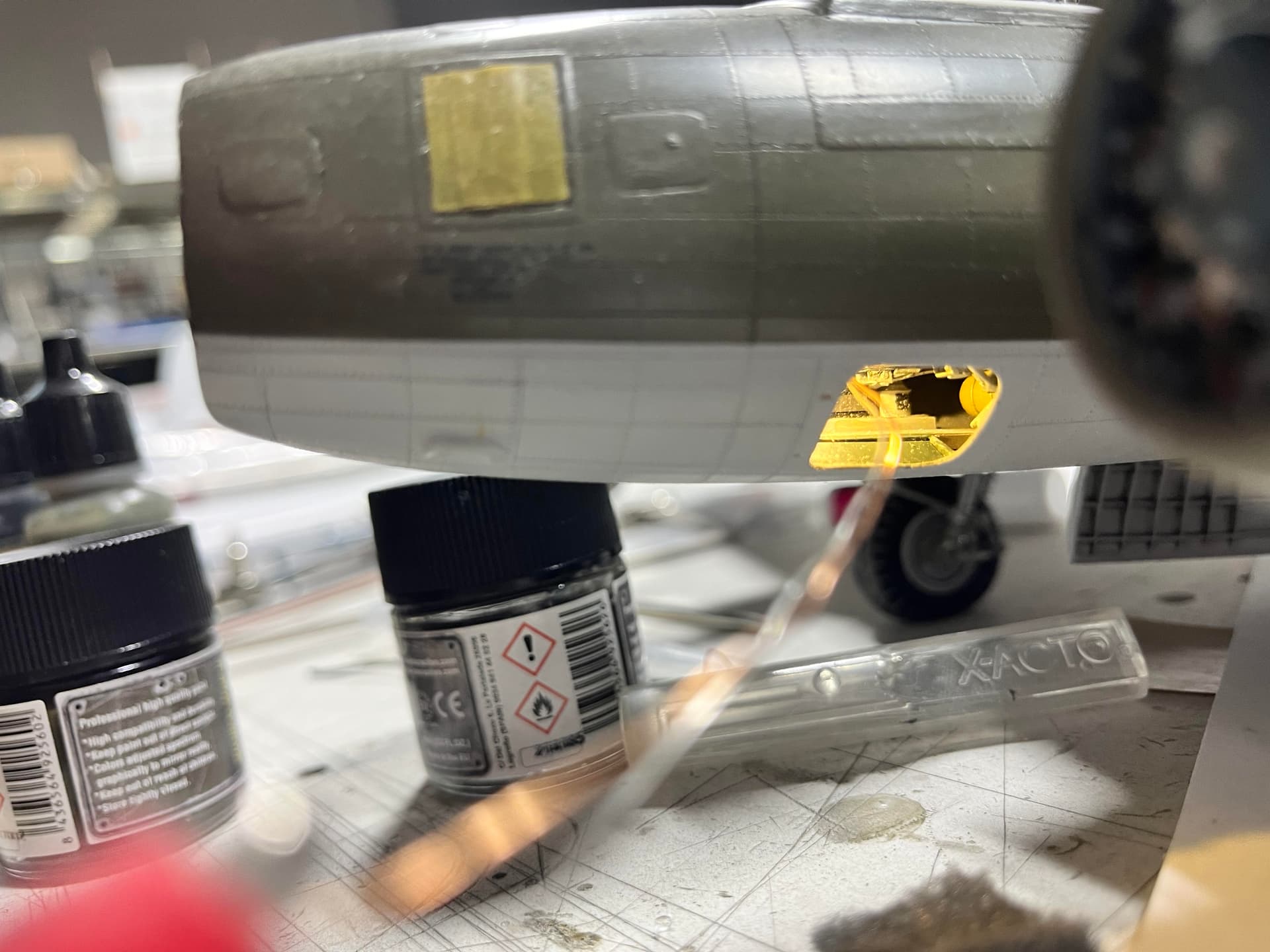

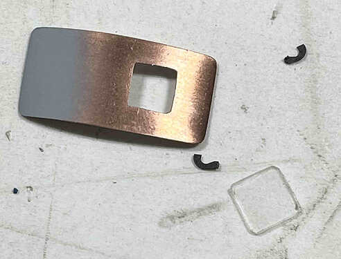

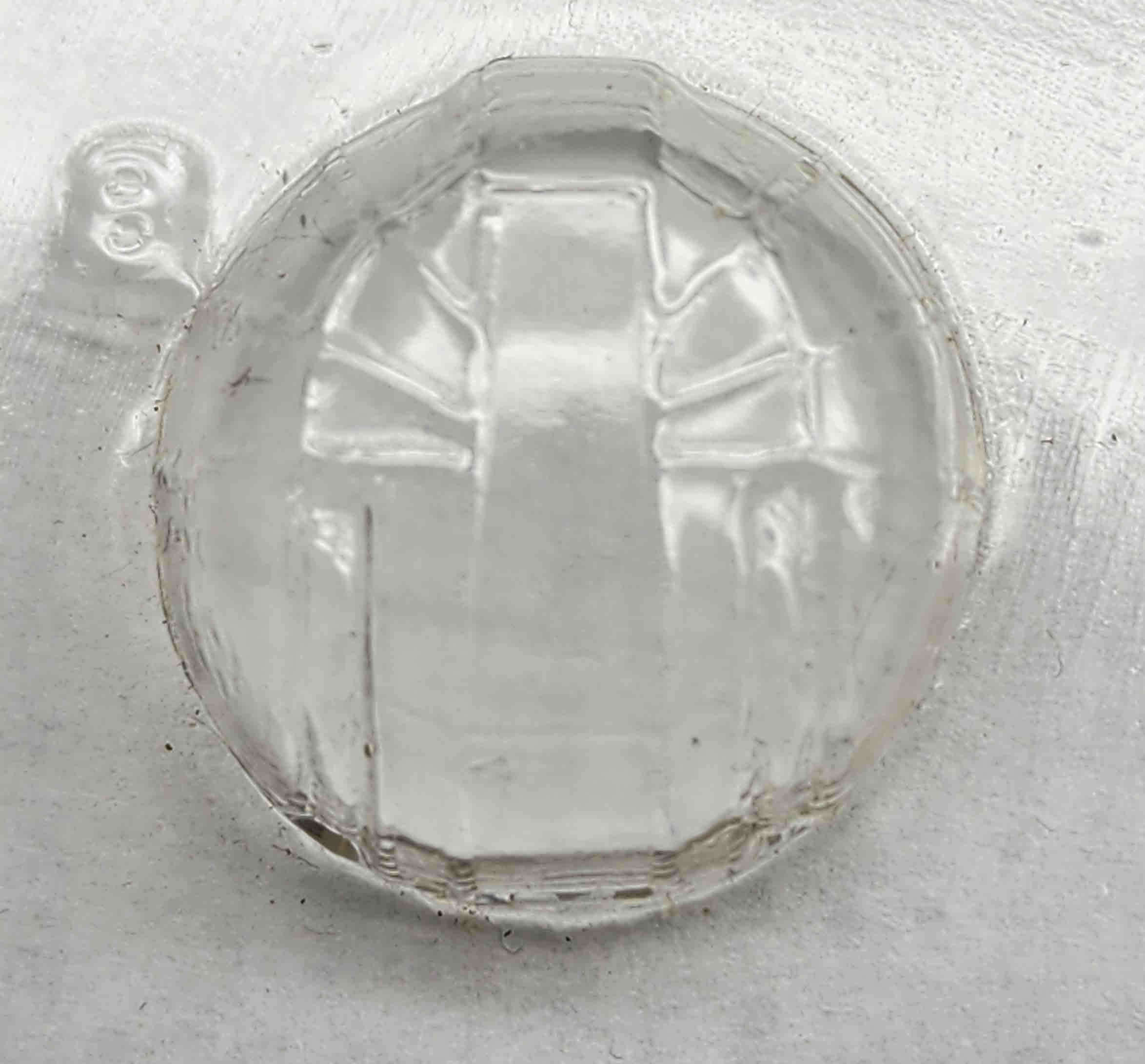

As you know, I lamented the loss of all three crew doors, and the fact that they were now OOP by Resin2Detail.

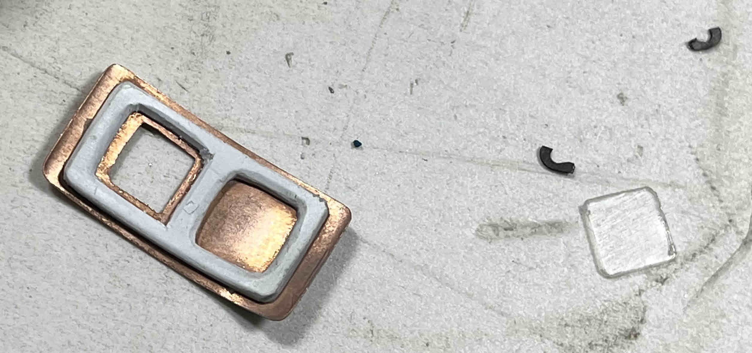

Well, guess what? It’s-a-no-problem. For real! Wudja-lookit-dis!
I was absolutely astonished. This is making a beautiful scale part out of pure, stock copper sheet and some form of paste or styrene. And look at the separate door latches inside and out and the door hinges.
I have never seen anything like it!
I can only hope my work on the interior, including the open hatch leading up to the cockpit, oxygen bottles and all the other stuff meets expectations.

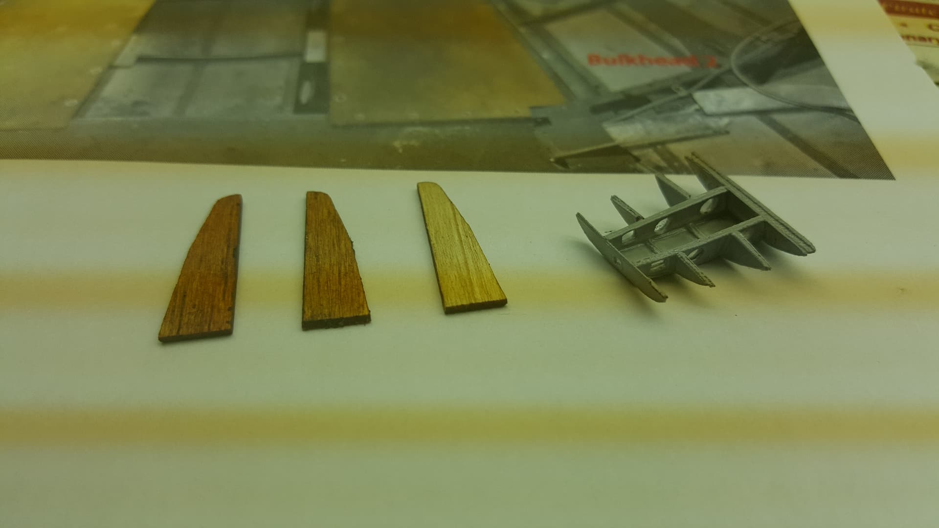

Lost details in the nose, including the wooden bombardier floor and the gun braces in the cheek windows.
I believe I gave Marks the floorboards for the bombadier station during the “unboxing,” and that the framework underneath remains in the model. See below.
For those not following from, ah, 2016, I got the blueprints from Karl Hauffe,
and if we need to fabricate everything from scratch, I’ve been in touch with him recently, and he’s offered to re-send anything we need.
Again, the long-term followers will recall that the blueprint components were scaled down and printed on wood by the late Art T. Babiarz, Jr., a modeling friend of mine from the 1980s who helped with many areas of the build.

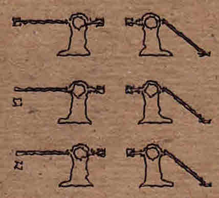

Art was very helpful in scaling down and reproducing on card stock the window brackets for the cheek guns in the nose.
2023-11-05 (1)
This is something else that has to be redone. At the time of his death, H.G. was working on custom-made brass substitutes.

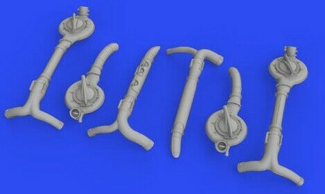

Also, we need replacements for exhaust piping on the inner engine nacelles, specifically the two in the middle, below.
s-l500
Those I have now as well.

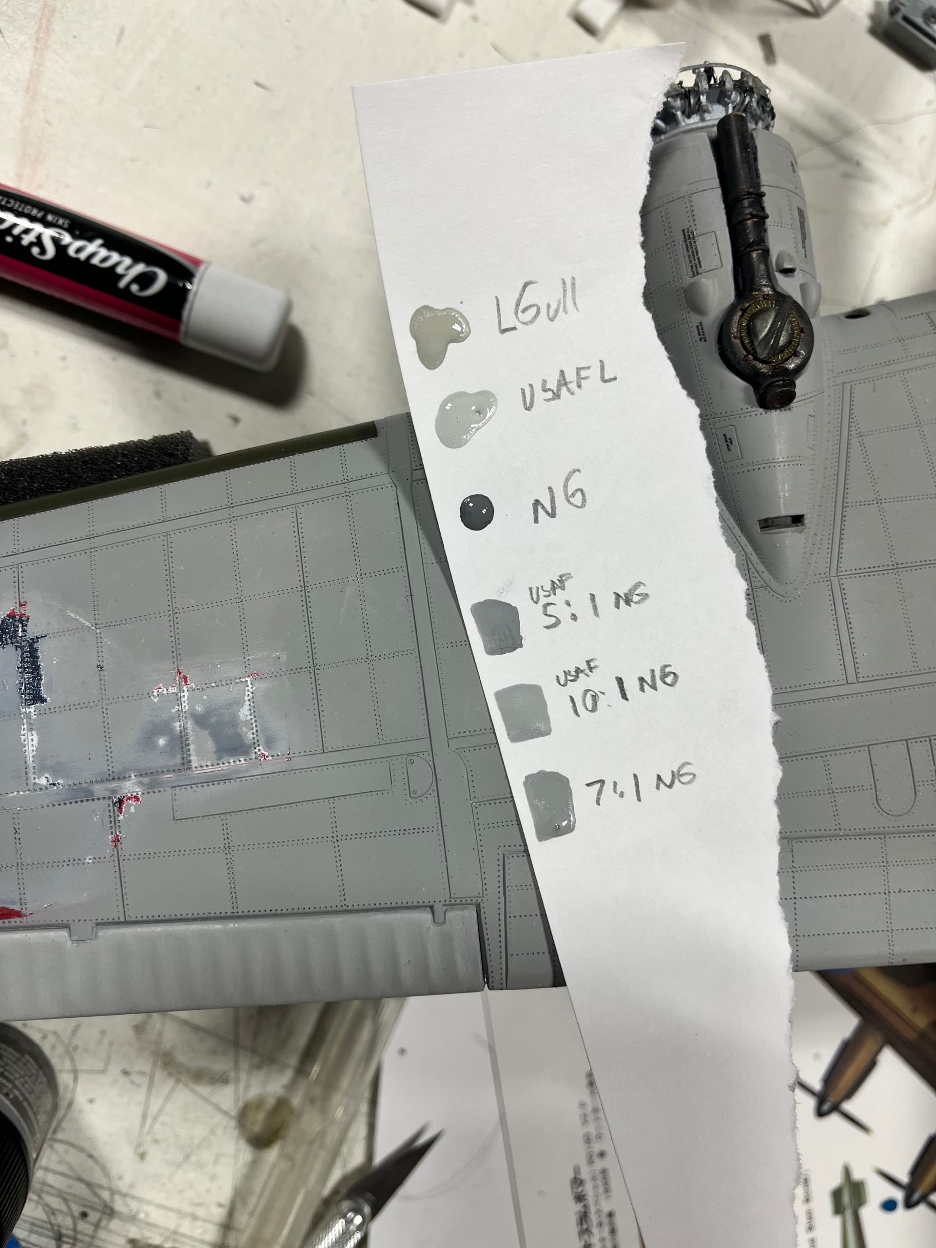

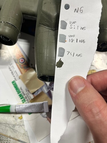

So, back at it! Marks began the touch-up work by trying to find matches for H.G.'s “neutral grey” on the undersurfaces. He emailed me that:
my ak color neutral grey was no good. Way dark. I custom mixed some Vallejo neutral grey with usaf light grey and found a close match at 5:1 (NG)
Attached is the method to madness plus results
I really like the prep work prior ro repainting the outer wing panel where the national insignia will be re-applied.
Next he tackled the area where the fuselage split aft of the bomb bay, and the sanding plus rescribing plus paint looks damn good!
I also have to say that my “vision” for the finished model is in sharper focus now that I see how the expert exterior work by H.G, and Marks compliments my work on the bomb bay.

but not everything! Here you can see that he’s scratch building the missing rear crew door, just as he did with the forward crew door under the nose.
Before we leave the subject of doors, let me return to the forward hatch area. Here’s a shot of the door opening seeing part of the interior.
Man, I want to see that door hanging down on the finished model, so the penlight afficionadoes can light it up and look inside!

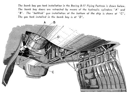

That leaves the delicate job of creating door actuators to mate to the actuator connectors and motors I did years ago on the forward and rear bulkheads. Comme ça!
unnamed (2)
This is another area where I want to see the exterior segue into the interior. (And yes, the illustration is of an early B-17 with a gun tub aft, but the actuators are right.)
