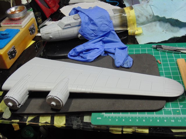

Let’s start with the wings.
DSC02283 (Small)
So, what’s wrong with this picture?
HG’s concern was that the primer obscured the scribed rivet detail. See the difference between the rescribed areas indicated in blue below and the rest of it.
And see the effect when the whole thing is rescribed!
DSC02285 (Small)

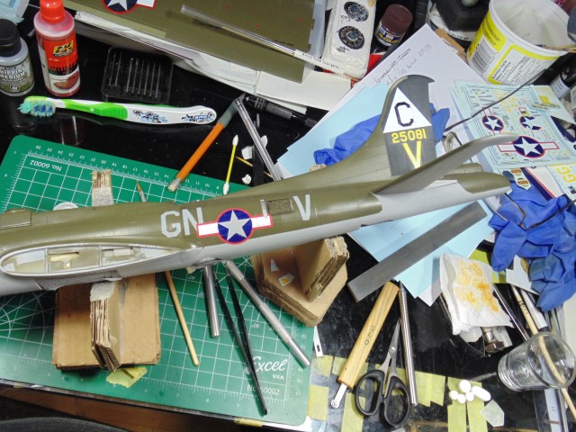

Moving to the fuselage, HG resprayed the white bar white where the decal had lifted a bit
and then rescribed it.
DSC02286 (Small)
Cool as hell! This national insignia color scheme is so emblematic of the period between First and Second Schweinfurt (August-October 1943) that any cognoscente seeing it on a B-17 knows the bomber belongs to the time when the future of “daylight bombing” hung in the balance. It’s the heart of what Half a Wing is about.

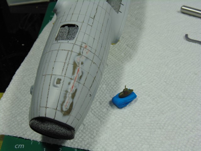

On to the radio room exterior.
DSC02287 (Small)
Of all the fuselage areas I fretted over when the build was in my hands this was the toughest, requiring so much expert re-sculpting beyond my grasp.
The is a WIP (work in progress) shot. I told HG “the Radio Room exterior ‘needs work’” and was told,
“that’s exactly what it’s getting. Gonna look splendid!!!”
So, watch along with me when the time comes.

For reasons I’ll reveal “in the fullness of time,” HG and I are less than pleased about the KitsWorld decals for the B-17, and for Luscious Lady in particular. You saw some of the issues with the generic national insignia, but the devil is really in the details.
For the record – and this is something any decal manufacturer should know – if you are doing decals for a particular aircraft, you need to get the details right.
It isn’t rocket science to find out from what lot a B-17 is with today’s online and printed resources. The late Roger Freeman devoted a whole book to the subject.
It’s in my library, though I’m a bit shocked to see it selling on Amazon for between $449.50 and $55!! [Yikes!!]
Anyway, you don’t have to spend a cent to go online to see that Luscious Lady was a B-17F-35-BO.
So I was surprised when HG showed me this from the A/C specific decal sheet we have for her:
DSC02525 (Small)
B-17G-35-BO – Say what?
Because there are other A/C from this sheet properly marked as F models, the error was readily remedied. That is if you’re comfortable working in millimeters.
DSC02524 (Small)
The fix is in, but Geeze!
