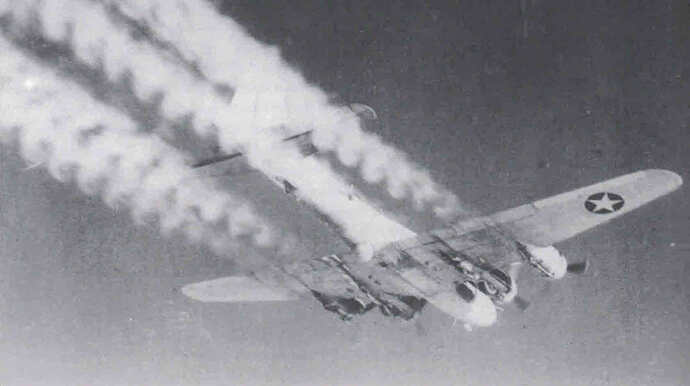

Ok, so the question before us is whether the bottom right-wing will have a grey star like the top left one or a white star.
DSC02475 (Small)
There are no pictures of this part of Luscious Lady, but there is other, conflicting evidence. Sorry if you’ve seen them before (save one new one!!) but let me lay them out now.
First up is the 303rd’s “Baltimore Bounce”
in a photo taken on 20 December 1943 with an obviously out-of-date ball and star insignia on the bottom right wing. Just as obvious, to me, the star is white, not grey.
Next is Vicious Virgin, photographed I believe in September 1943.
Copy 2 of pp-viciousvirgin (1)
Although the border looks white, trust me when I tell you that it’s red. But otherwise, it’s strange as can be. The fuselage national insignia clearly has white bars and a grey star, but the underwing one? It looks to me for all the world like grey bars and a grey star! Also, there’s that weird, super light outer panel. A quick paint job following major battle damage repair to the wing on a mission? Really hard to say.
So, what to do? There’s a final picture that provides my answer, taken sometime after October 1943, when the national insignia red border was replaced with a dark blue.
The aircraft is the Mizpah #42-5052, B-17F 358BS (VK-E), Assigned: 25 Sep 1943, MIA 22 Feb 1944, Missions:19.
gc-mizpah
I looked the name up and “Mizpah” is Hebrew, for “Watchtower,” from a biblical story, which has since come to signify
an emotional bond between people who are separated (either physically or by death). Mizpah jewelry is often made in the form of a coin-shaped pendant cut in two with a zig-zag line bearing the words “The LORD watch between me and thee, when we are absent one from another”.[3] This is worn to signify the bond.
4795lg
Ironic that the A/C was lost, no?
Anyway, the in-flight photo confirms that we will use white bars and a grey star for the bottom right national insignia, just like the top one. Here you can see it in a teaser shot from HG, not yet dried and fully snuggled down.
