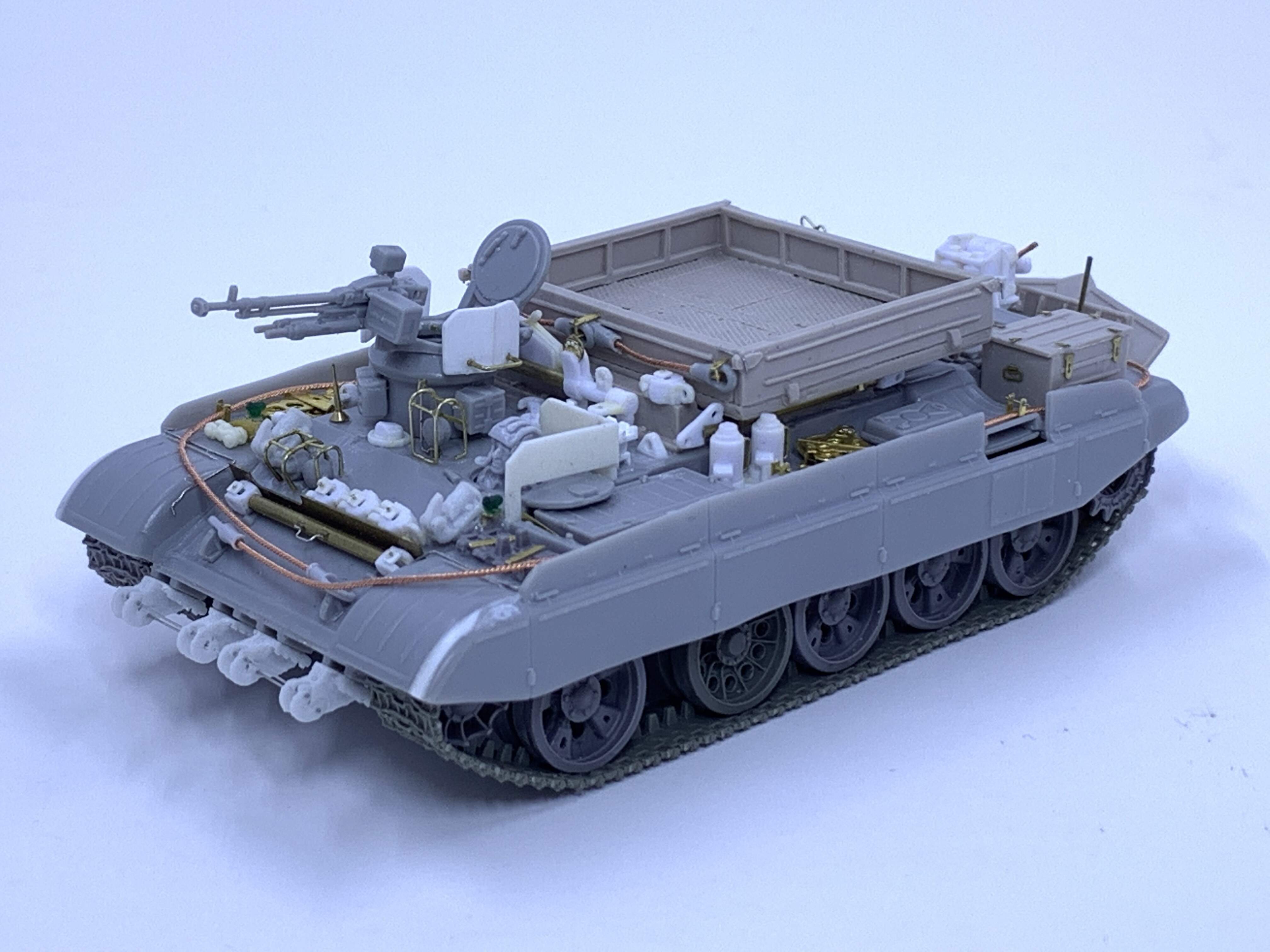

Thank you for all the comments. I really appreciate all of you taking time to view my post and add a reply. Just wanted to provide an update on this project. I have completed the build phase on the BTS. Here are the glamour shots.
Apologies for the picture heavy post. Unfortunately, I will post another picture heavy on focusing on detail shots. In the meantime, have a look at my “walk around” pictures and let me know what you think.

Lots of great details. :+1:
I do have a long project list of AFVs field modified with AAs. I will post them here as I build them. All 1/72 scale.
Very well done Joseph! Tons of details there for a 1/72 scale kit . Excellent job!
Hope to see them soon, I’ve already posted some of mine here, but in 1/35.
Killer work Joe! How did I know that this was gonna be one of your projects?
Off the Hook Joe!! So much work and detail in such a small package…Love It!!!
:+1: :nerd_face: :+1:
Amazing. Truly amazing.
Hey Carlos, you’ll recognize the work of someone who needs a psyche eval! Good to see you here!

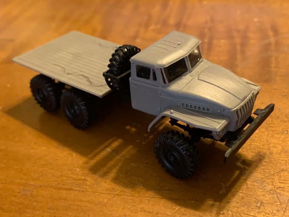

Hey there Sebastian, here is one of my older projects. It is a Ural 4320 with the ZU-23-2. 1/72 scale by Gran.
I am going to use a resin canvas cover made by Alex Miniatures.
I have New Penguin PE set for the Ural and some Balaton Model resin wheels but I decided to save them for another project.
The Ural was considerably an easy build but you’ll have to do some measuring in order to glue parts to the chassis. There were no molded positioning guides.
I dry fitted the canvas cover.
Not bad. I’ll work on the AA next.

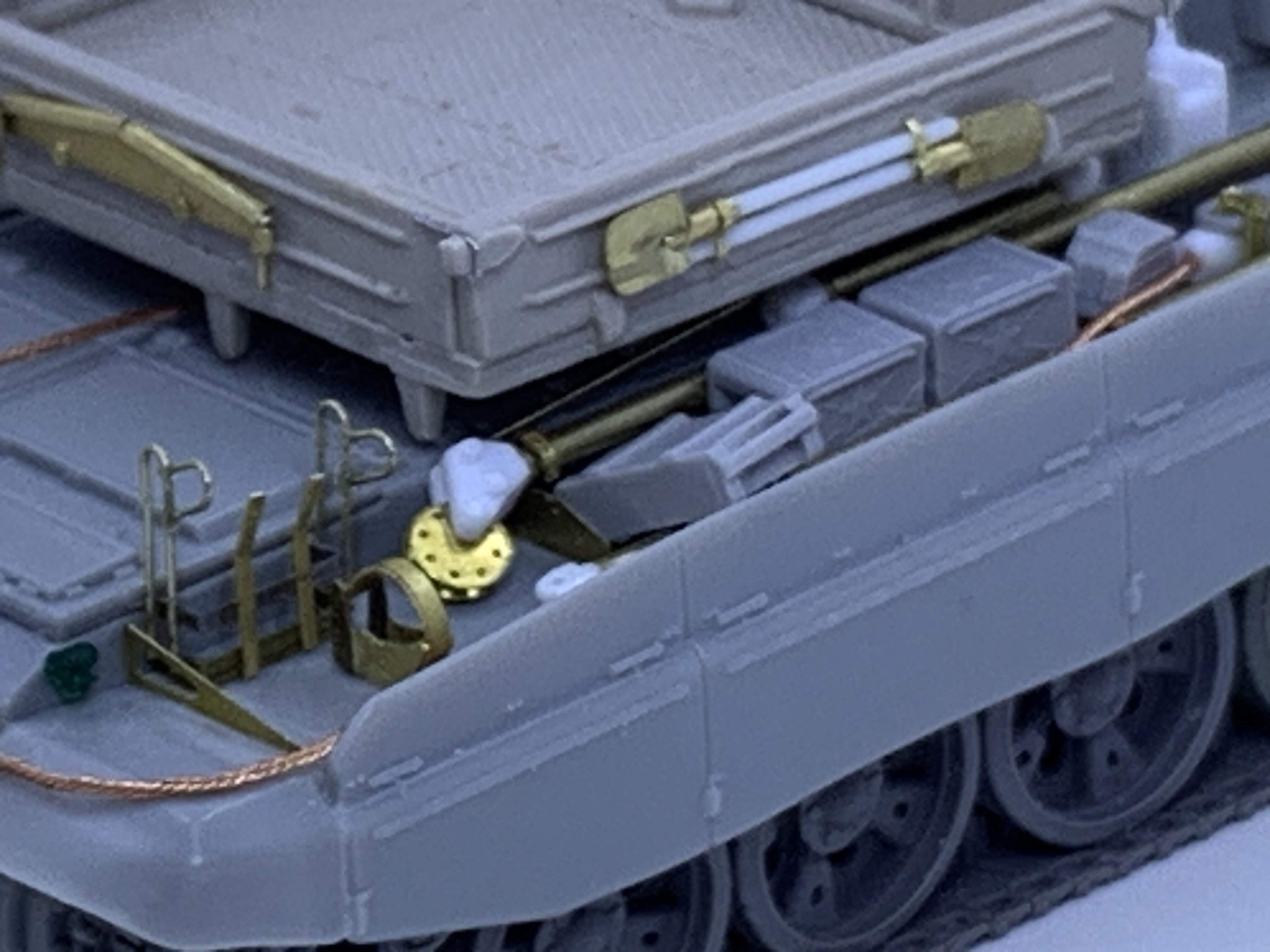

Hello everyone,
Here are detail shots of the BTS
Thanks!

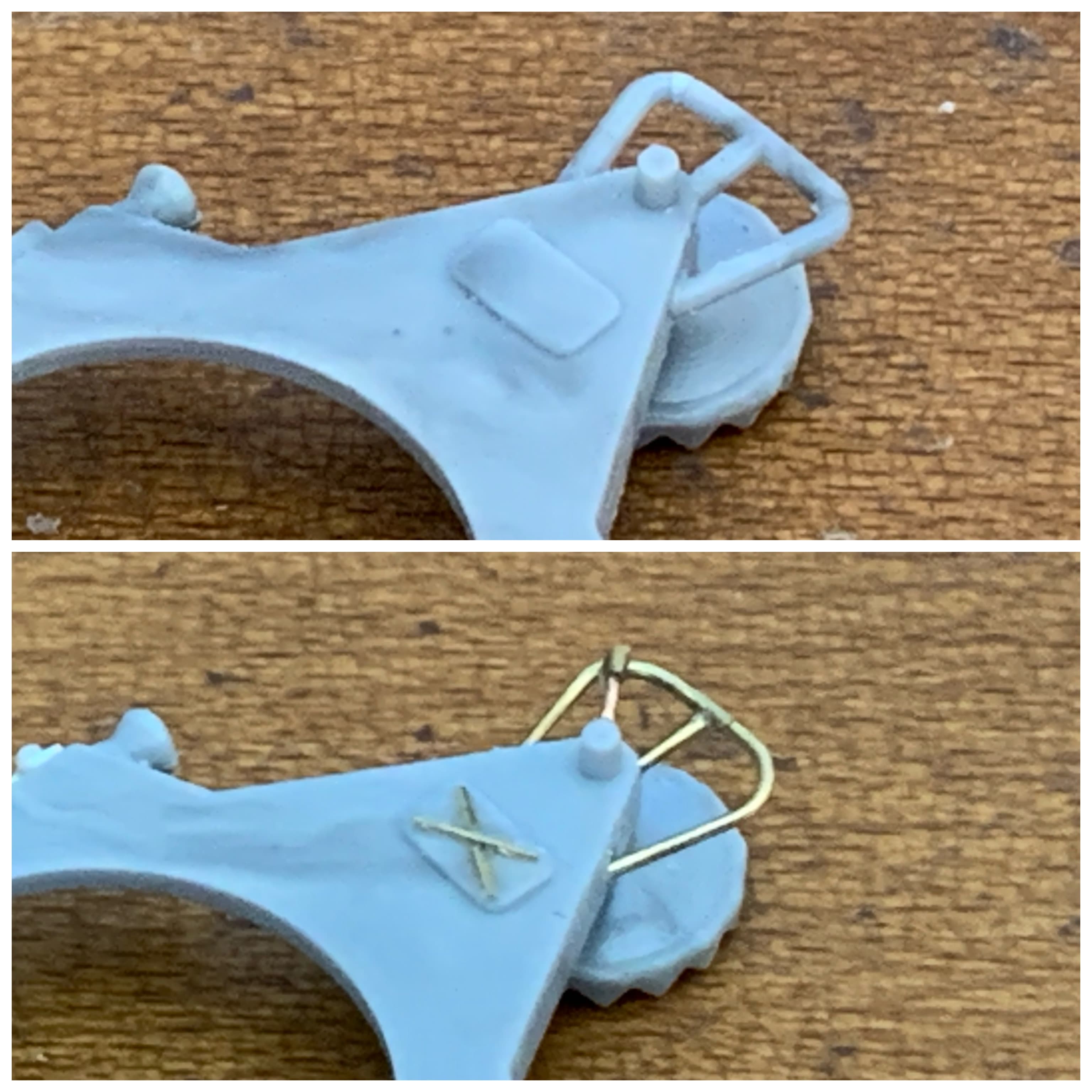

Work has started on the ZU. First thing I tackled are the barrels. There are no aftermarket barrels available. So, I used brass tubes and wires. Here are the components.
I then added some kit supplied photoetched parts plus some greeblies. Here are the resulting pictures.
I also updated the ZU base/trailer.
More pictures to follow. Thanks!
