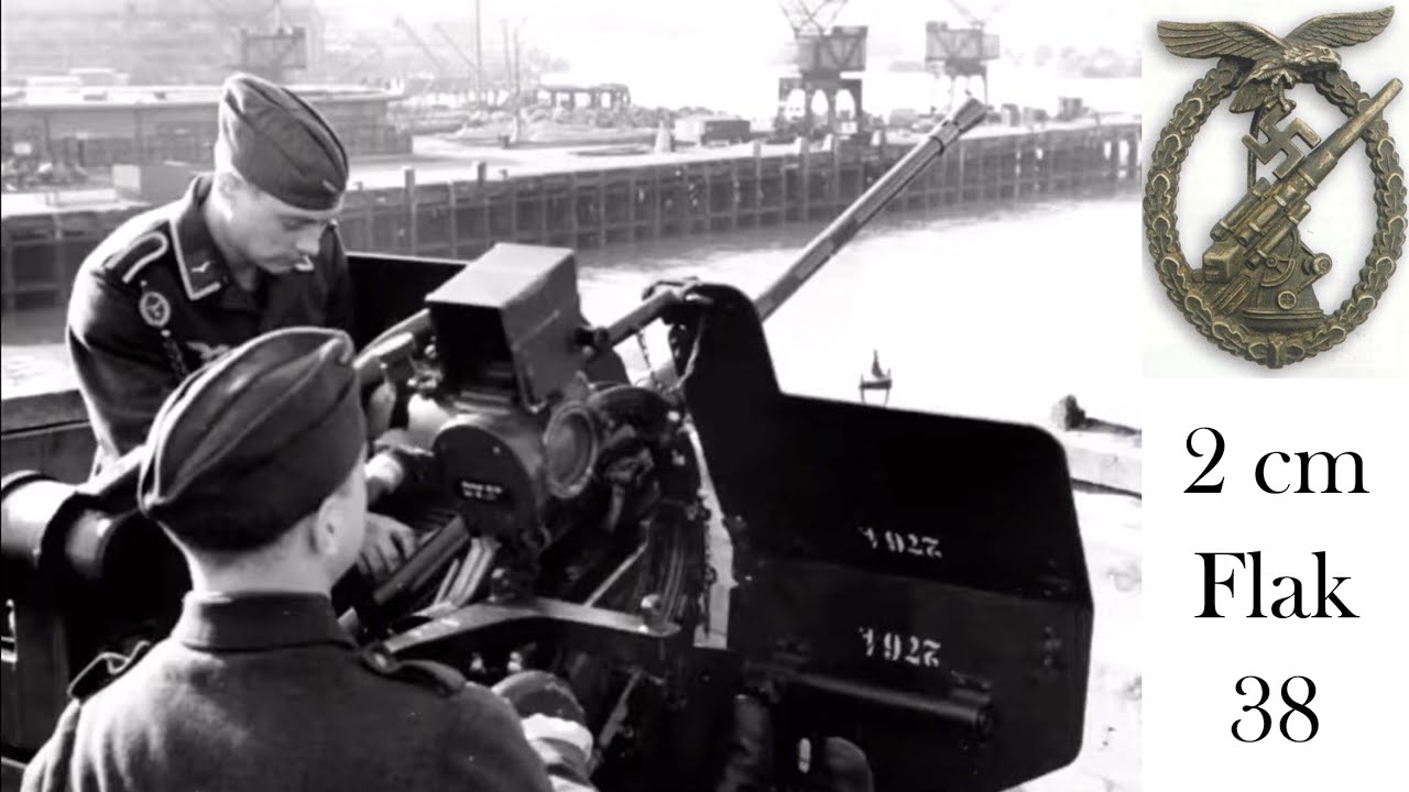

This sight is from a Flak 38 but I guess it should be the same on the Flakvierling…But I’m no expert :wink:

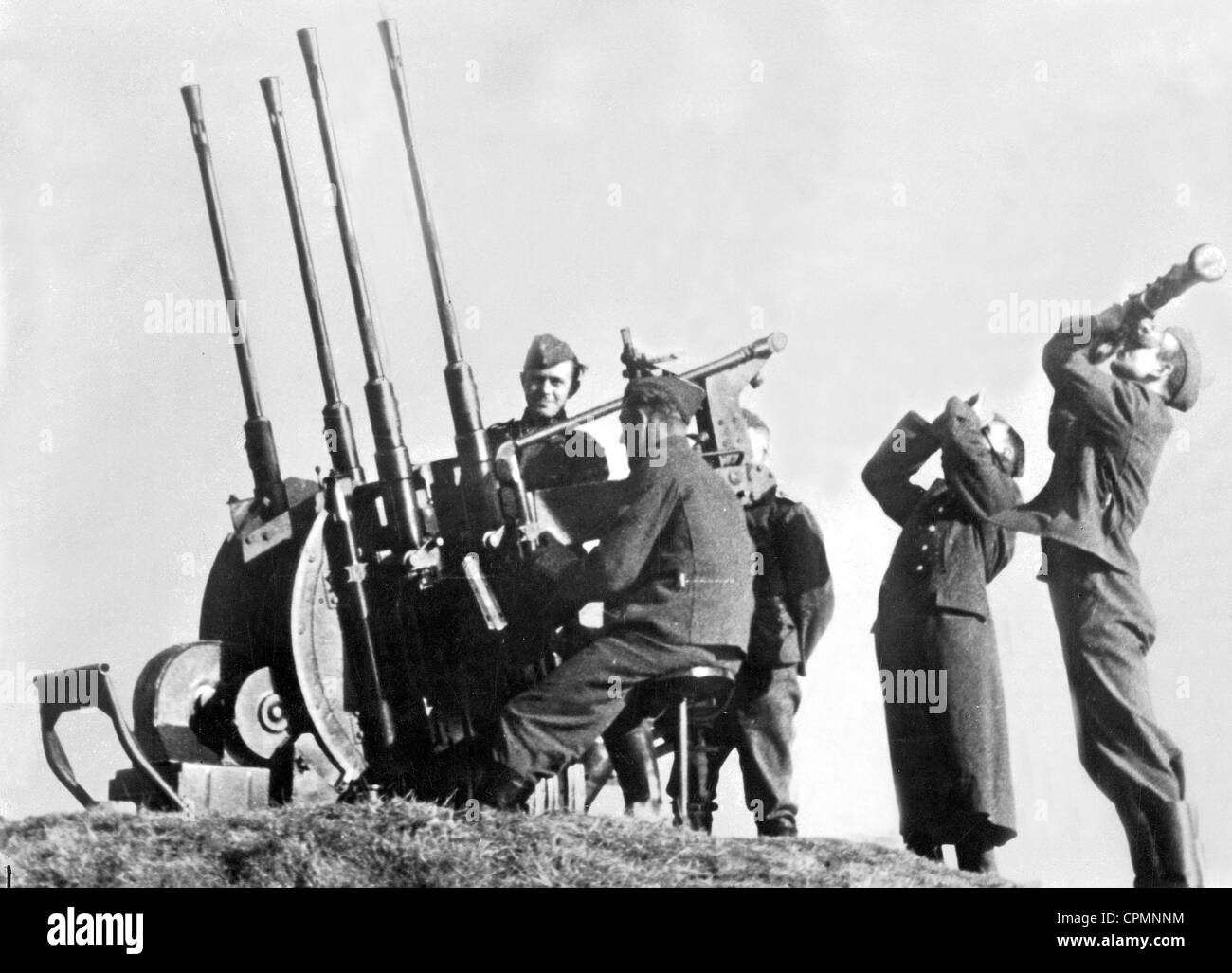

From the Dragon kit instructions
This picture just illustrates my point. The boom with the gunner’s seat is always horizontal - so the gunner is always sitting upright and, more or less, looking straight forward. The gun is capable of an almost perpendicular elevation. So the gunner is capable of bending his head back almost 90
degrees? If I am modelling a Flakvierling with an elevation of around 80 degrees, do I have to cut off his head and tilt it way back, so that his eyes are parallel with the guns?
