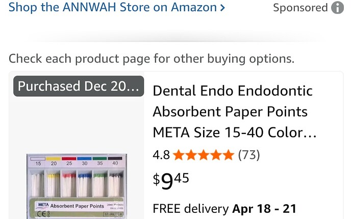

Ordered mine in December last year from Bezos-land…Amazon

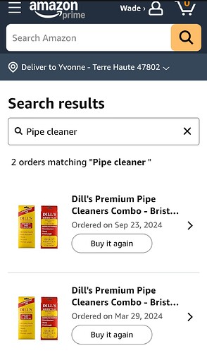

Does anyone still use pipe cleaners to clean their airbrush? And if so which ones?
Richard, I use these on my siphon feed Paasche VL & H to clean the color cup and where color cup attaches. I used them on the H’s nozzle and tip too. Will use them to clean the air cap tip with these on the VL but I don’t use them on the nozzle etc.
I don’t use them on the Iwata Micron B.
Pipe cleaners have a wire in the middle that can damage your nozzle and seals. Also, the fuzzies come off and clog up your airbrush body. I would advise against using pipe cleaners in your airbrush.
Yes exactly, I stopped using the pipe cleaners I have because of the wad of fuzzies that were stuck in the airbrush. I was wondering if there was a better alternative. I just bought those paper cleaner things. I’ll try them out today , I’ve got some spraying to do.
