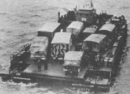

Photo of actual ferry
The sides are not solid, they are stanchions, wire and net. Just one example of lost detail.
Loaded with vehicles.

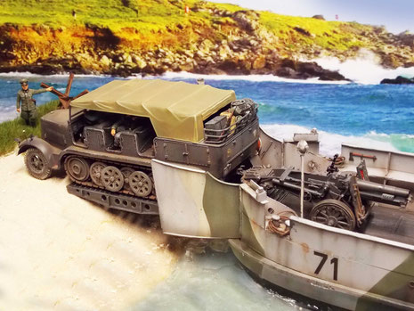

There was/is a kit for 1/35 Pionier Landungsboot 39 by Schatton Modellbau (nr. 3584)
There is a build/dio with it at Panzer-bau.de
