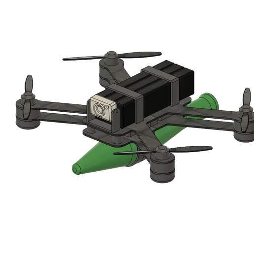

On CULTS3D there is Kamikaze FPV drone 1:35 (First person view) RPG Grenade, FPV Drohne by AG87

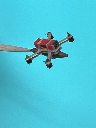

My attempt was

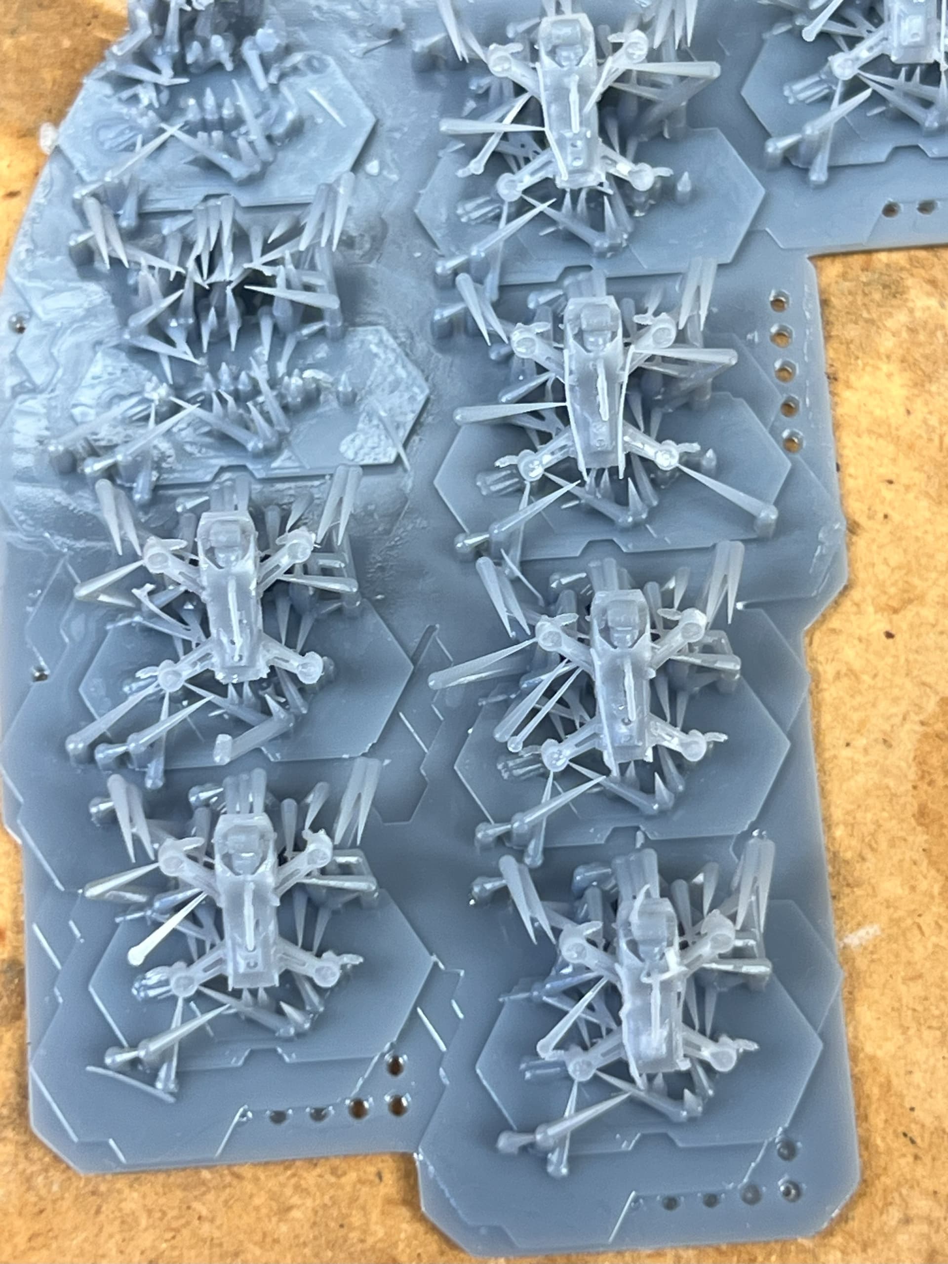

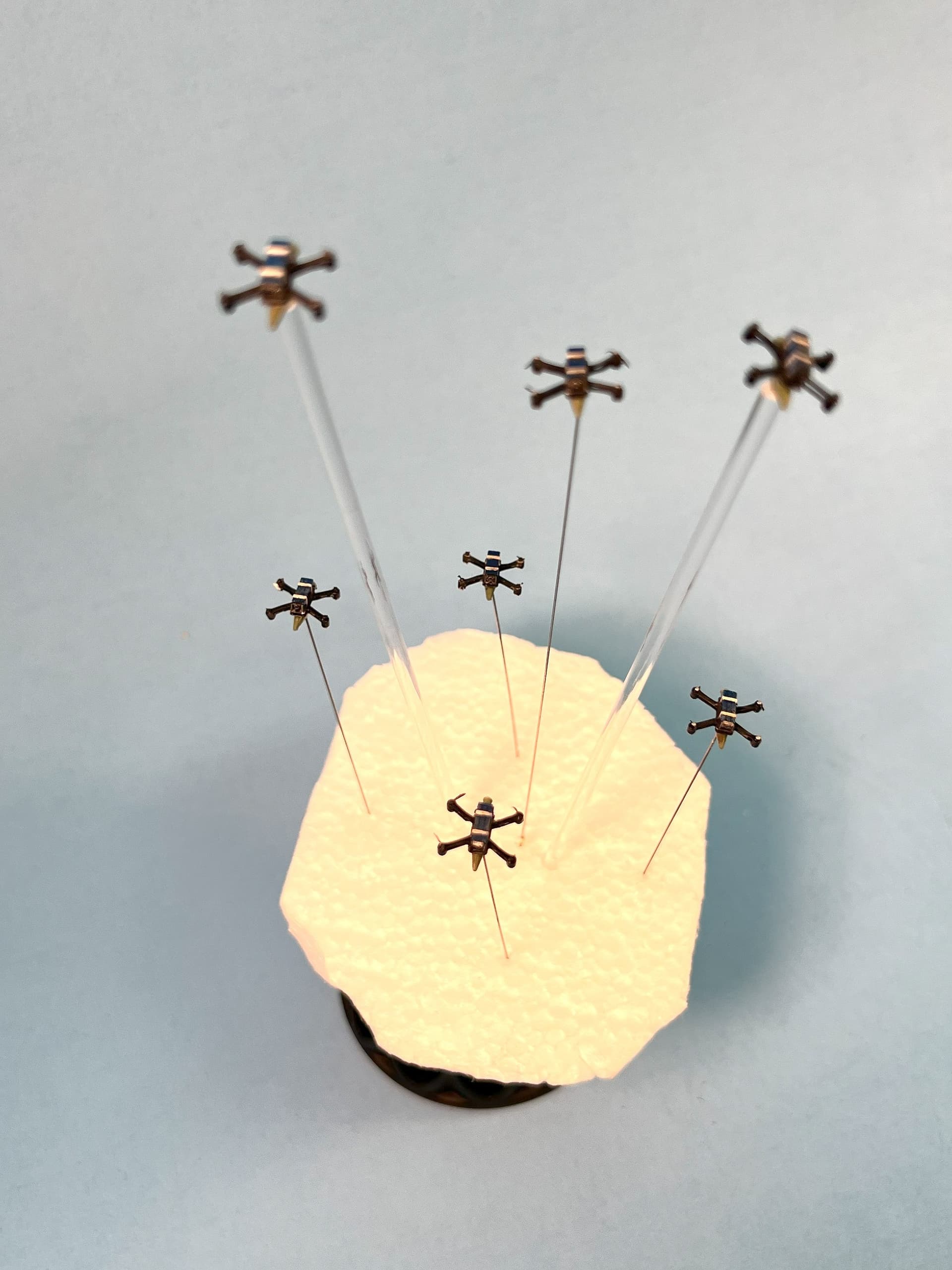

Making rafts of 6 little drones at a time takes less than an hour to print. Scaled up the Z direction by 20% to get arms and some propellers. The painting and weathering based on Youtube videos was fun.
Add some supports and formation creations open up interesting possibilities.

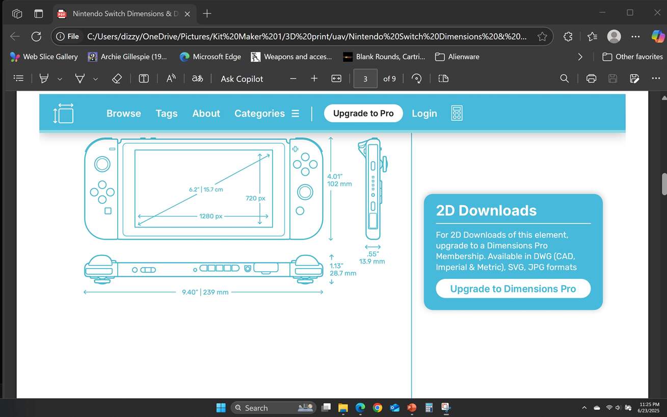

1/35 scale PSP controllers and crew staff are next.
Likely controllers are available on CULTS. The Playstation 3, the SWITCH, and the PSP controller all offered by zjjj927. These are easily scaled down from his original 1/24 scale to 1/35 scale for printing.
The initial printed parts in scale look good. Sorry for the poor pictures but future paint will pull out these details.

Sprank Drone (race drone with cam gimbal) ](đŸŽïž Sprank Drone (race drone with cam gimbal)・Free STL File for ・Cults) by mwilmars printed. Honestly gave mixed results but in fairness, I scaled his original model file down to 3%. 3% gets roughly the 1/35 scale print. 3% and things like the landing skids and props got sketchy.
More things to try before moving on to another possibliity

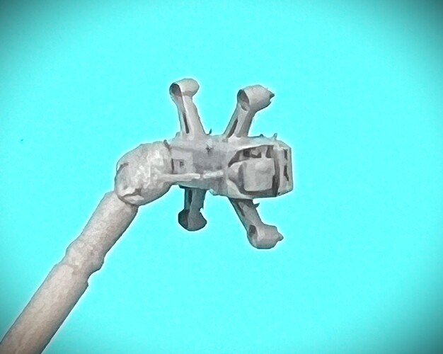

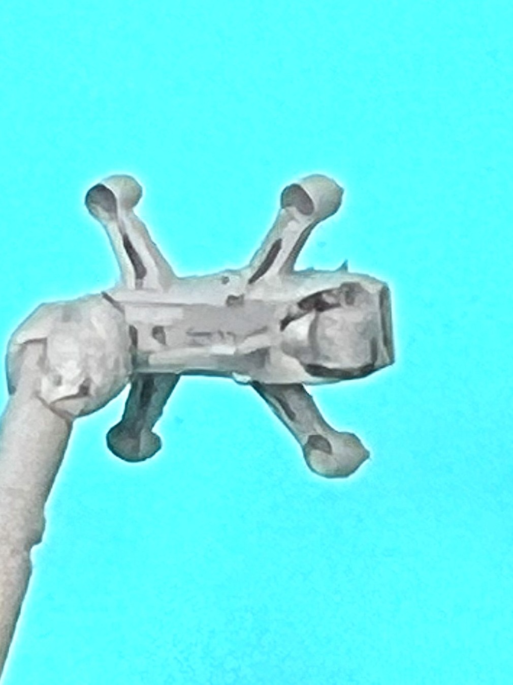

Found 1/35 Scale DJI mavic 3 from Russo Ukraine war by “ModernModeler”
These are equally tiny and I can not get my printer to support the propellers but they look to be scale.

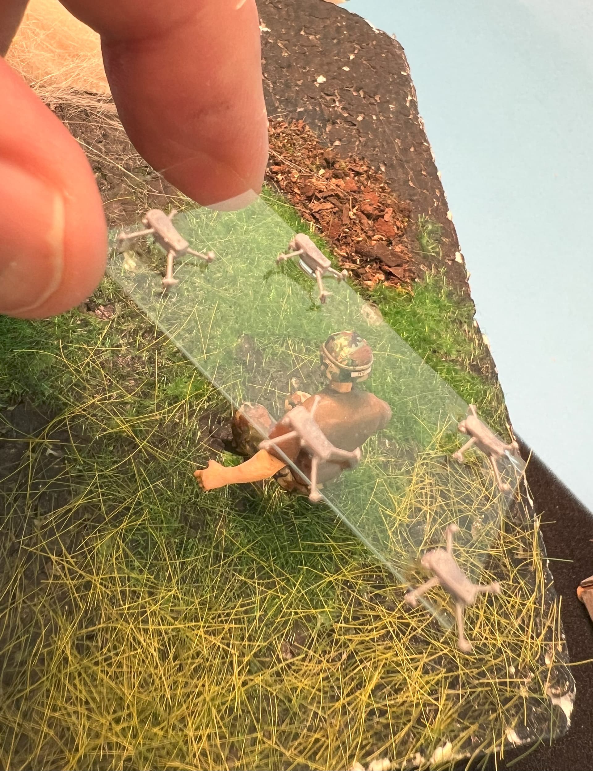

I like this suggestion by 18 BRAVO. Rob said:
So I started playing for a minute
and if you use the right glass, the edges are not much of an issue.
I had some microscope slide covers to play with
I don’t know if this would lead to anything useful, but some ideas to kick around.
I think this is a great idea to consider, Stuart.
Yes. Thank you. Just to be clear (see what I did there? LOL) the micro scope cover slides shown are a very brittle thin glass material that shatters easily. I could envision clear plastic styrene sheet punched out as small disks to stand in for the static drone props. The drone static props are part of the STL file but are beyond my resin 3D printing capabilities. Much ahead to try!
They also make plastic coverslips. I teach middle schoolers and that’s all I will use.
Will look at those also. Thanks for the link

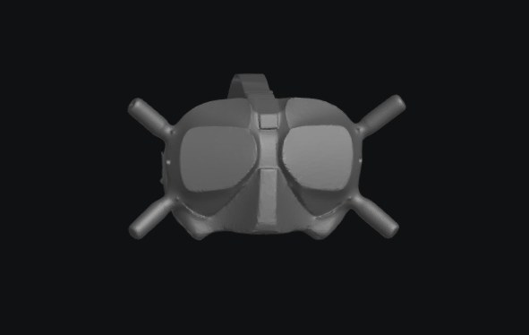

Thanks Mike. That is helpful insight. This same @ModernModeler
(All the 3D models of ModernModeler・Cults) offers the DJI helmet.

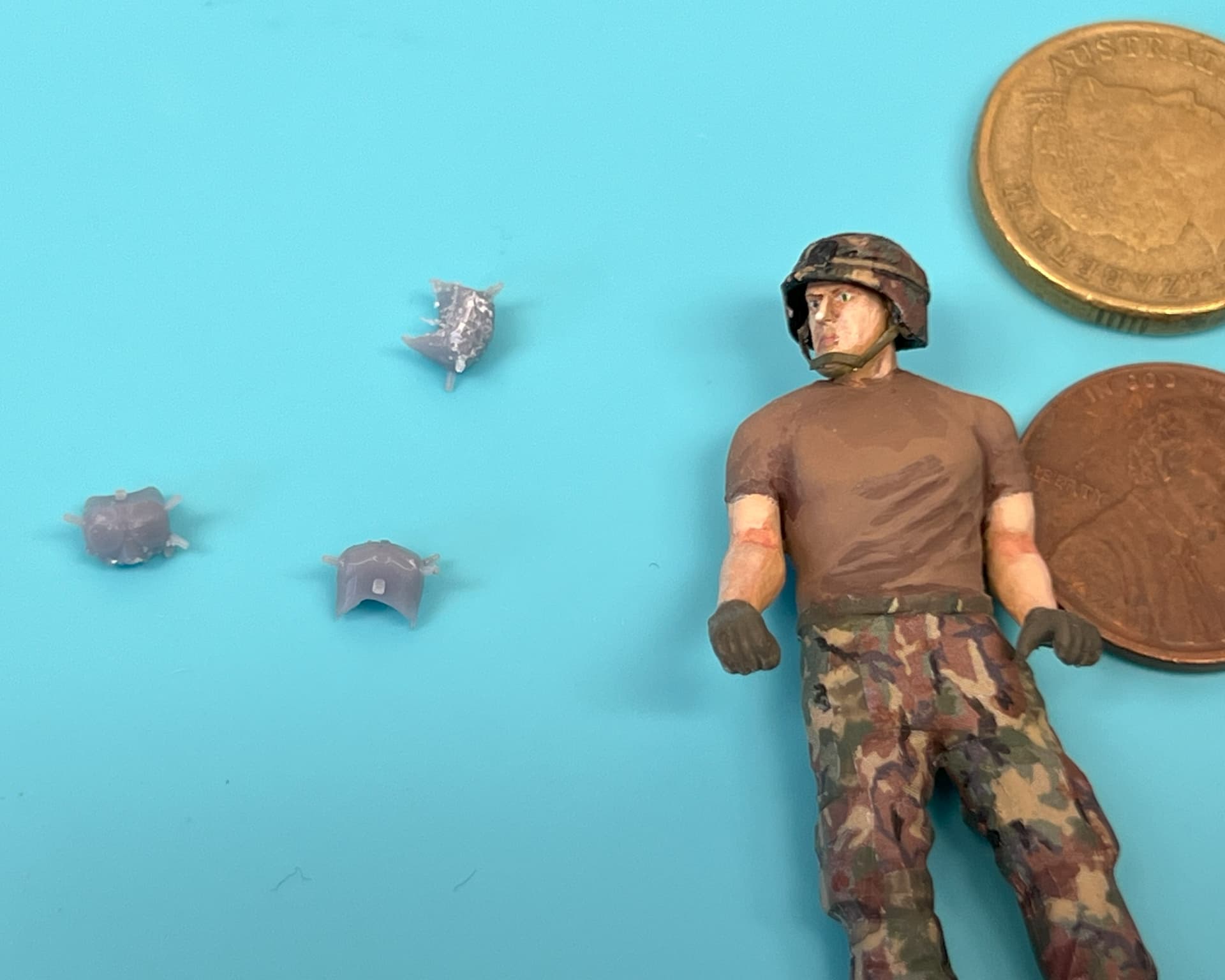

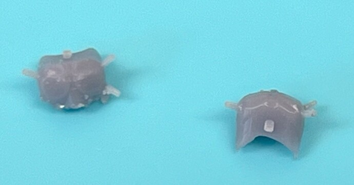

My attempts at the goggles so far
