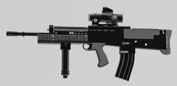

I have heavily modified my CAD for L85A2 to look like one with SUSAT. What do you think?
I’ve even added a Union Jack to look like the one in the reference photo. :slight_smile:
Reference

Length from rear of mag housing to rear of rifle is to long.
Exposed barrel is a bit to long and to thin.

  1. Looks like an A2 with a torch attachment but it’s lacking clear definition and detail all over
  2. looks like an A3 with a UGL but again lacks definition and detail all over
  3. Looks like an old LSW (basically an L85 with a longer barrel and bipod) now phased out and not used.
  4. looks like an A2 with a BFA fitted but same as above for definition and detail.

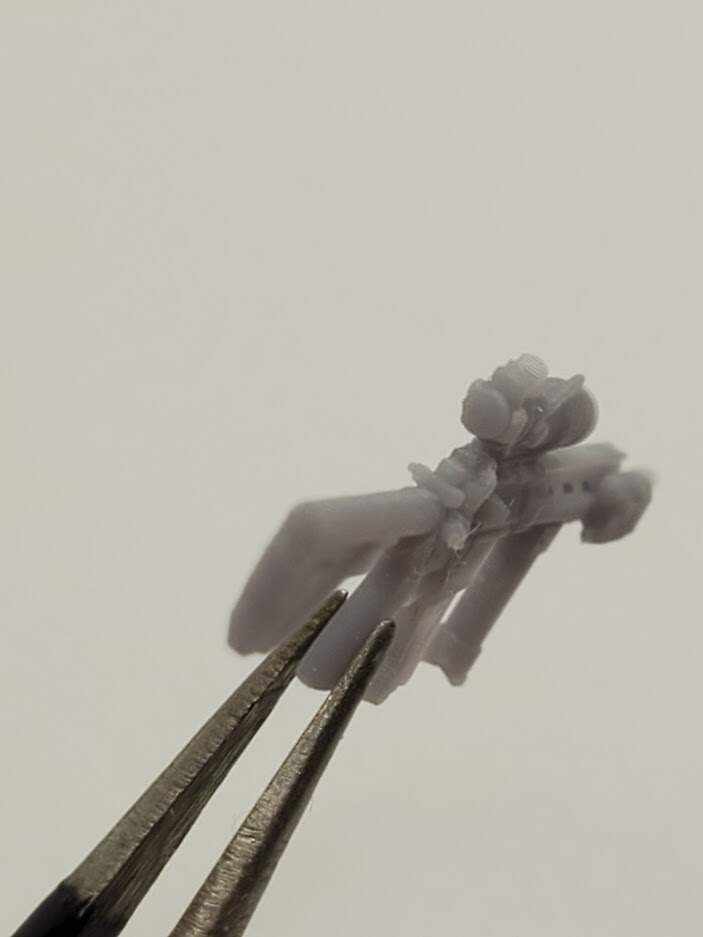

I’ll update the first L85A2 above a bit but it’s going to be purely more CAD exercise since no one has ordered a 3D print nor do I foresee anyone ordering it. The gas plug housing (not sure what it is but) will be left as is b/c at 1/35 to avoid thin parts triggering a print fail. From what I see Gecko models already offer a good set of British weapons.
Calling this CAD for L85A2 done. Spent unnecessarily too much time on it. I based the dimensions on some reference photos and corrected the sizing issues accordingly.
James, ref the finalised CAD you did above. Those changes now make it look spot on, looks great. I get what you mean about orders for it. I think its purely location as if you were this side of the pond, I could see you getting orders easily. One of the things that would sway it for me is, I could get 5 or 10 L85A2s from you and use them, opposed to getting say the Gecko weapons pack and end up only ever using a quarter of the weapons supplied, the rest staying on the sprue for ever…
Great work :+1:
Thank you, John for your kind words and feedback. No worries about not buying from me. The shipping cost is prohibitive (around $18-19 for the 1st class) from the US. This was a good practice run. I plan to CAD some more British weapons later and improve my printing skills also. My 3D printing skills need a little more refinement for these little prints. I want to at least print out an L119A2 in the near future.

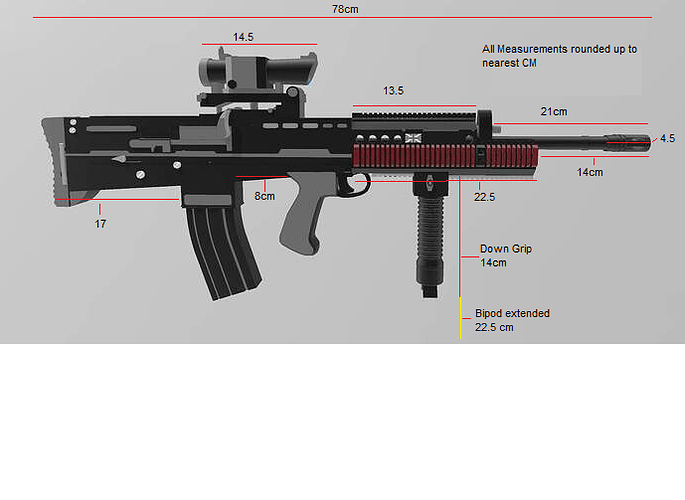

No probs and for future ref if ever needed.
Hope it’s useful at some point.
John
Thank you very much, John for the photos and dimensions. Luckily my CAD checks out all of them except for the top of the handguard (mine is at 15 instead of 13.5 - o, well, close enough…).
I’ve made a few changes based on the photos - not that they would be visible when printed in 1/35.
Glad to help out, the CAD is looking 100% :+1: nice work

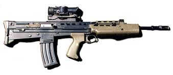

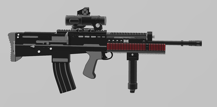

Hi John,
I ended up spending a lot more time putting together these CADs of British weapons. Once I started, I had to finish… :smiley:
Can you please let me know if there are any glaring errors? I really wasn’t too sure about the LDS scope and had to guess based on limited reference photos.
L85A2 & LDS + CQBBS
Reference photo:
L119A2 w/ sound suppressor - downloaded from Sketchup (https://3dwarehouse.sketchup.com/model/19bd0f5e-970d-4196-bc55-6ce2d800ab5f/COLT-Canada-L119A2) and made some minor changes:
L119A2 w/out the suppressor
Hi James, The L85 now looks perfect and that is a pretty damn good rendition of the LDS & CQB BS.
Ref the L119s the renditions are all good as they are, just remember they can be outfitted in so many configurations for individual operators on custom fit outs.
Now add to that various customsights, different types of down grips or angled hand grips, laser markers, torches etc etc etc … its a long list :+1:

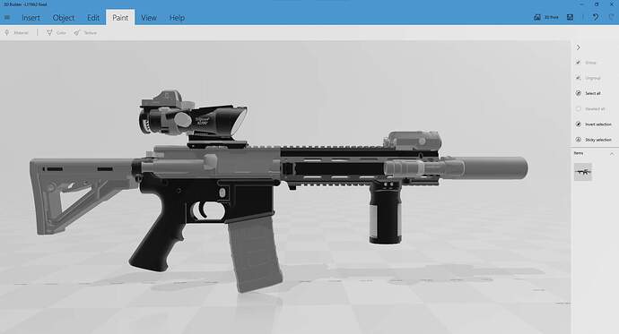

CAD of M27 IAR (HK416 adoption) used by USMC:
W/out sound suppressor:
With suppressor
Reference photos used:
one more custom CAD done. 3D printing tonight or tomorrow.

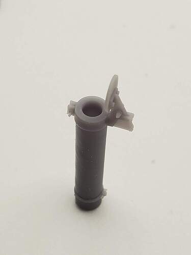

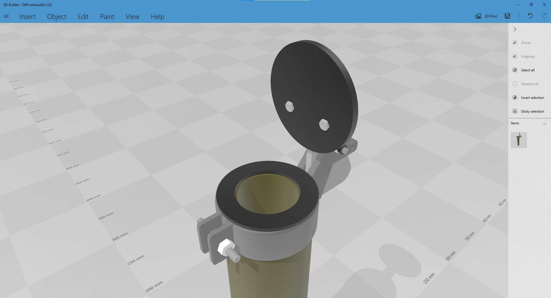

D9R bulldozer (for Meng 1/35) exhaust replacement for “in action” position.
Reference photo:
Kit parts:
3D prints of the D9R exhaust done:

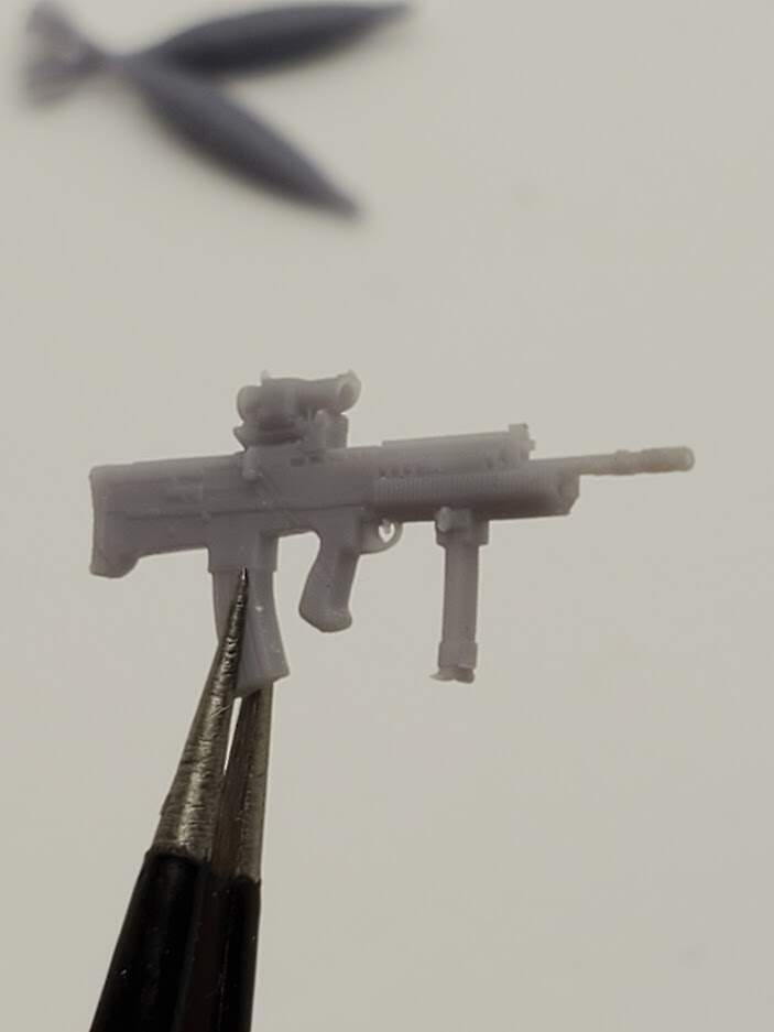

Rifles printed. M27 IAR:
British L85A2s CADded earlier:
