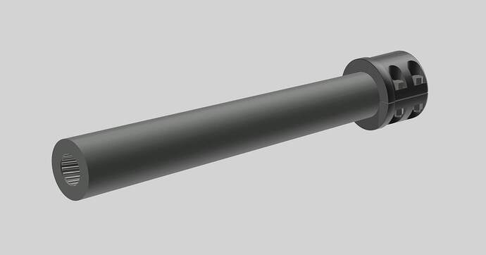

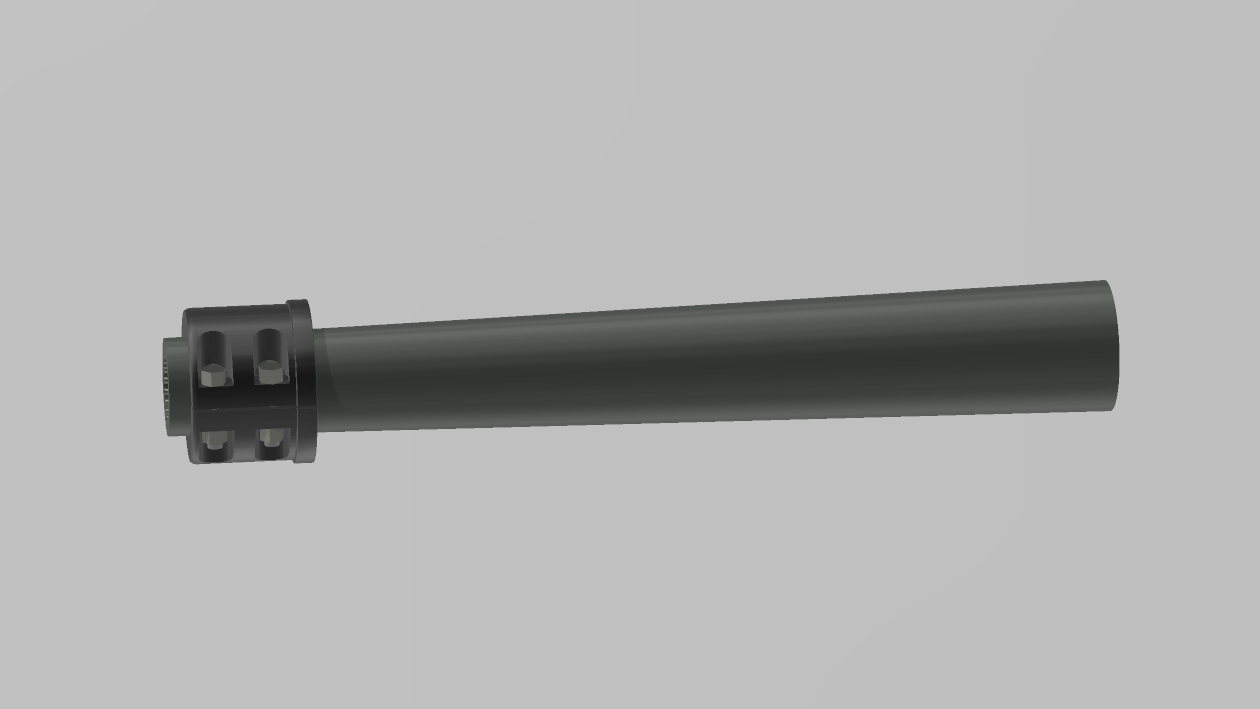

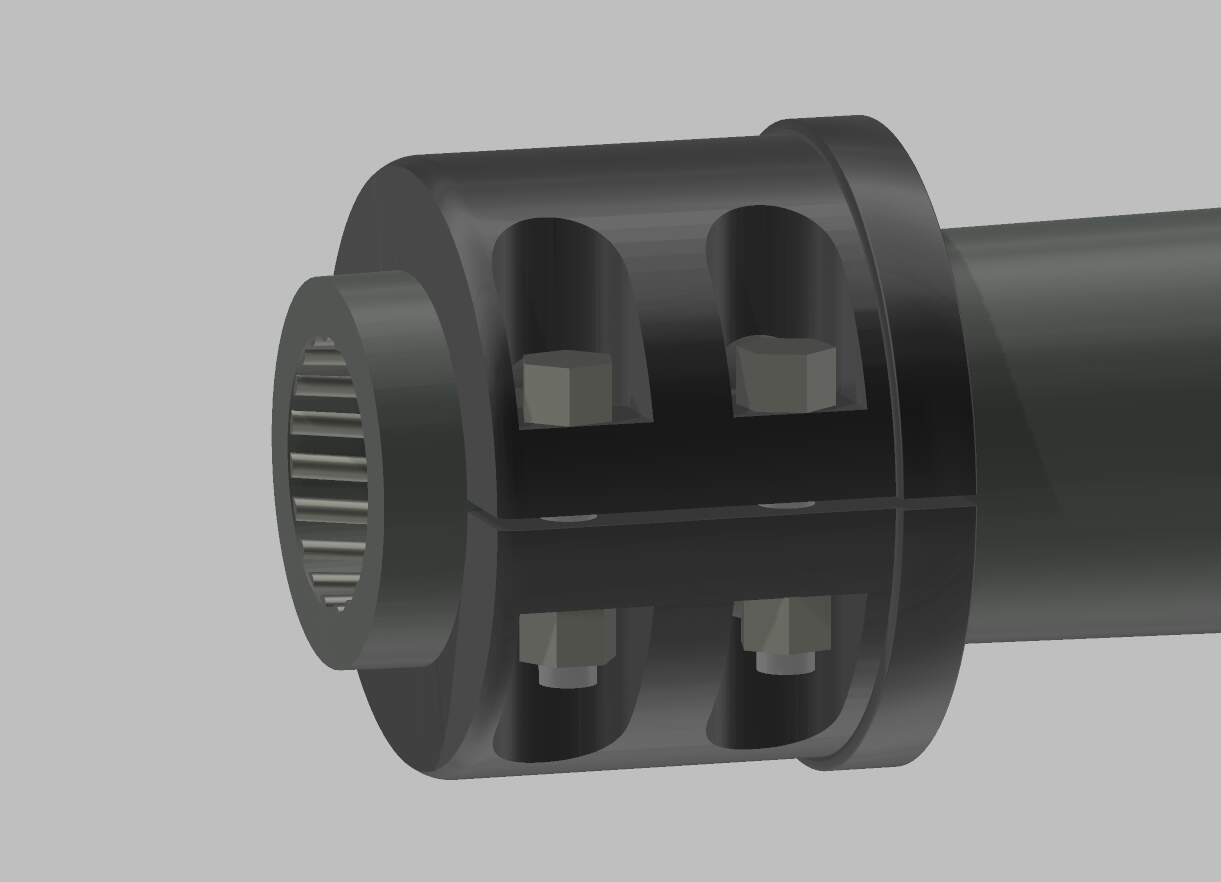

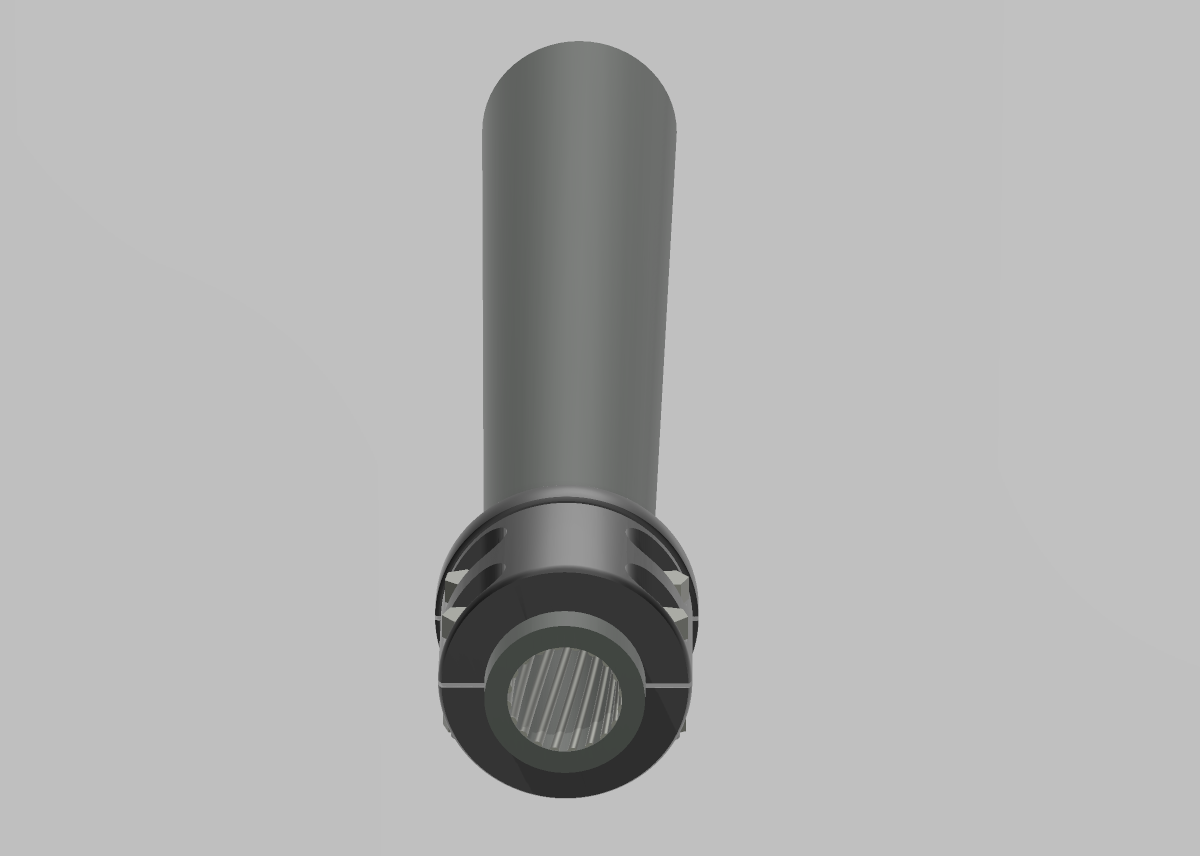

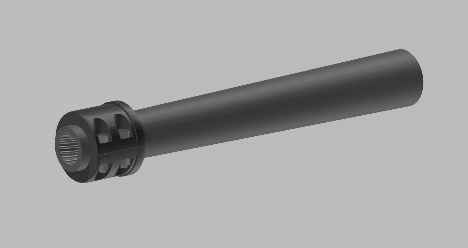

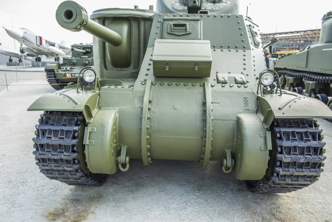

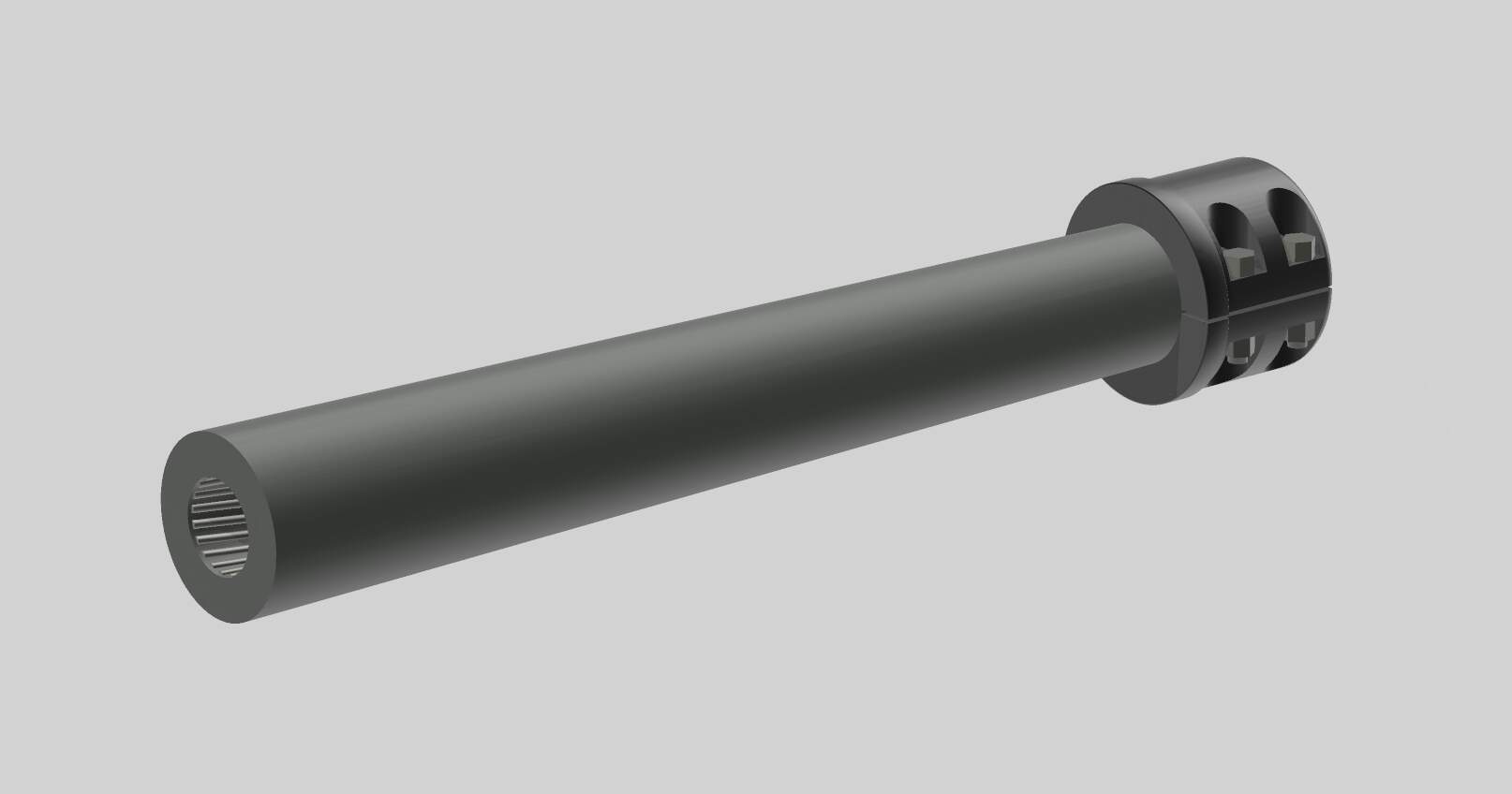

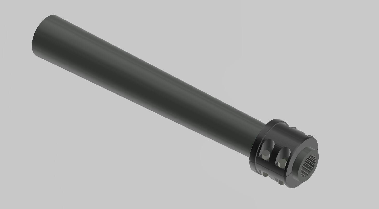

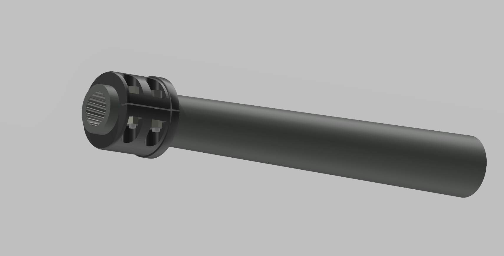

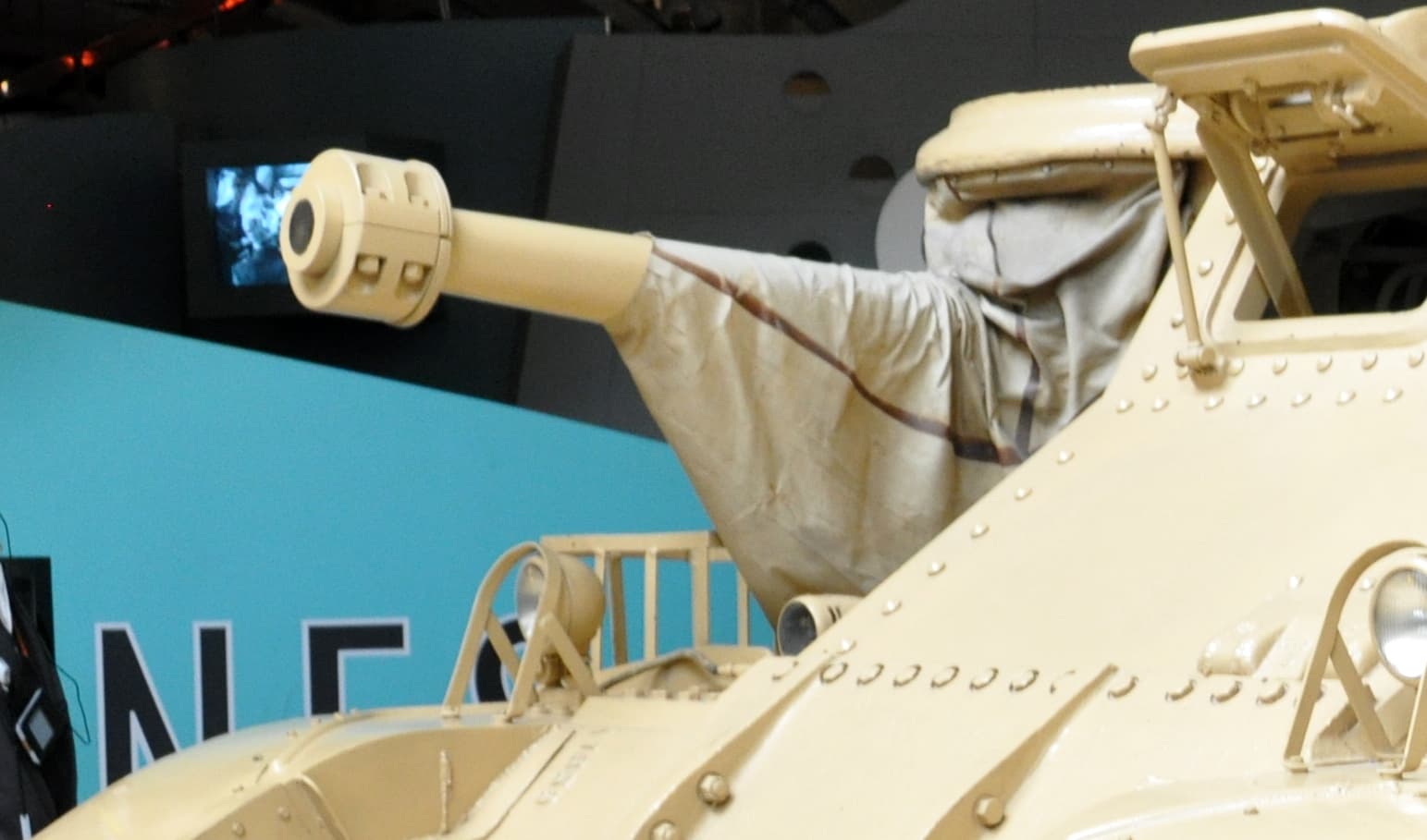

M3 Lee mid. prod. 75mm gun in 1/35 CAD.
Measurements based on Takom kit parts and Formations resin AM parts.
Reference photos used:
Looking nice James! As you know I’m interested in more recent subjects than WWII and the like, but your level of art is inspiring. Thank you for sharing.

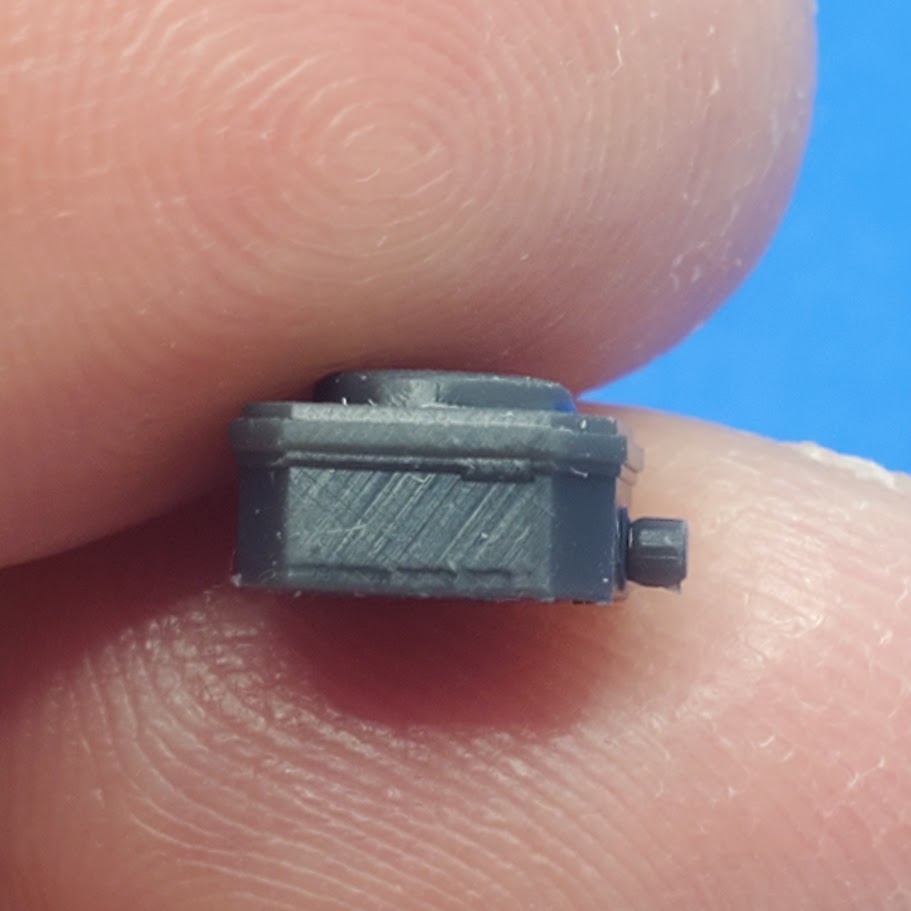

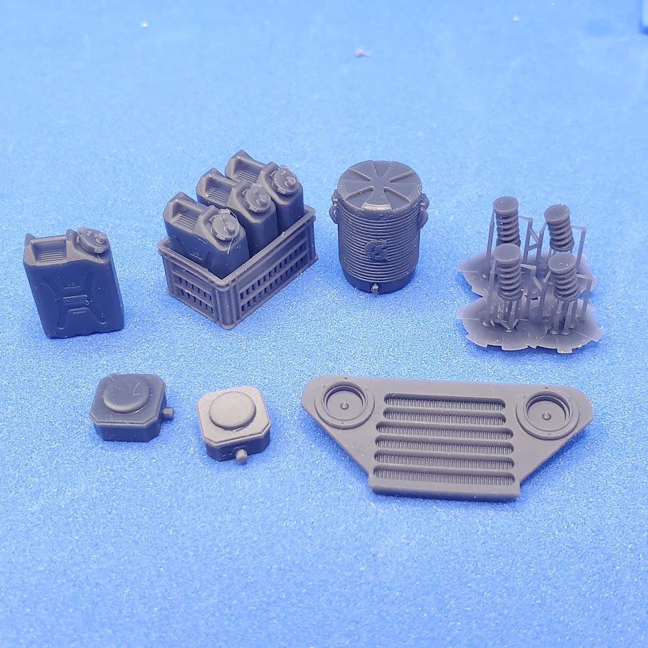

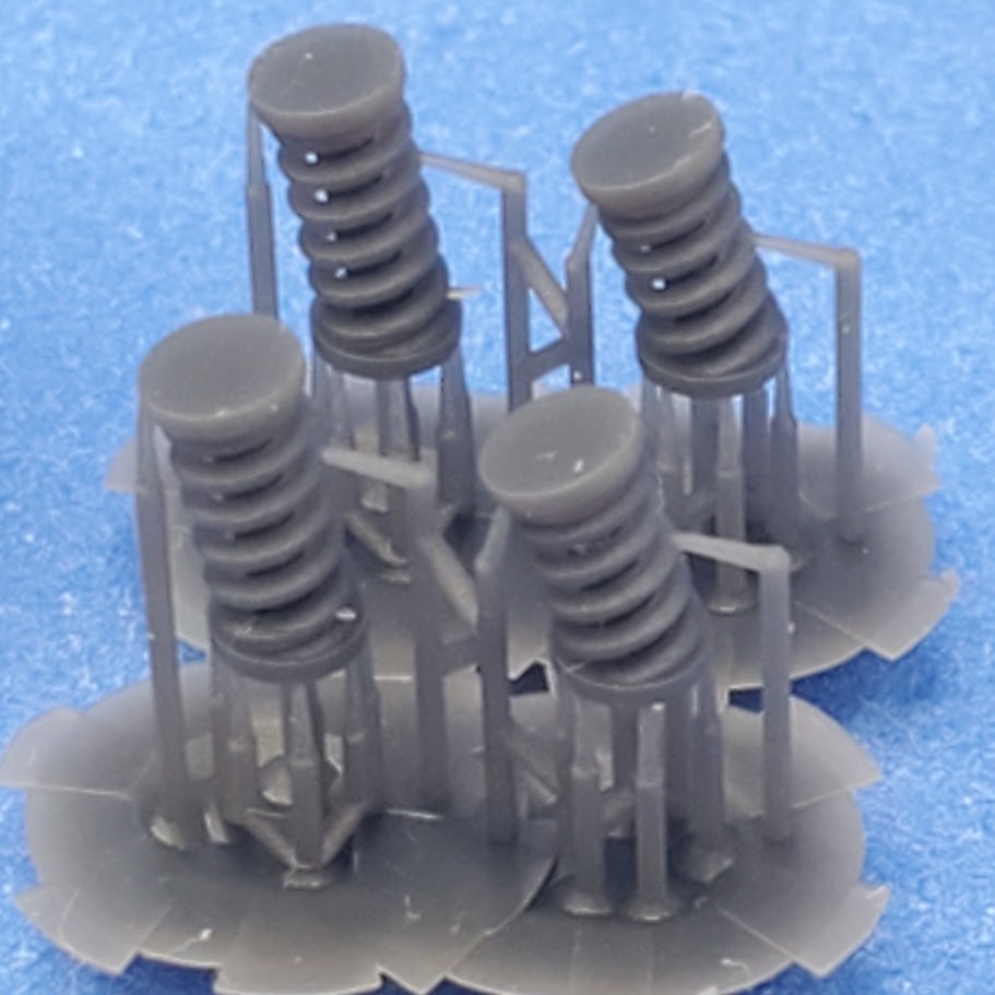

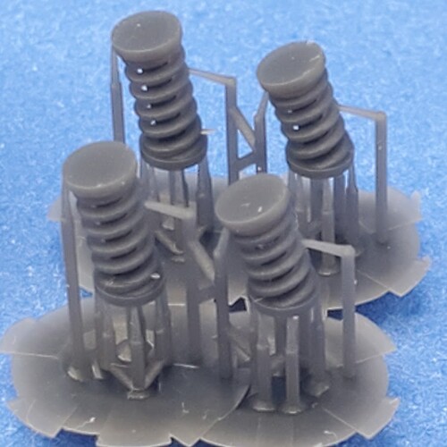

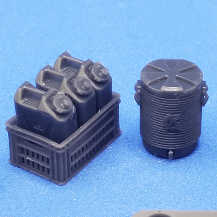

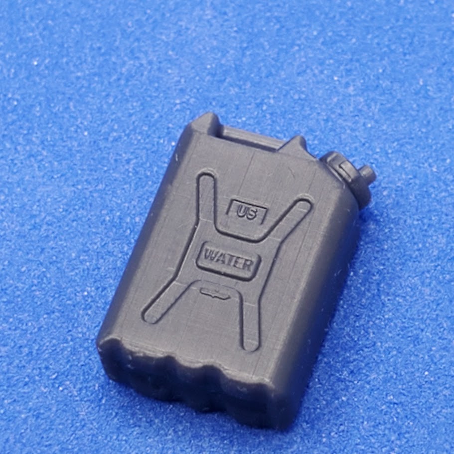

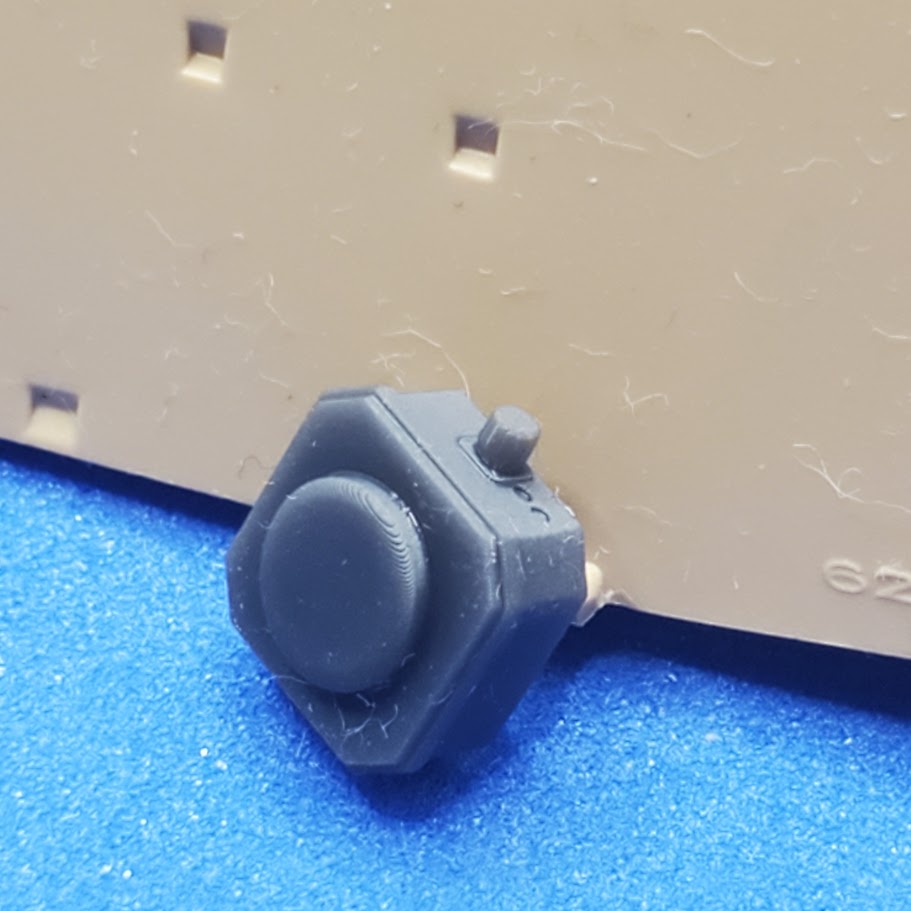

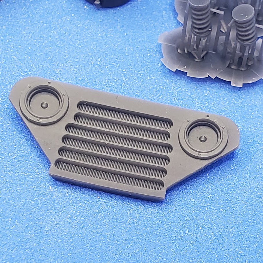

Some 3D prints in 1/35 from this past weekend. These are printed with my newer 8K Elegoo Saturn 2. The details are better than my 4K Mars 3:
Dan, please let me know if you want to purchase some Lee guns and M1919s. I can print some this weekend.

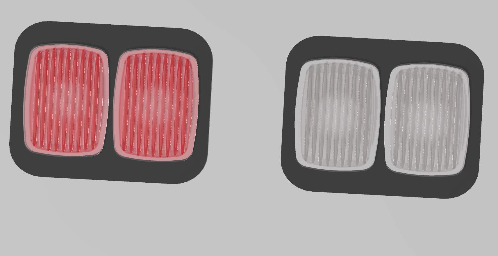

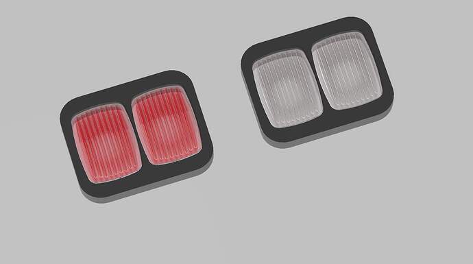

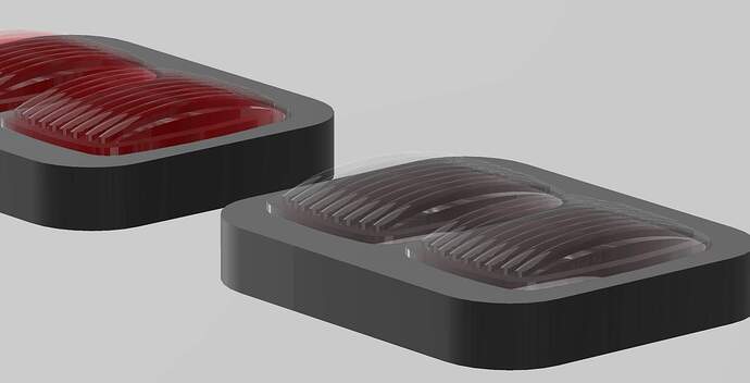

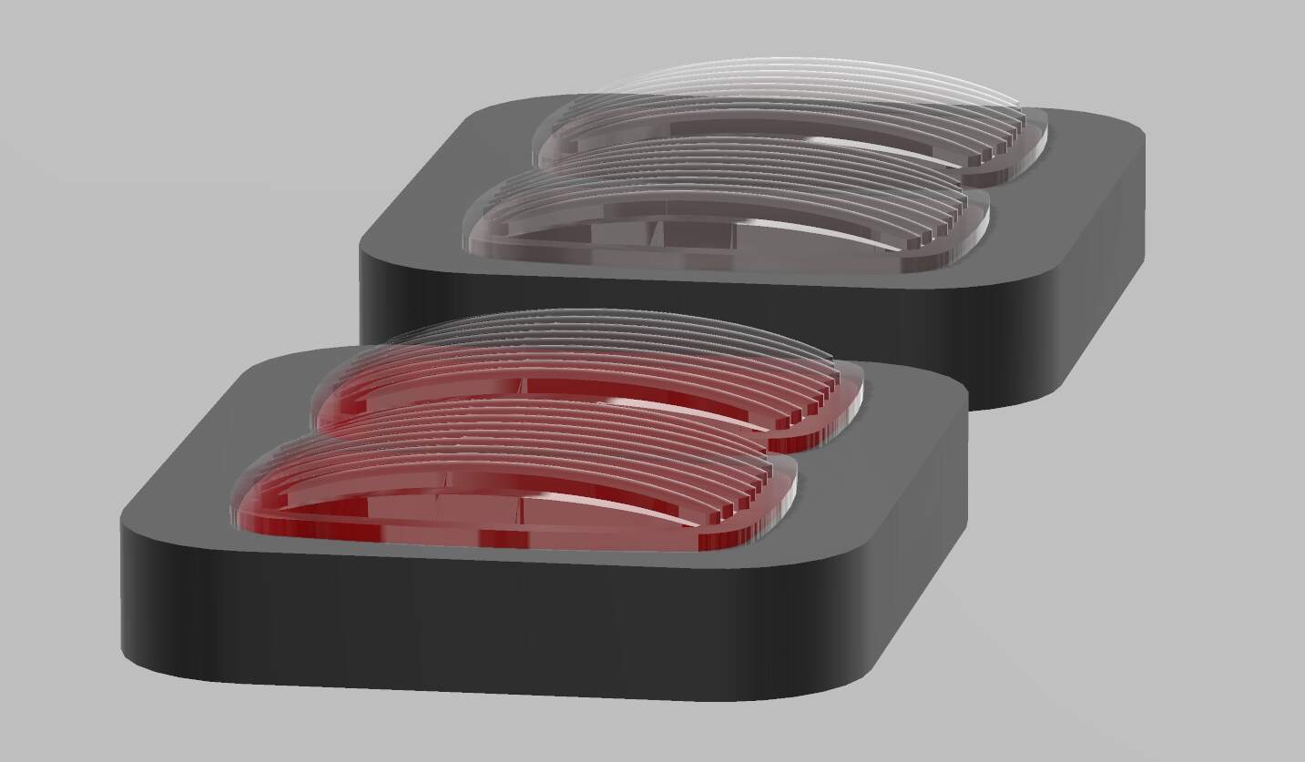

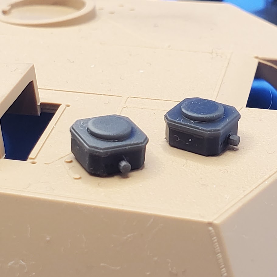

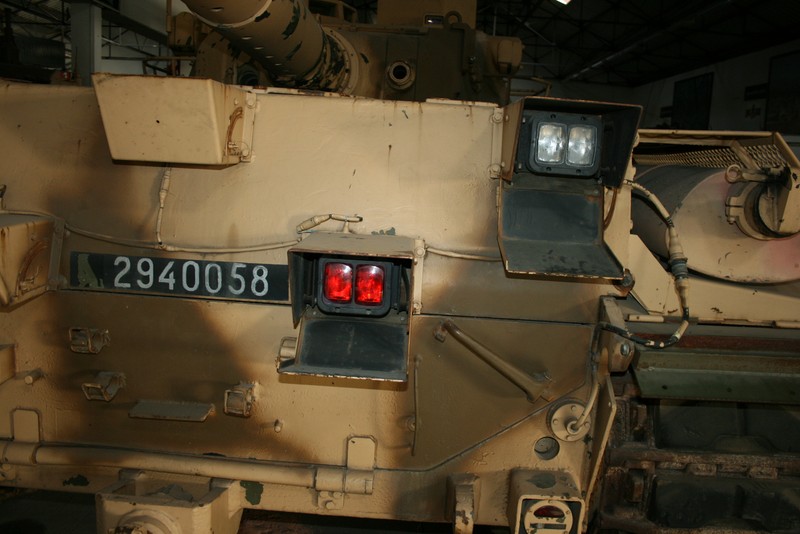

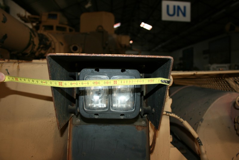

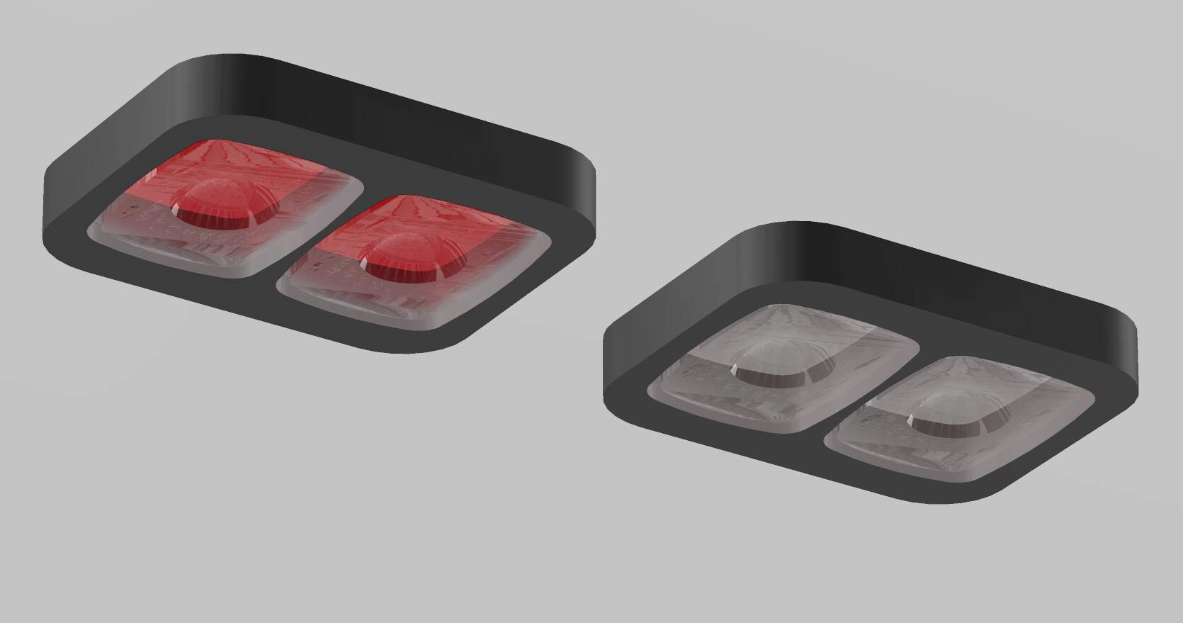

Getting there with the lenses for AMX-30 EBD rear light casings.
These will be 3D printed in clear resin.
Reference photos:
