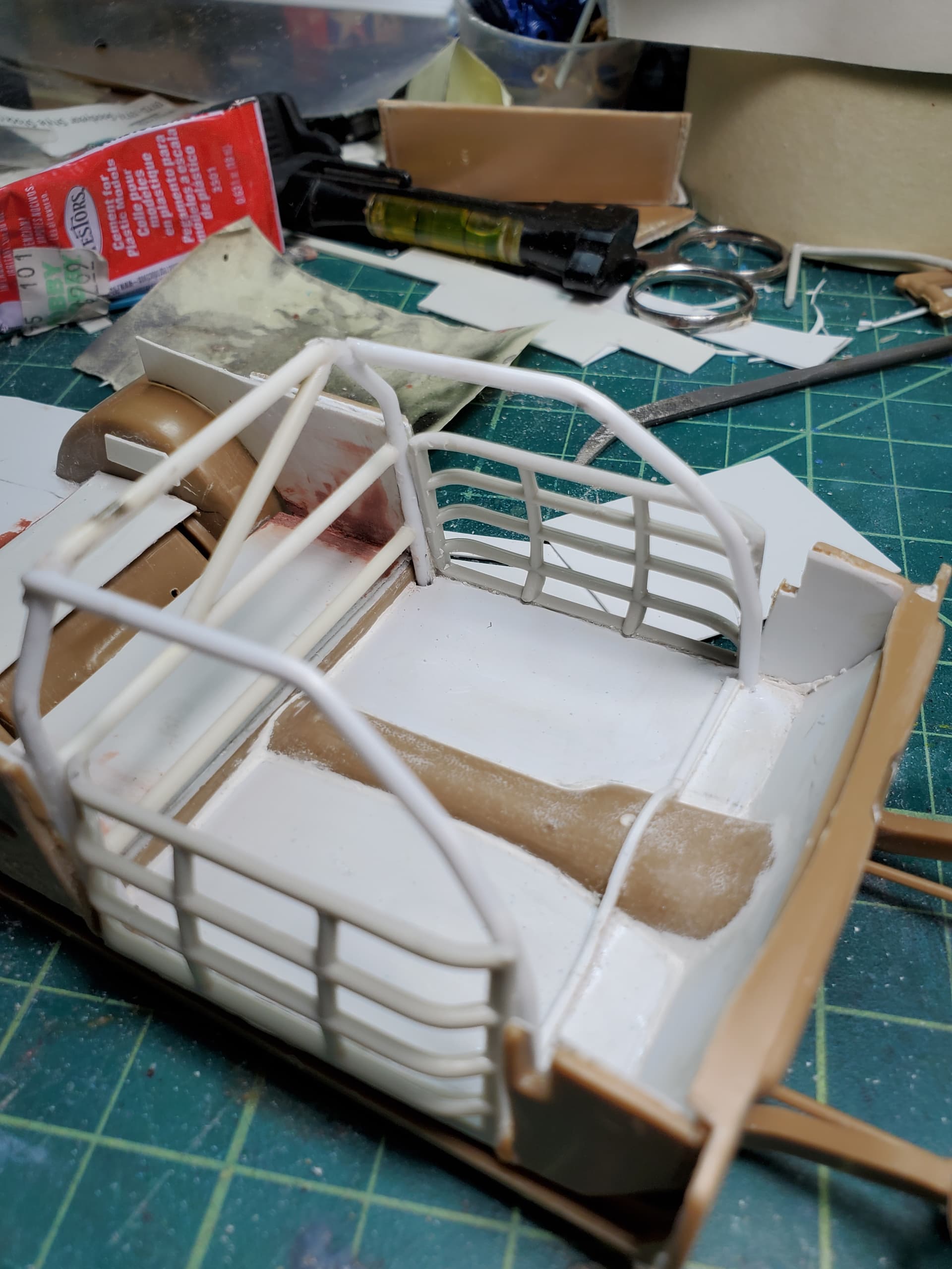

This will be a road track version. i had bought this years ago at the nnl east. it was just the primed body and an old monogram nascar chassis that was modified with rear leaf springs and front k frame and torsion bars added as you can see. the trunk was already cut open so i plan to detail it with a fuel cell. i quickly realized the chassis was not going to work, i didn’t like how the front suspension was lining up to the wheel wells. a friend also pointed out by this point most teams had done away with the k frames so i decided to use the chassis of the 68 road runner. i cut out the k frame except for the part that had the motor mounts.
I then started the interior and got this far before i noticed in my research the rear firewall was not correct and i had the side panels ready to be glued in when i also noticed the rollcage was not inside the panels but the panels were actually cut out to allow the bowed side bars to espaned out to the outer door skin.
so i had two choices, leave it as is or chop up my work and make the changes.i decided on the changes.

now for an update on the work. as i said i tore out the rear firewall pictured above and scratch built a new one that i think is closer to how the actual car was.the cage was scratch built except for the side bars, they came from an ertle nascar.

started the engine cage, scratch made some upper A frames so a pair of shocks can pass inside them and constructed some frame supports from plastic rod. they should be square tube but i don’t have any. got to put some on my to get list. also assembled the rear leaf springs and differential and added the shock mounts. here is where this part of the build is held up as referenced before i am not sure if the shocks mount to the underside or if i have to drill four holes in the chassis to allow the shocks to pass through to a bracket mounted inside over the area of the rear axle. it is difficult to find reference photos which is why i ask if anyone can help.
i also cut the front spindles off and re glued them higher to get the ride height lower.
