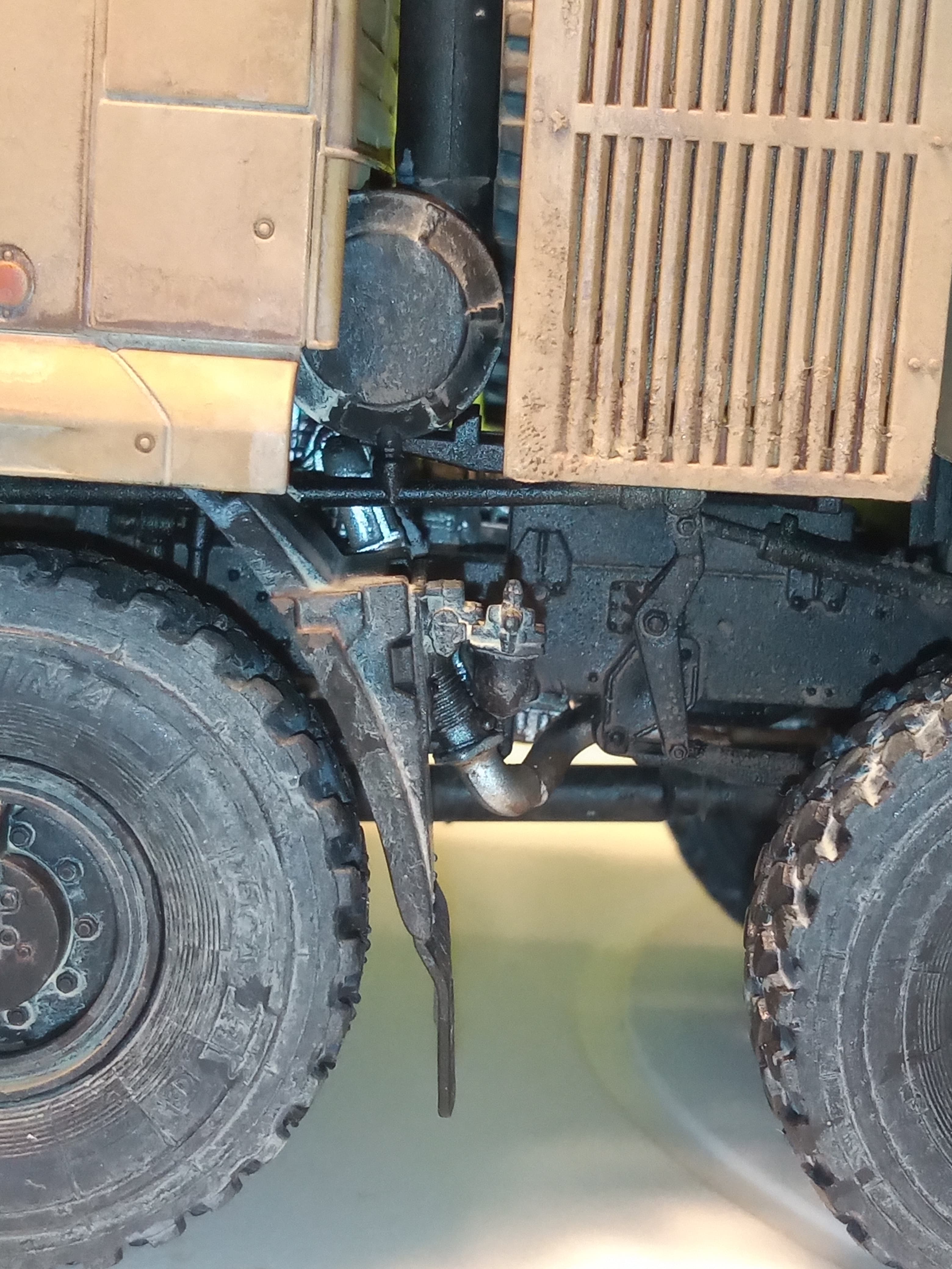

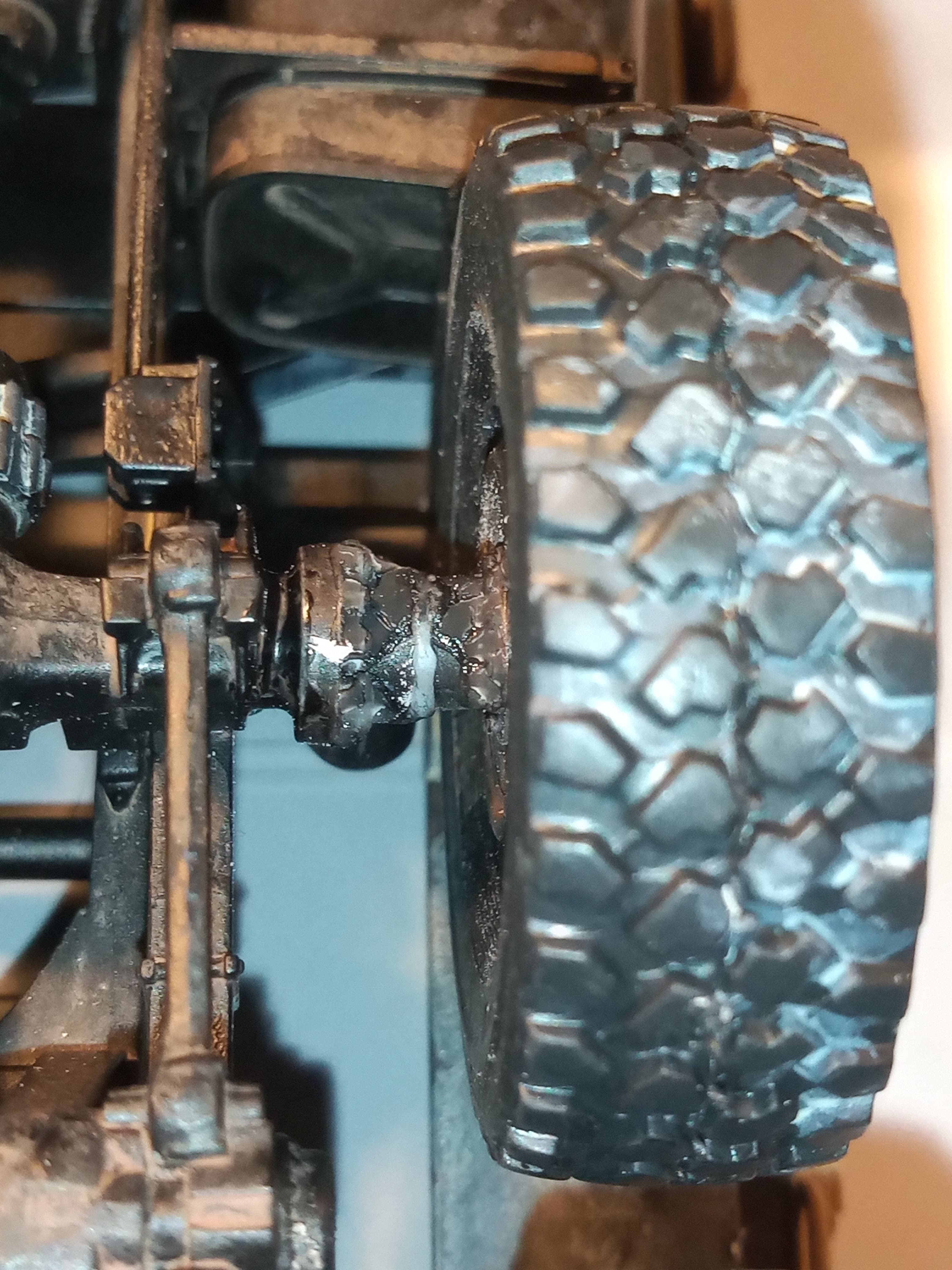

I did mention that issue during the build, but genuinely forgot about it till it snapped off. I agree though, you’d of thought manufacturers would suss onto the fact that’s a very weak area and tweak the connection somehow.
Decided to do the wheel. Knowing my luck, if I did wait till later I’d probably end up losing it someplace lol…
Holes drilled… And amazingly both central :grin:
Mixed a small amount of 2 part epoxy, and for the metal rod, used a 2mm steel nail cut down to about 12mm along the shaft. Filled both drilled holes with epoxy and then the length of nail into axle and offered up the wheel.
Thankfully, the wheel is in line with its mate and sits on the deck.
That’s the join, it isn’t pretty, but it works and can’t be seen. I have also given the whole outer join a thin coat of gorilla super glue gel.
Very happy and relieved that it went as well as it did …

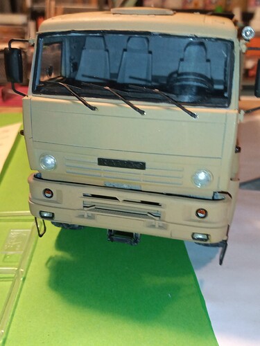

Windscreen wipers and front lenses are on.
Washes, streaking and a filter next.

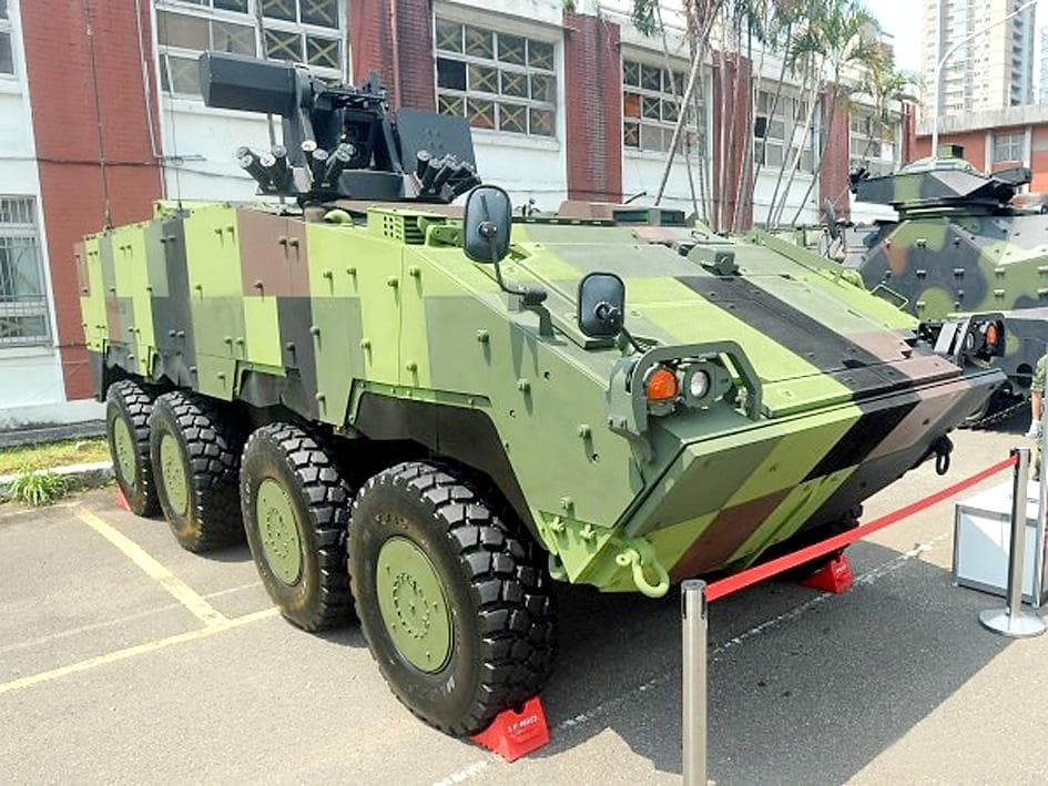

For my own entry I was thinking of something Russian but I’ve built a few of their 8x8 vehicles so I decided to opt for something a bit different. Meet the Republic of China’s CM-34 Clouded Leopard.
What drew me to this vehicle was partly the fact I’ve never built anything of the ROC’s military and I really like the camo scheme, a sort of woodland take on the Berlin Brigade scheme.

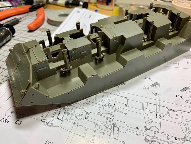

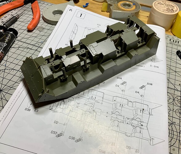

The build starts with the hull tub and mostly concerns the suspension assembly.
So far I would describe it as satisfyingly complex and there is plenty of nice detail.

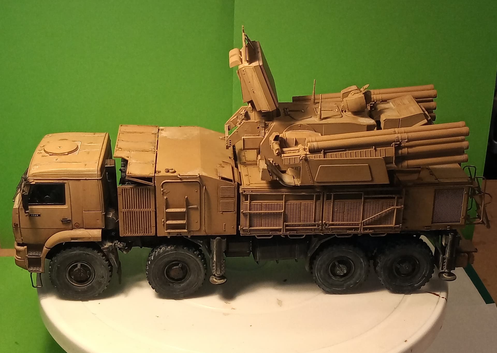

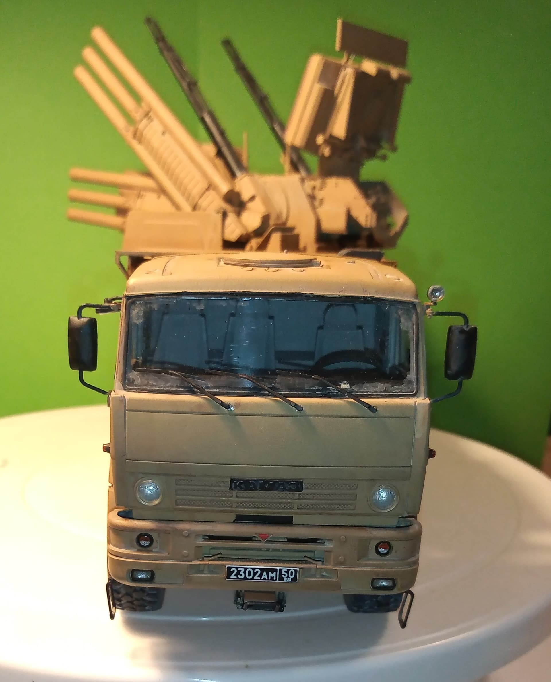

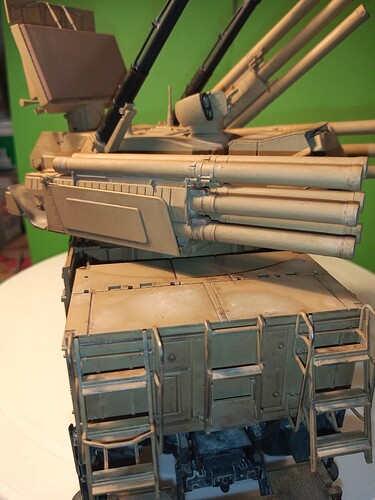

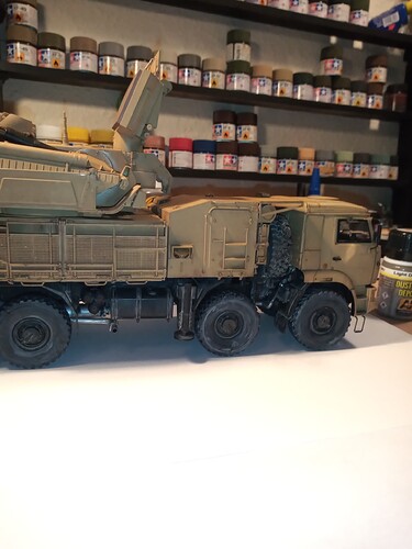

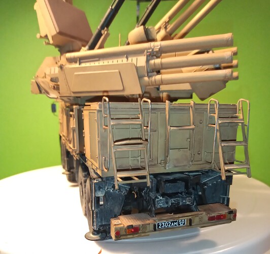

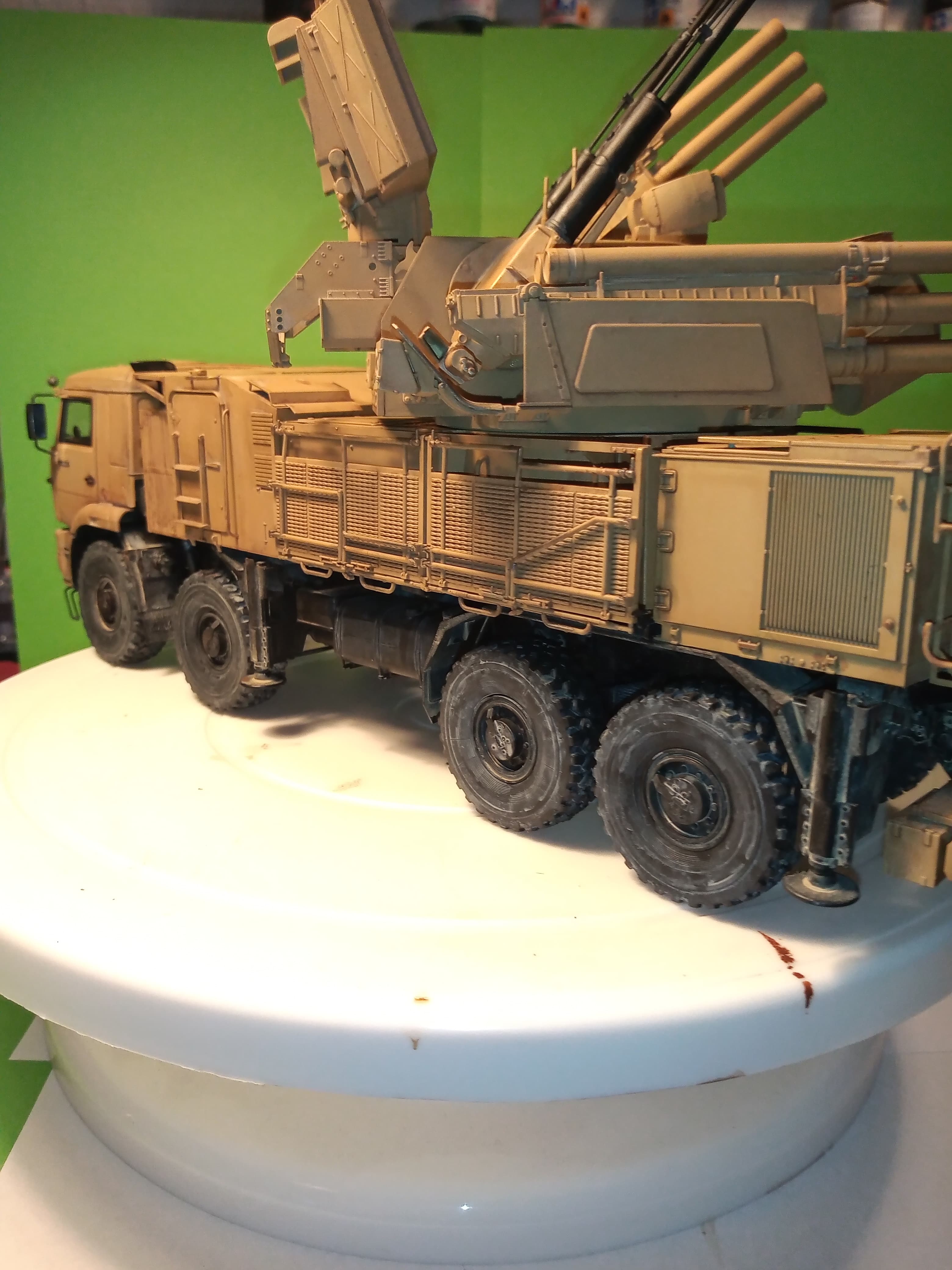

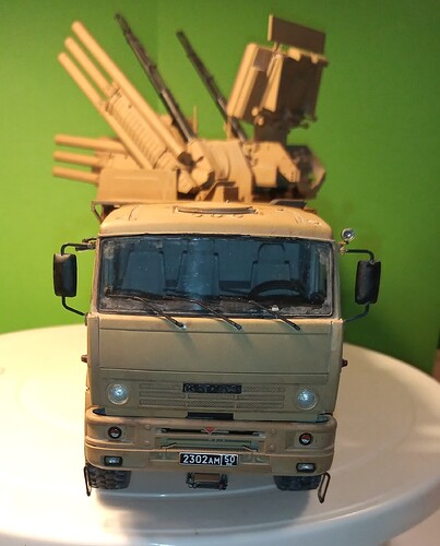

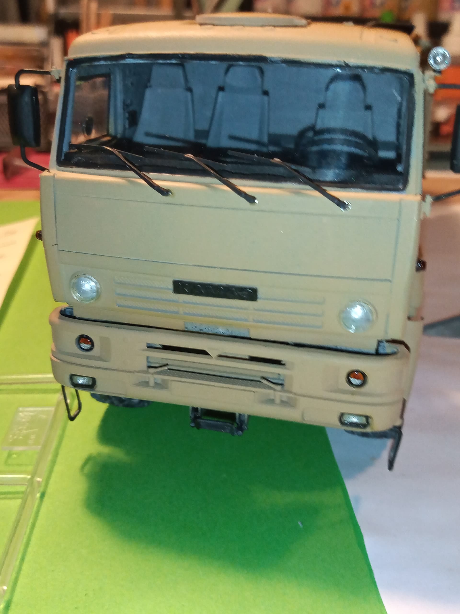

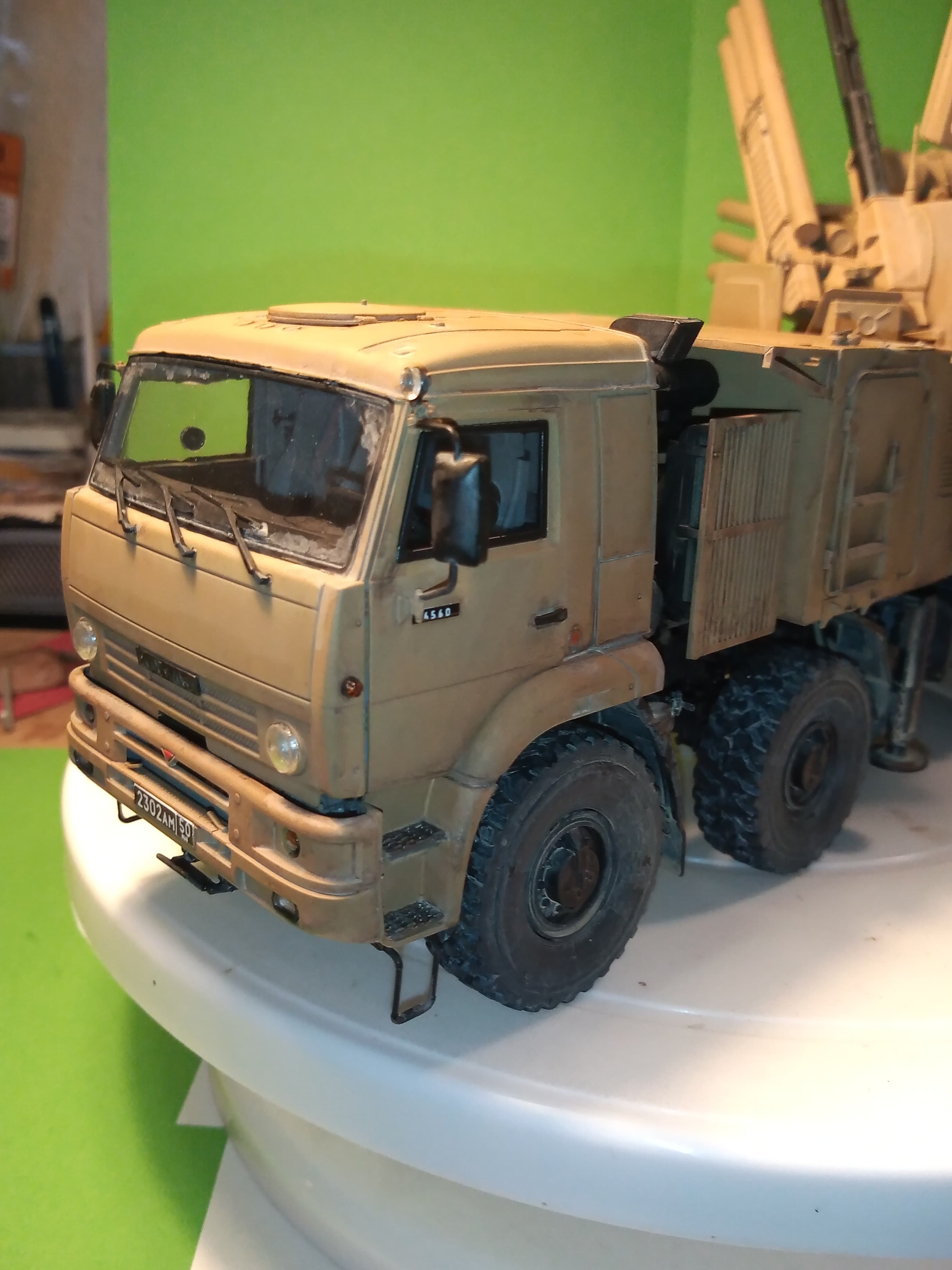

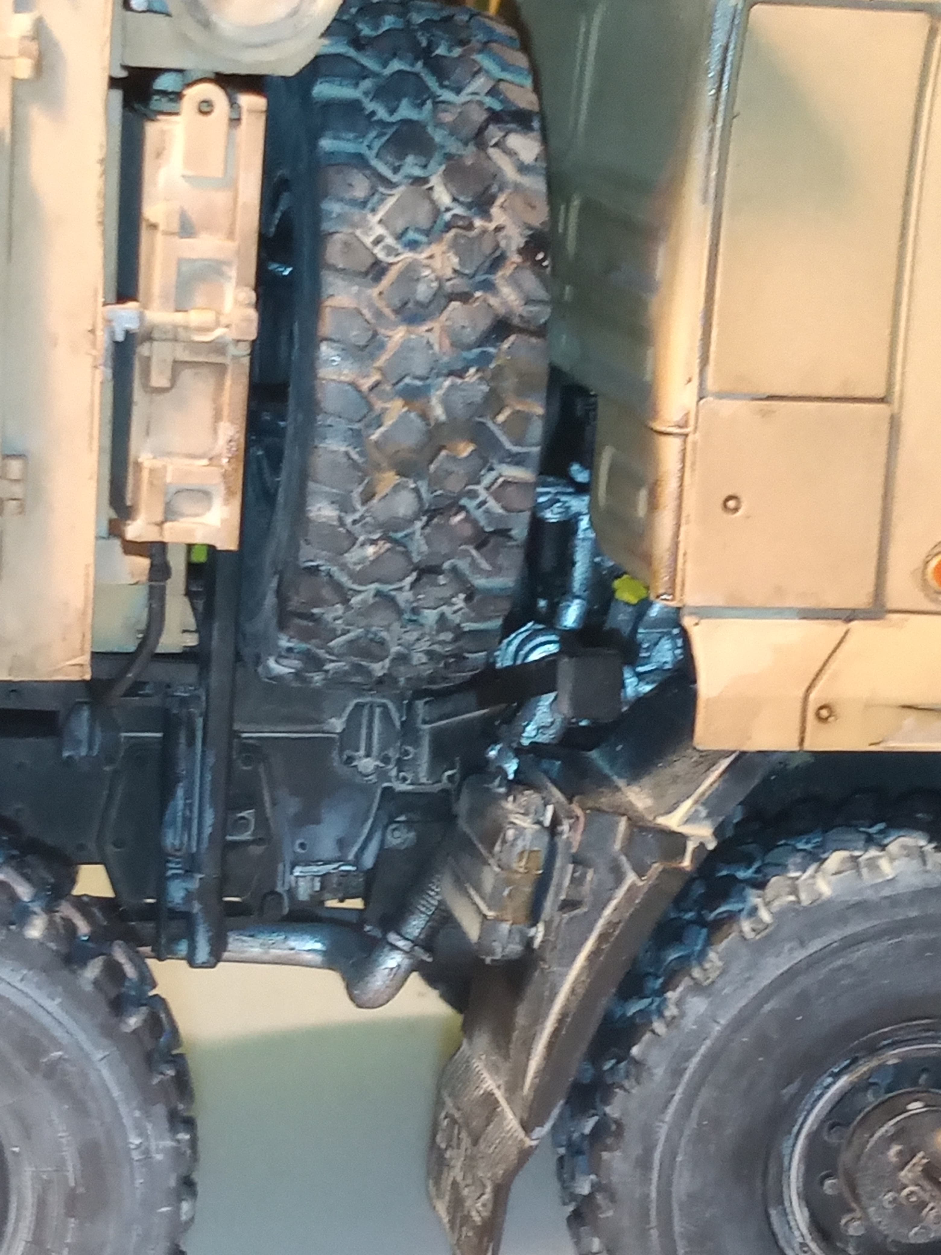

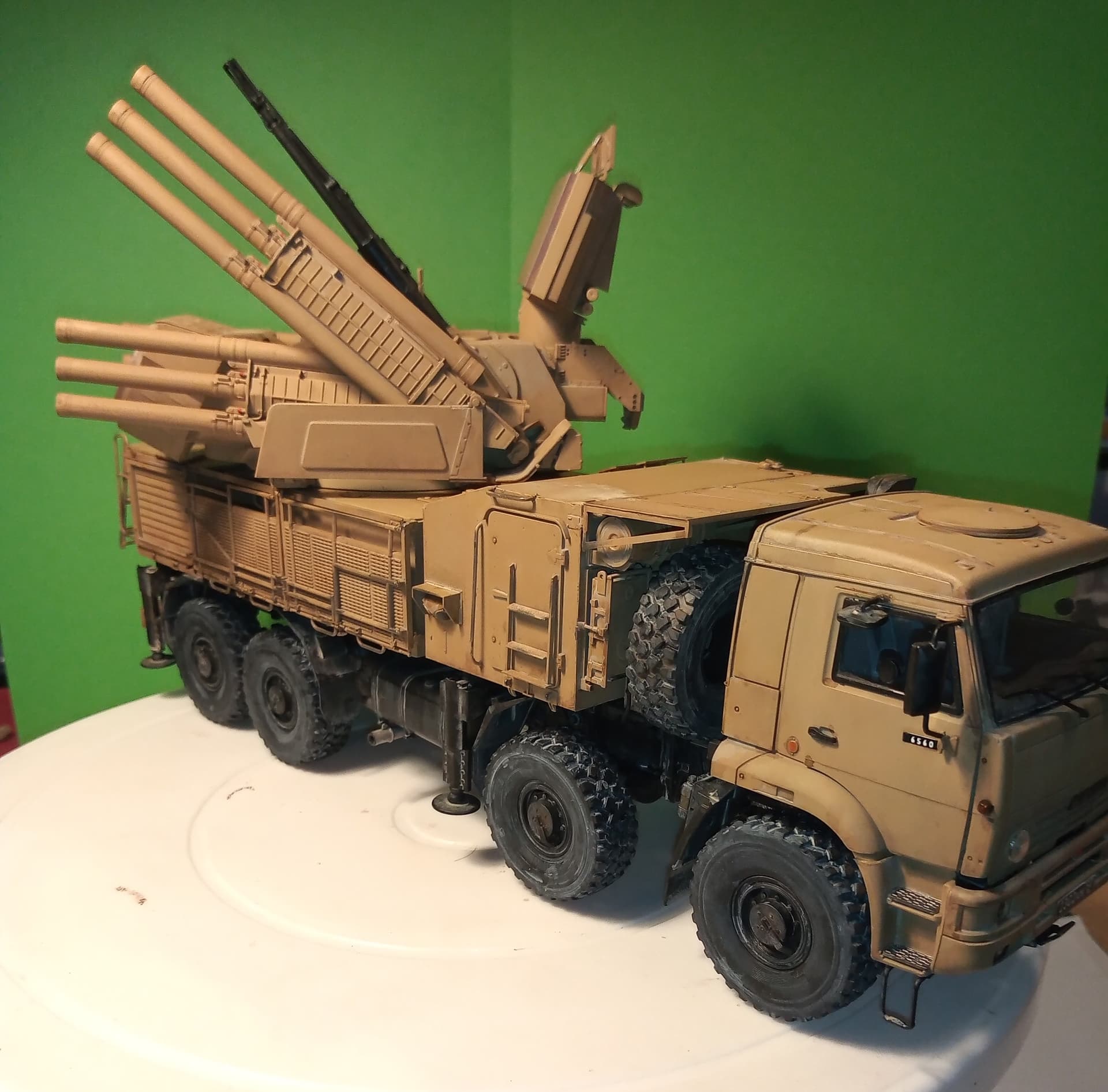

I have crossed the line with the epic Pantsir S1… What a kit. First modern Russian vehicle, and first Zvezda kit I’ve done since they apparently turned a corner with their manufacturing and begun turning out great kits. Which this one certainly was. There were a few issues, but some were down to me so it wouldn’t put me off getting this kit again or recommending it.
Decided on a good dusting and weathering, considering the conditions it would of been through in Syria.
All paints were Tamiya on this one, and all weathering, washes/filters were AK and some Vallejo steel pigments.
Really good build and very nicely detailed, sadly a really cool and super detailed engine and chassis is mostly hidden from view, but it looked impressive as it built up. This was straight out the box and it holds up very well without having any extras thrown at it … Any Q’s then ask away, if not … Enjoy :+1::+1:
Very cool looking 8-wheeler :slight_smile: Nice finish! Looking really good!
I have the same one on the way. Going to do it in winter-camo.
As for the THAAD, it got sidetracked a little. I’ll get it on course again next week :upside_down_face:
That’s the first time I’ve seen this vehicle in that color- very different to the usual green and catches the eye nicely. The weathering is spot on and it’s good to see all the details you’ve picked out.
Great finish John. This is the same camo I intend to apply to my own Pantsir when I paint mine some day.
@Karl187 I’ll follow your build with interest. I have the model by Freedom Model kits. It should be not far from the AFV Club one. I’ll be interested in your experience with the pre-cut masks for the camo.
Olivier
Such a beast of a thing. Ugly to boot. Might have to break down and get some type of massive Russian thing despite not having a place to put it. They just look so menacing. :+1: :+1:
Well that sure is a fantastic looking vehicle, love the color and weathering!
Fantastic finish John. It really will stand out amongst the collection.

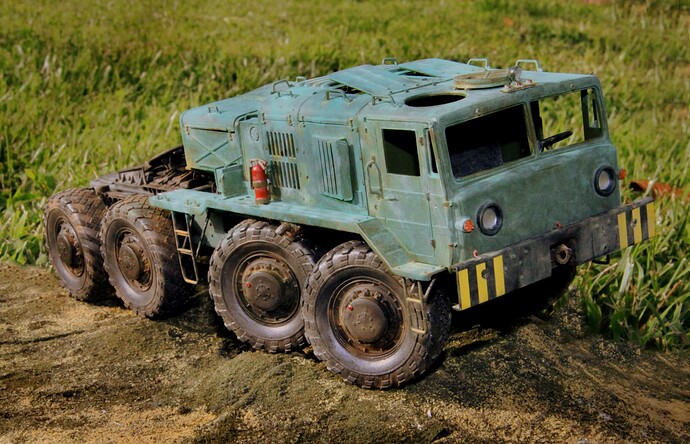

MAZ-537:

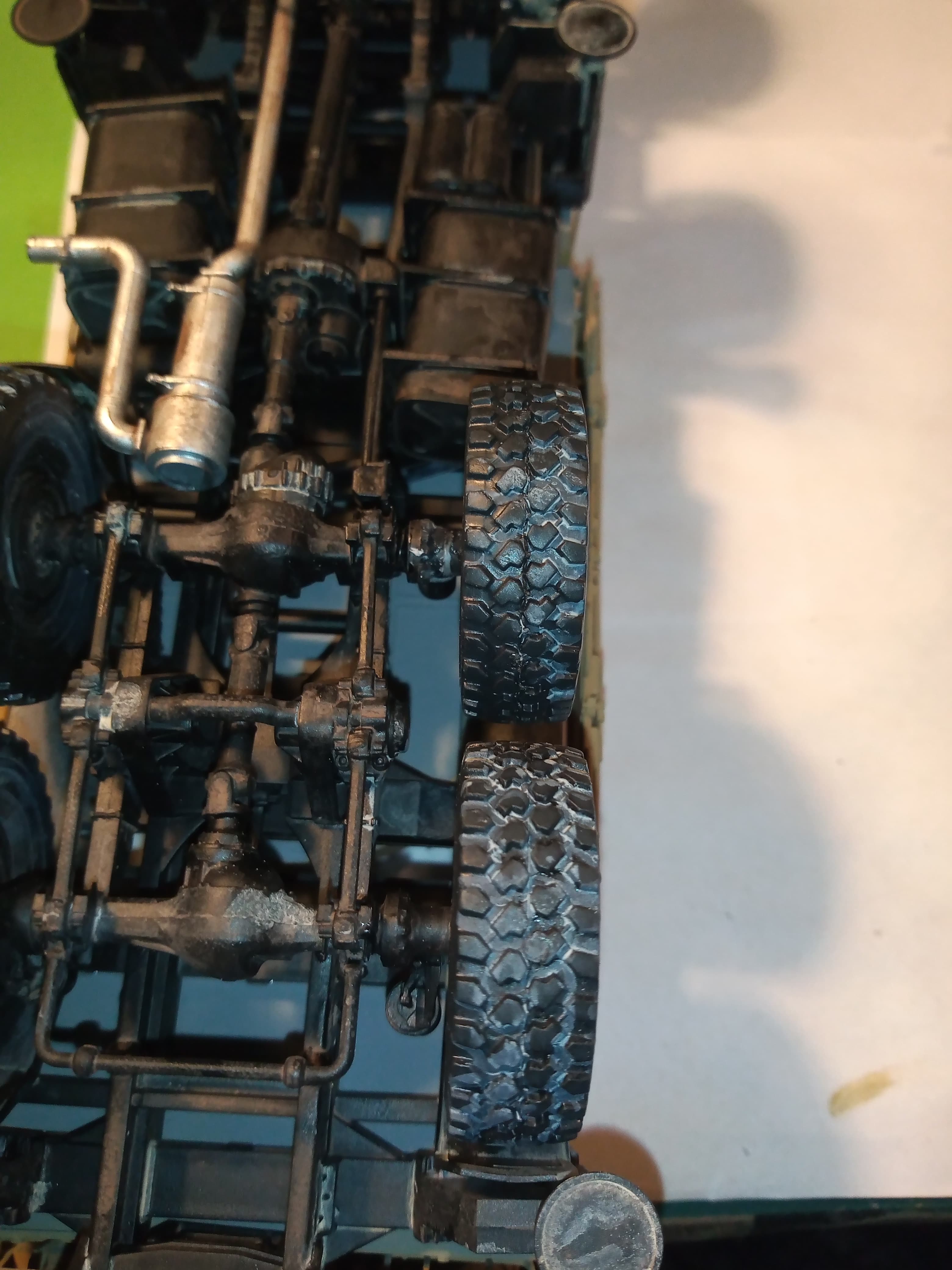

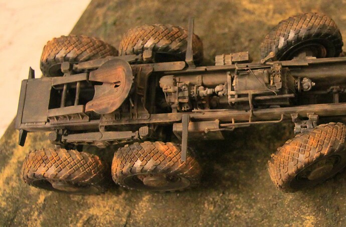

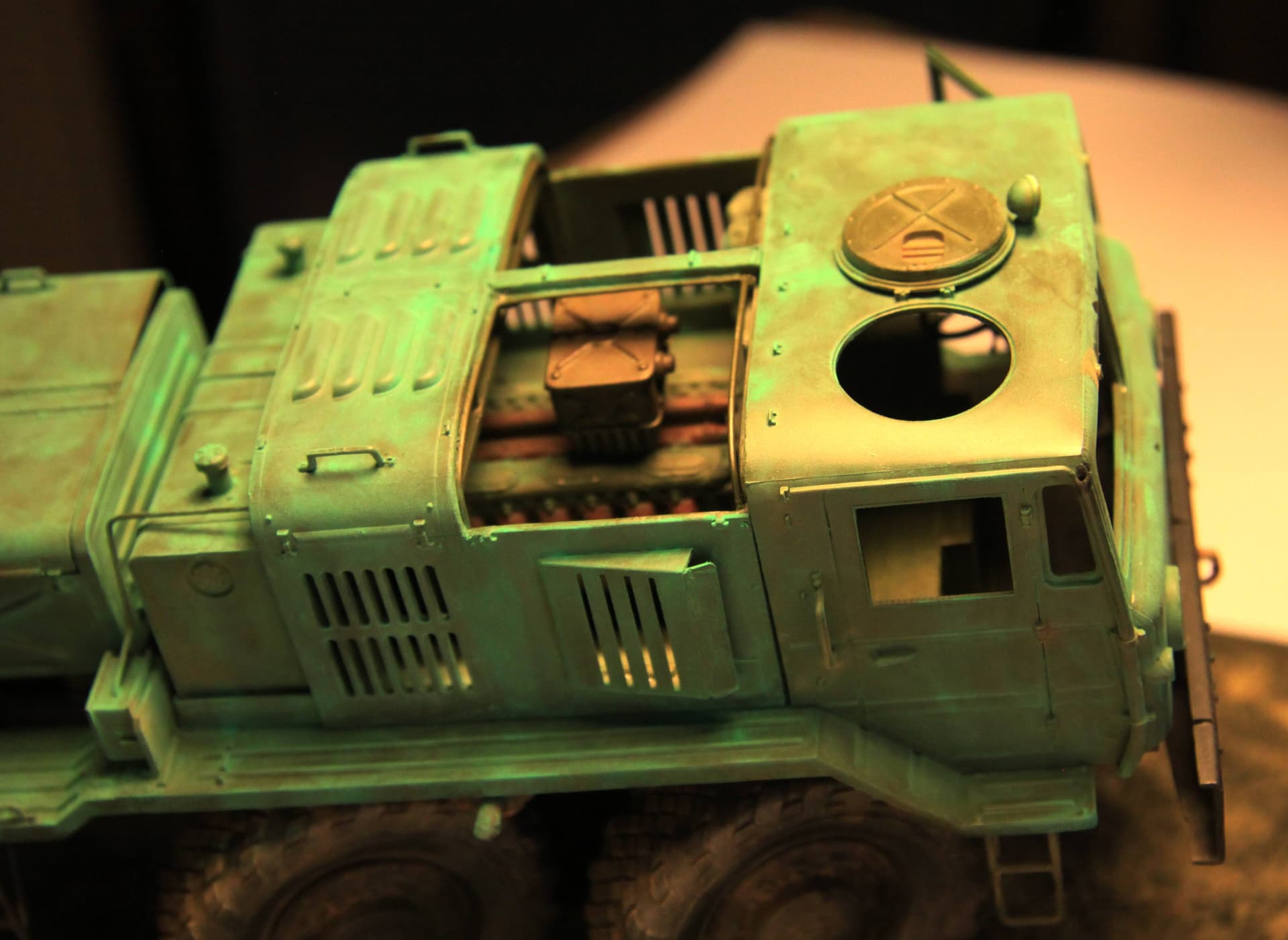

In all honesty while on the surface Trumpeter’s kit looks fairly well done if you look deeper you will find major flaws in the driveline mechanism and interior ~ plus NO ENGINE!
If built totally OOB the provided driveline could not/would not even function mechanically.
Scratch built transfer case and transmission:
Also the final drive gearboxes are missing completely from the stock kit!
All this is doubly sad in that all Trumpeter’s recently created series of new MAZ-543 8x8 kits have all these components present and these vehicles all use the same engine, transfer case, transmission and final drive line as the 537! (Only driveshaft lengths and exhaust pipping are different!)

On a few other points: The cab interior could use some improvements. The seats are incorrect, the rear cab wall is incorrect and even though you have the exhaust pipe for the auxiliary cab heater running up the outside of the cab there is no hint of it on the interior.
No bracing behind the front bumper:

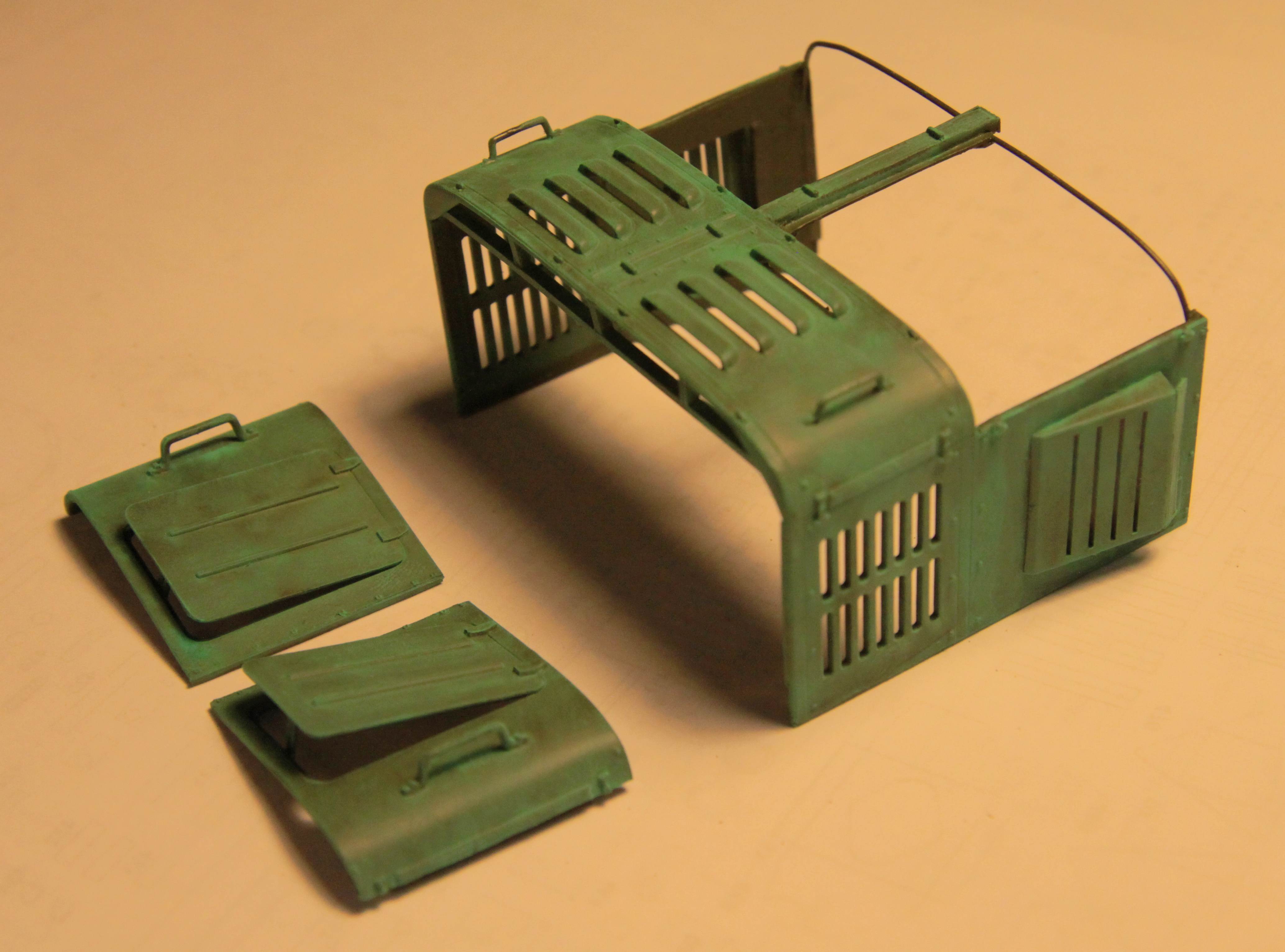

Incorrect bracing on the engine bonnet. (Only one very flat piece of PE included to represent this bracing.)
Not to mention that you can look in just above the gas tanks and clearly see THERE IS NO ENGINE!

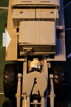

My model with the winch housing installed:
I made mine removable so the driveline could be more visible when desired
Trumpeter even fails to include the small driveshaft that connects the PTO on the transfer case to the winch mechanism above.

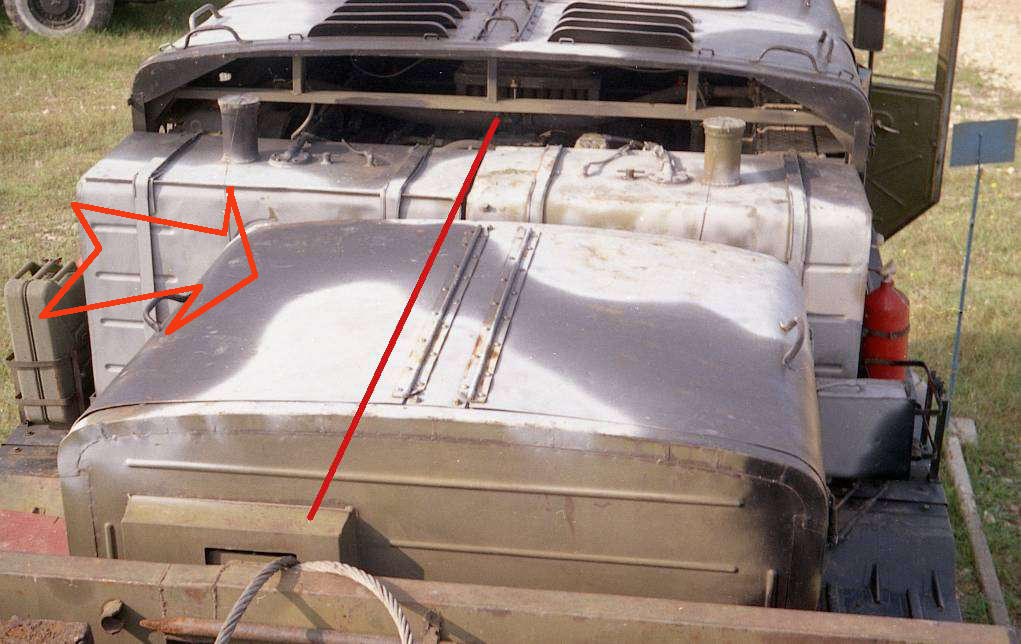

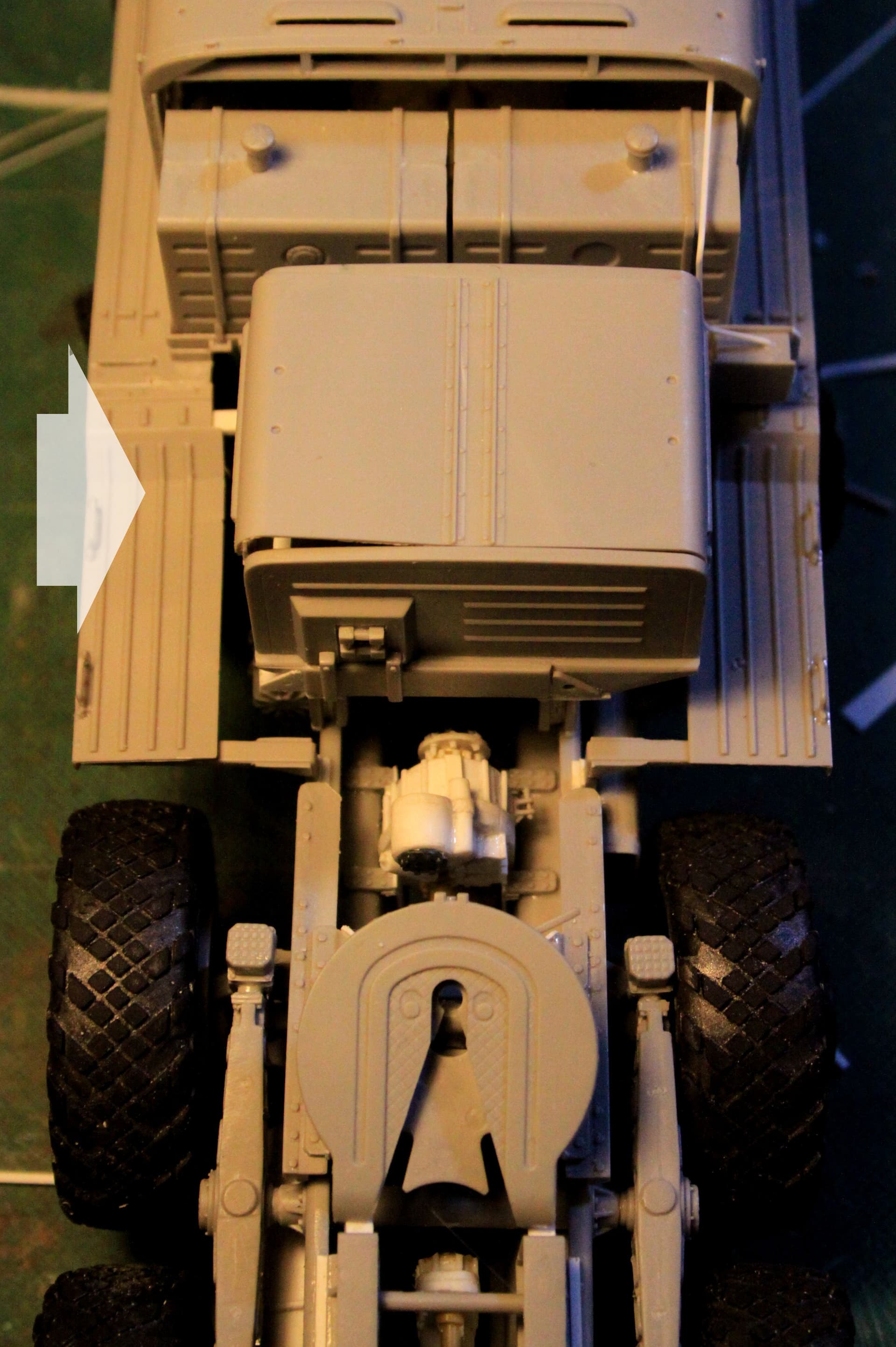

While on the subject of the winch: Trumpeter places their winch on the centerline of the vehicle when in reality it should be off-set to the right side.

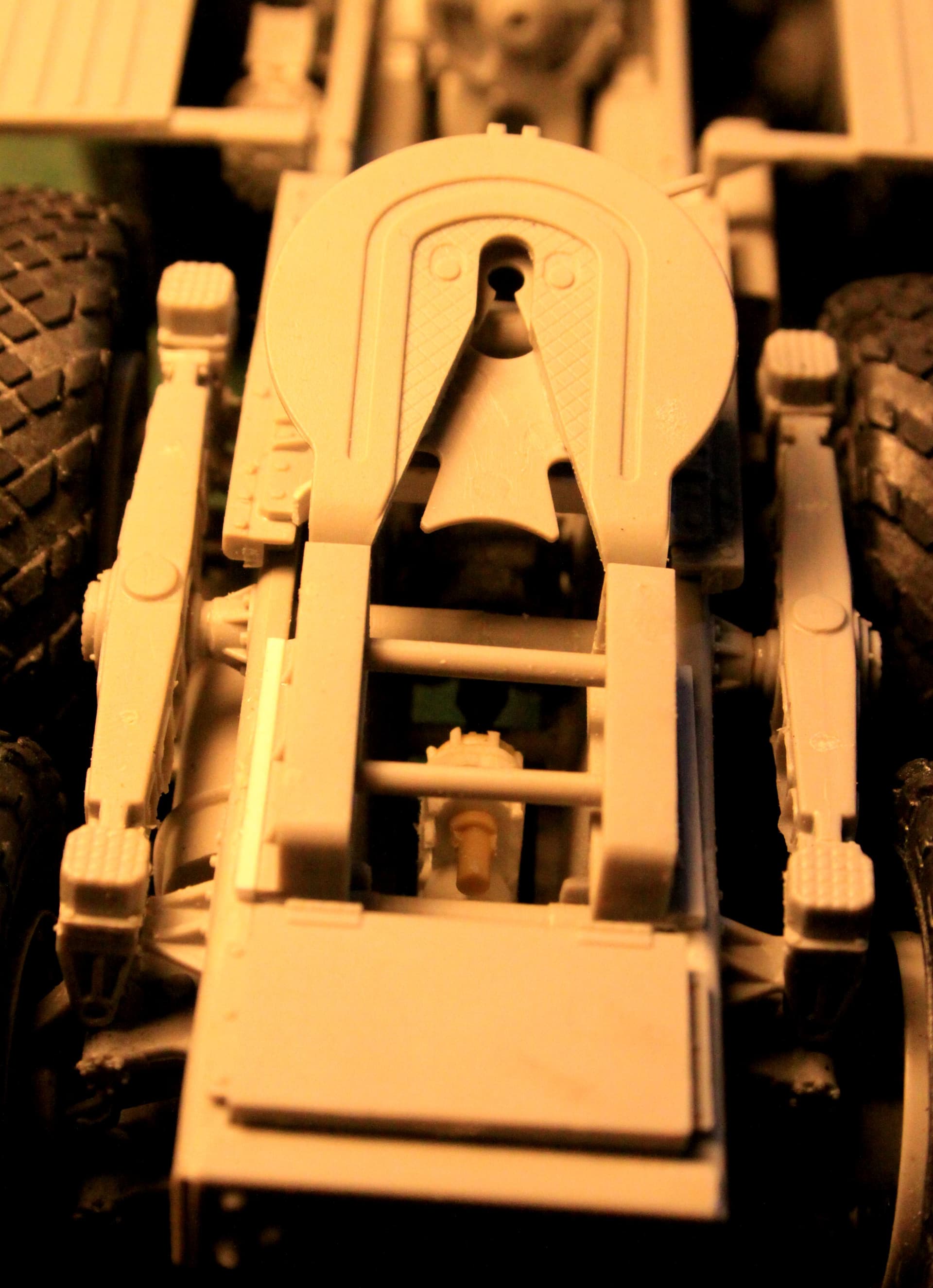

The trailer run up ramps are set too wide. They should align perfectly with the rear fingers of the fifth wheel: (This is still wrong on their current day offerings.)
Run up ramps are also missing the small fifth wheel rests
Seen below with the rests installed:
Shown here without the rests; the fifth wheel should never be angled like this!
