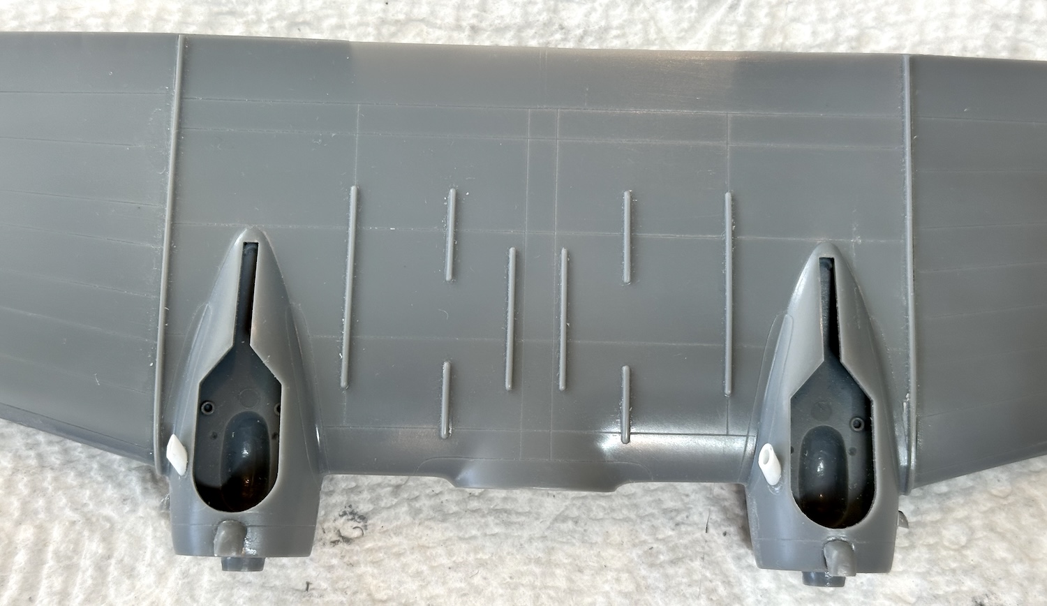

While working on the Airfix DC-3 conversion I have been poking around with the MPM DC-2 kit and decided that building it concurrently with the DC-3 made sense. The cowlings on the DC-2 will be useful for modifying the B-17 cowlings to be used on that conversion.
The MPM kit is surprisingly good! It is actually better than the new tool Airfix kit in a number of ways. Where Airfix has huge troughs for the panel lines, MPM has restrained detail that is much more realistic. The downside of this is that it is easily sanded off . . .
The cockpit to is better with a very nice instrument panel, not that much of this will be visible once closed up.
The fit is not as nice and does require more work, but not hugely so. The propellors are build’em yerself types, we’ll see how they come out.
Oddly, there are no exhausts in the kit! The locations where they should be are scribed into the plastic but it’s almost like somebody forgot to actually build them.
Here is the DC-3 fuselage in front of the DC-2.

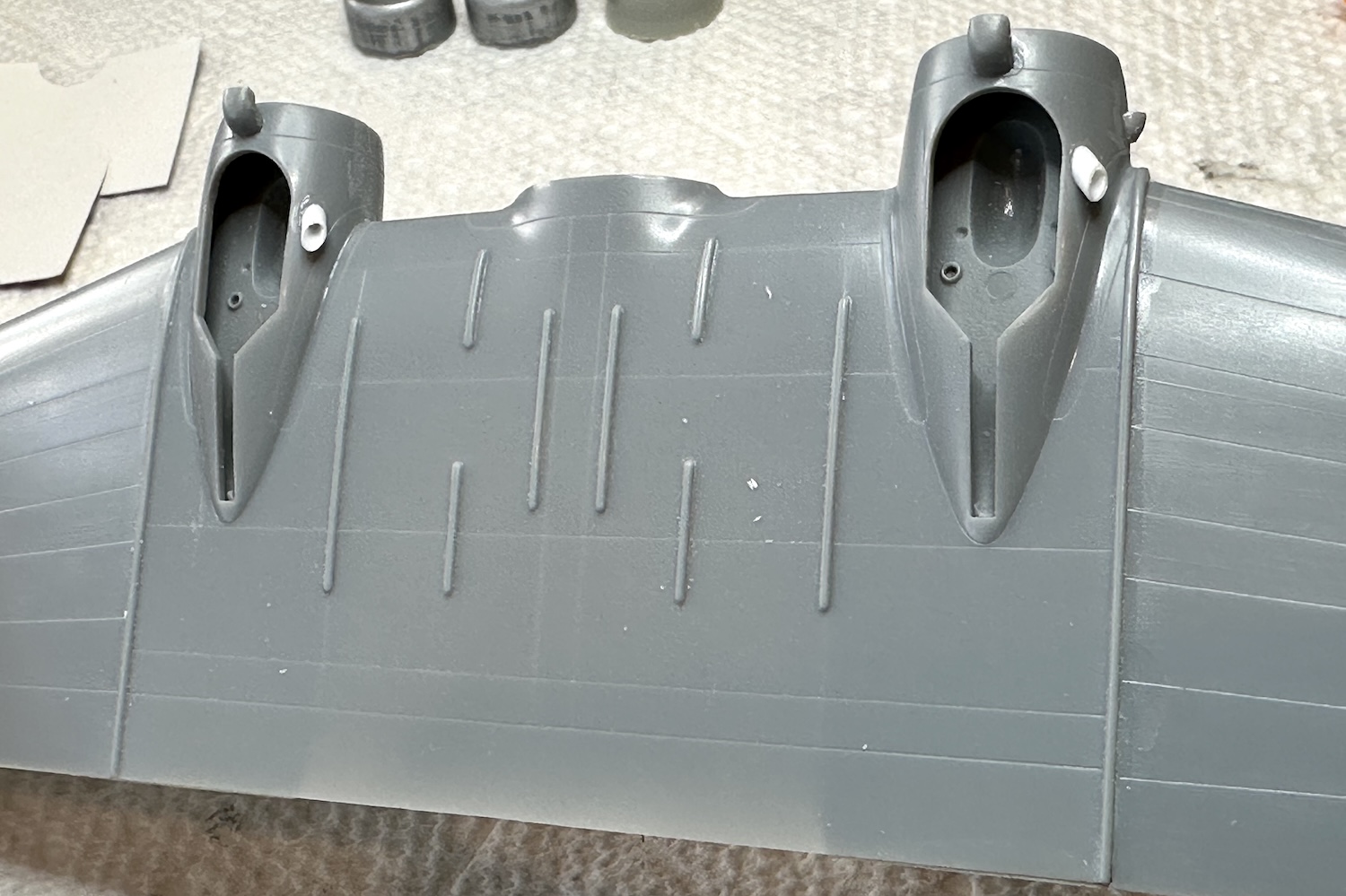

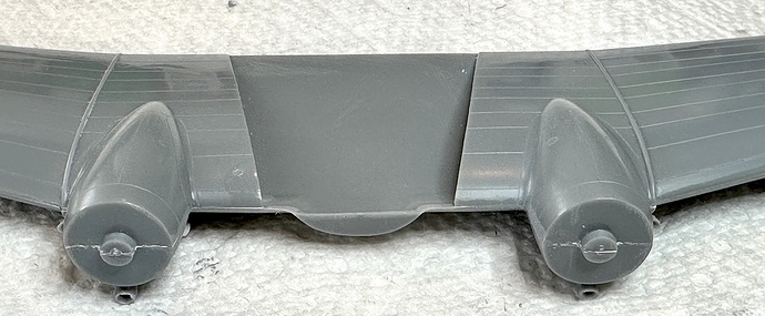

A bit more done on the MPM DC-2. The intakes were all solid blocks in the kit so I drilled them out and refined to cavities with a No. 11. Next will be a bit more smoothing with a small file.
The new exhaust pipes are shown in some of the pics.

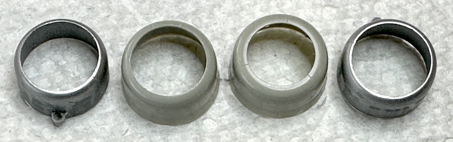

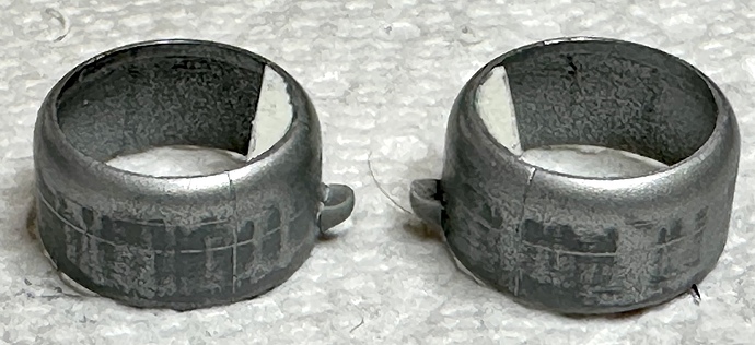

The DC-2 cowlings are a blessing for the DC-3 conversion. You may remember that I had robbed a spare set of B-17C cowlings from tha Academy kit. These needed to be opened up in the front and the DC-2 parts were a useful guide to this job. Next the cooling gills will need to be removed and replaced by a piece of plastic card.
With the B-17 cowls opened up it was time to make an upper lip for both the DC-2 & DC-3. These were deemed useful by Douglas to impeded the reverse flow of hot air out of the cowls and into the carb air intake just above. Not all birds had these but many had them from the factory and others may have been retrofitted. As far as I can determine, all or nearly all of the Wright engined DC-3s did have them. The pics show the DC-2 units ready for a bit iof putty & sanding to shape.
Paul
The two outer cowlings are the DC-2 units, the two inner ones are the B-17 units one of which has already been opened up.
These are DC-2 cowls with the plastic card lips installed.
