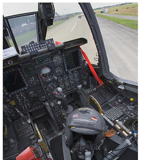

I thought most modern cockpits are black for NVG use, do you have different information for this bird?
No, I haven’t. In fact Iwas looking for some pics yesterday but with the mobile. I just could read at ARC forums that is Gull grey, but no pictures to check it. I’ll search a bit more before painting the cockpit.
Thanks for the appointment, Ryan
Edit:
It looks like it’s grey
Even in the newest versions:
I saw this for the A-10C which is why I asked.
I may still have the Reid Air A-10 book around here some place. I will look this weekend for it.
I looked in Reid Air A-10 Modern Hog 2nd Edition and every cockpit shot they show is a grey pit.
Well there you go….going back to the shadows again.
Nah. Stay topside! The cockpits are all grey in the book, but with the shadows on some they look pretty dark.
I will still be following just not commenting as much on this one as my perspective appears to be off and don’t want to give bad information.
Ryan, any info is always welcome. You made me look for the info, so as I say, it’s good for the hobby.
