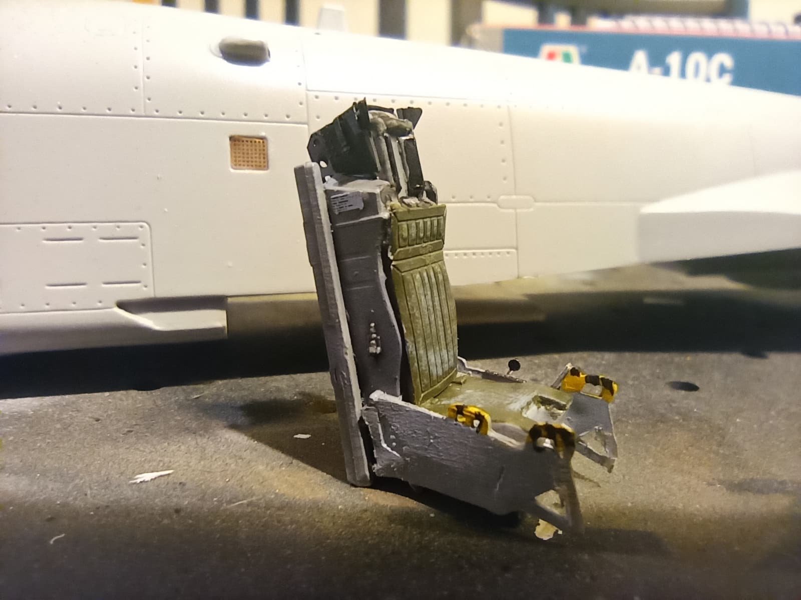

I’m slow lately with the ‘Hog’ so I just could make the ejection seat and begin with the ‘driver’.
The pilot’s right arm was remaked to change it to a salute pose. I also had to cut the head and turn it left.
I’ll try to begin tomorrow with the painting. I’m going to paint the flight suit in desert yellow.
Cheers!!!
