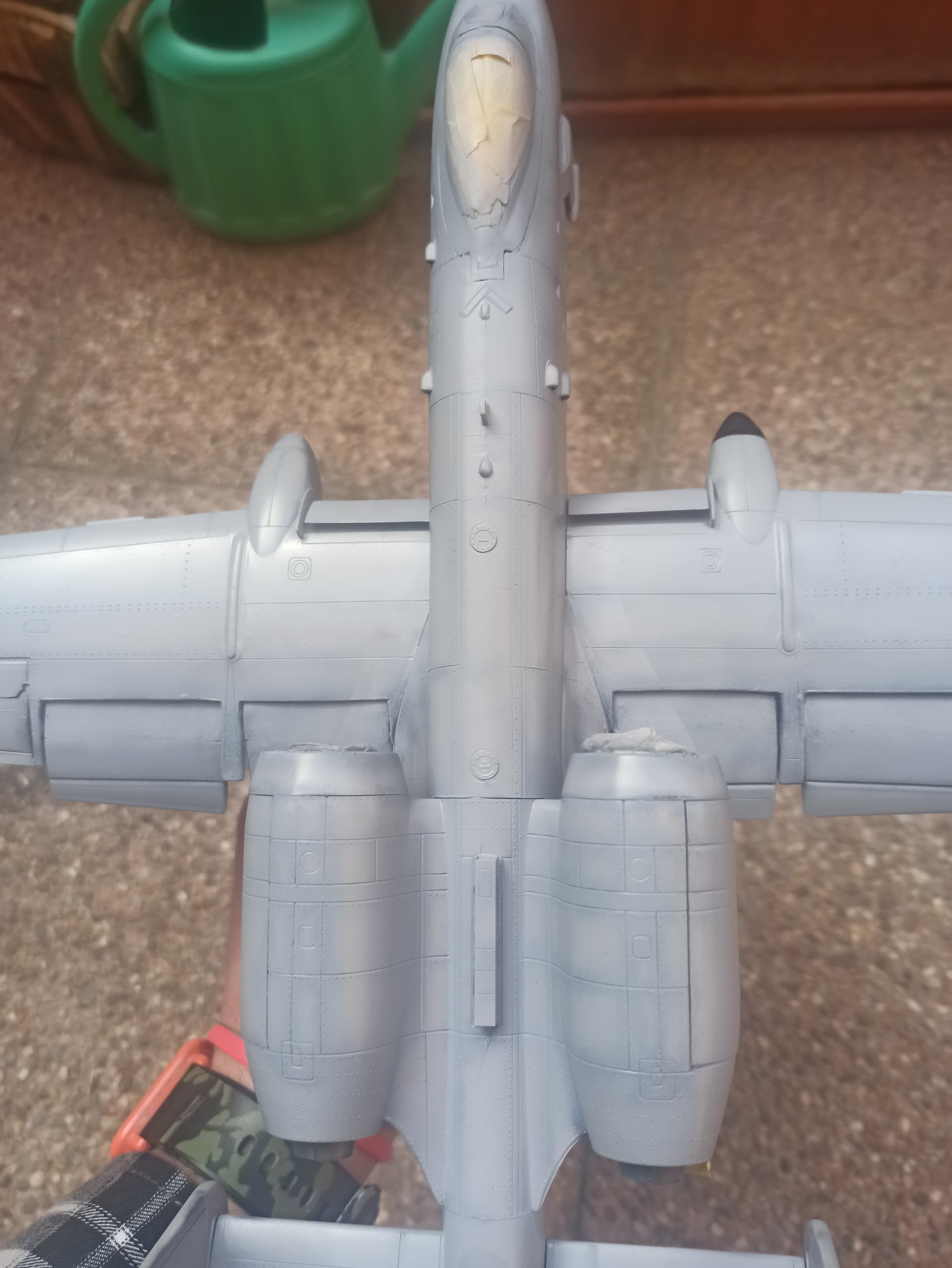

I was up to airbrush the glossy coat when I realized about that
The putty from the scratched flaps was not very well sanded, and I didn’t see it when primmed. But the gray paint showed the fault. So after many tries without success, I finally could solve it and leave a better surface before spraying the gloss coat.
I also took advantage for contrast both greys, mainly in the wing’s roots and in the engine’s cowls.
And that’s all for the week. Next, the decals and begin with the filters.

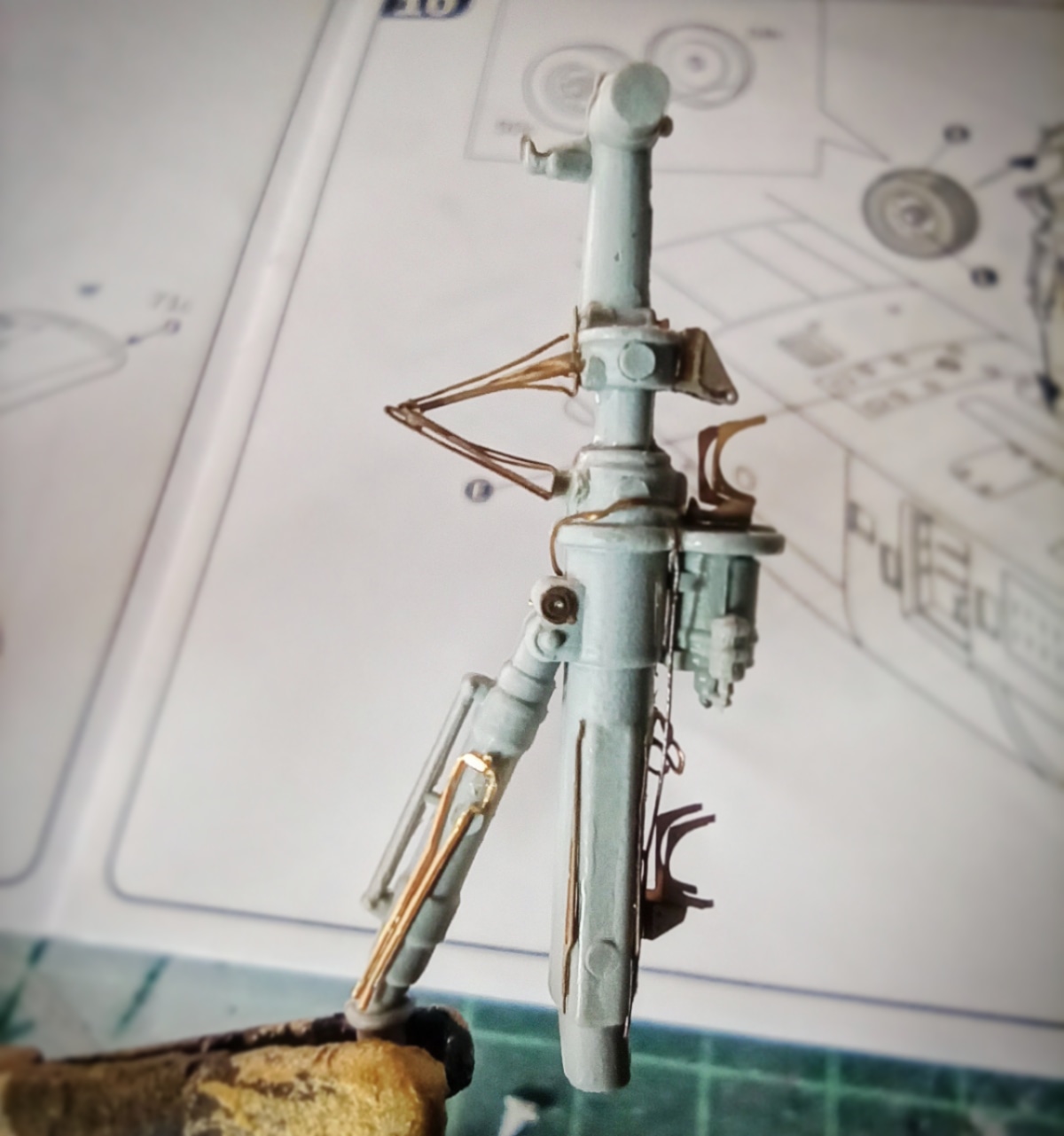

I’ve been making some advances in the ‘Hog’. The landing gear’s legs and some oils on them.
The front leg took me all the sunday morning due to the PE parts.
I’m not sure if the result deserves all the time employed.

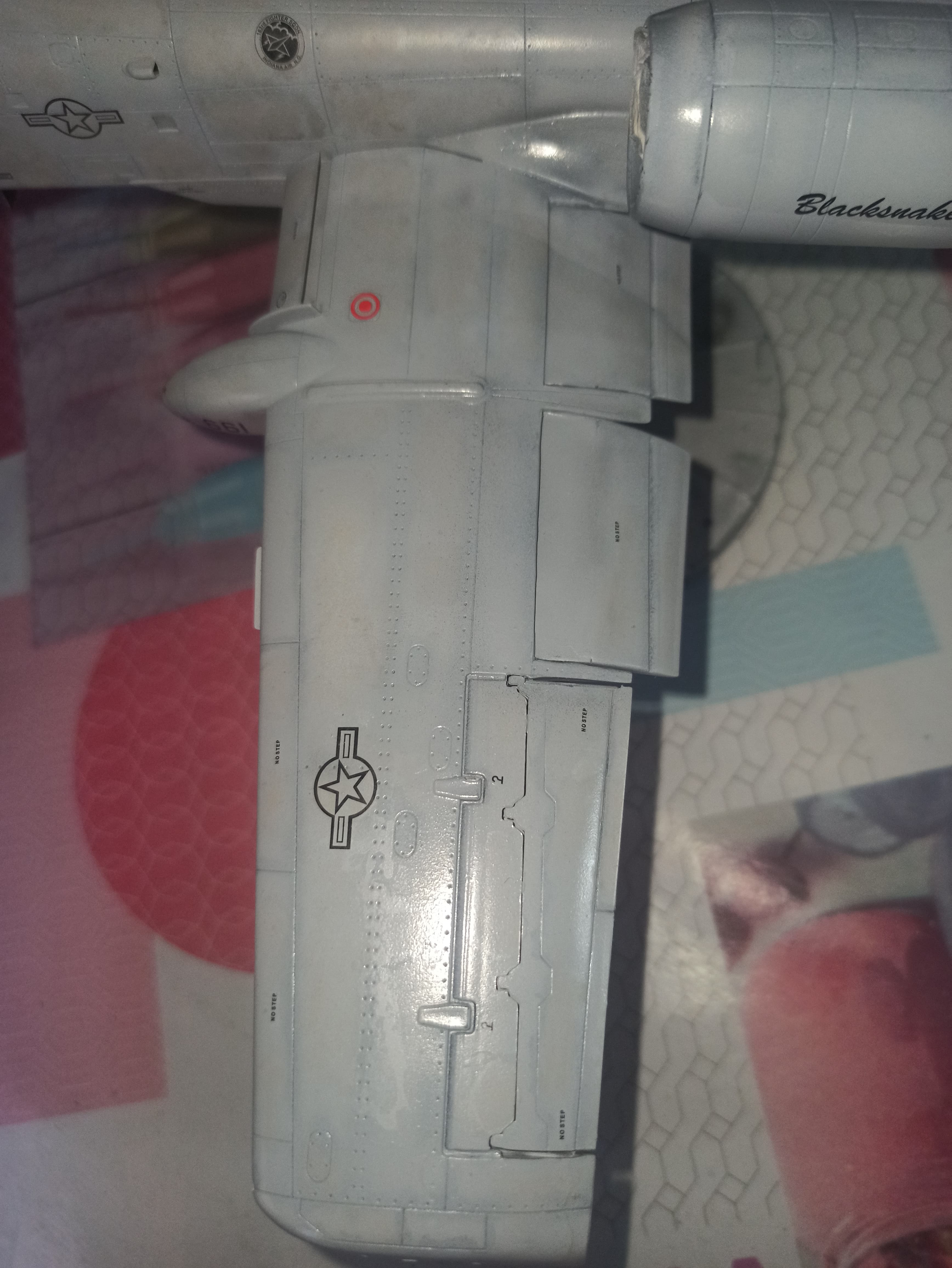

First attemp with the Ammo filters. It’s nee for me, never used before, despite this techique has around 20yo. For this A-10 I’m going to use these two colors
The grey to white doesn’t make too much contrast, at least with artificial light. The brown looks better. Two pictures of what I’ve done by now.
I can’t get a good shot of the wing, so it appears to be ‘just gray’
Thanks for looking!

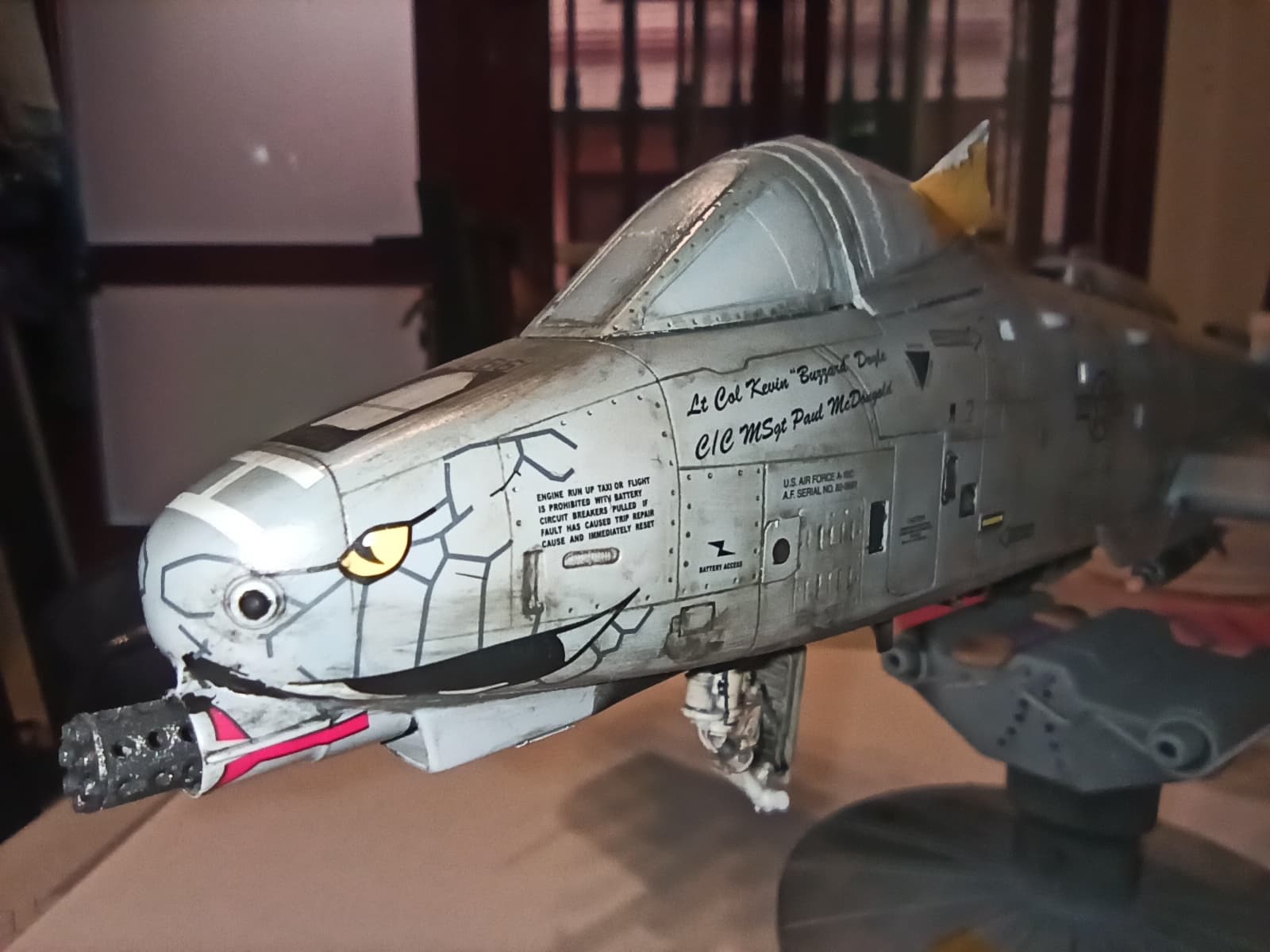

Hi all!!!
It was weathering weekend. The idea is a well used Hog during OEF in A’stan. So I’ve been generous with the oils. There’s time to make changes yet, so if you think there are things to change, let me know.
Processing: IMG_20220515_183418.jpg…
Thanks for watching!!
