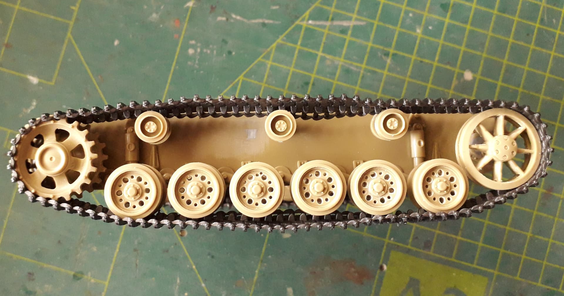

Tracks are temporarily in place and I hope the worst of the deformation will easy out. When turning the wheels, much of it does indeed level out.

I’m wondering if gently heating those tracks with a hair dryer would enable you to straighten them out.
Or a bath in hot water.

I built one of these as a kid, motorized version. Loved it! It should work well for you. As pointed out above, a little heat will help with the tracks, or if you want you can go with some after market ones.

I tried that once. Ended in disaster.

After market would defy the purpose of this build and write up.

Yep, just throwing out options. The tracks should work out just fine. I always liked Tamiya’s vinyl tracks, way better than others, like Monogram or Nichimo.

Call me crazy, but I’ve always found Tamiya vinyl tracks to come out just fine after some good paint and weathering!
