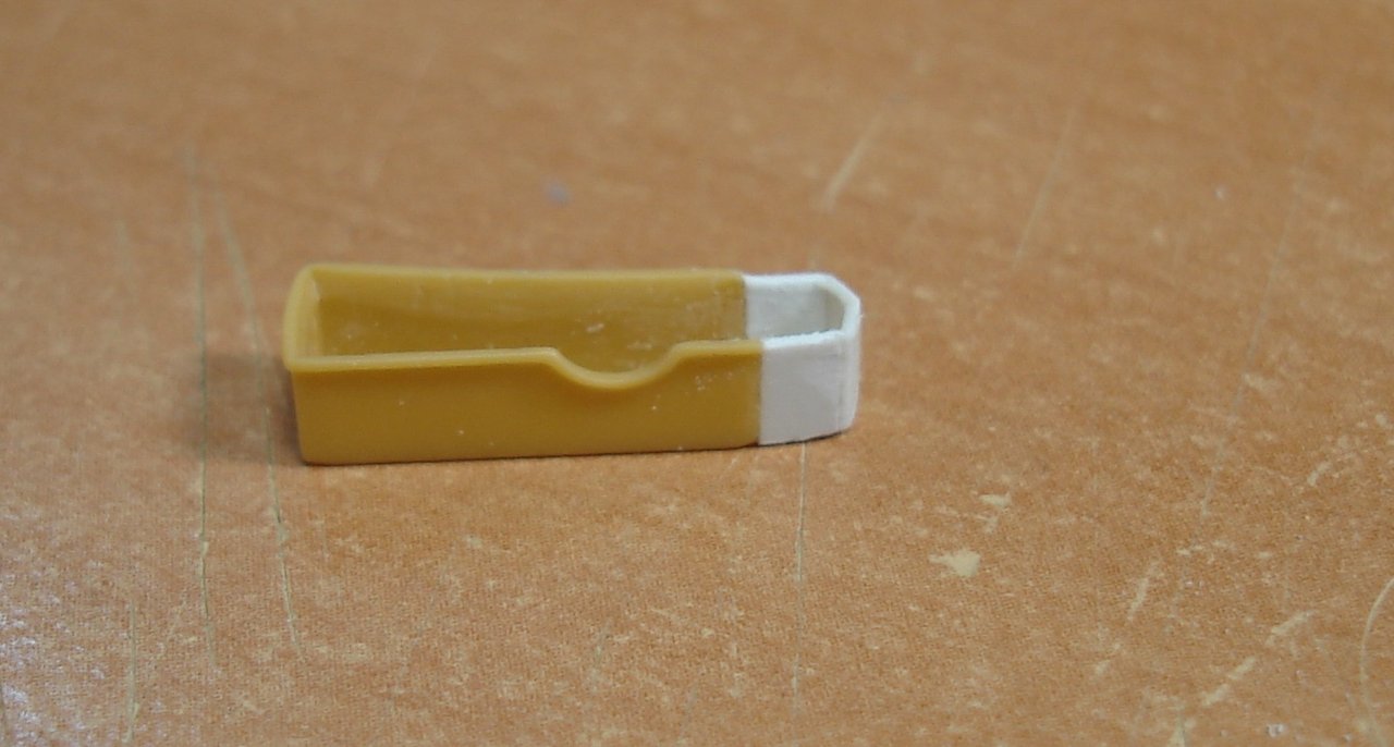

As I understood. This is a shell case extractor.

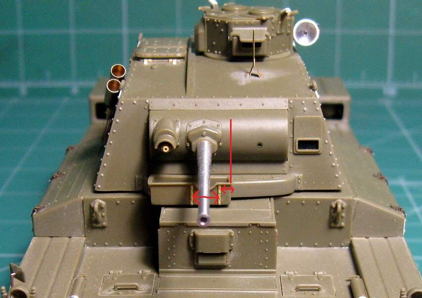

Some big problems with ammo shells box. Too narrow on a model. You may see it on the pictures. Holders with rivets are too close to each other. Pay attention that I have moved the main gun and machine gun on my model on a right. So if we want to save the proportions we should increase the box on it’s length. Also we need to make the holders on both sides and on a bottom because they are one piece.
After all I did it but with some assumptions. Unfortunately MK doesn’t have rivets less than 0,4mm.
