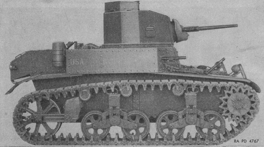

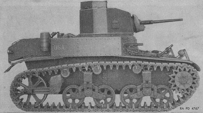

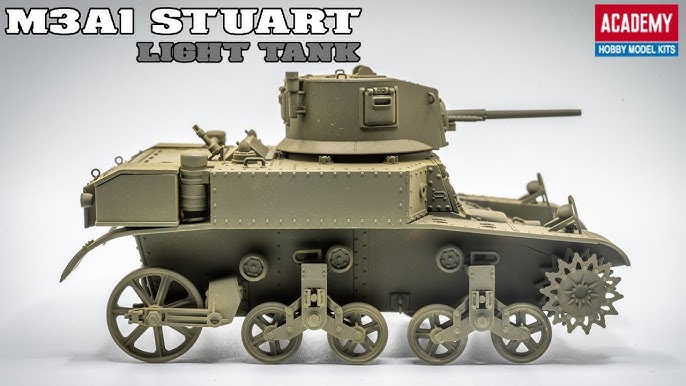

You’re aware that the suspension is incorrect, right? The angles of the suspension arms are too steep, and because Academy did notice the lower edge is horizontal under normal conditions, they made the whole arms an incorrect shape. Compare:
The kit has a number of issues. Note the difference in Jakko’s two photos where the fenders attach to the hull sponsons. The biggest miss was that they never grasped that the M3A1 had the formed, one-piece rear upper hull. I think, in many minds, that the round homogeneous turret equals M3A1 but there were as many as 2400 M3s built with that turret. That underlying assumption, along with the surviving and well-documented M3A1 prototype that was a modified M3, has led to a lot of confusion.

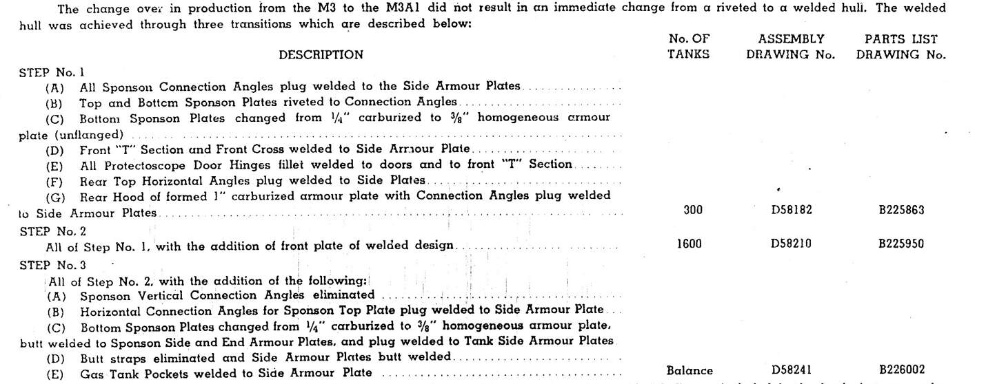

The upper and lower hull construction methods seemed to be on separate evolutionary paths. Even after M3A1 production started there was still a transition process:

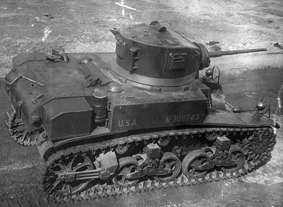

Here’s an M3A1 with welded sponsons and a riveted lower hull:
The tank in your photo (Do you have an overall shot or information that could identify it?) shows Step 3.D in the listing above, incorporated after about 1900 M3A1s had been produced.

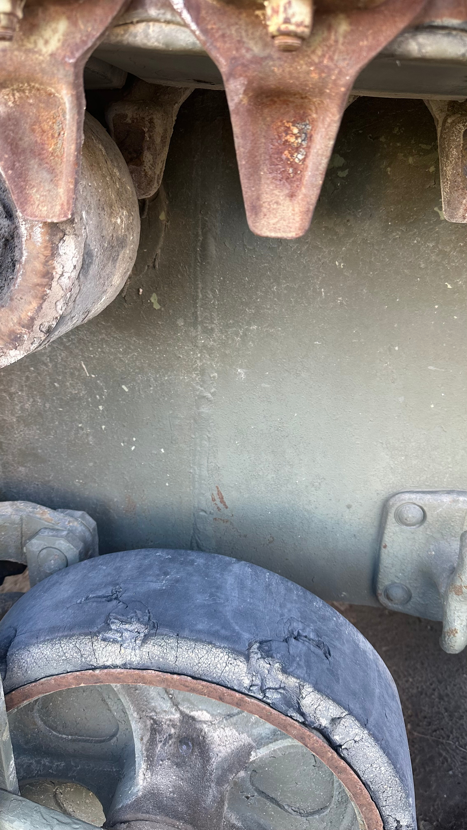

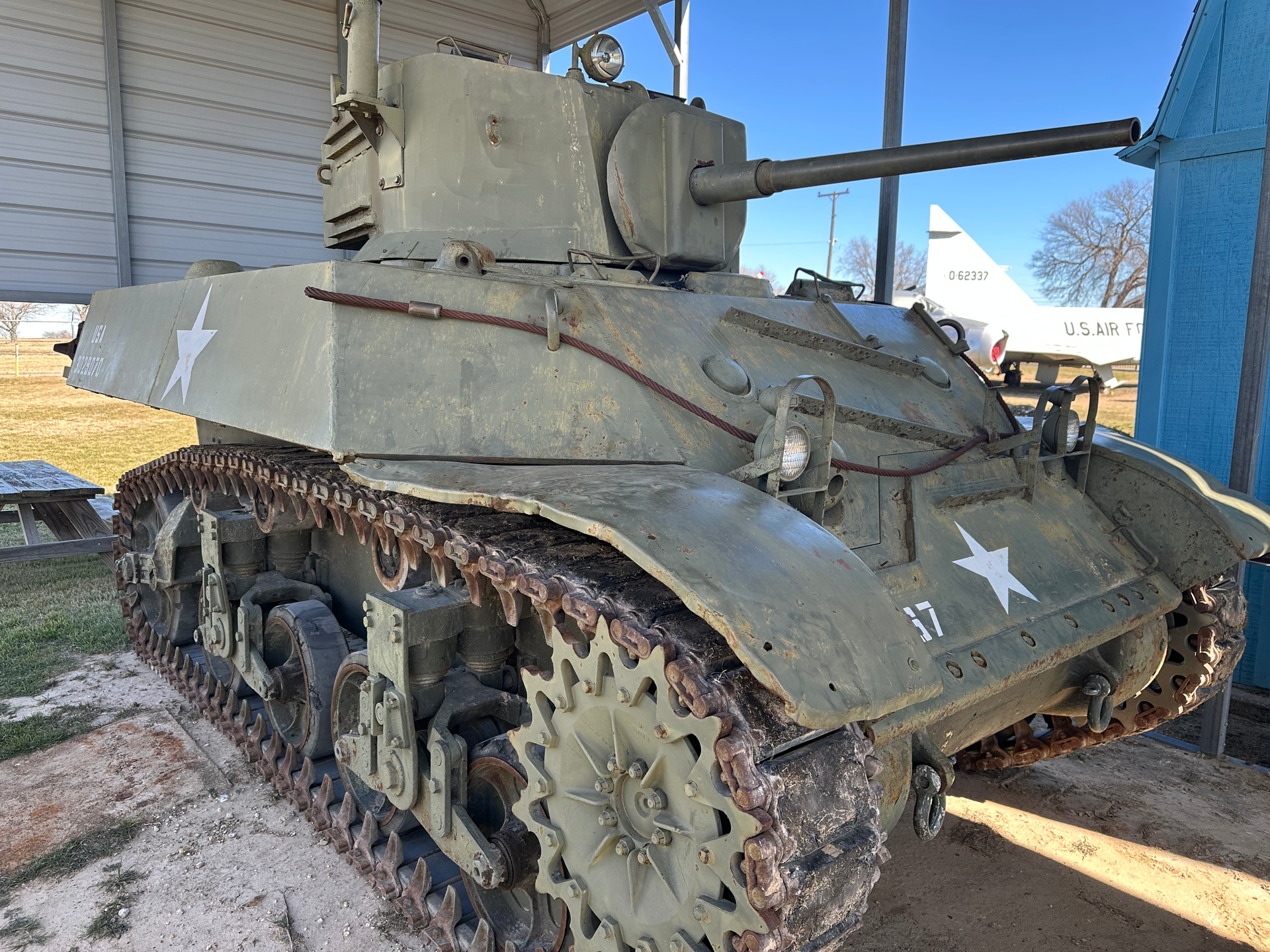

It’s not an M3A1 - we’re just holding it for another museum. I confess I don’t know that much about these older tanks unless I Google it. We just call it “the Stuart.”
I think it may actually be some version of an M5.
It is M3A3 used by British, Chinese, French and Yugoslav partisans. IIRC US did not use this version
It’s an M3A3, and not one I recognize. (There are only 15 or 16 in the US.) This might be the one held by the Planes of Fame museum in Chino, CA; it had a dummy gun shield. Where is it now?
The M3A3 was developed to give a welded hull, like on the M5, to the M3. The M5A1 was developed to put a radio turret, like on the M3A3, on the M5.
It was used for stateside training and in the CBI (drawn from UK stocks) but all but 105 were sent as International Aid.
KL
It’s in Fort Worth, Texas.
