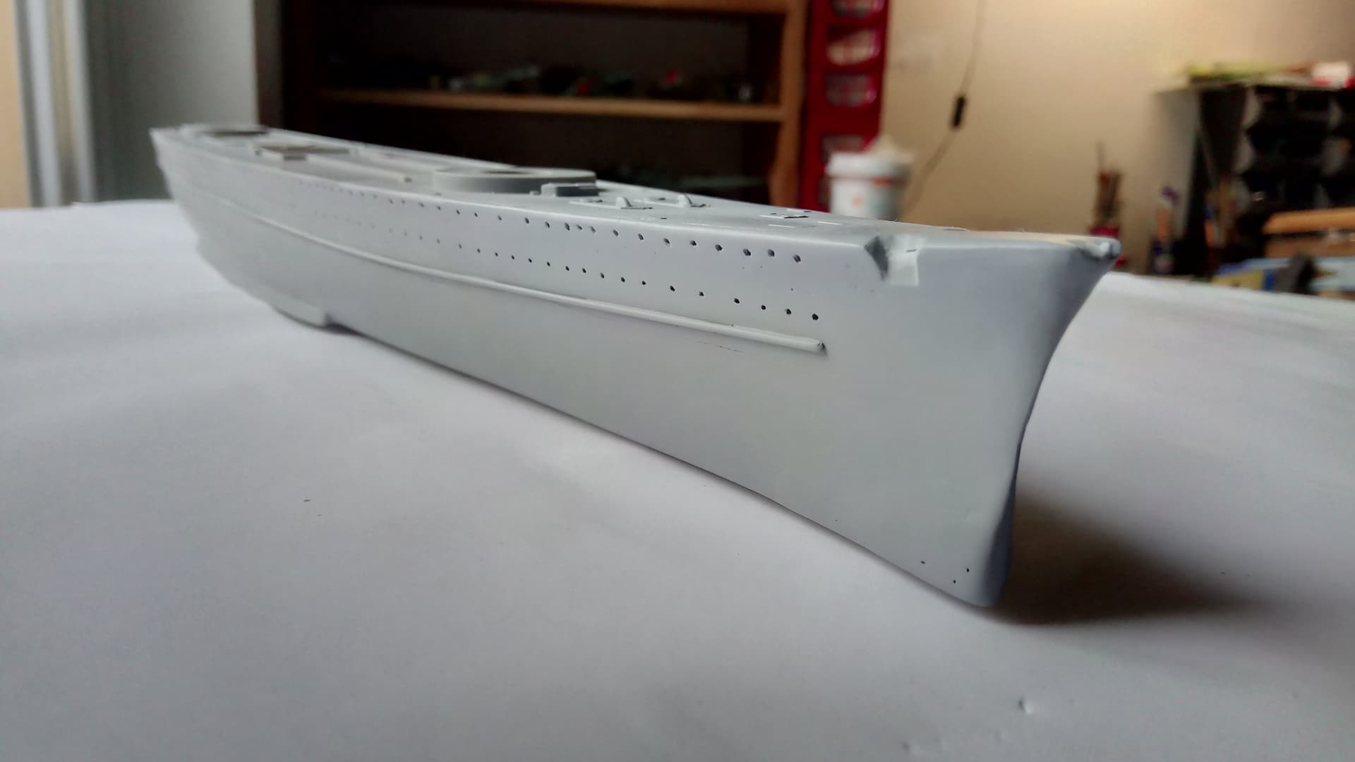

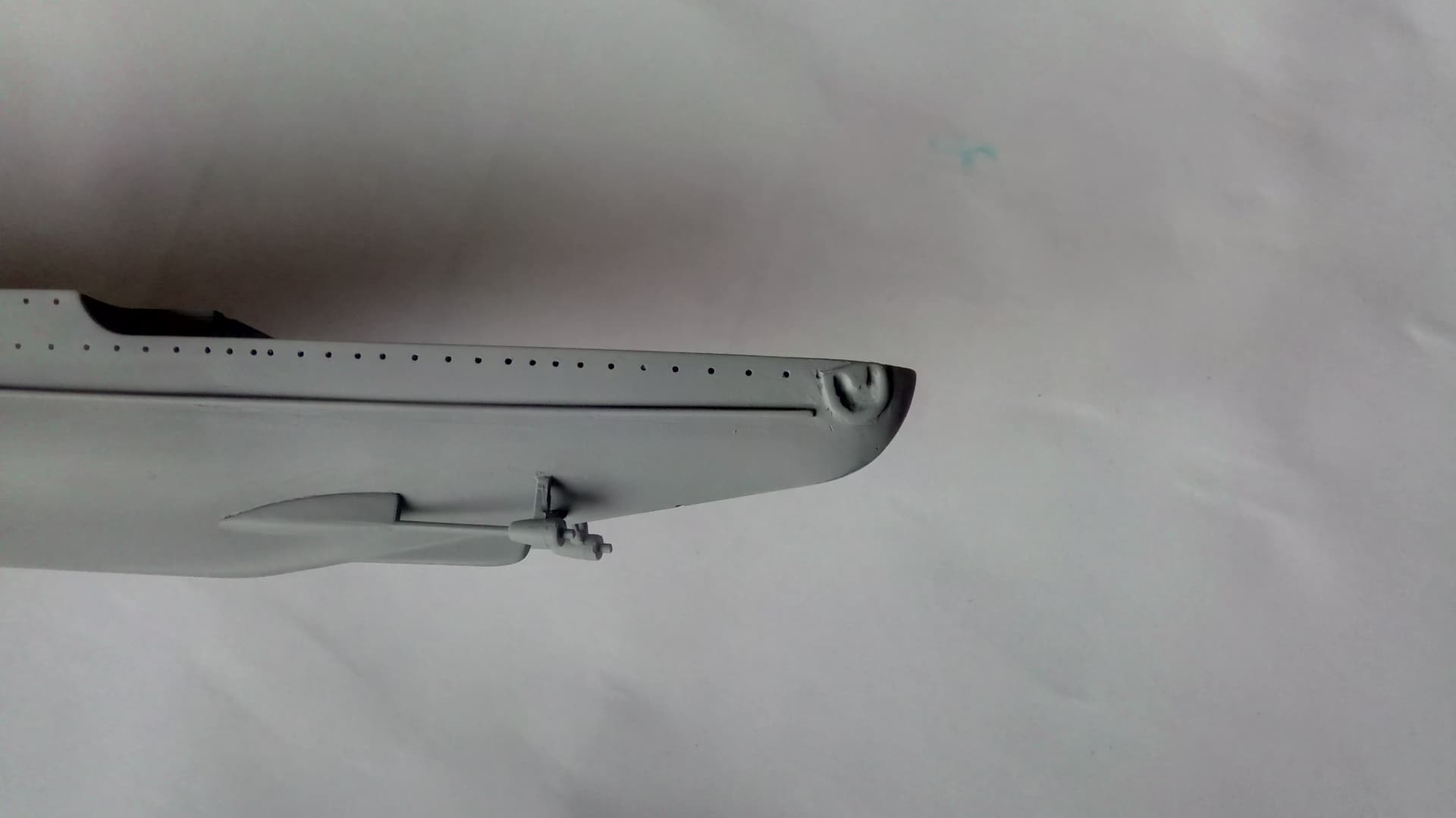

I was not lazy over the holidays, but progress was a bit slow withsanding, puttying, sanding… This is the result up to now
I increased the bilge keels, turned around the aft anchor pocket, added the degaussing cable and modified the bow with a raked stem, much more flare and larger bulbous forefoot. I am quite happy that I used brass form PE for the stem. Its really razorsharp.
Some minor repairs, then I can start painting underwater.

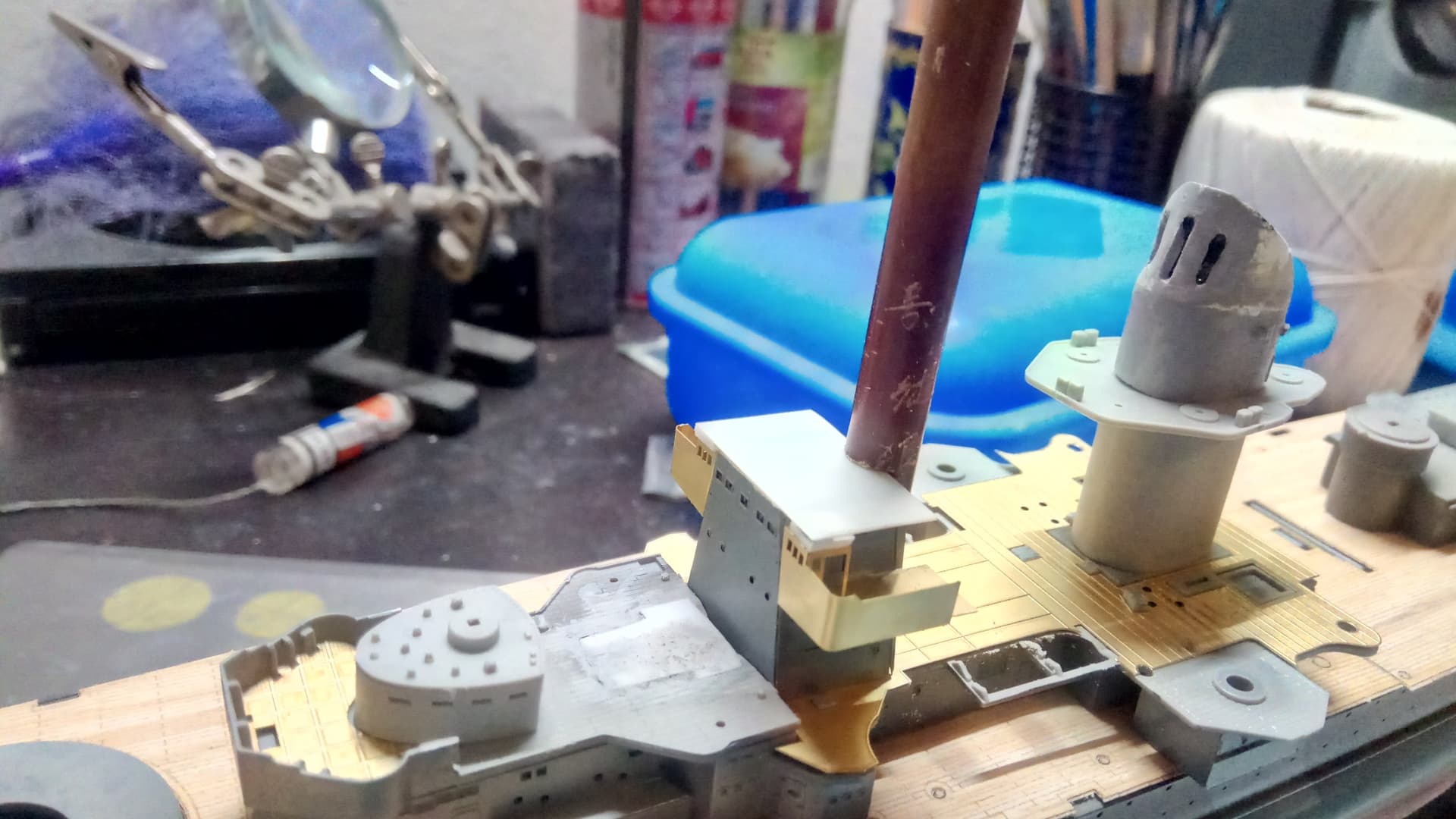

To compare the existing parts with my (not so good) drawings I installed the plastic bridge wings and platforms at the tower mast. Looks actually good. Only the base of the direction finder is quite wrong (also for Graf Spee)
I then sanded off the nice details and added the brass parts for the bridge. The bridgewings are nice, but fiddly but the small triangles of the tower mast are seperate and fit not very well. Why they not make the thing in one part?
Fortunately you cannot see much of it because of all the platforms. If I would do it again i would keep the plastic and just replace the platforms.
VF have forgotten the deck in front of the tower bridge. It should be either wood or linoleum (like the boat deck around the funnel. As I build Scheer later in the war I will probably just paint it dark. Linoleum removed due to fire hazard :slight_smile:
As you can see I use thicker material (bamboo too) for the mast. Looks better.

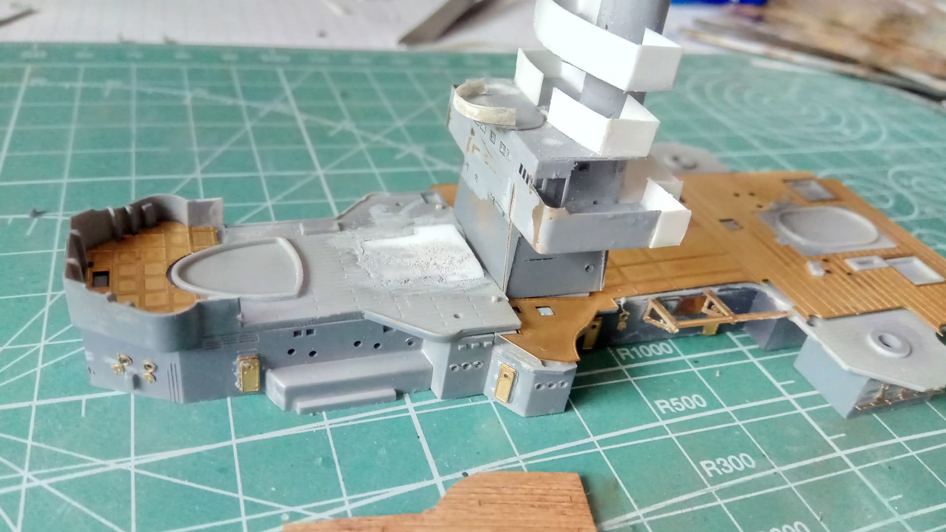

However I managed to install the nice PE at the superstructure
For some reason the VF set includes a brassdeck for the superstructure, but omitted the wooden deck behind the armoured control tower (which is clearly shown in the photos in the instruction). As this deck anyway have to be revised due to a slightly different dechouls carrying the lower director it is not a big problem.
I made the bulwarks for the various bridge platforms from thin styrene with the help of glue and thinner.
My Nitro thinner (lacquer thinner?) is like very thin glue and makes the plastic soft.
This is how it looks with a first layer of paint (mainly to get the borders of the white top right)
Btw the wooden decks are much darker now. I got them stained with artist paint (umbra). Still not 100% the color of teak, but much more realistic.
