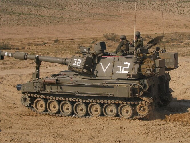

For example, this is a Doher and it still has the armored sight cover up top.
IDF armor can be confusing
The AFV CLUB kits are totally accurate that’s why my name is on the instructions sheet on all of the including the paladin. I spent close to a year photographing them from ever angle. . What happens after they were put in the field and depending on units things get changed and added or removed due to needs of the unit and the crews.
That’s one of the ones that was upgraded but didn’t have the GPS aiming system…
