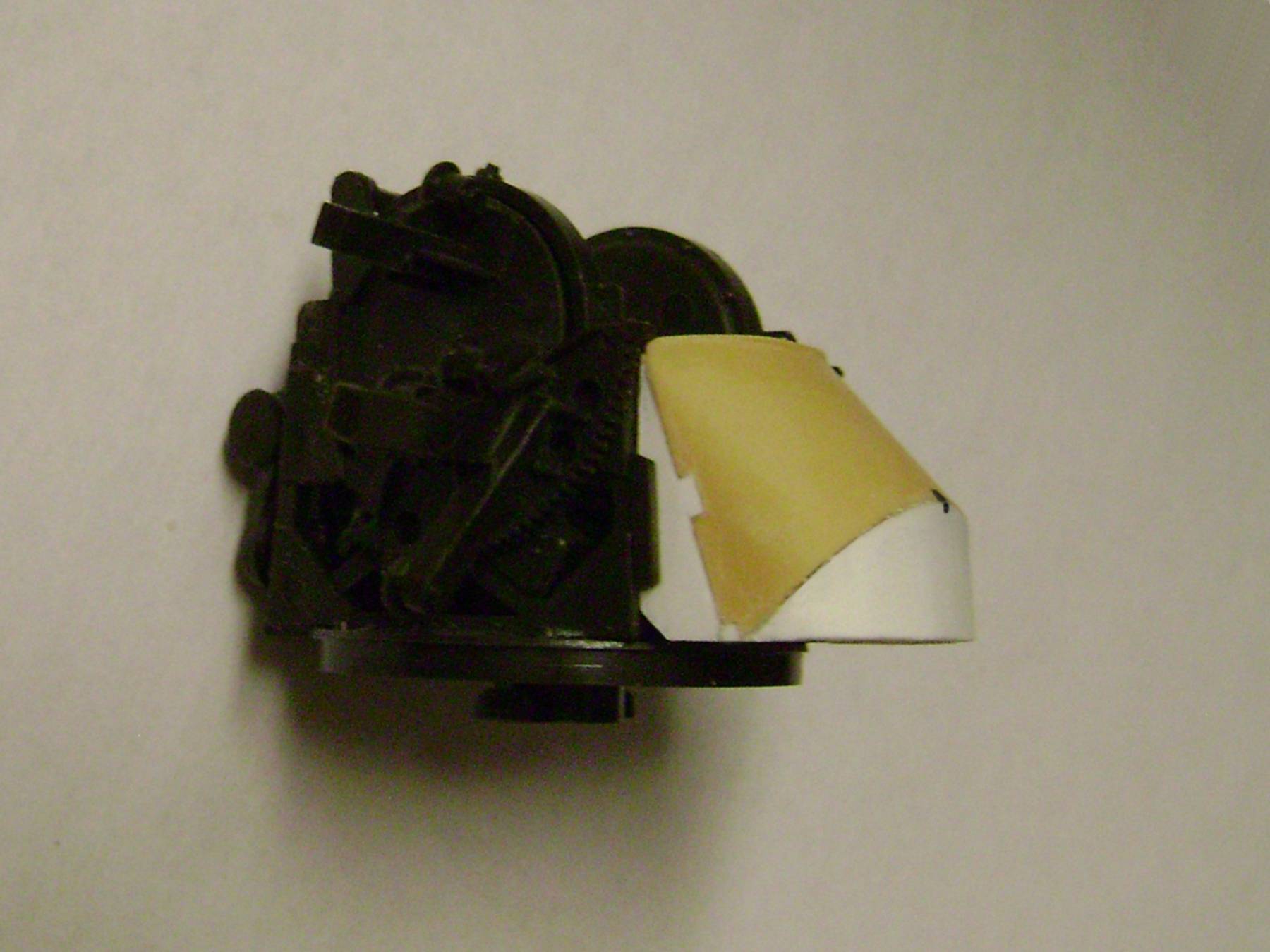

There were two manufacturers of front turret shields and they are noticeably different. The lower part “nose” of the shield is much larger than the other. The real Nancy had the larger one. That shield, referred to as the M45C shield was made by Kimberly-Clark. The one provided in the kit is the smaller one which was made by Frary-Landers-Clark. This incorrect small nose turret shield makes adding the decal with the teeth extremely difficult. The shield in the kit can be modified to better resemble the one on Nancy. I have shown how to accomplish this in another topic.

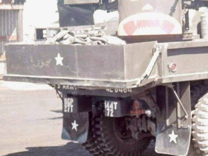

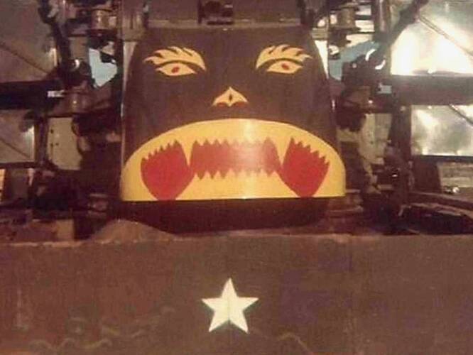

The decals in the kit for the face and teeth on the turret shield are totally wrong. I have added a photo dated early 1969 showing the correct graphics.

I’ve determined after years of research that the image of the Nancy doll on the rear turret shield was only on the vehicle for a very short time when it was assigned to the 28th TC. (8GP, 27T, 28T, 9) Unless you’re adding the correct 28T 9 bumper number, it should be omitted.

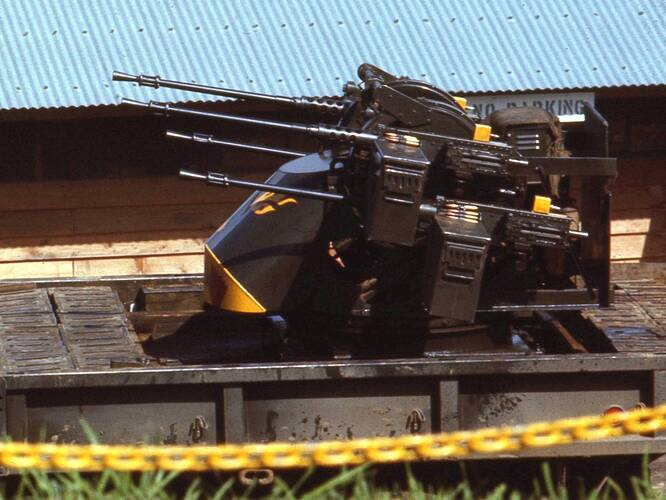

Great info. Can you copy the info about the shield and post it in this thread. It would be most helpful to keep it all in one place. Also, any pics of the wooden platform and extended bed parts?

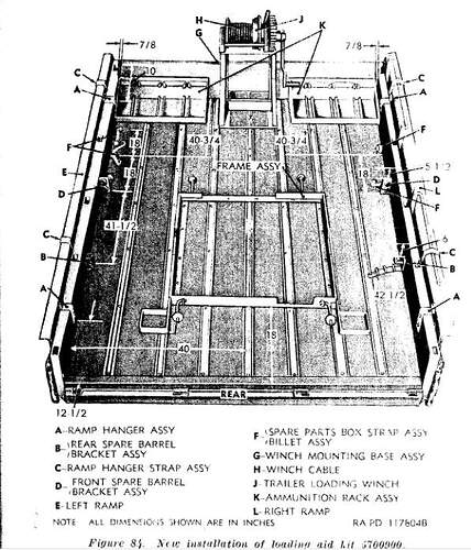

When you write about mounting the trailer to the bed, do you mean this by “frame assembly”?

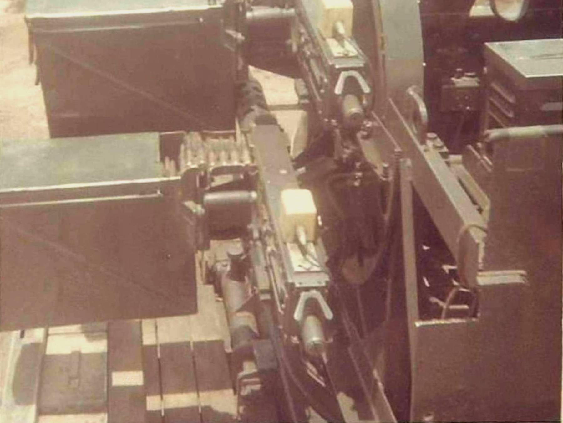

I don’t have any pictures of the complete wooden floor surrounding the M20 trailer but this can give you an idea of what it looked like.
Yes, that’s the frame assembly I mentioned. It is hidden by the wooden flooring.
No sketches but I can provide a pretty good picture.
Sure, here are some pictures of the way I did the M45D shield conversion to the M45C shield. The pictures are self explanatory.
Here’s what the shield looks like mounted to the Tamiya Halftrack frame which is identical to the Kirin resin kit. The shield from both kits is smaller than the Dynamo or Nancy kit but the procedure is the sa
me.

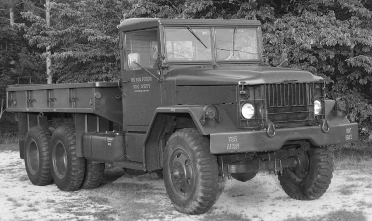

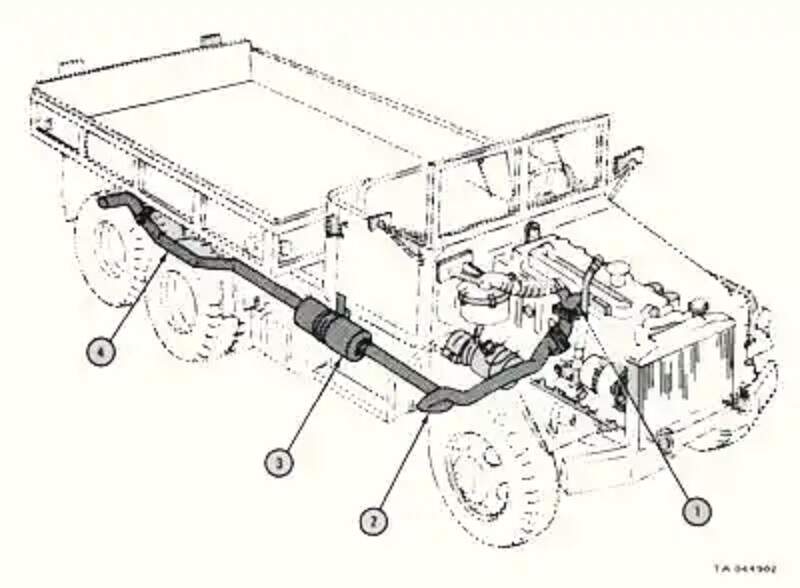

Another, small correction is to fill the hole on the right front fender. It shouldn’t be there since on the M35A1 the exhaust runs along the frame and exits between the rear wheels, not by a stack up through the fender.

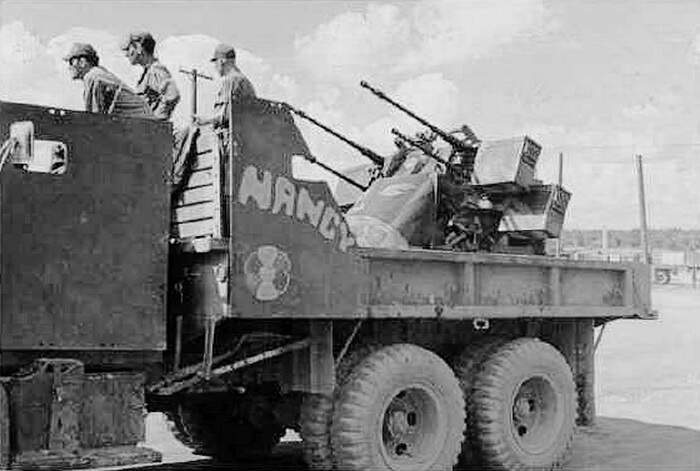

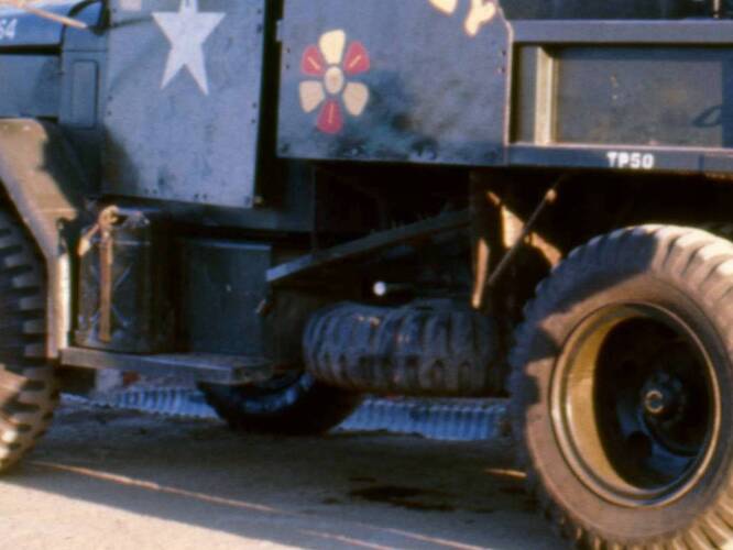

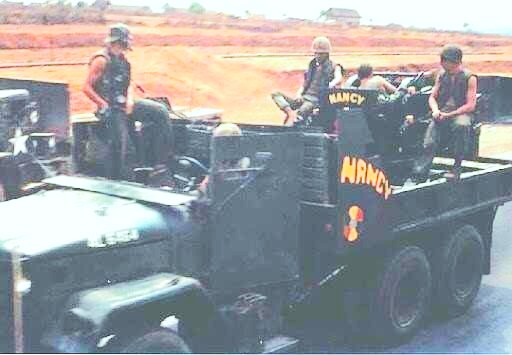

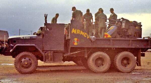

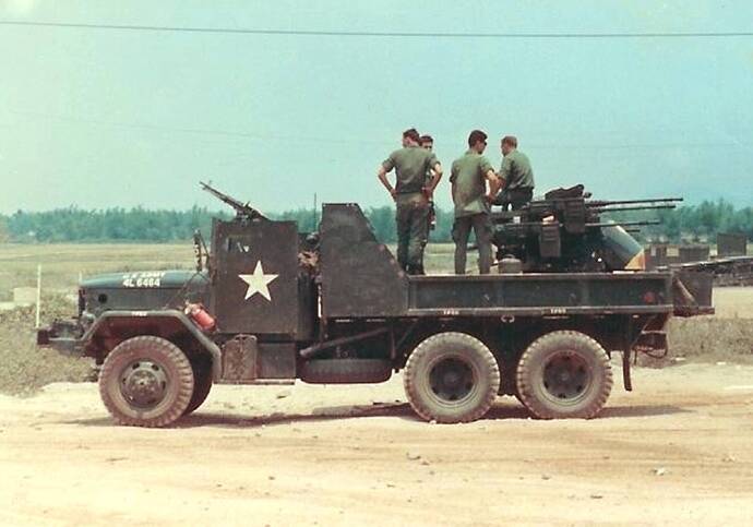

Some reference pics of the actual “Nancy” at different times as well. Interestingly, from the below pics, it looks like “Nancy” never carried a spare tire.

Yes, I’ve seen many pictures of Nancy and there was no hole in the fender. In fact, I never noticed that there was even a cut out in the fender filled from the factory.
There would not have been since the hole came with the later M35A2 model with multi-fuel engine and a few other changes.

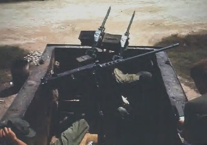

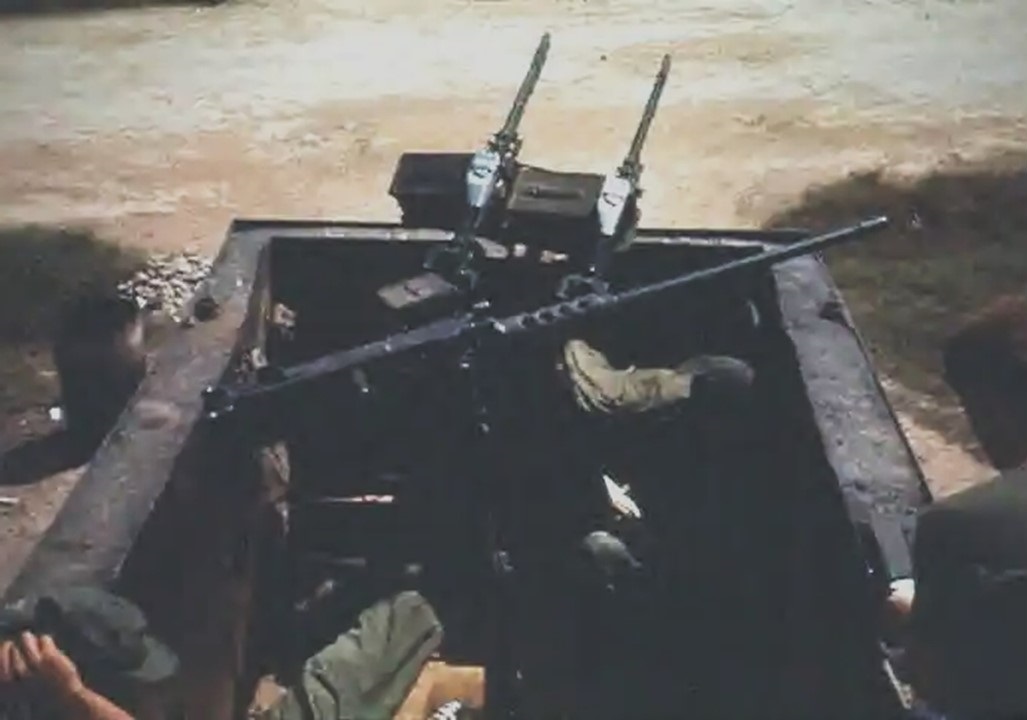

I think your pic above of “Peace Maker” is reversed as well since the M60 and M2 ammo boxes and charging handle are reversed. It should look like below.
Nancy did carry a spare but not all the time. Here’s a couple of pictures of the spare. Please note the absence of a flower on the side armor in one of the pictures.
Good catch, I noticed the ammo cans on the M60’s didn’t look right.
Cajun :crocodile:
No big deal. That’s the way the picture was sent to me.
