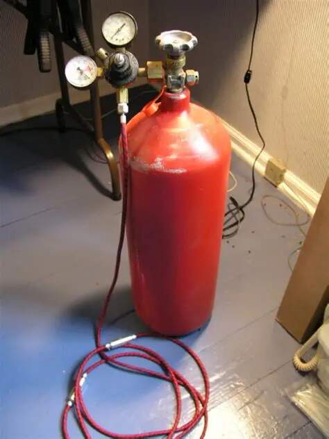

OK in all seriousness, If you want to use CO2 for airbrushing you will need a tank, a 20 pound size is just about right., Note, CO2 has no moisture in it so a water trap is not needed. There are several ways ot get a tank. There will be a company around where you will get the tank refilled. mine lasts a very long time between refills. The company will have tanks for sale. Normally you give them the empty tank and they exchange it for a full tank. My first tank I got from an auction. You will need a regulator, You can get this from the gas company also. Check around for a used tank, just make sure it is in compliance. Look for used welding equipment. To me the advantages of a CO2 tank set up outweigh those of a compressor. Silent, no electricity needed, completely portable, few parts to wear out, no water issues.
This is it, nothing more needed.
THIS is where I lean. I’ve got AirGas, Linde, etc in my area. I’m pretty skookum on what’s needed to do this setup, was more wondering if anyone had experienced it then - LO AND BEHOLD!!! :rofl: Thanks for posting the pic. Are you still using this setup as your ā€œfront lineā€? Or is this a nostalgic backup kit?? SlĆ”inte.

I was lucky enough to win a BIG tank 25 years ago at my model club’s raffle, a member was moving to another state and he just donated his, I’ve used it ever since. Its BIG and heavy, it has 26 lb engraved on the tank, I guess that’s what it is.
The only drawbacks are: you can’t ever be absolutely sure when it’s going to run out. It gets lighter and lighter (you can barely lift it when it’s full) but it still may run out right in the middle of a project, don’t ask me how I know! Also, once you’ve swapped it out 4 or 5 times at AirGas or similar, you’re approaching the cost of a cheap compressor.
But it’s way worth it to me for the absolutely bone dry airflow, and the dead silence while you’re using it.

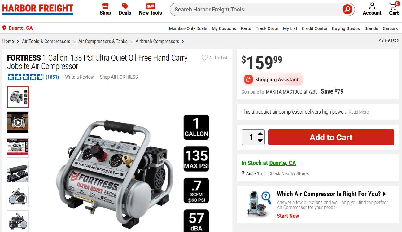

I live in an apartment also so it’s perfect, no one hears a thing. But after years and years I decided to look around for a compressor as a backup. I researched and bought this a year ago:
It really is QUIET, I’ve even used it when people around me are at home, but no one has ever mentioned anything about it. You can also just fill up the tank and then turn it off and airbrush away for quite a while, no noise at all.
It looks like, in the picture, that it would be putting out industrial strength noise but it absolutely does not.
You can get it for less than this price, just keep looking for a coupon or a sale at Harbor Freight, highly recommended.
And look on YouTube for reviews, pretty much 100% people who use it love it.
If I didn’t already have the CO2 tank I would be totally happy just having this.
