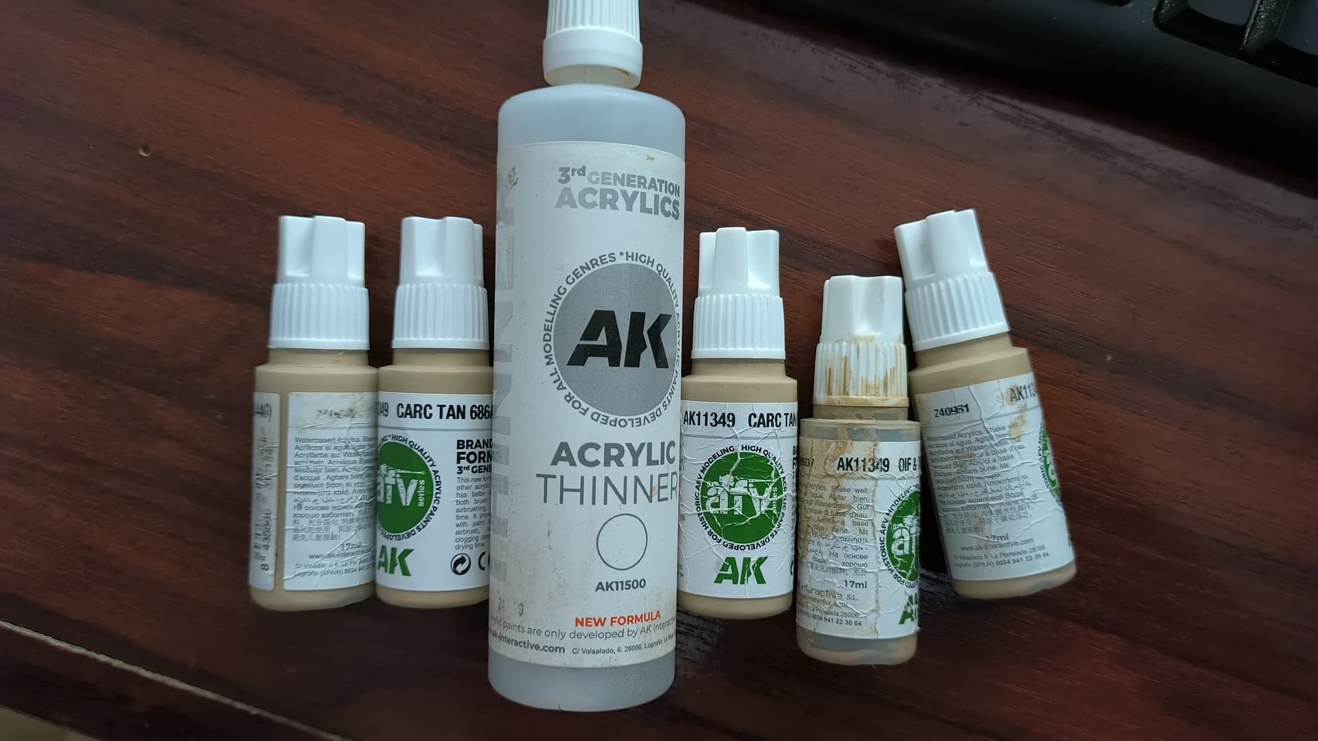

In my experience, for my Abrams I used the third generation AKs, precisely the CARC TAN obvious haha, as a paint the color is excellent, but the paint is a damn horror, you have to dilute it with its own solvent, under no circumstances with the Tamiya X20A , or leveling thinner, nothing, (They are not compatible) it has to be with its own thinner, with water or distilled water, or it remains very thick or very diluted until you get the point, and above all, control the tip of the airbrush and do not leave it too long spent some time inside the airbrush, as I said, the paints are truly horrible, I personally have ended up hating them, that’s why I switched to the ATOMs that also have the CARC TAN
I leave you a photo of the thinner

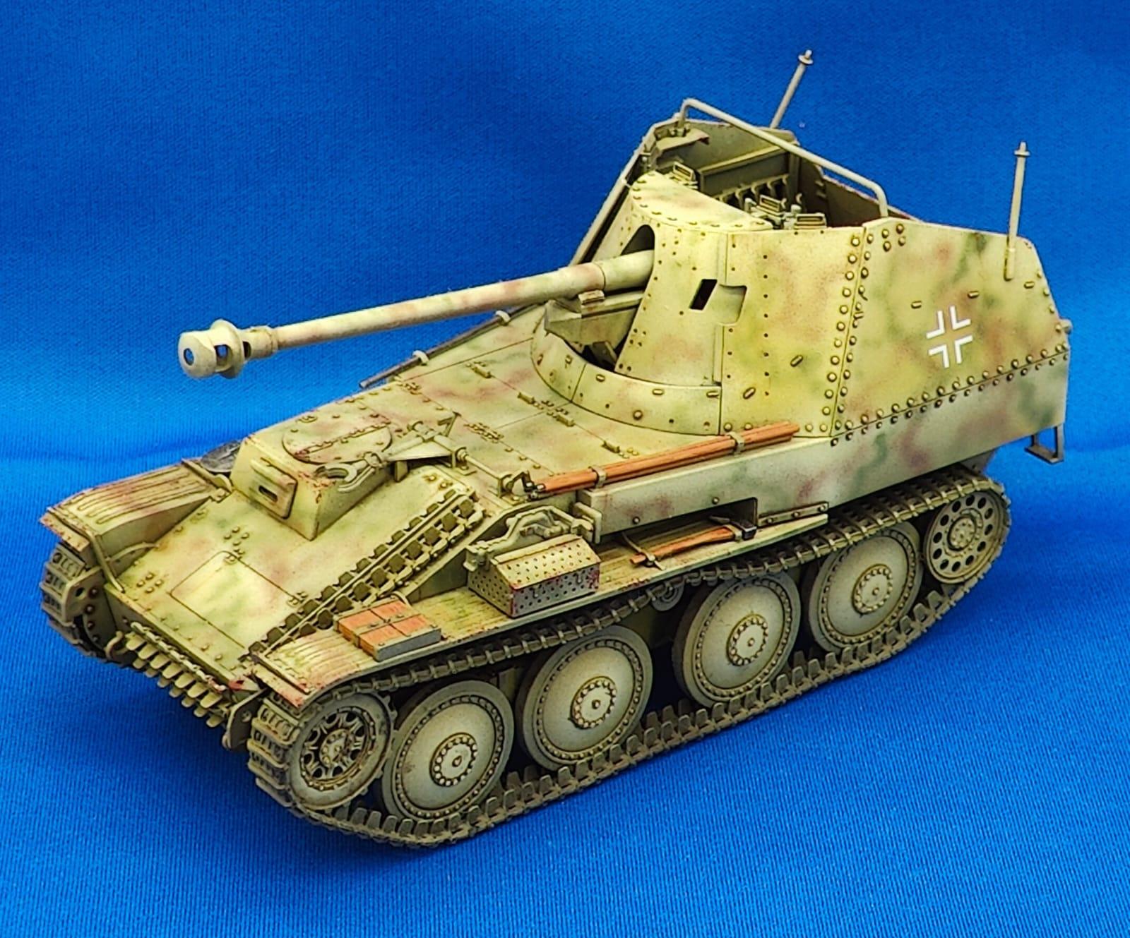

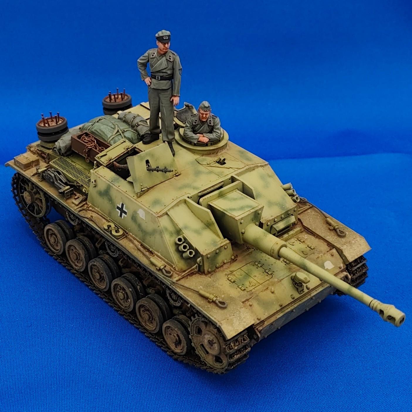

Paint preferences are about as personal as whether or not to put pineapple on pizza. My experiences with AK Gen3 paints have been the opposite. Yes, you have to use their thinner, but they behave quite well.
Thinning them with X20 won’t work because despite Tamiya saying their paints are acrylics, they aren’t really.
Here’s a few examples of what can be done with them.
