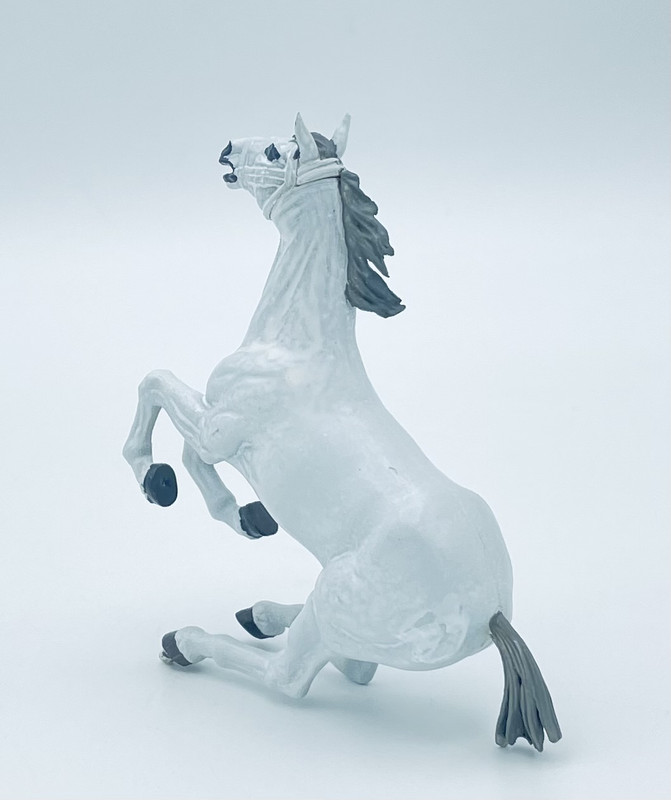

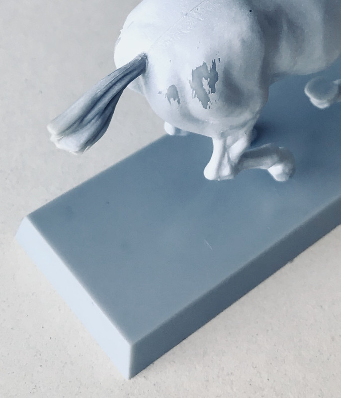

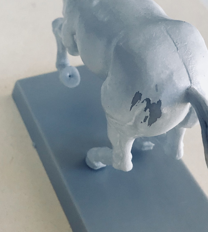

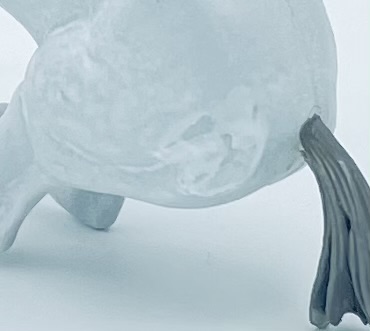

So I tried them out the other day. I don’t have a paint mule, but I do have a paint horse…
An airfix 1/32 Scots Greys horse that I used to try out for airbrushing Humbrol Acrylics…
I decided to try the markers here on the hooves and a few assorted areas. I used Rubber Black and RLM 66 on the hooves
I also used the RLM 66 in areas like the nose, ears, and mouth.
I am going to try some acrylic glazes for making the dapple base area, along with the AK Real Color markers, since the flat white is a bit translucent. I used them to cover up areas on the horses haunches that I had scratched up testing the hardiness of the Humbrol Acylics

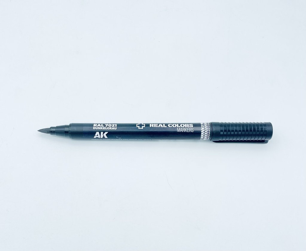

I forgot to add a photo of the markers with the tip uncapped. The side can be used for wide area applications, while the pointed tip obviously can be used for more precise work

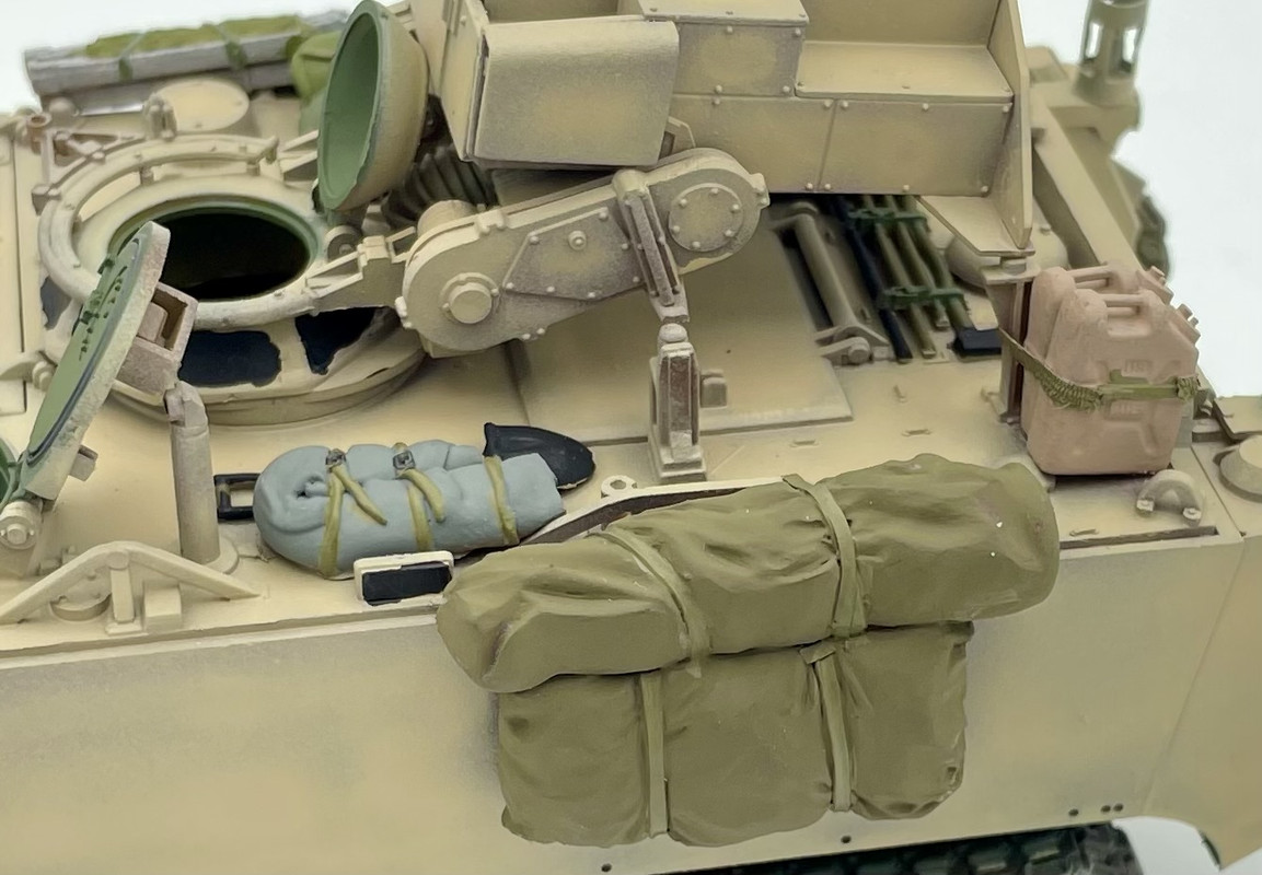

I used them over Vallejo “Bone White” as the second color, “Wood Base” as the darker yellow on three color day desert camo on these rucksack covers
I was gonna try out their “buff” as the darkest third color on that scheme, but it was way too light…

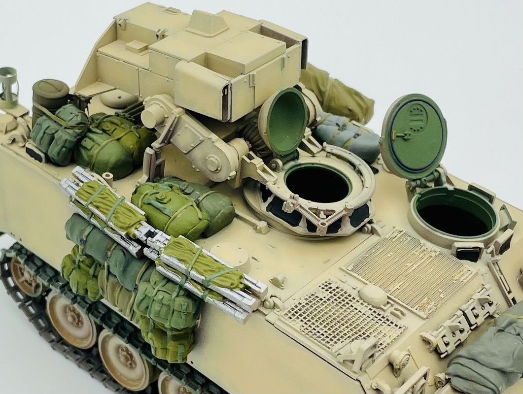

I also used several of the greens and black for periscopes, hatch seal rings, straps, and buckles on the stowage for my FISTV
it definitely takes a steady hand and fine touch for the precision work, as the paint flow is quite good…
