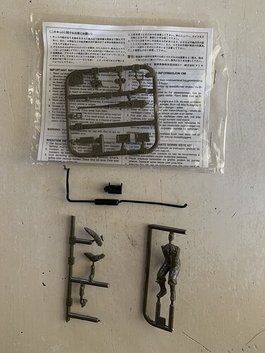

Shout to Mike @165thspc for sending me some spare parts for my build. ![]()
I did also receive some time ago my 3d printed parts.
