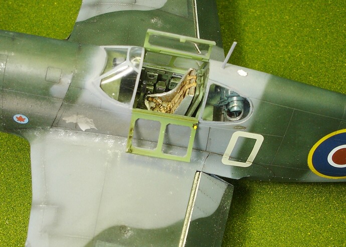

Okay third time is a charm and still so much to learn. Putting the photos from another build of mine here just to keep them in one place.
Mounted all the control surfaces to match stick forward and to starboard, flaps down with right rudder while parked.

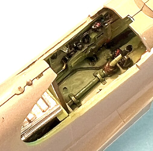

I vacuformed the camera port side rear window to support the K24 camera

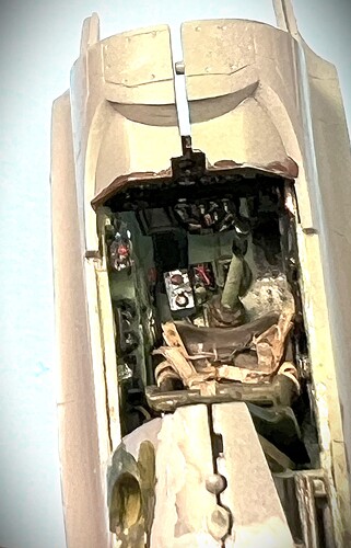

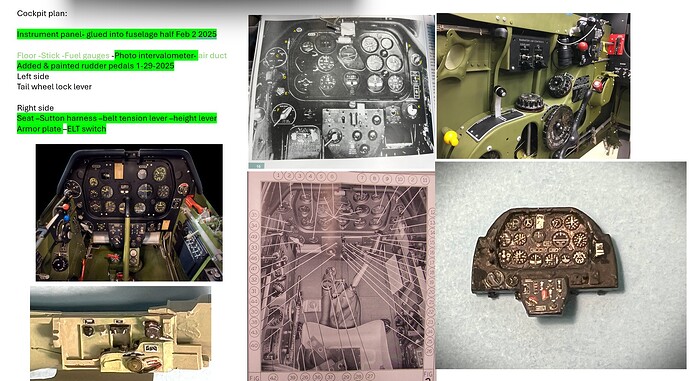

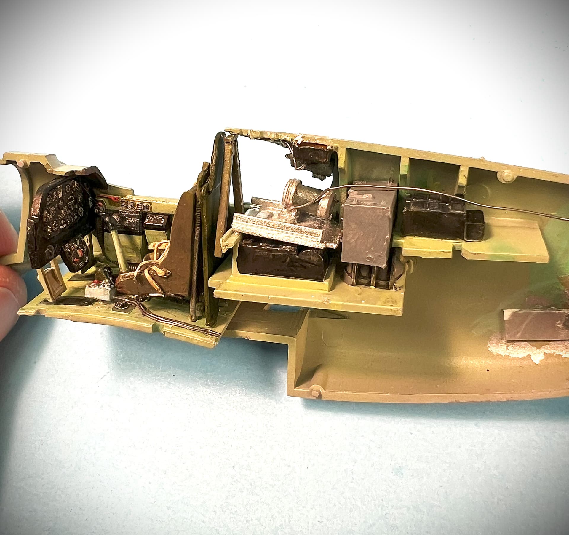

Cockpit highlights include the camera control on the floor to the right of the control column. This is marked as number 37 per cockpit reference from Colin Ford.
Looks great
Very nice work on the control surfaces/positioning and the controls.
Shaping up quite nicely.
I could not make room for my 1/48 scale resin TR9D radio to match the exact configuration shown in this photo. Seemed a more realistic mount to turn the radio 90 degrees and move it aft instead of cutting up a fuselage frame. I get the impression the radio and camera bay evolved quickly and varied to fit the operational need at Sawbridgeworth as the Mustangs started flying there. Reading stories of changing out the radio for every mission based on air or ground comms required.

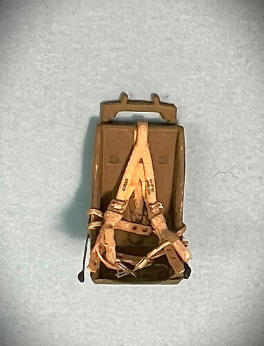

Really like the look of the seat with the Sutton harness.

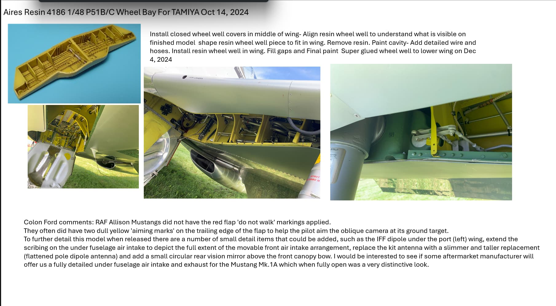

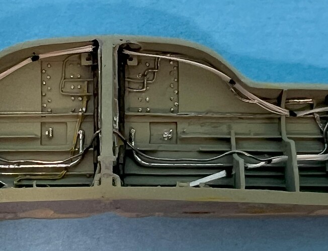

Main gear bay added to lower wing.
Tail wheel bay detailed some

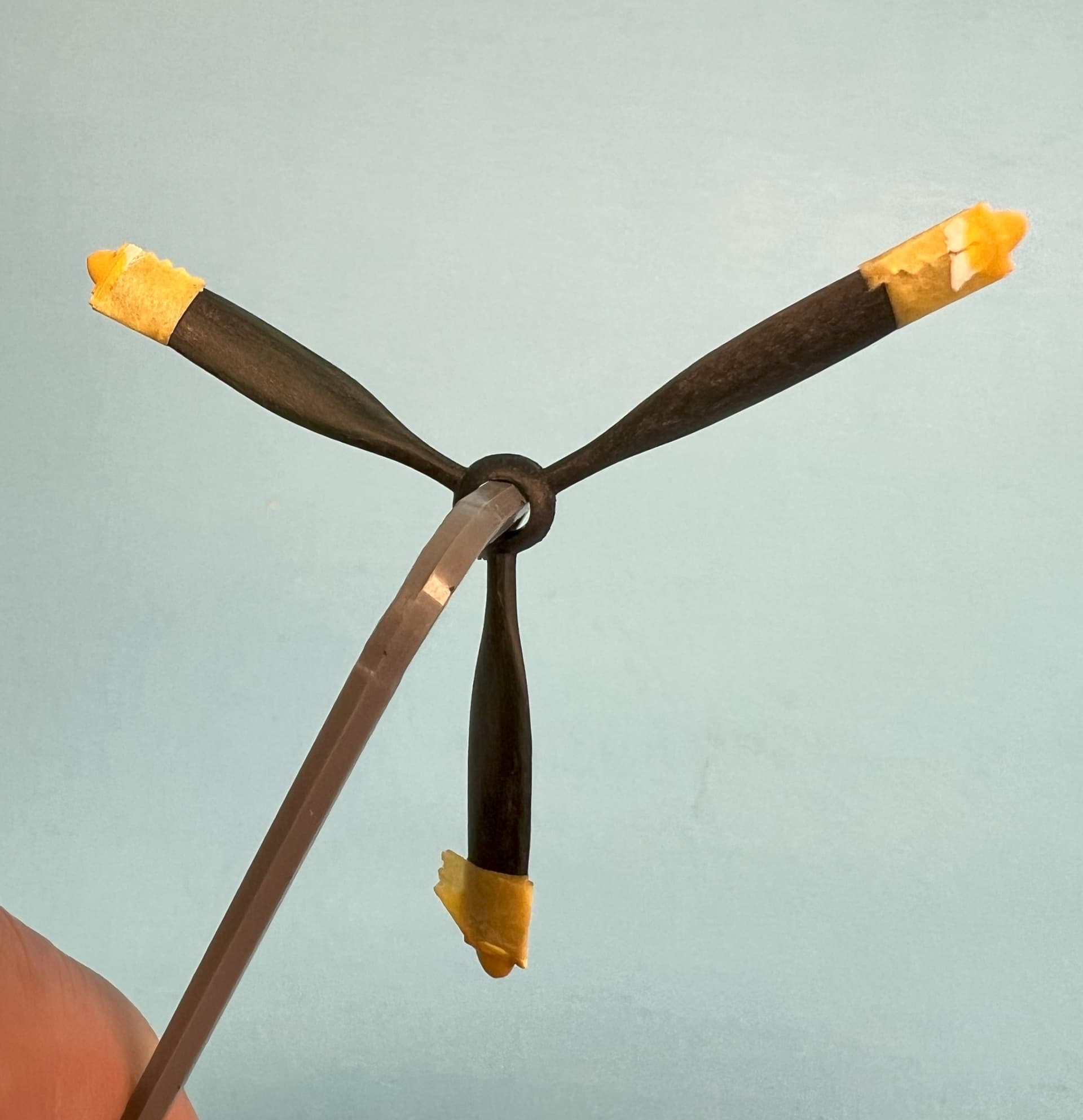

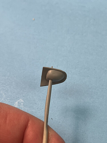

Used the propeller from the old Monogram P-39 kit. Tips painted
Thank you for looking and the kind remarks! I really appreciate your sponsorship of the Mustang campaign as I am learning a lot from the sharing

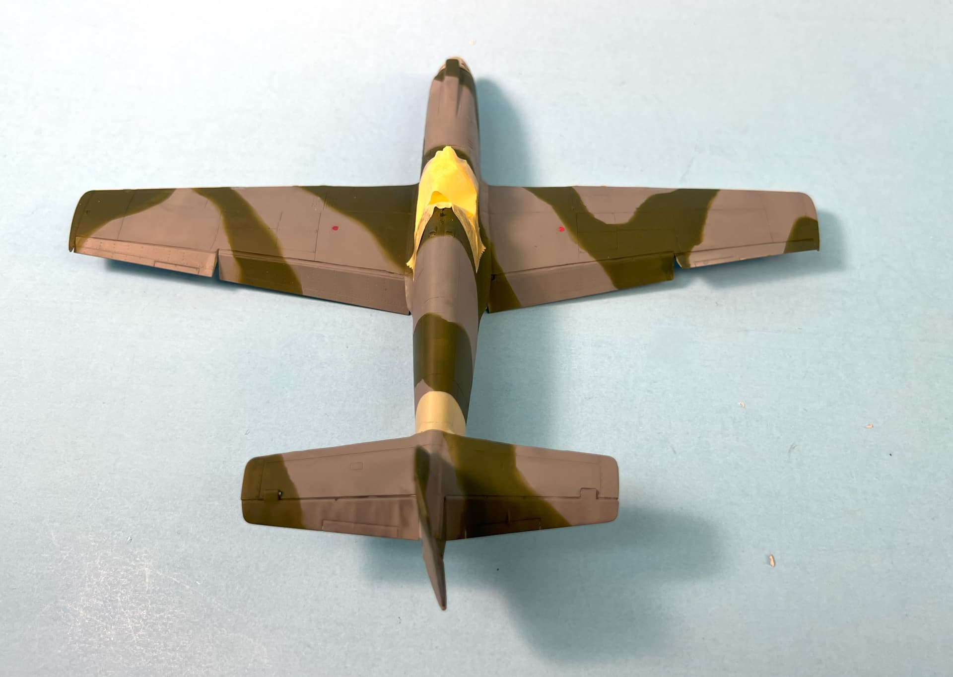

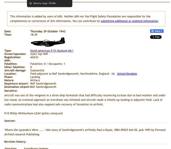

Thinking about weathering. Perhaps light weathering. I want to be realistic for a plane that only saw a few months of service before being written off in a crash landing per this report…
Wing root chipping was common. Used a rattle can silver paint at the port wing to fuselage root after priming. Next was a moderate hairspray for that chipping method only at the same port root. After airbrushing the camo pattern a small dot of water and a toothpick made for very controllable chipping easy to match actual photos. I am happy with the result.
