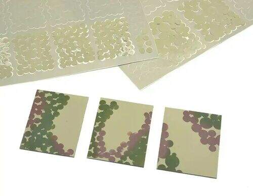

Actually, there are masks for doing just that:
