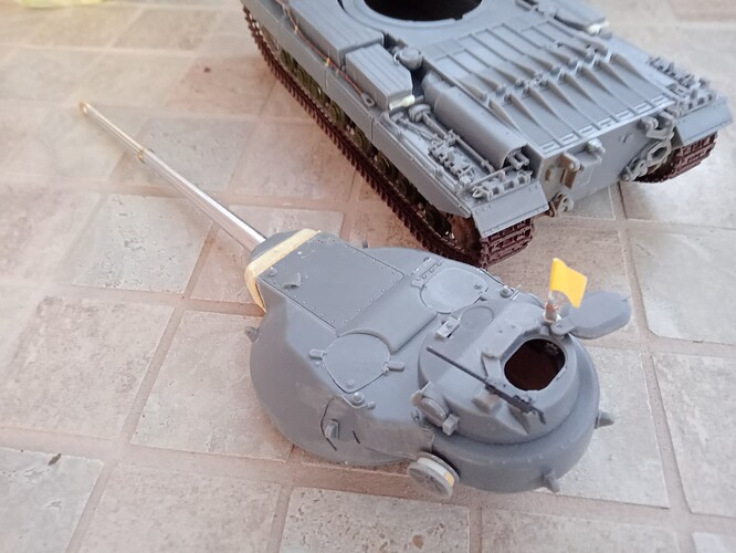

And some construction shots; I had to paint some areas as I went:
I used Friuls as the kit ones were not the click-together type Amusing Hobby later provided.

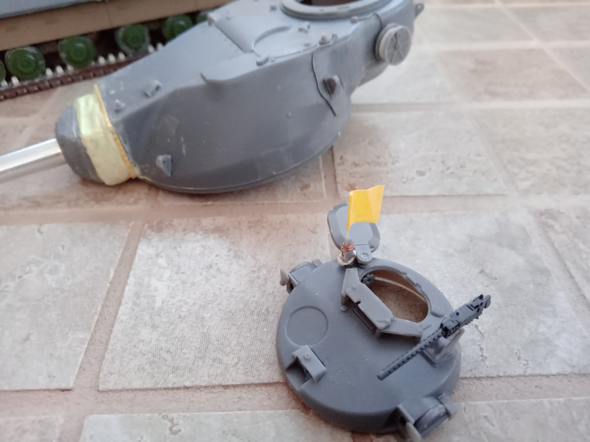

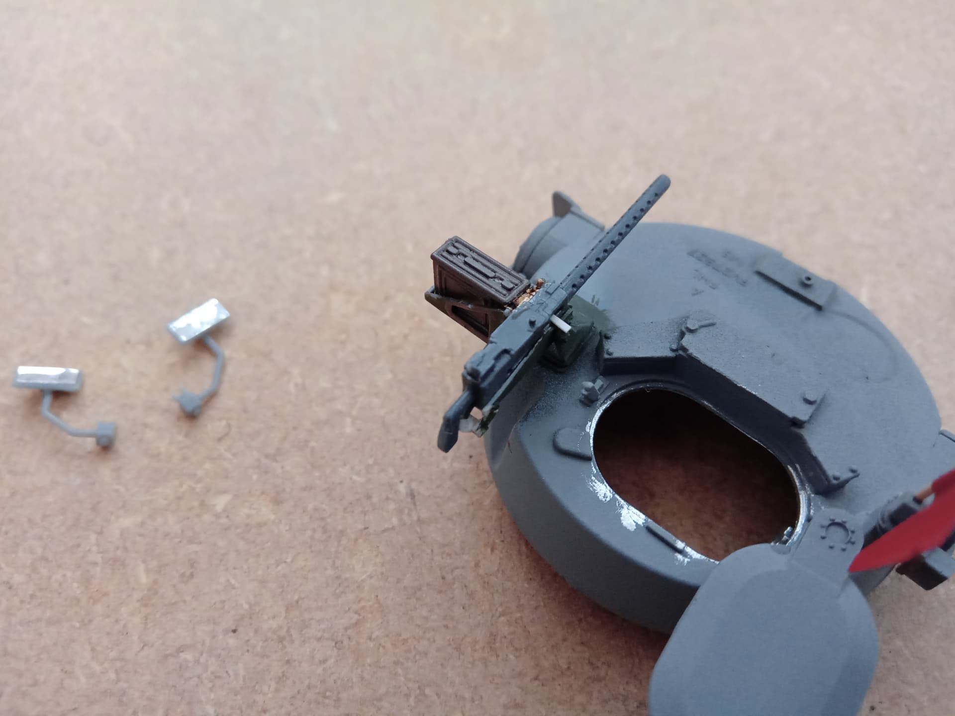

A few mods: a metal gun barrel from Aber. A tape and card sleeve around the cable reel, and an etched buckle - not really visible. A replacement MG from Academy, and a scratched range flag (plastic rod and masking tape) inserted into the hatch support/stop, modelled as lashed to the support (fuse-wire); I’ve since found out that this support housed a release catch mechanism so the flag would probably have just been inserted, however, given the unforgiving nature of super-glue I’m afraid it’s staying where it is and as shown. I also added lead wire to replace the rather weedy conduits for the smoke dischargers.
Mantlet cover from Milliput, though not one of my better efforts.

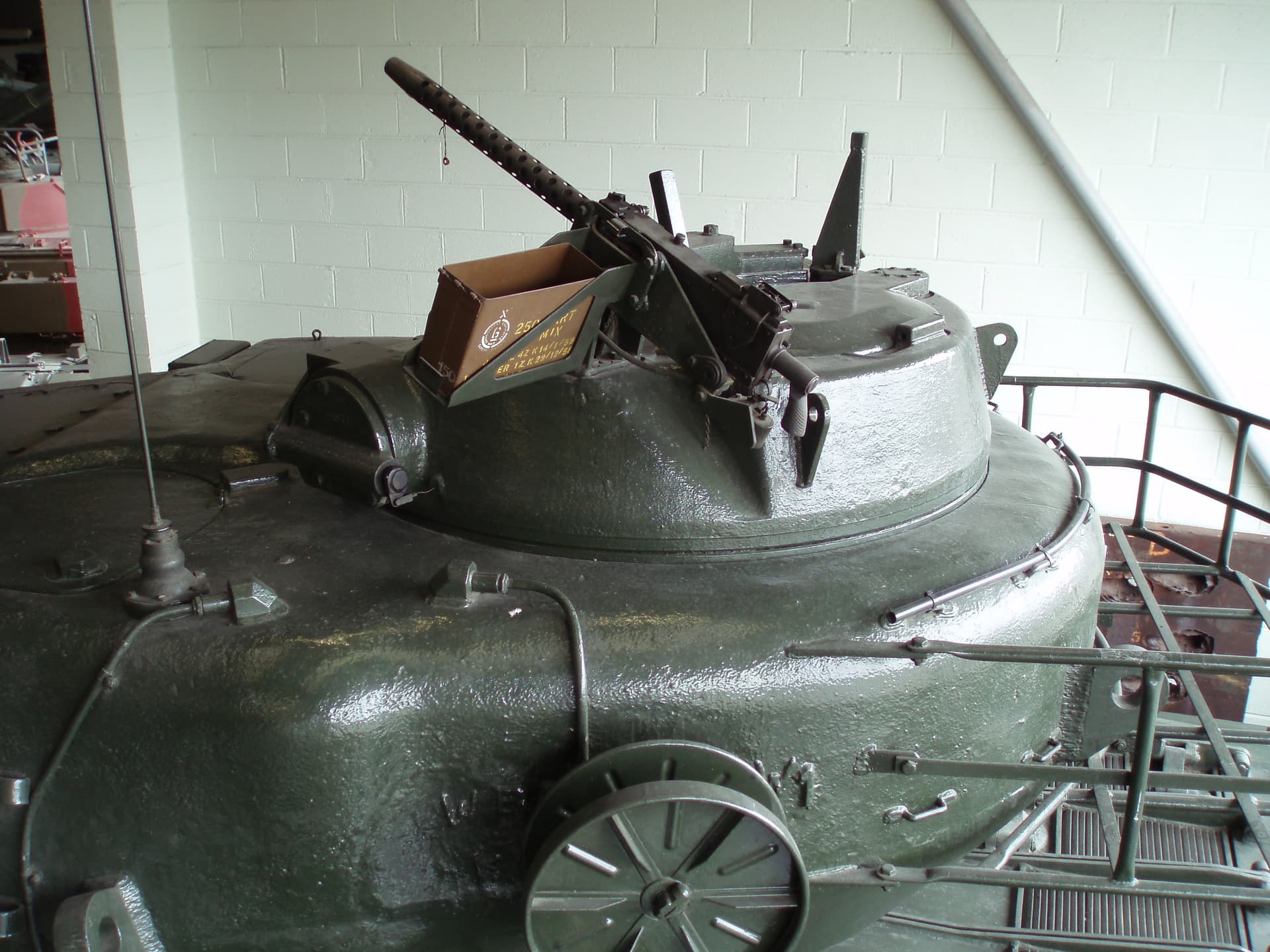

Another view of the turret, showing the ejection port and the Fire Control Turret
