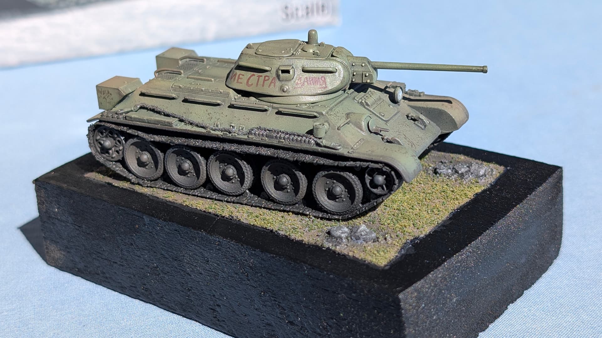

Hi Folks, I was encouraged by @18bravo to share my experience of printing my own decals. Hopefully this will assist you to either avoid my mistakes or appropriately remedy them should you fall into the same traps I did while making my own decals for the turret inscription on this Trumpeter 1:72 scale T-34/76 mod. 1942

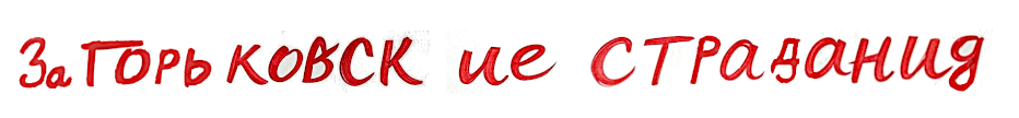

Running @Holger’s text suggestion through an AI (I’m pretty sure I used ChatGPT) with the prompt that it’s represented in red paint over a white background we came up with this image:
We then manipulated the resultant image using the free Photoshop clone GIMP2 to come up with more uniformly-sized text to make up the inscription:

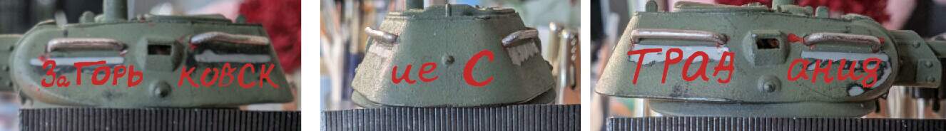

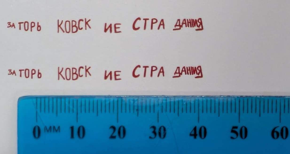

We took a number of profile photos of the turret with a metal ruler in frame, so we could get the size of the decals correct, also using GIMP2 to align and scale our images as well as break up our inscription into pieces that could be distributed around the turret
Satisfied that our sizing was correct, we printed a test run on plain paper, yielding satisfying results. This would also point to where the decals would be positioned on an A4 sheet

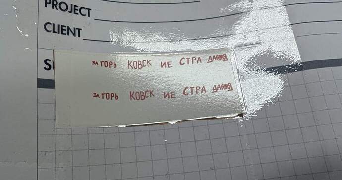

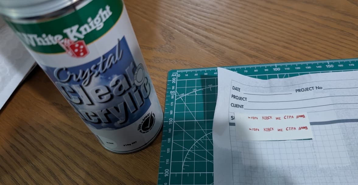

Since I was only after a pair of 50mm long decals, I didn’t want to waste a $2 sheet of A4 decal paper on a tiny transfer, so I printed my decal image on a sheet of grid paper with the idea that I would carefully cut out the location of the print and replace it with decal paper secured by tape. This method was ultimately successful.
The printed decal was then sprayed with White Knight Crystal Clear Acrylic as recommended by the manufacturer. One coat is enough, as two coats will make the decal too thick, and it’ll take a lot of work to make them appear to conform to the surface

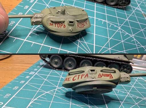

Allowed to dry, the decals can then be cut from the paper and applied in the usual manner. There were no issues using solvents such as MicroSet or MicroSol.
I stuffed up and sprayed two clearcoats…

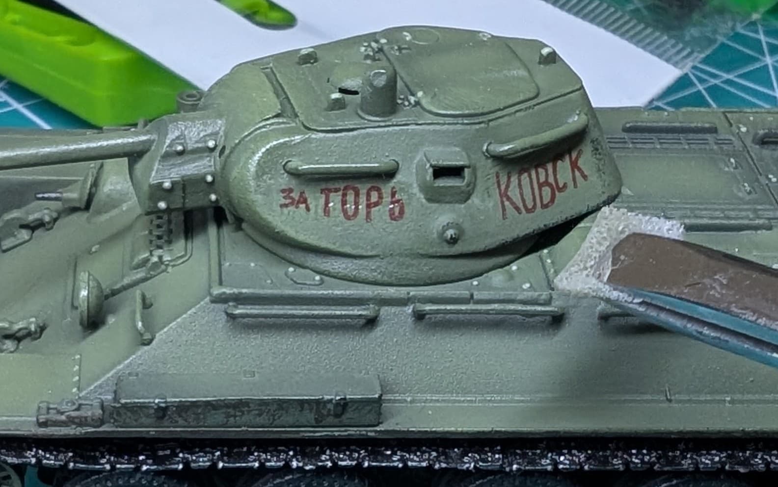

Overdoing the clear-coat will make your decals fat and prevent the decal from conforming to the underlying surface for that coveted “painted-on” look. Holding a piece of #3000 Sanding Sponge in a pair of self-closing tweezers allowed me to thin out the obvious edge of the decals as well as thin the decal to allow underlying surface texture to come through consistently. I scuffed my own paintwork in this process, so some extra clear-coat for your model will better protect it from whatever aggression you use to sand the decal edges
Alternatively you could simply sand the decal edges while it’s still on the paper, which will place your model’s paintwork at much less risk.
Importantly, you want to wet sand rather than dry sand. I found sanding the decals without a little water tended to make them go cloudy which is far from ideal

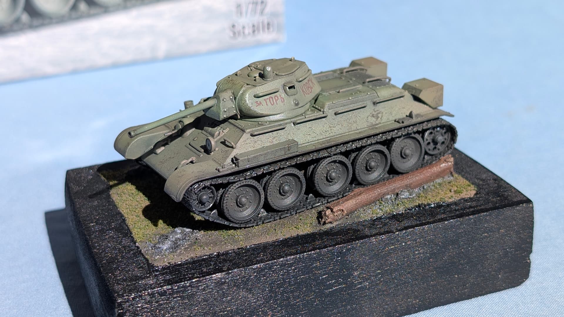

In conclusion, this was a highly satisfying exercise allowing us to better represent the subject. The historically-minded modeler would do well to explore the world of print-it-yourself decals particularly if there’s a particular time, place or unit that you’re trying to represent at scale. For civilian vehicle modelers, the options are unlimited.
