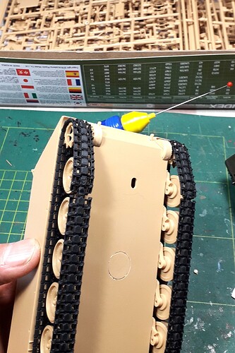

Some progress has been made and everything fits just fine… except for the tracks. These are too short! Which is a shame since they look good.

Are those the kit tracks?

The newer boxing like you have should come with pretty nice indi-link plastic ones too.

@tankerken Yes, they are.
@HeavyArty I know, but I had hoped to be able to use those for the Revell M901 (yes, that one) I have. Those tracks are useless.

Cut off the axles for the idler wheels. move them forward by half the length of the gap in your tracks. It won’t be much. The axles will be fragile. You can overcome this by drilling into the axles and their mounts and adding some steel or brass rod to strengthen the joint, or you can drill completely through the hull and add a rod of the appropriate diameter for an axle. Obviously this won’t work if you want to show the interior.
