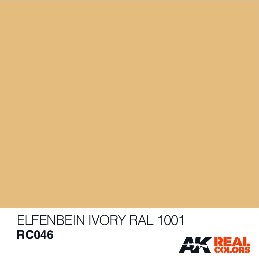

Obviously, there is a considerable amount of variation depending on area being sampled, dust, dirt, oil, grease, method of paint application, thinner used, dilution ratio, time of day, lighting conditions, camera, film, processing, monitor settings, Feng Shui, whether the photographer had chocolate milk, etc…
In other words, I doubt this process is going to yield accurate results with so many uncontrolled variables. For what it’s worth, the first one looks a lot like Elfenbein RAL1001.

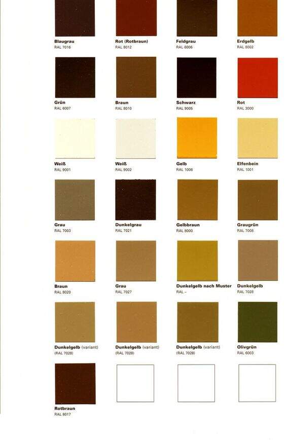

I just stumbled across this RAL chart, note the 5 shades of Dunkelgelb;
Unless someone has a new, in box, relic of the proper time frame, can confirm that the color of this artifact matches the color of the paint used at Nibelungenwerk during the time in question and also has access to a spectrophotometer to determine its actual color, this method of determining a paint color seems doomed from the start.

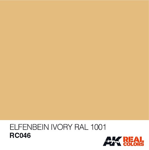

Makes me wonder if Elfenbein RAL 1001 was used on occasion to stretch other paint stocks.
Same colour?
My old eyes think so.
I’m not saying it is Elfenbein, it just appears that way. Feel free to plug the photos into Photoshop and sample it, see what y’all get. I just don’t see this as a viable technique given all the uncontrolled variables.

I’m still not seeing a RAL sample that looks anything like the Jagdpanzer IV roof, the far-right grenade case, the Jerry Can or the SdKfz 9 I posted. Dunkelgelb Hell, where the Hell are you?

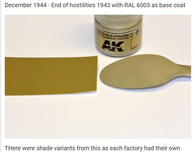

OK, I went back to the original FSM thread, the last spoon entry seen here, (but not the 4 spoon line-up I posted) does look like the color in question and is of the right time period.
But only the paint on the spoon.
The Hex Code for this spoon;
I resampled the SdKfz 9 and plotted its color vs the last spoon;
Final spoon Dunkelgelb
Final spoon color.
Resampled SdKfz 9
As you can see in the new vs current color window, they are rather similar. Now thrown in all the variables… and I corrected my error in posting this last image. Compare the RGB values.

So this RAL chart is official Wehrmacht quartermaster?

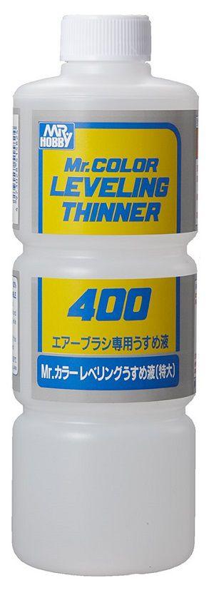

One Thinner To Rule Them All
one Thinner to thin them,
One Thinner to filter them all
and in the darkness bind them.
Introducing my precious! :sparkling_heart: :heart: :heart_eyes:
  1. Mr. Color Leveling Thinner pick a paint that’s compatible with it for great results. I don’t think it hardly matters which paint if your using Mr. Color Leveling Thinner.
Tamiya, AK Real, Gunzy, Model Master, Floquil or other compatible chemistry paint.
  1. Keep your airbrush in excellent condition and clean.
Previously, I felt some paints were better than others and that’s probably true to a degree. However, I’ve seen others and experienced for myself excellent results with a variety of paint products.
Long discontinued Floquil Railroad & Floquil Military Colors were and are my favorites. I always got my best results with Floquil products. However, after starting to use Mr. Color Leveling Thinner, I found I could get the same Floquil Quality results with a wide variety of paints.
Of course you will need excellent ventilation. This guy had poor ventilation.
You will find that thinned 50/50 with Mr. Color Leveling Thinner, you will have the best airbrushing results with Tamiya and AK Real Colors. Shoot at 12 - 15 PSI. In addition, AKRC offers 4 shades of Dunkelgelb. Simply the most enjoyable airbrushing experience you could have.
