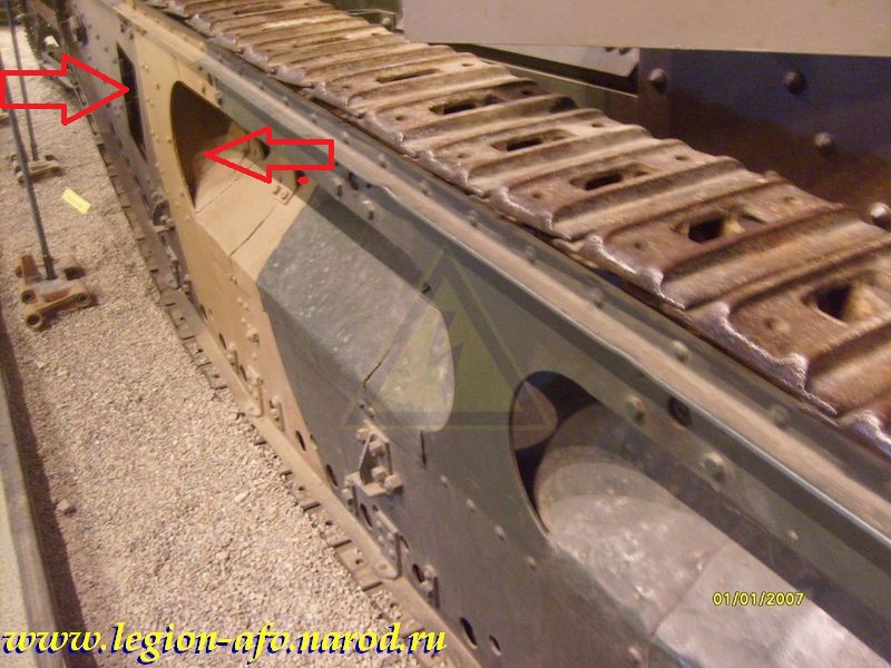

Thanks! I have seen the landships site but this Russian site is new to me. There are some great details. What I have no idea about is how the engine sit on the chassis. All the pictures are taken from the left side - I wonder how the right side looks. There is no picture online of the Daimler M1910 engine used in the LK-II.
Luckily this Russian site shows the underside of the tank. That was something I needed. My other wish is seeing into this part. I’d like to see how it looks inside.
I have the MR Modellbau kit. Well… it has so many flaws… While trying to correct them I have decided to thin the walls and open of the doors to show the inside. That’s why I need photos of these nooks and crannies.

Thanks @srmalloy, I am aware of these videos. As for the Strv m/21-29, it has a Scania engine. I’d like to scratchbuild a DB Model 1910 engine but from these photos it’s not possible unfortunately. That’s why I need some detailed photos taken inside the engine compartment showing parts not visible otherwise. Next to Chieftain’s video I have some photos from different angles but I’d like to see how the engine sits on the chassis for example. How the bottom half of the engine looks like.
Judging by the shadows, the sloped plate is one continuous piece, and the vertical dividers are just flat plates across the outer edge, if that helps..
