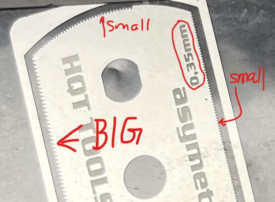

Asymetric: Has two or maybe three different tooth sizes, blade is 0.35 mm thick
Symmetric blade: Same size teeth all sides, blade is 0.5 mm thick
Symetric = all sides are equal/same no matter how you turn it
Asymetric = something is different depending on how you turn it
Width of cut could be influenced by the teeth being angled slightly outwards.
A saw tends to bind in the cut if the teeth cut the same width as the thickness of the blade.
Doesn’t matter for shallow cuts.
There’s also the asymmetric handle, which helps you see what you’re doing.
These are Photo-etched blades - there’s no asymmetry in the blades’ profiles lest anyone thought that. The kerf is going to be the thickness of the teeth, unless your technique is all assed up.

I don’t think the true asymmetric kerf really plays into these blades as @18bravo stated. I believe this just to be a more aggressive saw blade due to varying saw tooth depth, hence why they call is asymmetric. I believe .5 and .35 is actual tooth depth, not blade thickness @Uncle-Heavy.
If I had looked closely I would have noticed that the asymetric blade
has both numbers:
:man_facepalming:
Manufacturers just love throwing big words around…
—mike :grin:
It’s all about the teeth position at the radius ends of the saw blade.
