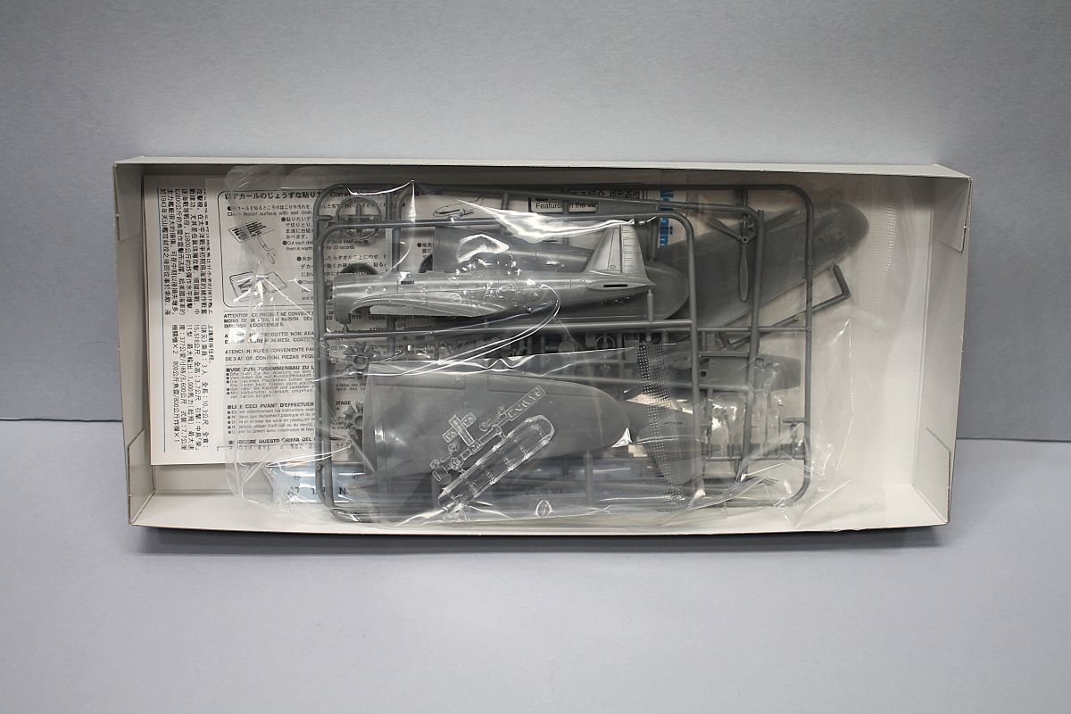

The kit just arrived, off to give the plastic a wash then start cockpit painting.

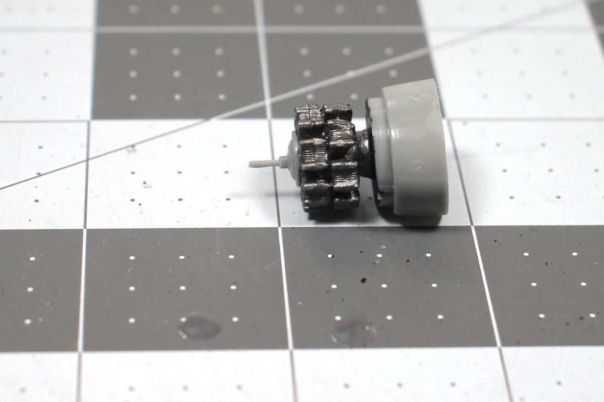

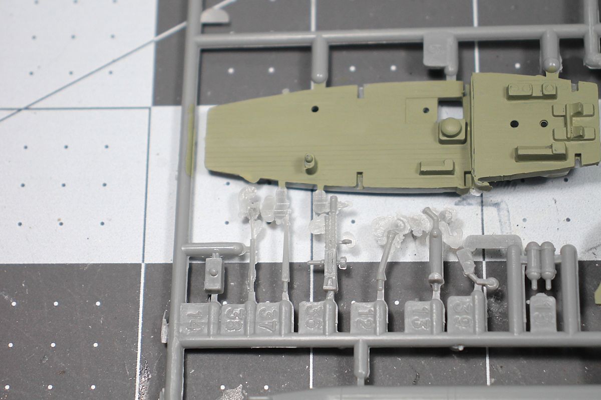

I did some detail painting and assembled the engine.

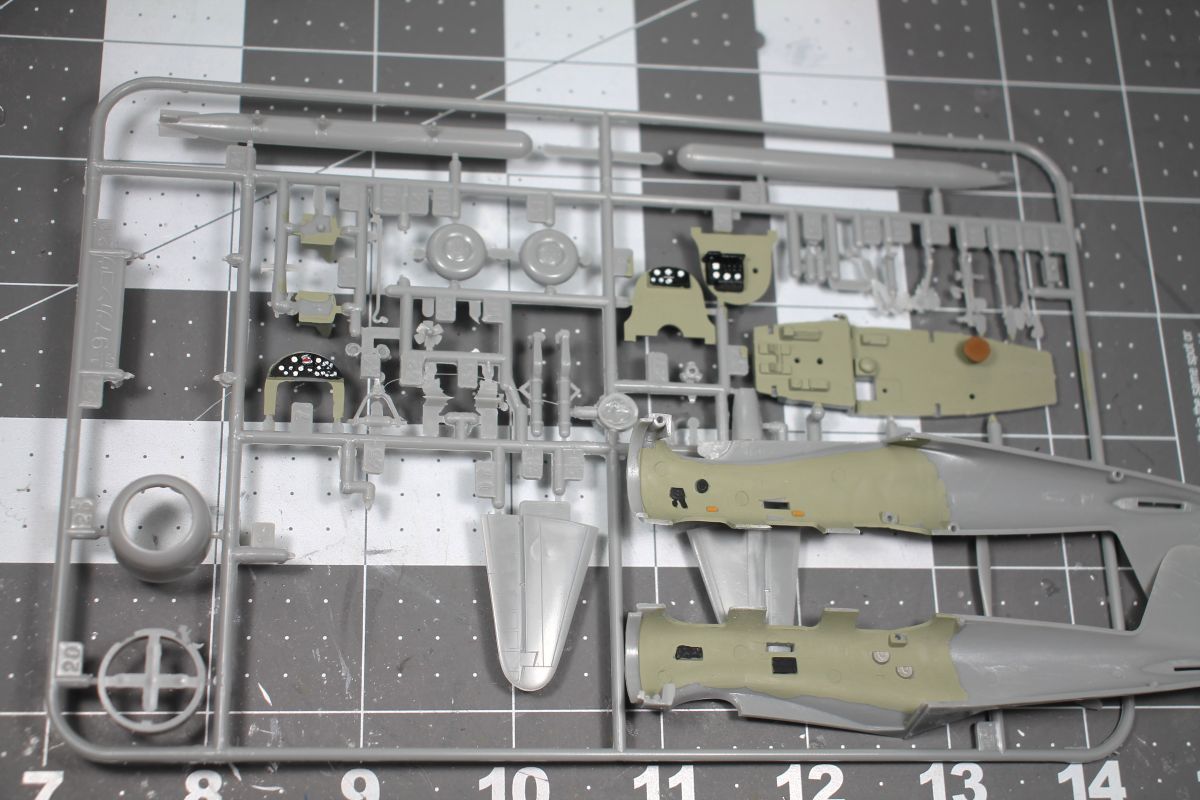

Some more detail painting of the cockpit.

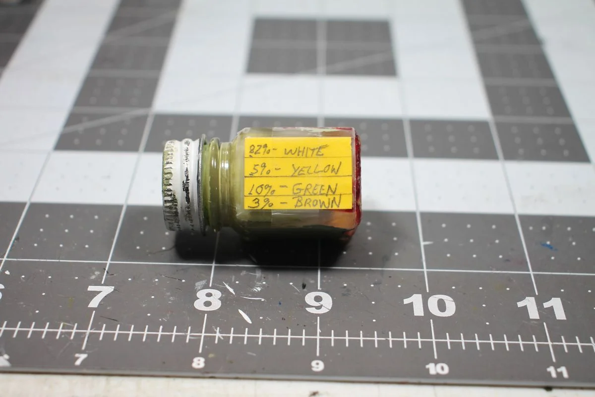

What green did you use for the cockpit interior?
This green, mixed it with acrylics years ago using Hasegawa formula in the 1/72 Kate instructions, bottle is almost 20 years old.

Paint looks good. It’s very similar to a bottle of AK ‘s Japanese Interior Green I picked up not long ago. The greens not as strong as Tamiya’s.

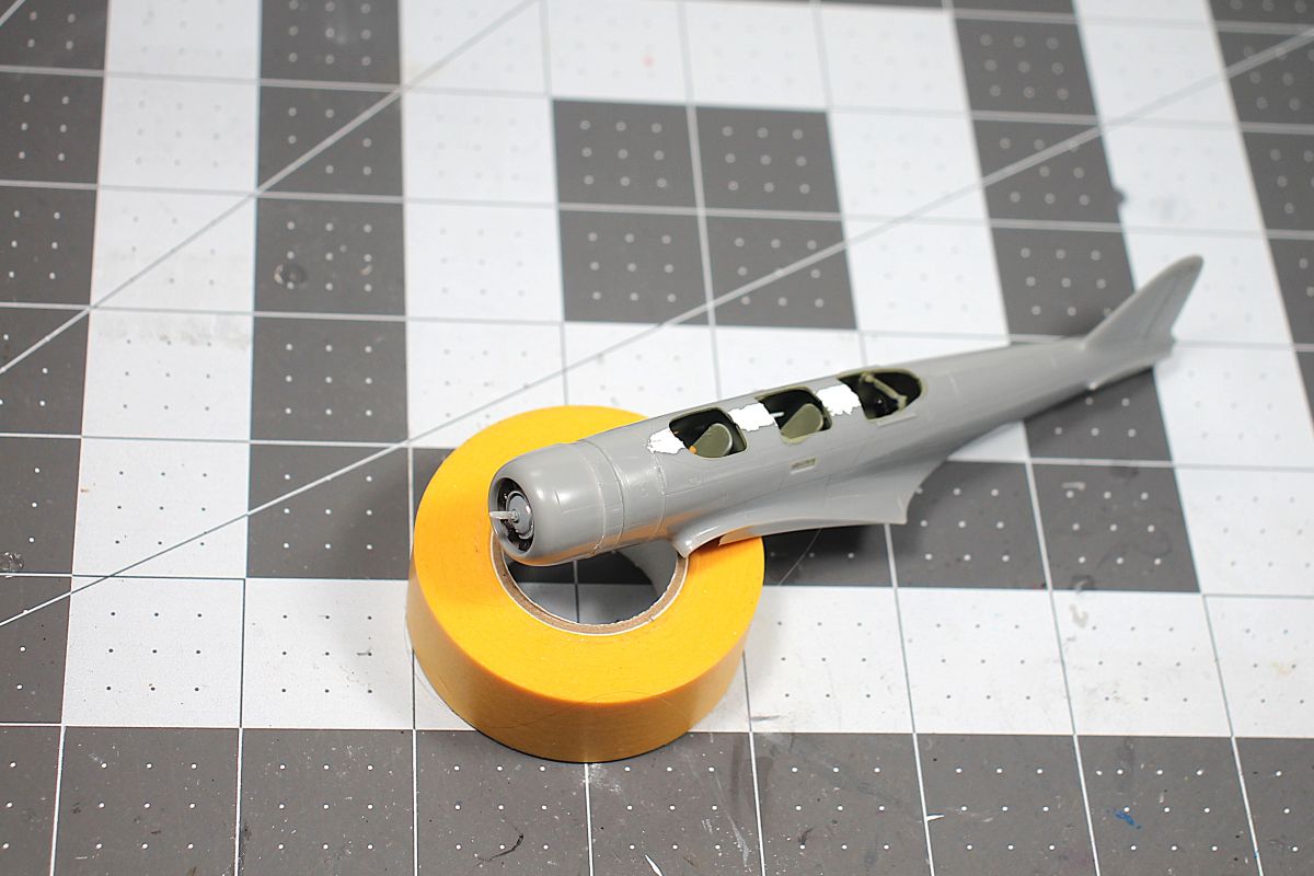

I have the fuselage and cockpit closed up with machine gun in rear stored for a closed canopy. I also have the engine and cowl on and some seams on the upper fuselage puttied.

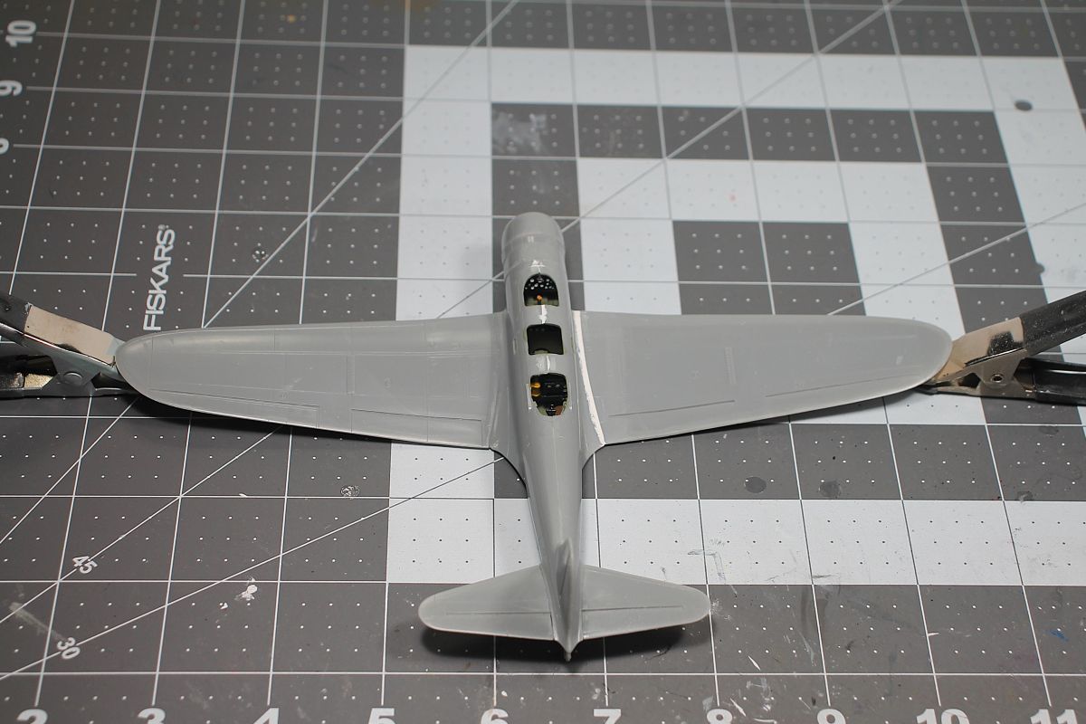

Wings on and puttied up.

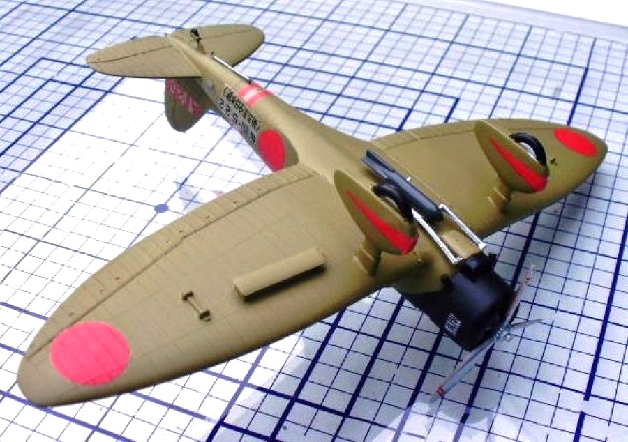

Back from house hunting. I have one update, bottom painted and canopy on. Will be moving 1400 miles around first week in April. May not be too many updates until June or July of this year. Very hectic next few months.
