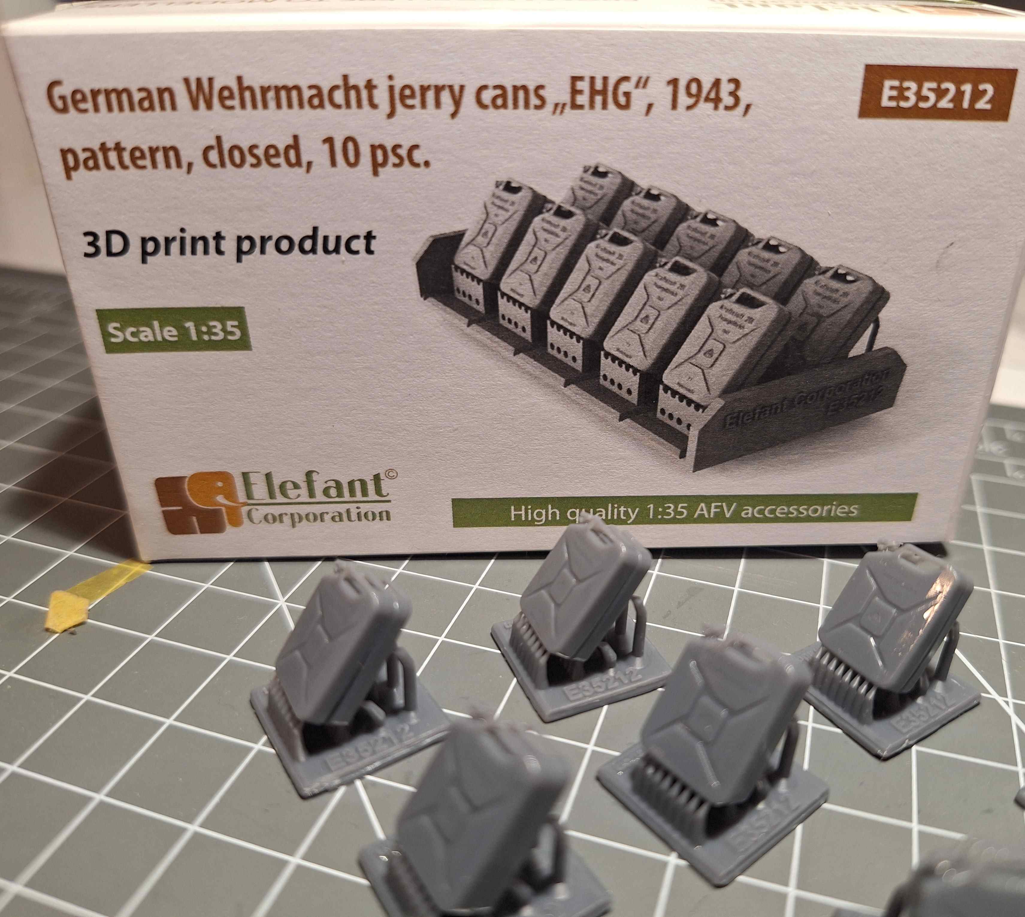

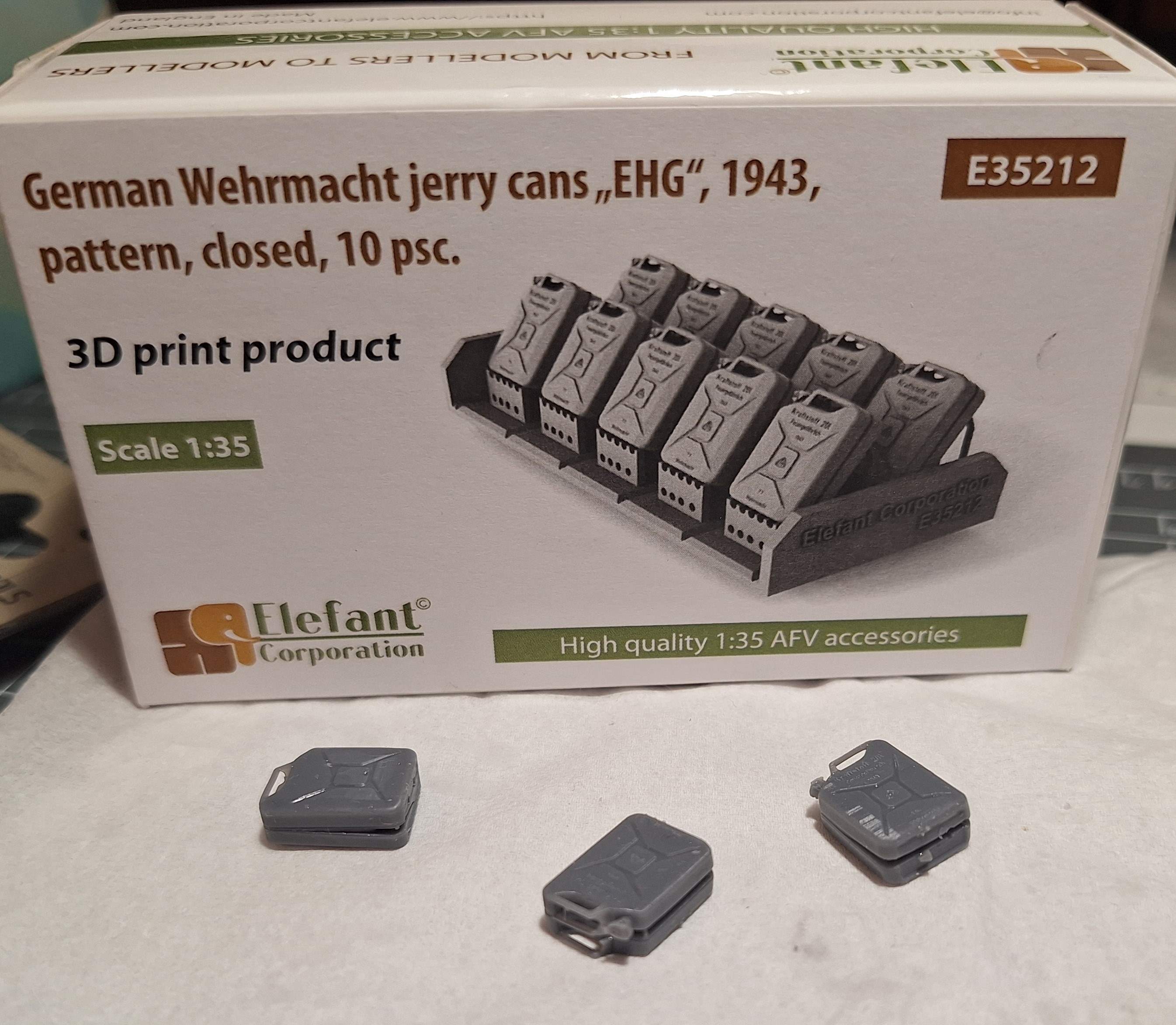

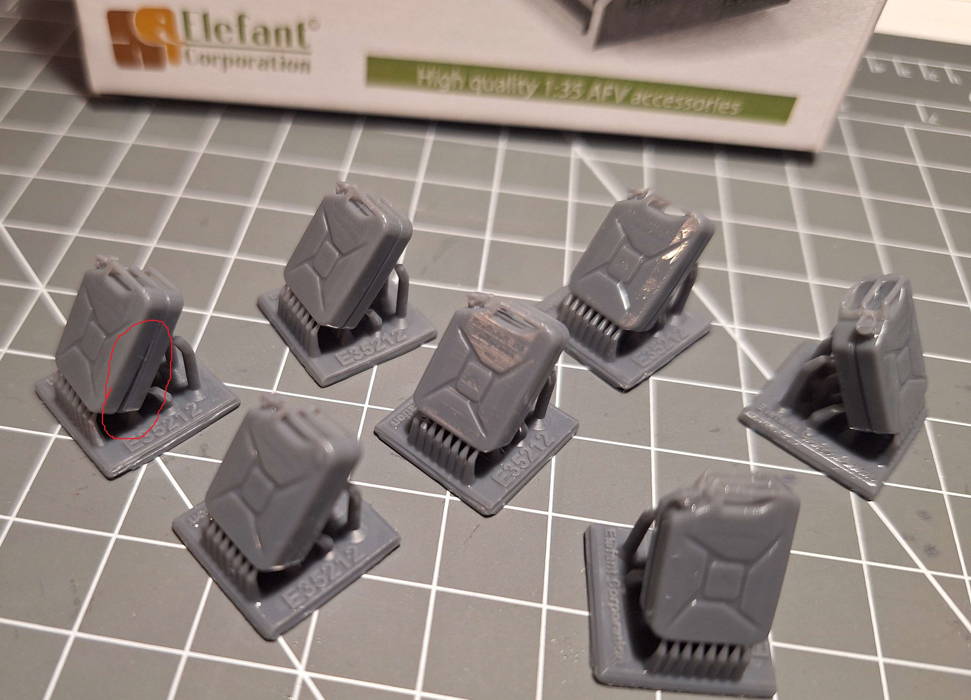

I´ve bought this set half a year ago. Now I decided to use the parts for my models but unfortunately noticed that parts are covered with a film of some liquid. as far as I understand this liquid should be resin what was dried not properly. Additionally, Jerry cans are designed as part with cavity so the residual resin was locked inside the cavity acc. my opinion. Next I noticed taht parts have been starting to be disintegagrated. Well have you already met with this also? Or any other experience with this producer? Thank you very much for your feedback.
if they are hollow, then it looks like the drain holes aren’t big enough and it wasn’t flushed properly. I’ve had a couple of resin parts that i printed crack due to not cleaning out resin properly, but these were large pieces. I’m surprised the company would make something as small as jerry cans hollow.
the only thing I can suggest is to wash the pieces in IPA, let them soak, make sure the IPA gets inside and try and flush it out. Wear gloves and a mask, resin that isn’t cured is nasty stuff. I’d reach out to the company as well to let them know about this as well
