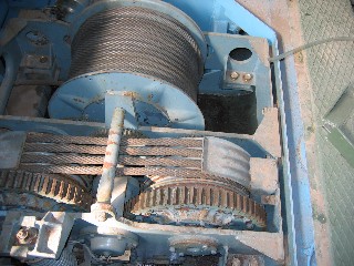

We continue with the installation of the cable winch. There are also photos and original images. Unfortunately, none of this is included in the kit, you have to build everything yourself.
