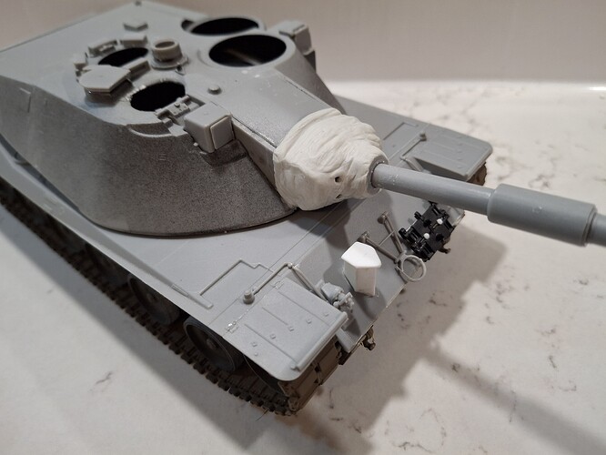

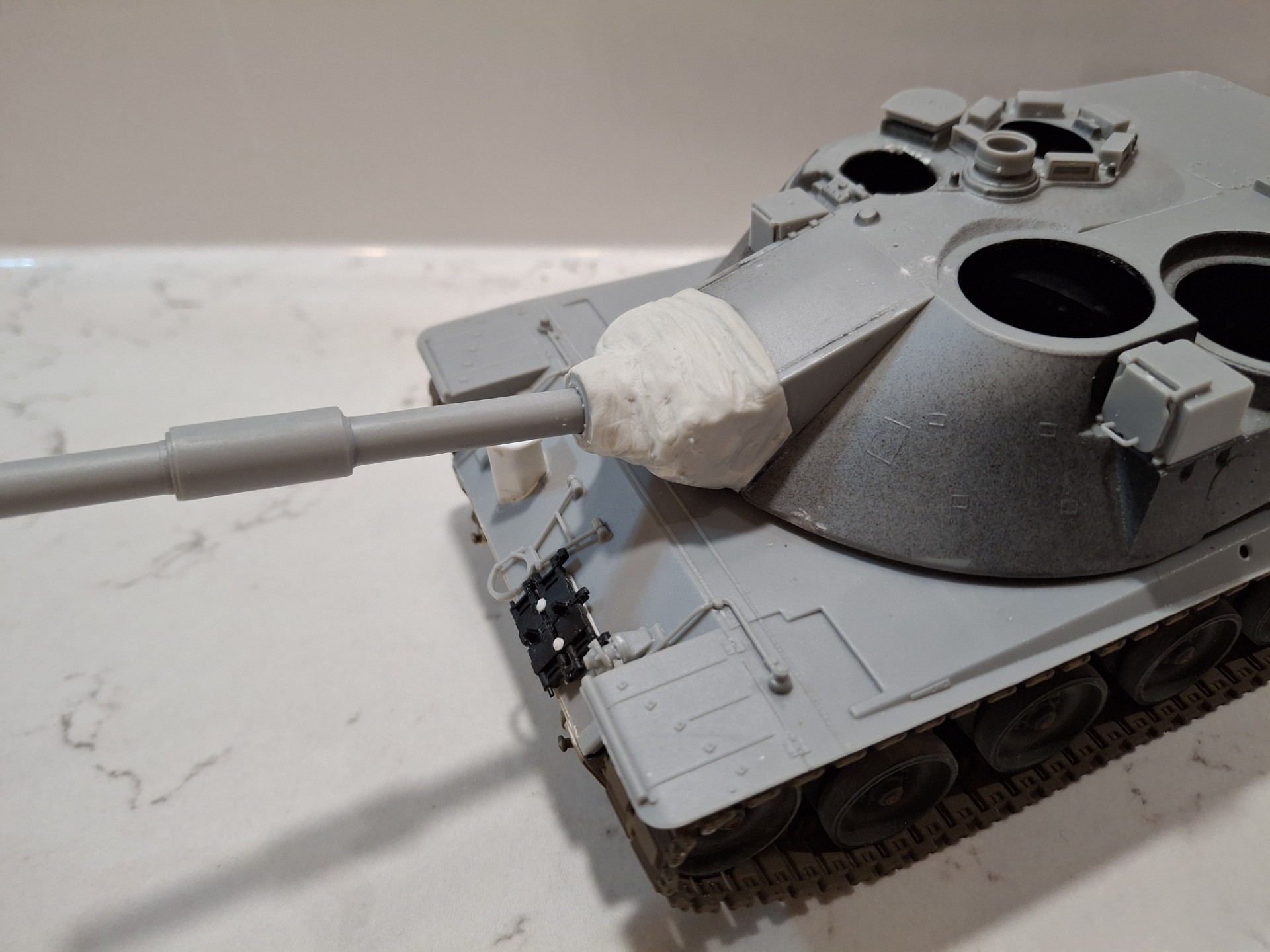

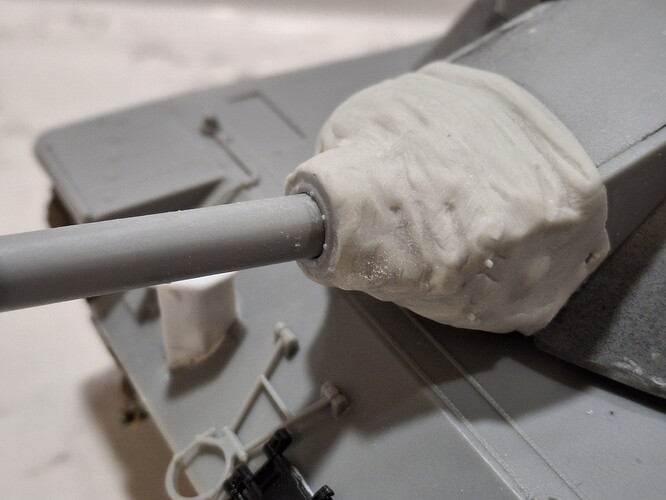

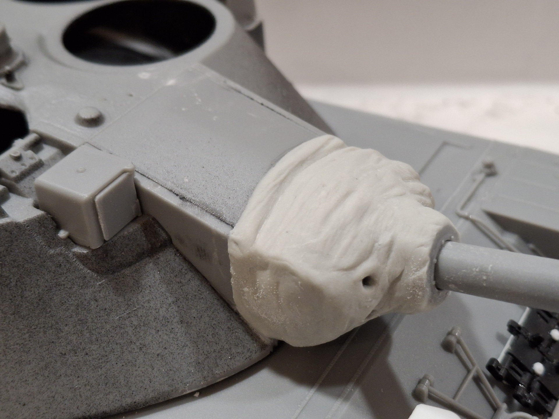

I’ve finally tackled the mantlet cover - surely a must if this had ever seen service; not my finest sculpting effort so don’t look too closely. I’ll try some gentle sanding in the morning(!)
I’ve also used the Magic Sculp to contour the Gunner’s hatch which I’ve had to scratch (not shown).

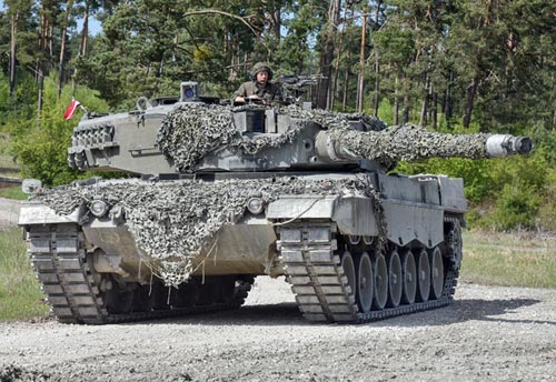

Just for future reference to those who might be dipping into the Campaign, I plan on adding camouflage nets somewhat akin to this Leo 2:

Good question about that: would it have been American-style like you have it here (may want to add M60-type bellows around the barrel, too, BTW) or German-style that just covers the gap between turret and mantlet?
Yes - a tricky one; apart from the weather also vital for NBC protection - all that liquid blister agent has to go somewhere. Of course, in this narrative it would be the German version that (I’m assuming) the Dutch would acquire, so more likely a sparser mantlet cover really would be required, however, I’ll save that for my Bundeswehr version.

You could always explain it as the Dutch Army being familiar with the covers from the Centurion and wanting much the same on their Gvt 70[1] rather than the smaller cover the Germans used.

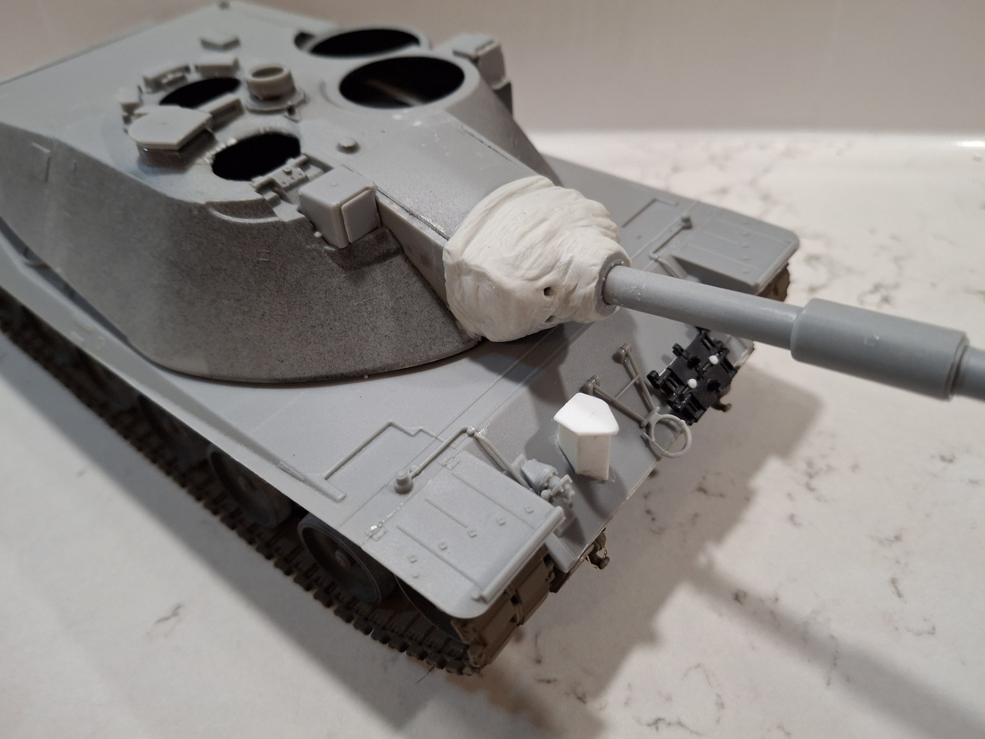

Admittedly a subjective view, but in the cold light of dawn - or at least my kitchen lighting - the mantlet cover hasn’t come out too badly at all I feel:
Coming along very nicely indeed, Brian. Like the mantlet cover.

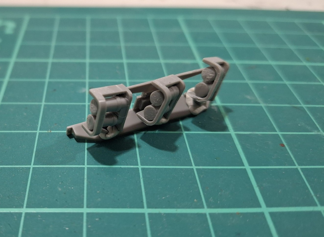

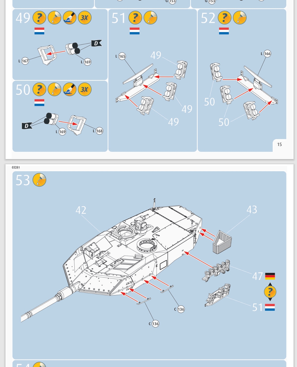

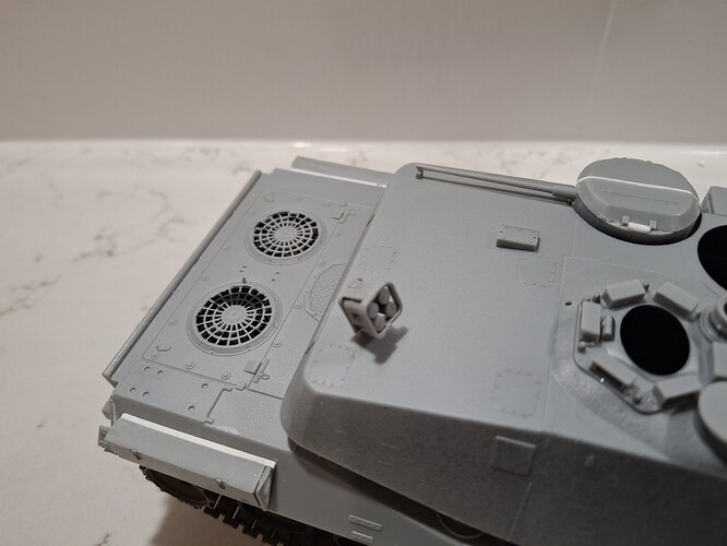

Right Folks, I’ve hit a bit of a problem here. I’m in the process of installing the distinctive Dutch pattern smoke dischargers. I’m using the ones from the Revell Leopard 2A6, shown on their instruction sheet here:
Here’s the constituent parts Blu-tak’d together:

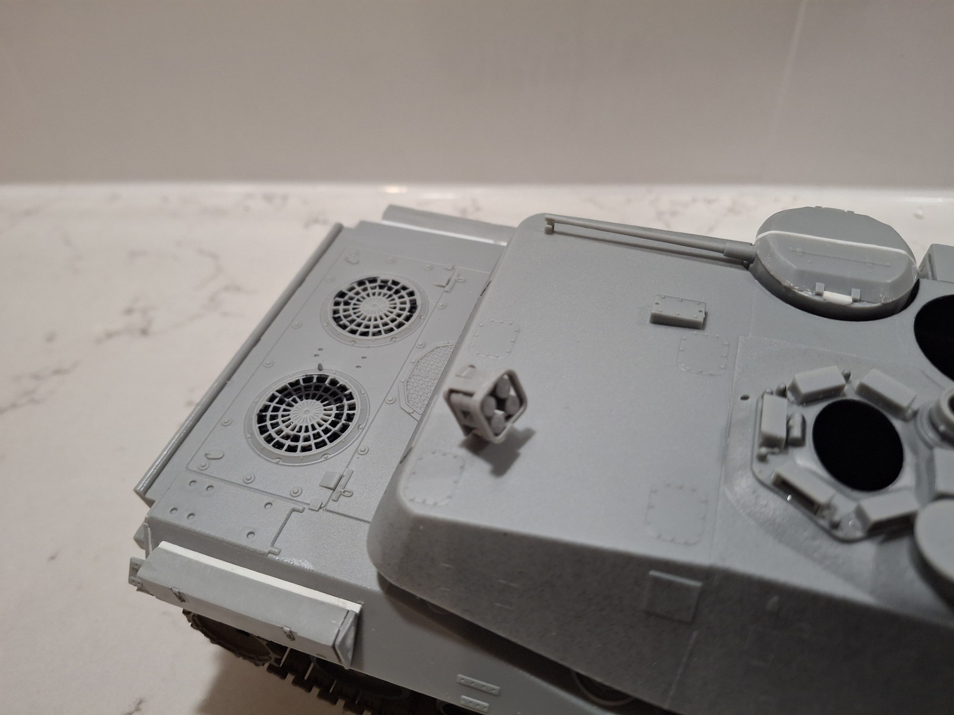

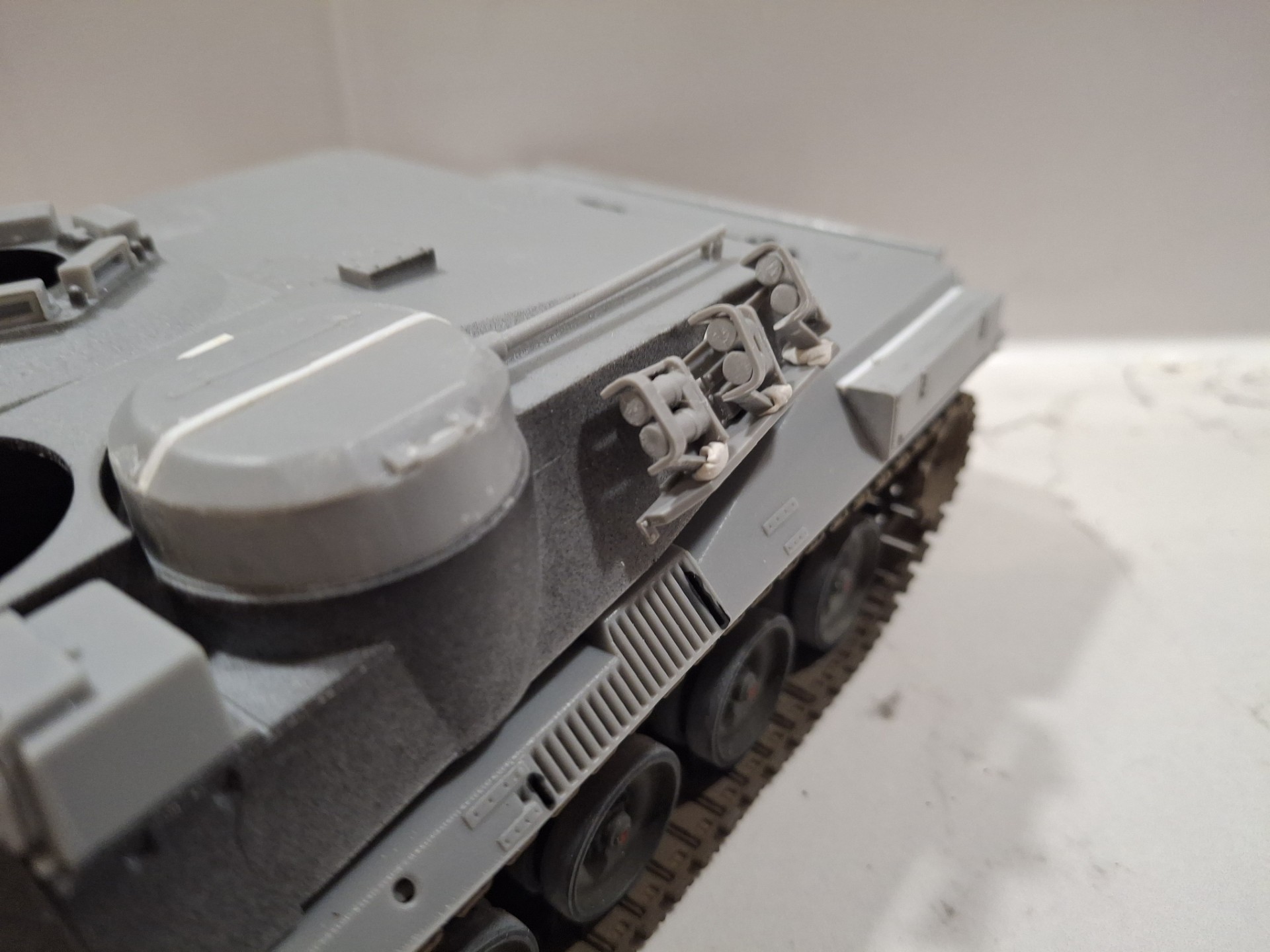

But of course, for the Leo 2 they fit against a completely vertical surface (and look just fine); if I apply them flush to the MBT-70 turret (which isn’t vertical), they look a bit odd - although if this makes mechanical sense let me know:

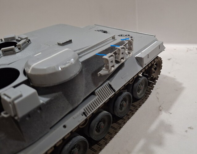

If I move them out so they’re perpendicular, which sort of makes sense in a way - they still look odd:
I could add some sort of bracing strut - say a continuation of the protective frame of the launcher to the turret side, roughly shown here (in blue) which might reduce the oddness:

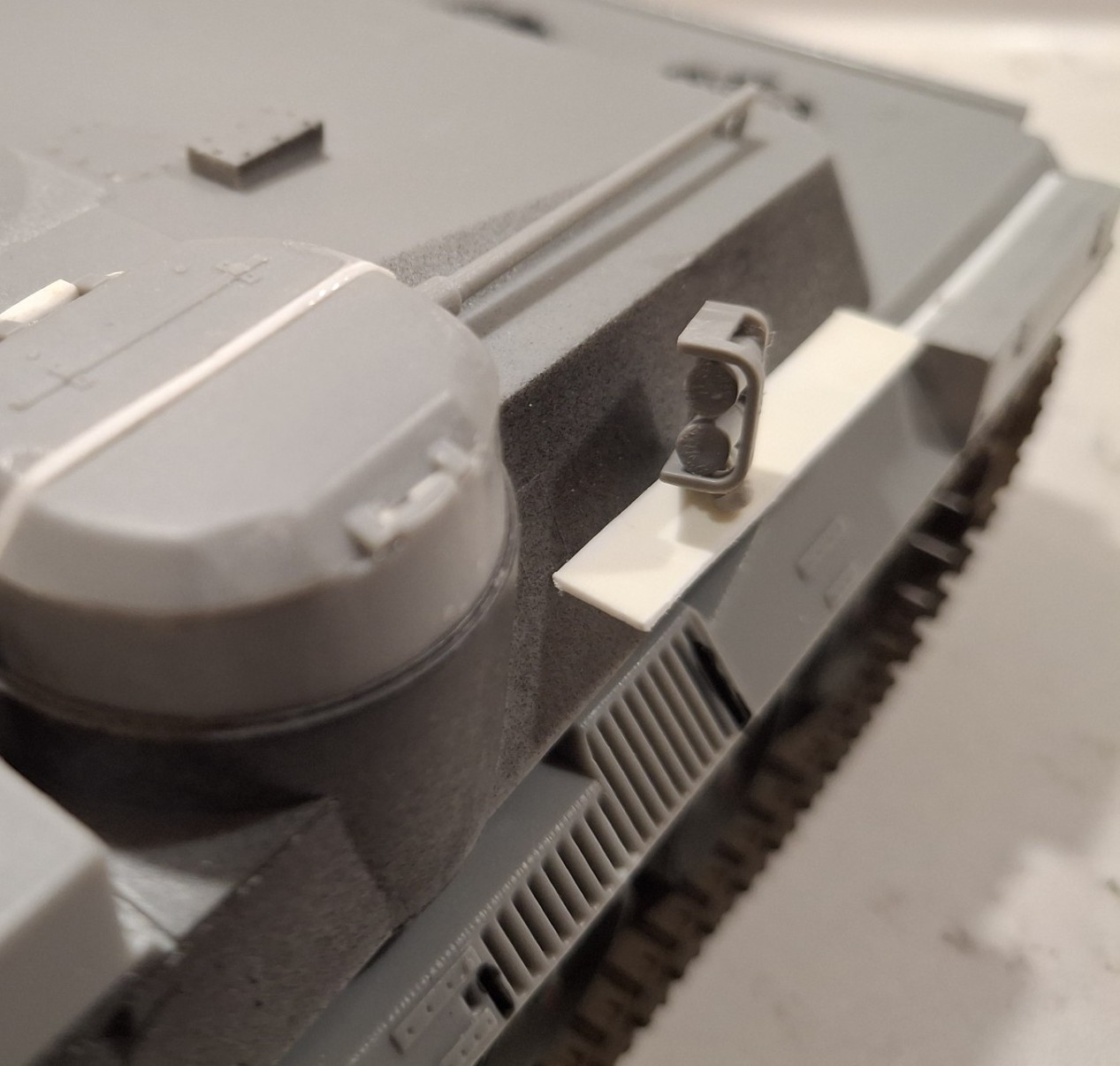

or, even scratch a platform, roughly shown here:
and still consider adding a continuation strut of some sort.
Any comments/ideas welcome.
I’d go with the bracing struts and the kit shelf. Bear in mind you need to aim them out enough so they don’t ricochet off of the 20mm barbette!
Yeah, I was kinda going that way myself, or possibly with a blanking plate (vertical) behind the launchers and then some struts.
Don’t worry Tom, re the angle of the dangle - they’re only Blu-tak’d and I’ll check with CSI-type rods to make sure there’re no own goals!
You do know the dead space behind the bracket is a magnet for all kinds of unauthorised stowage!
So true; I also came up with this - sort of á la Jagdpanzer Kanone. There’d be 3 x of them. Well, there is all that space on the turret top:

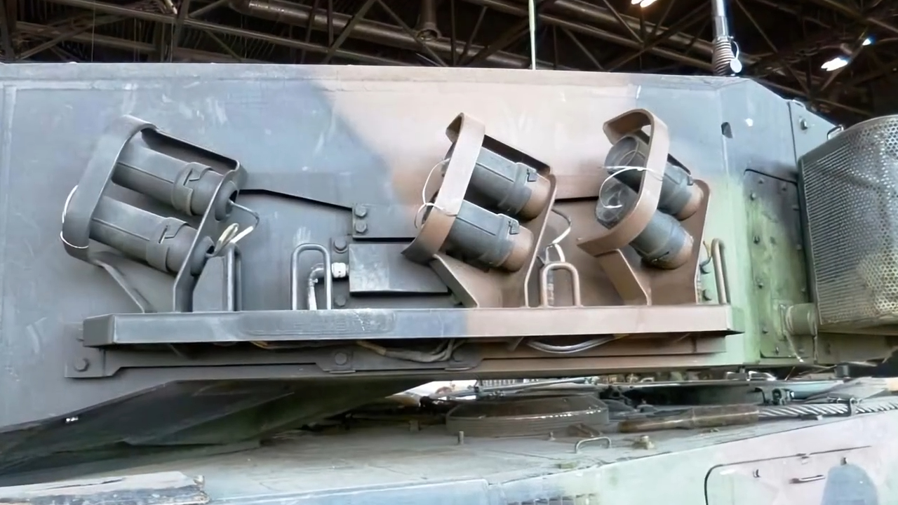

Having cast around for a bit, I realised that one of my earlier hoarded pics provides an answer - or at least in a way. The actual launchers are not flush against the turret side on a Leo 2, but still stand proud a little; see below:
So, whilst it may look a little odd, that might be the way ahead; I’ll do some more faffing around and see.

Likely, I would fit them flat against the turret using the Revell parts for the base, but you would need to turn the front launcher on the left outward, because it would hit the base of the 20 mm turret otherwise. Or fit them more towards the front, if there’s room below the missile tracker housing.

Regarding the smoke dischargers: I think I’ll have to fit them flush; every other option is getting too complicated.
