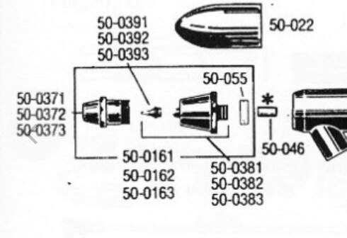

What type of airbrush do you use ? When I remove the tip from my Badger 150 it doesn’t spray at all.
The Badger can be “tuned” (abominated) to do this.
Part 50-0371 /..72 /..73 is the tip in question BUT it also provides the small opening around
the nozzle, part 50-0391/..92/..93, which creates the required airflow around the nozzle to
make it spray. If the the tip is left off the airbrush will not spray.
The tip can be converted by filing down the front to remove the raised circle.
This will however expose the tip of the needle and the nozzle to damage by being rammed
against hard objects. This modification can not be undone so it is advisable to buy a second
tip and only use the modified tip for special jobs.
The part number triplets are because these parts are different for different needle sizes.
Other airbrushes have a different design for the tip.

Check parts diagrams for other airbrushes, or get a spare tip for your 150 …

I wasn’t clear. Just removed the guard on the end, exposing the needle.
Never tried @Uncle-Heavy idea.
It depends on how the airbrush is constructed.
On some the guard is only a guard,
on the Badger 150 it is a guard AND a necessary
part of the spray function
