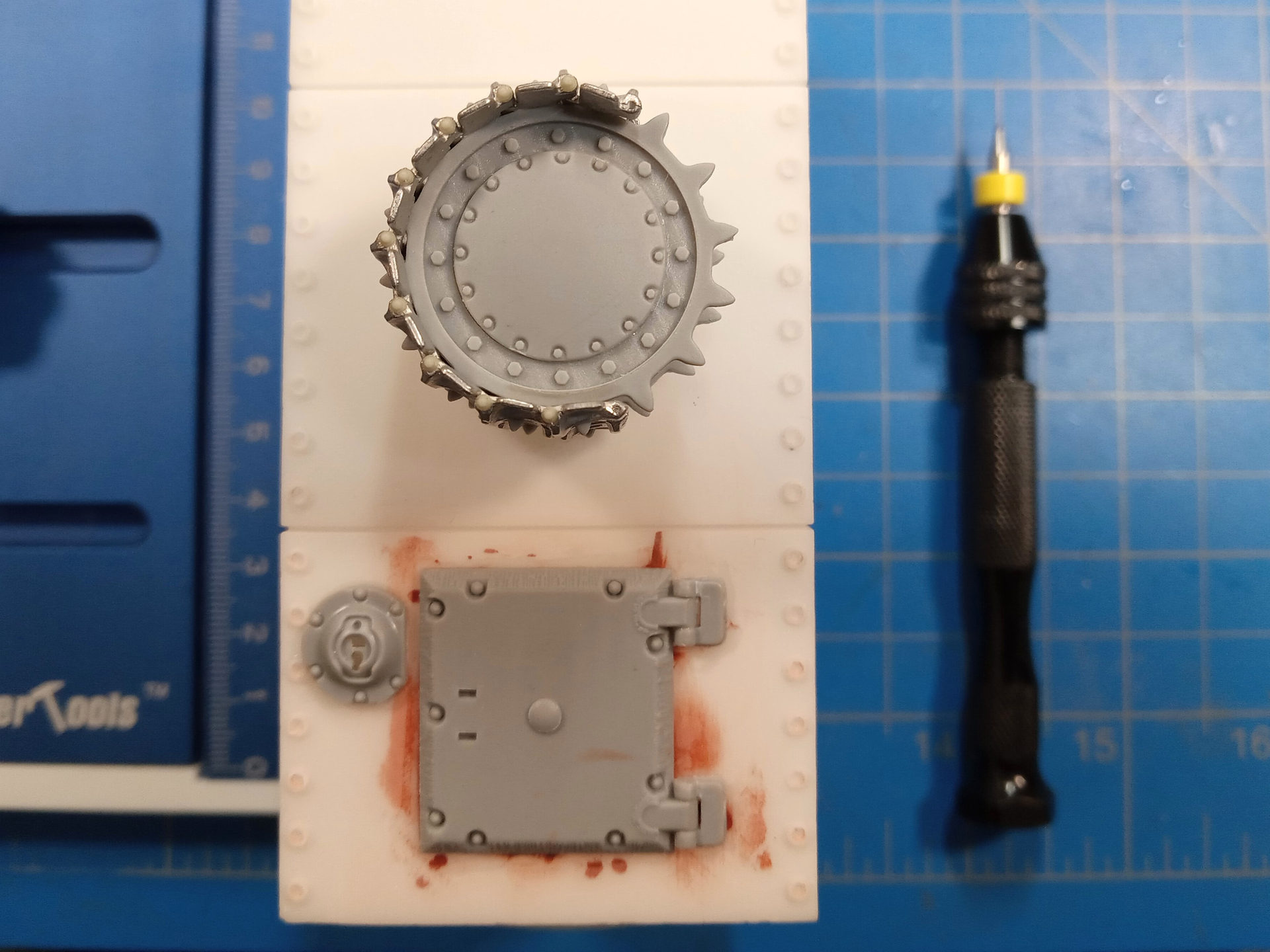

10 links at a time in a set, then add the sets together. Pin holes call for a 0.6mm bit, but I find the 0.5 is better IF needed. And, the Master Club tracks fit nicely to the Trumpeter drive sprocket. Whew!
Kit turret rear hatch and MG port has been added.

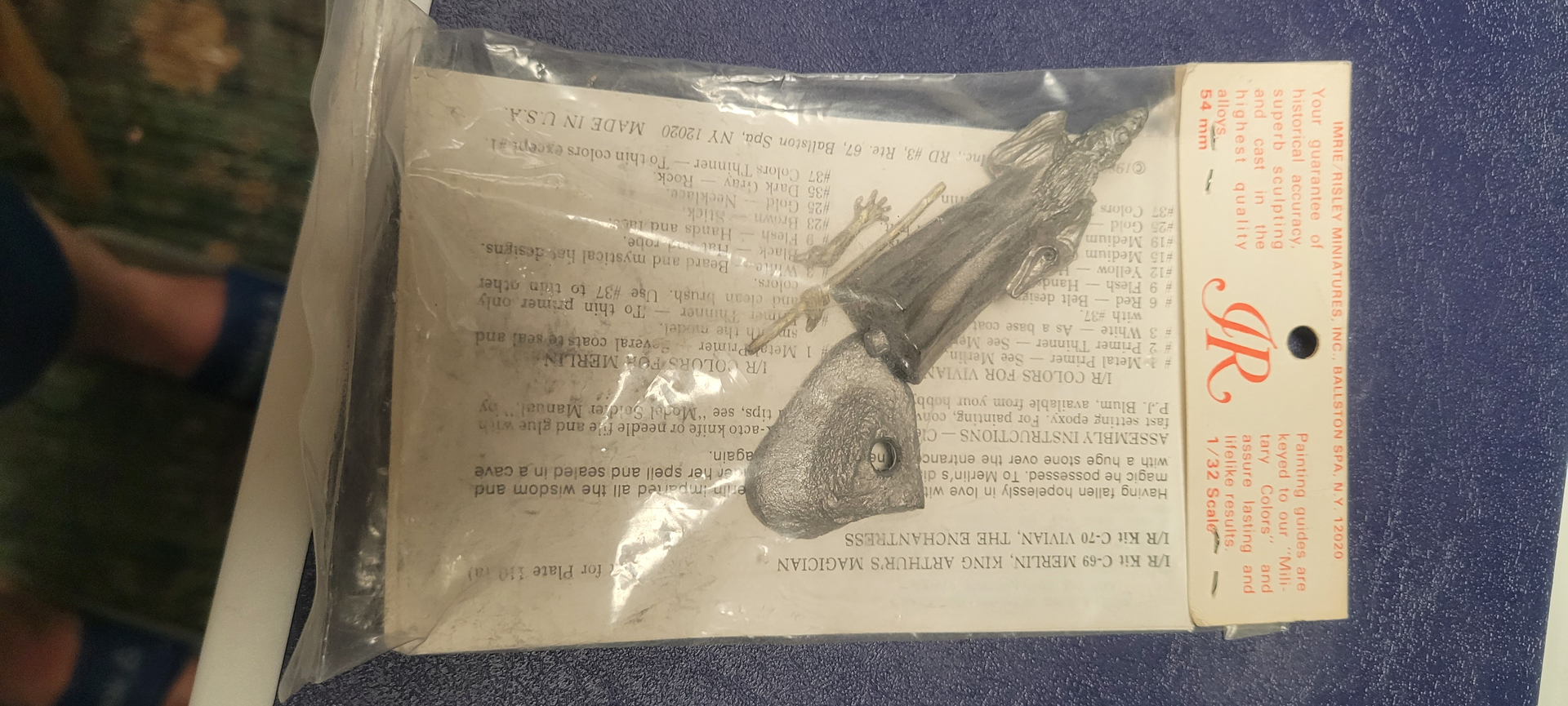

I’ve settled on a figure, I have 2 kits to finish this year and 5 in various stages so something I can actually complete is nice. The IR Miniatures Merlin. White metal, 4 parts, 54mm.

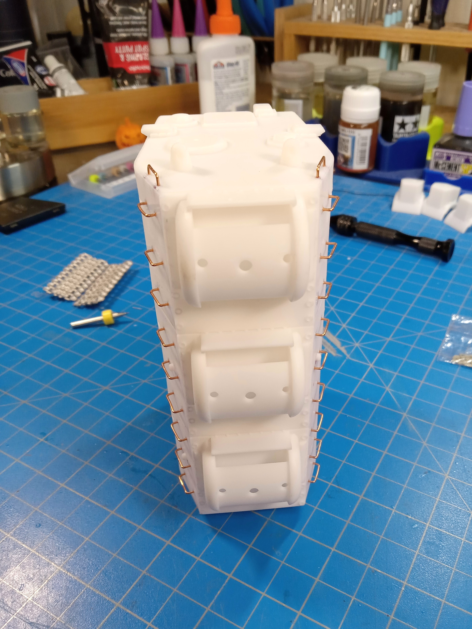

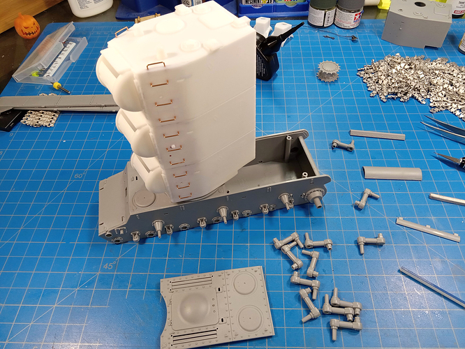

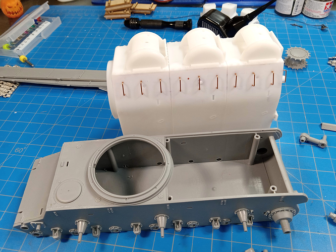

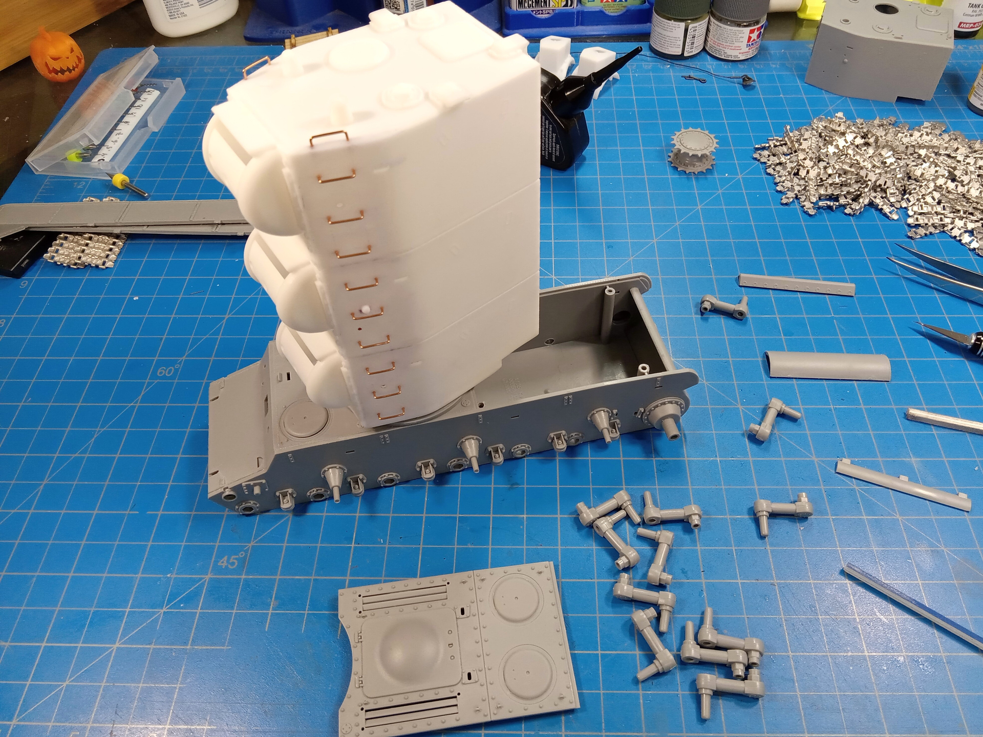

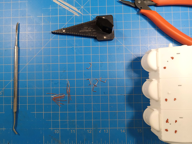

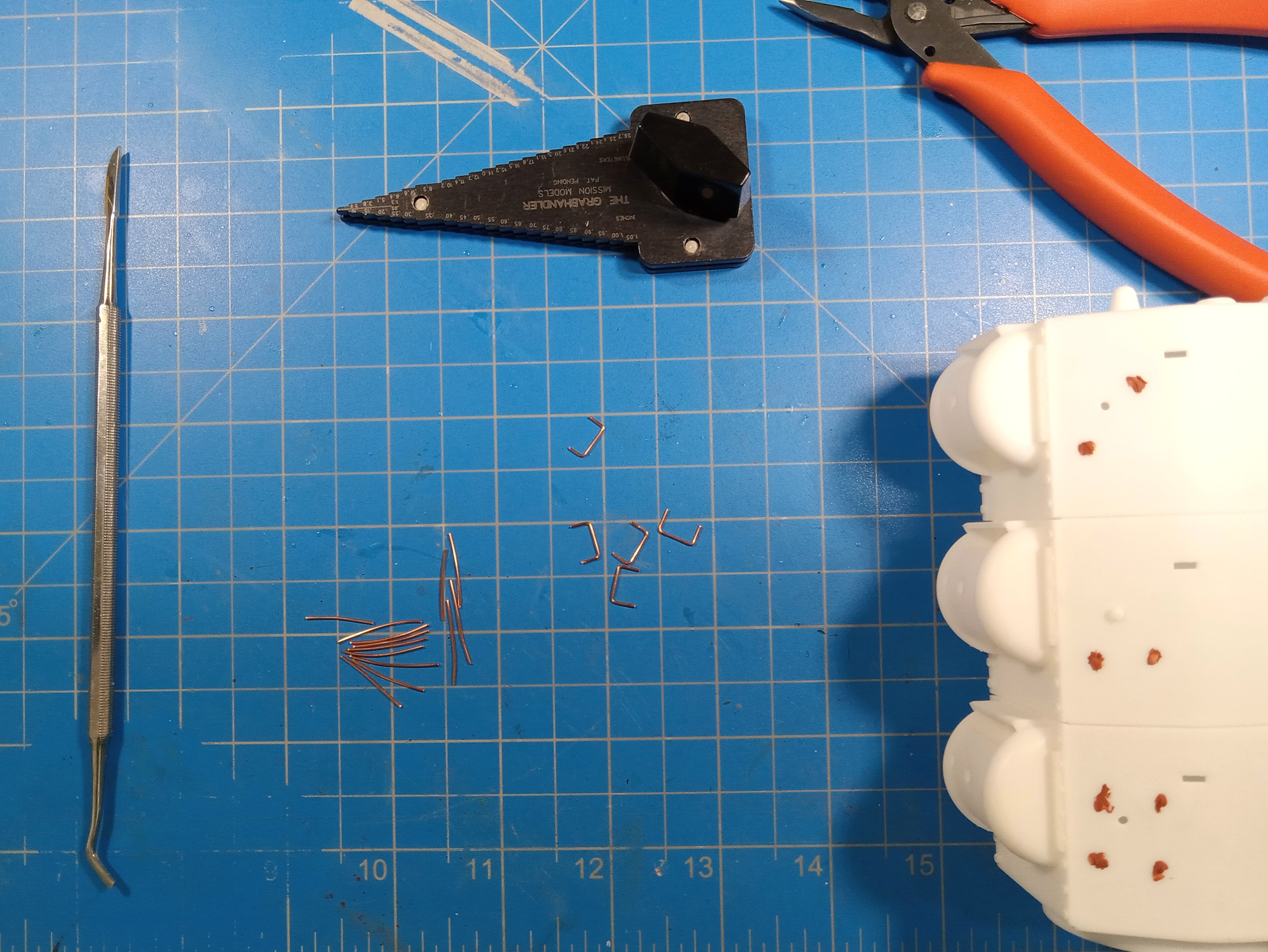

Working on the grab handles. I’ll be putting on nine per side, evenly spaced. The old grab handles were removed and filled as necessary. I have three of the “plugs” (pistol ports?) in brass that I’ll add - that’s the two holes showing (one at the top and bottom turret on this side and one in the top turret on the other side).
Mike
Done for the night. My fingers and eyes are wore out. It was 10 per side, not nine. And of course I lost three to the carpet monster [batrastard can keep 'em!].

I’m wondering if the weight of the turret will deform the hull over time. Do you think you might need to brace up the hull a little?
if you are worried, then yes.
Surprisingly enough, the turret is very light…at the moment. Add three aluminum barrels and the mantlets? That’s a very good idea - one I didn’t consider. Thank you…I’ll look at doing that tomorrow.

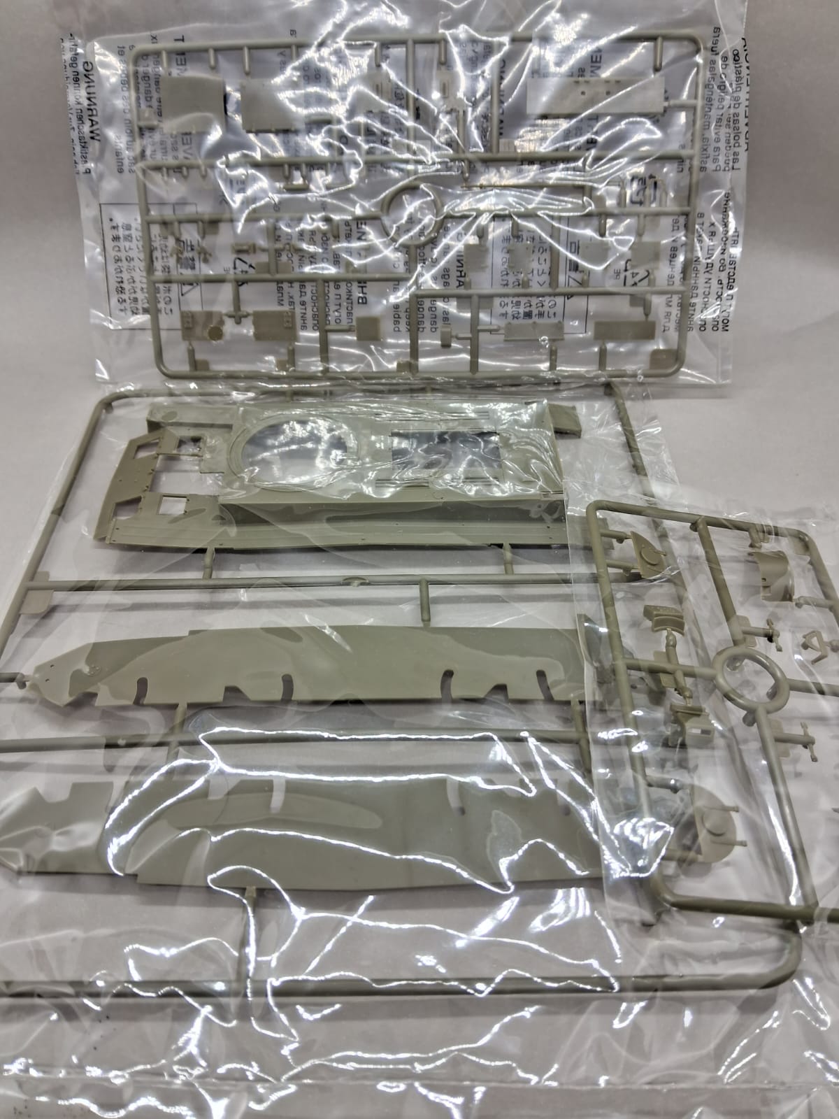

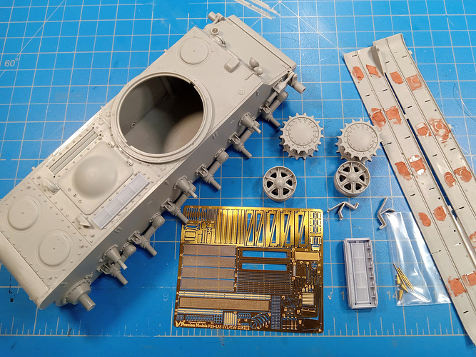

The “basic” tank hull is built. I won’t be using too much of the PE - fender supports, toolbox handles, and a few other bits.
I almost made the mistake of gluing the “mud scrapers” on…I’d have played hell trying to get the drive sprockets in place. :wink:

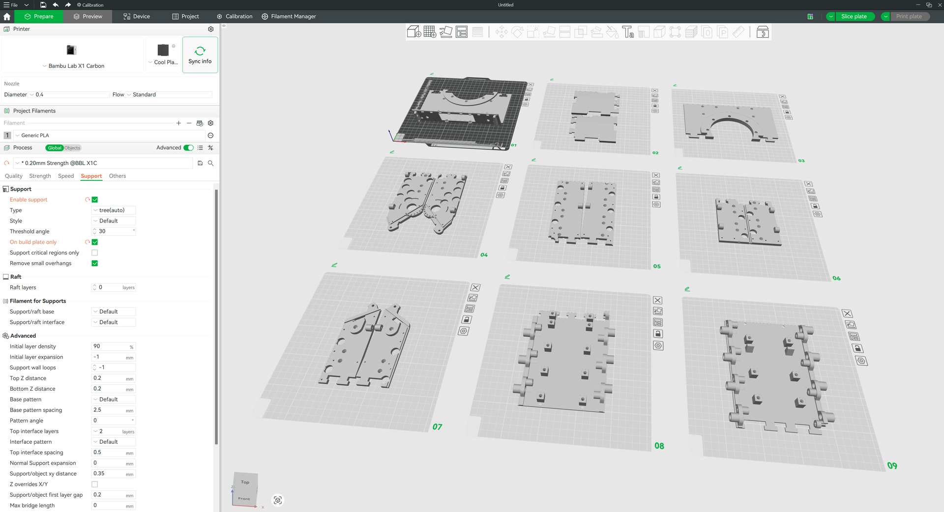

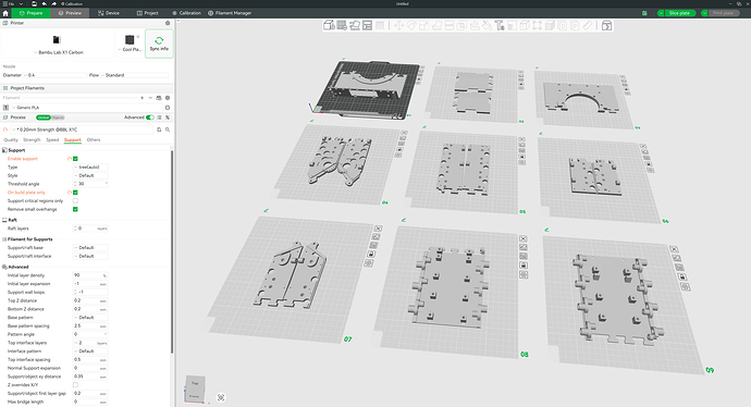

As promised to moderators here is the first series of my Campaign admission. What you are looking at is going to be the hull of a Waffentraeger, i hope. All the plates barring anything going wrong should take 22 hours to print.
Printer: Bambu X1C Filament: SUNLU PLA+ @20% Infil 6 wall loops. Print bed: Glacier supertac the model looks really clean and hopefully it produces a great example of this vehicle

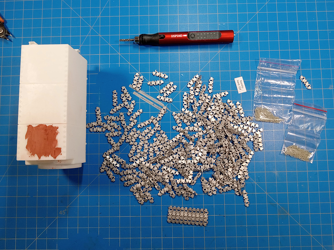

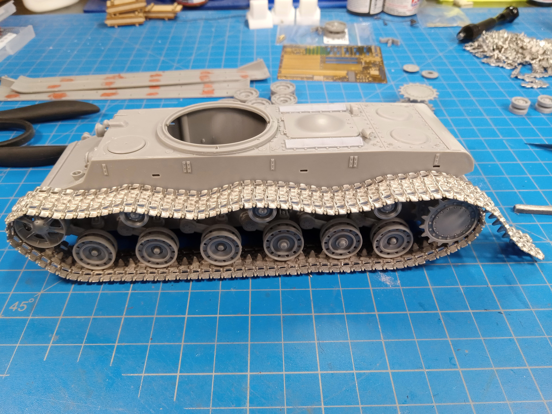

Three days of off & on, one side of the tracks is done…a bit more than I thought. :wink:

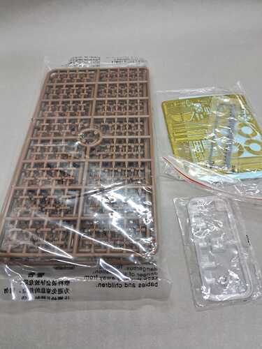

I was worried that there wouldn’t be enough links or pins (especially those as I’ve managed to lose/break a few). The kit comes with 200 links and the picture shows 100…about 10 or 11 too many depending on how much sag I want. Needless to say, I’m happy about this. :grin:

I kind of went a different route with the upper/lower hull build. The lower hull fit was iffy at times and figured adding things “later” would be a fight, so most parts of the hull have been added. I can still get the tracks on after the lower hull and tracks are painted. It’s looking like very little of the PE set will be used (more to add to my box of spare PE parts!).
