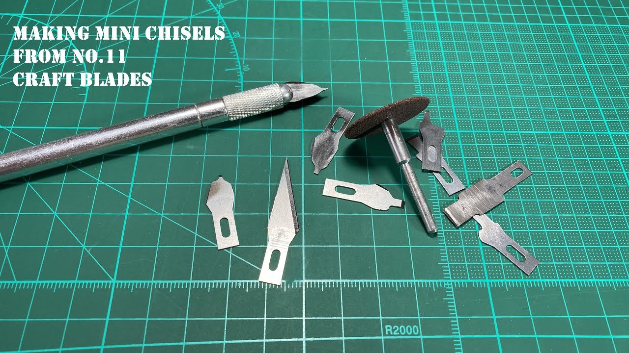

I haven’t done this….yet but you can repurpose them for some additional use. One example. You can dull the sharp edge more and use the other side of the blade as a scraper.
