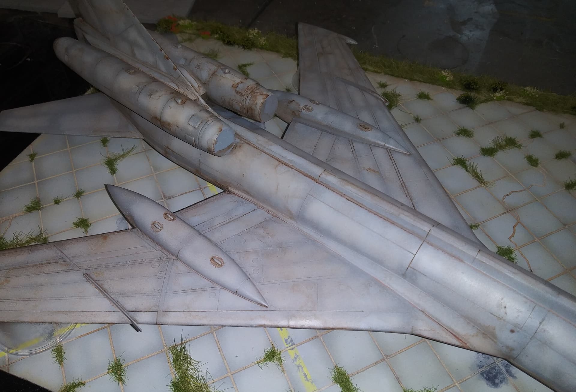

Something a bit different . Working on the old Esci 1/72 Tu-22 Blinder bomber. As per s.o.p. for me , the base had to be fabbed before the project is complete.
I am mimicking some Russian boneyard / abandoned fields for aircraft.
This old war bird is going to get the treatment.
Now I’m hoping the Blinder will be hard weathered to within an inch of its life… Can’t wait for this one

Did some canabilism work to the nose. As well as a few other details .
Black primer is down followed by a coat of aluminum. That was then sealed with a flat coat and two coats of suave super hold #8 laid down with the airbrush…
Bottom side is a pale sky grey. The top side is a dark sky grey that was then panel fades and a dark filter .

Making some progress on this one side. Chipping, pealing , mapping and exposed primer.
The next filter and steps will tie it all together.
@Johnnych01 … This is weathered to within a inch of its life

Thank you. There is still much to do
yes, but what is there is very promising.
@drabslab . Thank you my friend … I need to set it aside for a couple days and let the old grey matter work it out
Very nice idea and execution. However I do think those red stars would have faded to a pink shade over time. Possibly the inlet covers as well.

the aircraft looks great, my only grumble is all the concrete panels look to uniform. a wash over some of them wit a darker shade and perhaps some cracks in the cement as this appears to be inactive section of runway, so it wouldn’t be as cared for.
just my tuppence worth.

@Klaus-Adler . I agree with your statements. This one gas been sidetracked for a bit while my mind works on it
Chris, have a look at the last post with the pictures I did earlier today of an old WW2 RAF station where I live and the concrete and tarmac areas. Might give you some ideas.
