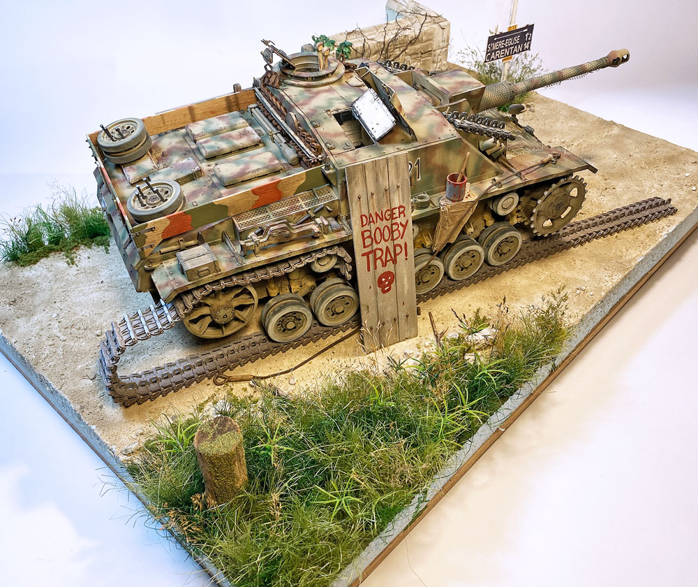

BOOBY TRAP ! Stug III Ausf.G Early Normandy June 1944 DAS WERK 1/16

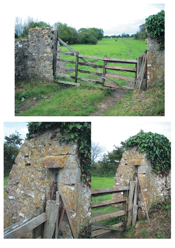

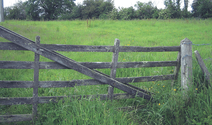

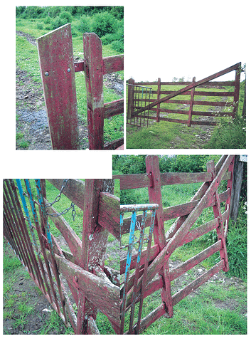

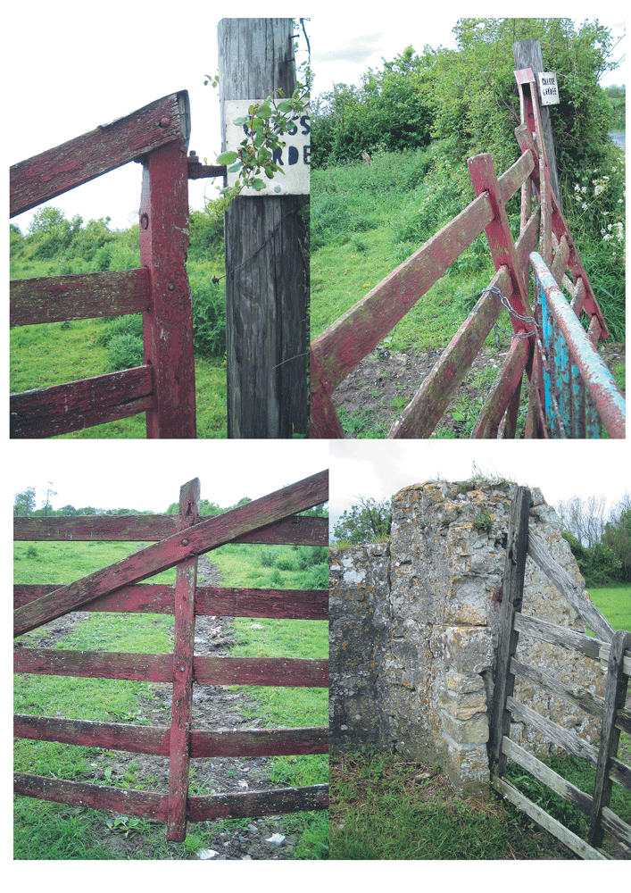

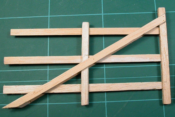

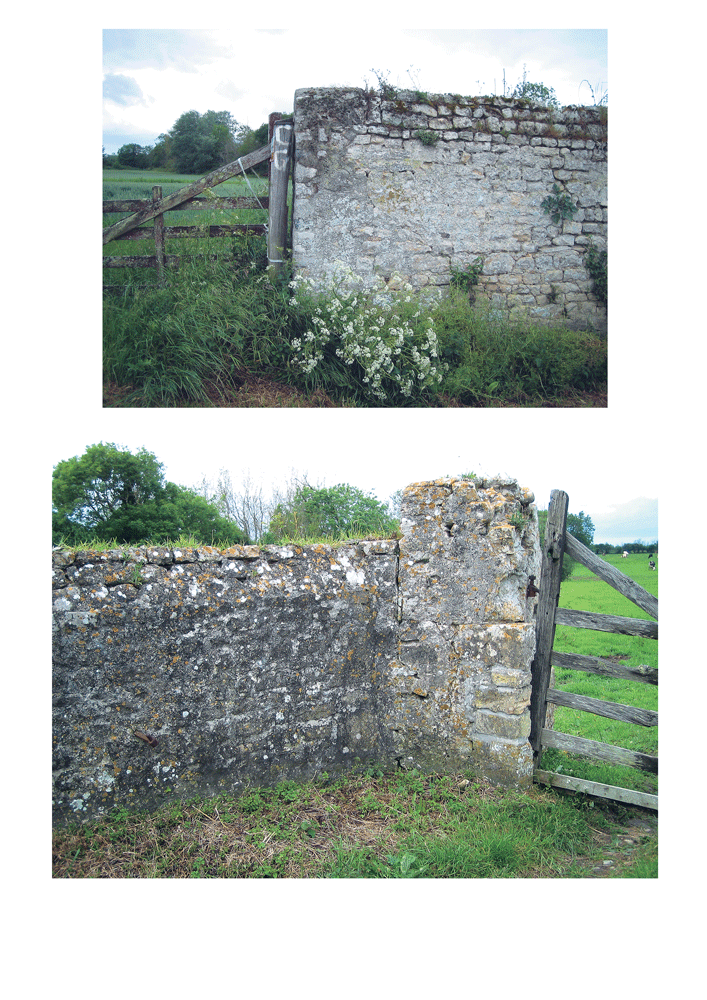

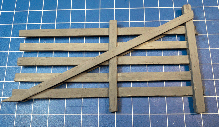

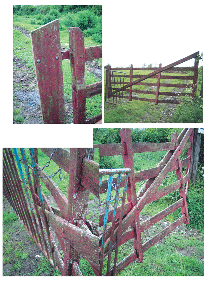

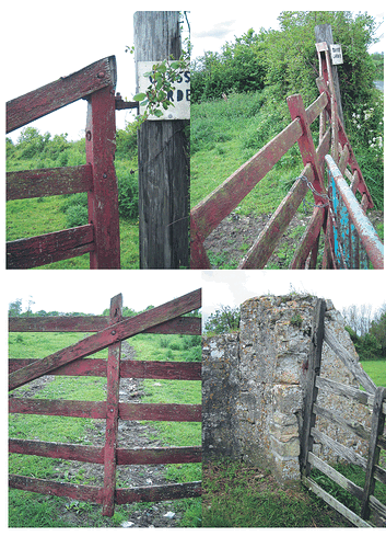

During my many stays in Normandy I was able to photograph a great number of things, of objects and take photos on the fighting sites on the landing beaches and inland Having the desire to make a typical barrier I was able to approach some still in place! Here is a series of photos of this wooden gate.. I made lots of detail photos to reproduce at most just my portal.However I must cheat for its length because otherwise on the diorama a part would have been in the void outside.

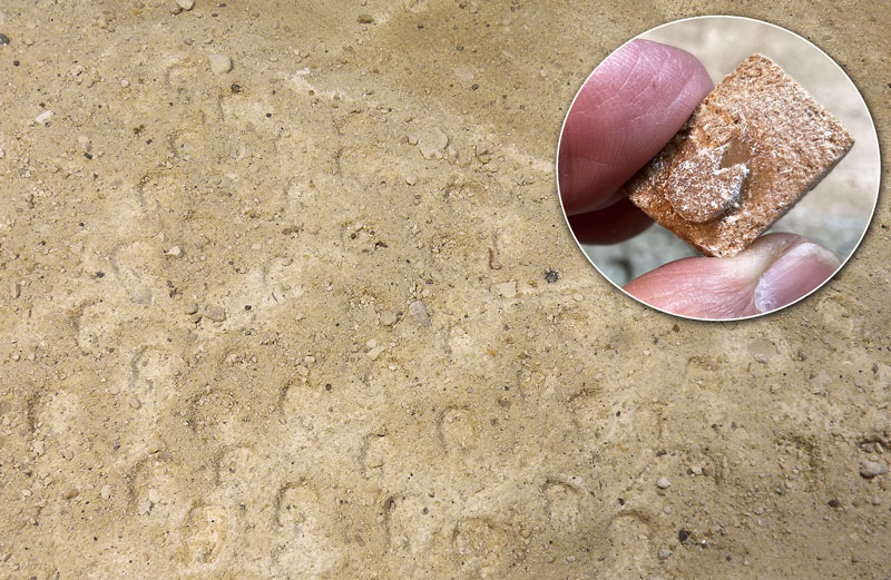

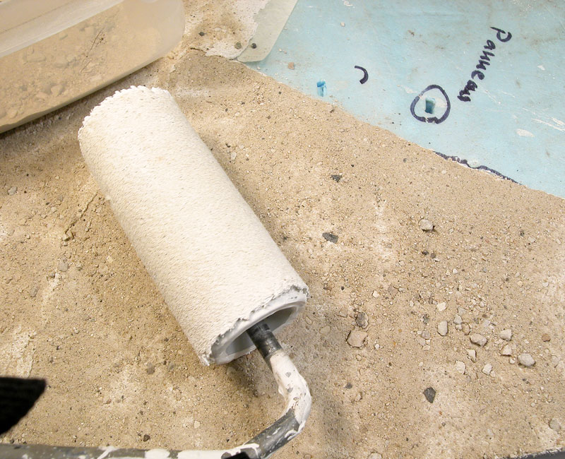

The diorama is therefore 60 cm long and 40 cm wide. Its base consists of a 40 mm thick Styrodur plate. The floor is shaped by portion with a mixture of tile-making glue and filler. So the plaster hardens less quickly… I soupoudre in this still fresh coating of the ground and small stones. The frequent passages of vehicles, drive the pebbles into a soft soil because very wet in Normandy I have restored all this by working in the fresh plaster with a paint roller. I repeated this operation until complete covering of the ground. Cows entering the meadow are marked by numerous hoof marks in the ground. I reproduced these impressions by creating a “stamp” in a square of wood balsa shaped hoof. before pressing it into the soil still wet. For the following some pebbles will appear here and there without exaggerat
ion.

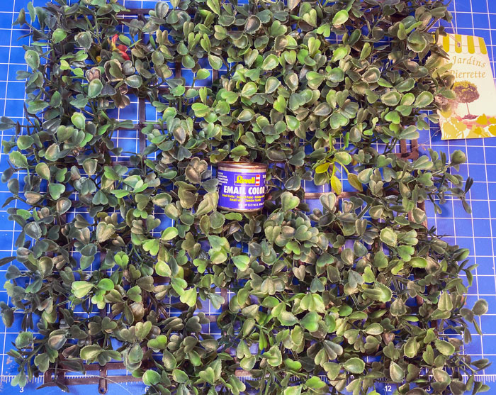

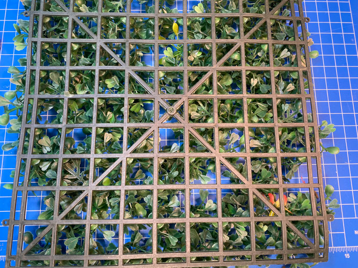

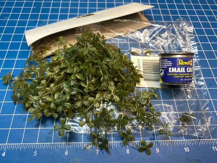

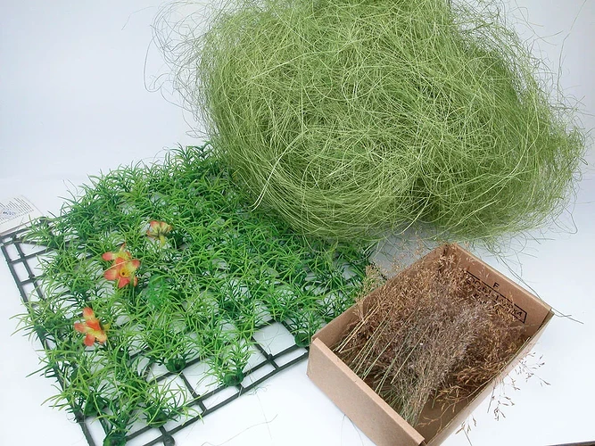

Unlike 1/35 vegetation does not exist at 1/16… Manufacturers will be interested in this very soon I am convinced. But for now, you have to look for and be imaginative. I don’t know if these types of stores exist in your country? There is a group of stores specialized in “culture” the brand name is Cultura… There is everything: paint, brushes, glue, felt-tip pens, books, music, scrapbooking material, fine art material and lots of small objects and curiously flowers and plastic plants

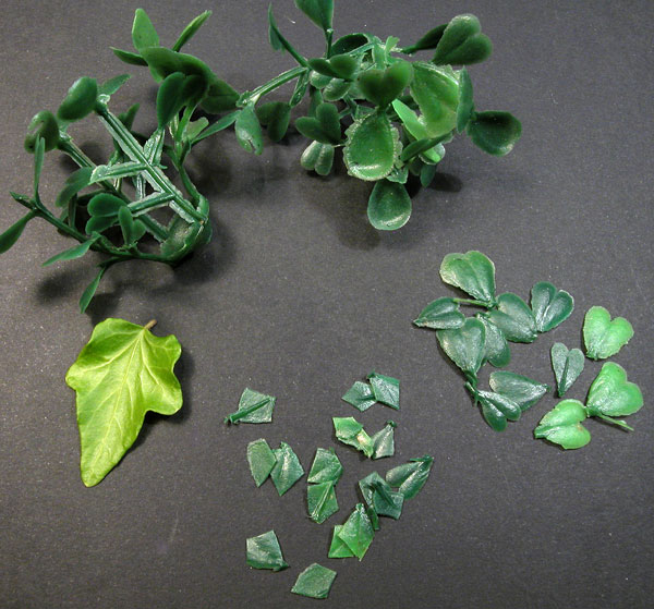

By prospecting in stores like this, I manage to find objects that I will divert for my dioramas. This is the case of these plastic flowers.There are different shapes and colors that often serve as decoration!

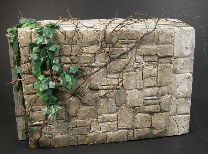

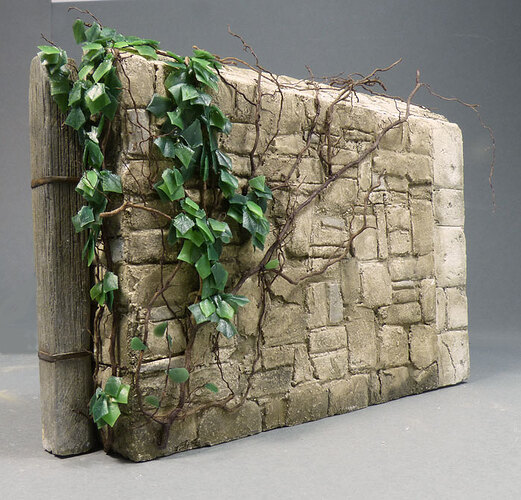

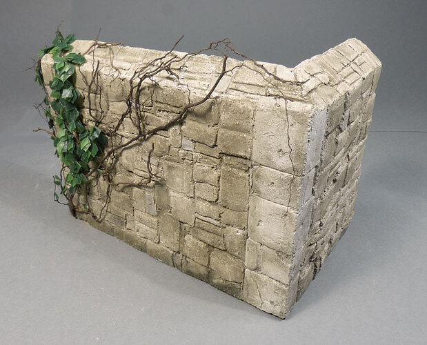

This is how I was able to create the creeping ivy on the wall. The dead branches are small roots glued to wood glue
The ingredients used to make the field on the side of the diorama. Small grass picked up in a forest during walks, plastic flowers, a log and tall.

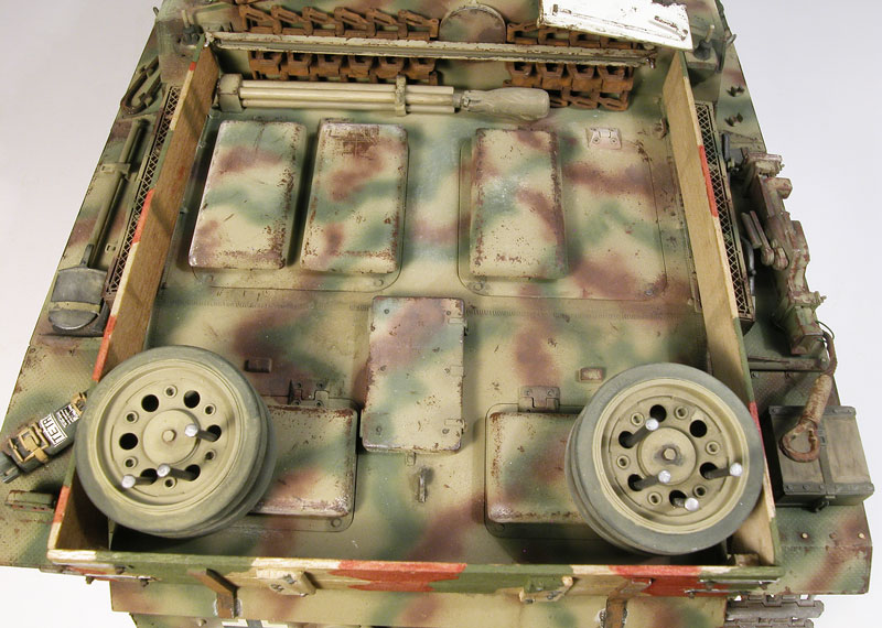

I will conclude this topic on my Stug III with this last photo and the spare rollers… The connecting axes must be considerably refined. I will soon post one of my dioramas on the Ausf Panther. Dragon happened a few years ago, when my eyes were still accepting the 1/35!
You did a fine job there. I like the cow imprints and the way you managed to make ivy of those horrible plastic “plants”!
Thank you for this comment
