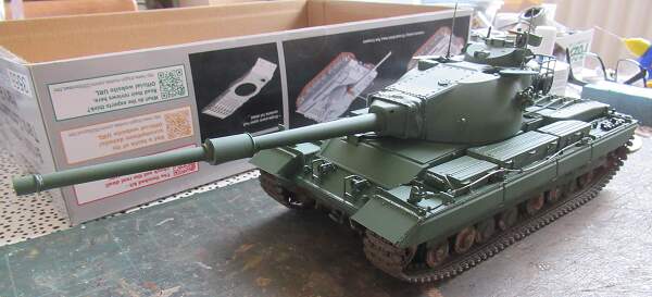

must be an early version, but then again the Bovy one is a mk 1 and it has that giant turret equipment cage on the Bustle of the turret.
the rear plate finally, correctly fitted out.
the side armour support arms (c40)are a very unhelpful butt join.
sand them to as flat a mating surface as I can and support them till they harden in place, they can’t sag when they take the weight of the side plates.
that does make more sense of my picture taken of one, peering between the roadwheel and a gap in the armour of the Bovy tank.

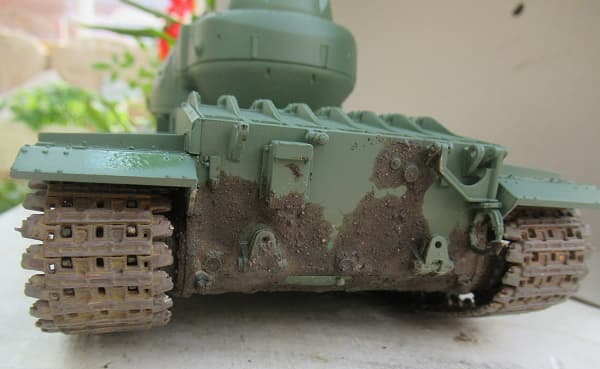

early applications of mud effects on the lower hull and running gear. I’m counting on this drying and cracking like the real thing on Soltau.
I want to represent those long Autumn ex where you could start in thawing mud and end in extreme dust that got in your hair, food, equipment. This is the in between period as the mud dries and cracks off.

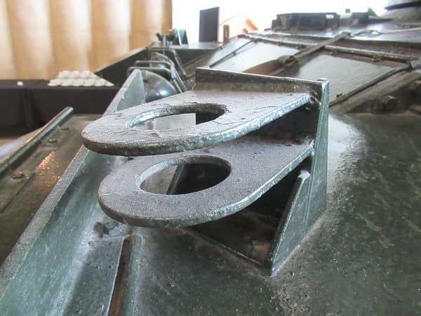

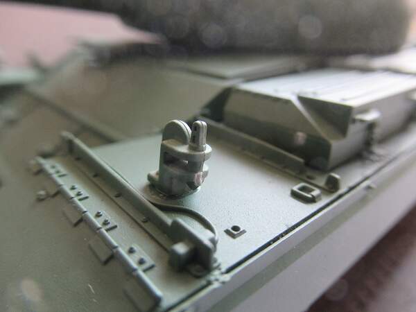

clamp of some sort on the front.
very different on the Mk1
the Mk1 has the same fitting but the securing pin is missing

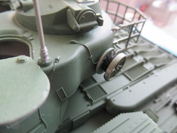

black thread standing in for comms line.
