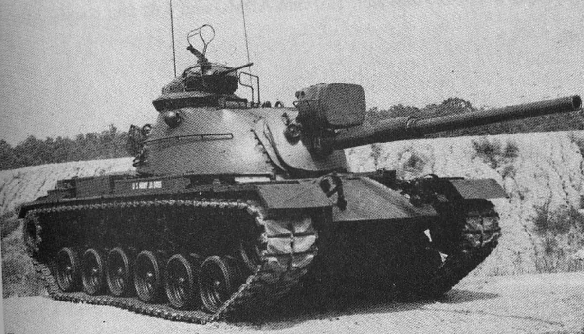

No, M48A5s had top-loading air filters. Some early ones did use the M1 cupola and chevron tracks though.
Most had the standard setup of urdan cupola, T142 tracks, smoke grenade launchers, etc. as in the Takom kit.
All 3 of the above have urdan cupolas, they do have T97E2 chevron tracks though.
Hard to find good pictures of the actual tanks on the net that don’t include “World of Tanks” imagery.
I`ve seen a picture of an M48A5 with early M1 cupola without the riser i believe. It also had chevron tracks and early air filter boxes. Anyhow the M1 cupola seems to be rare. Whereas the air filter boxes and tracks varied, What about replacement of the kit supplied gun barrel with an wm one. Which one to choose. I want one with the canvas included.

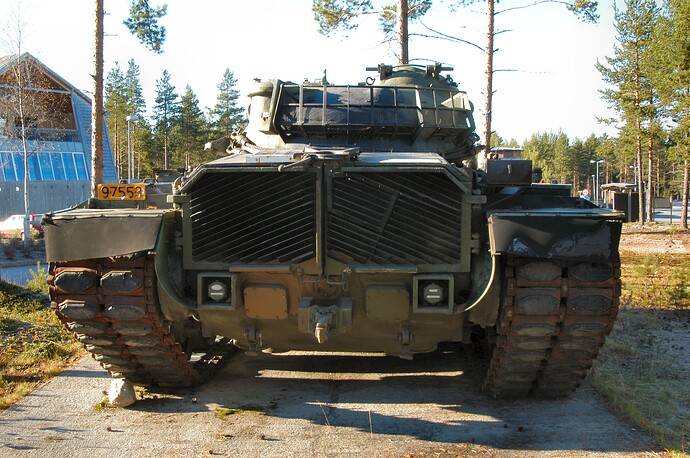

Lets start with the Norwegian

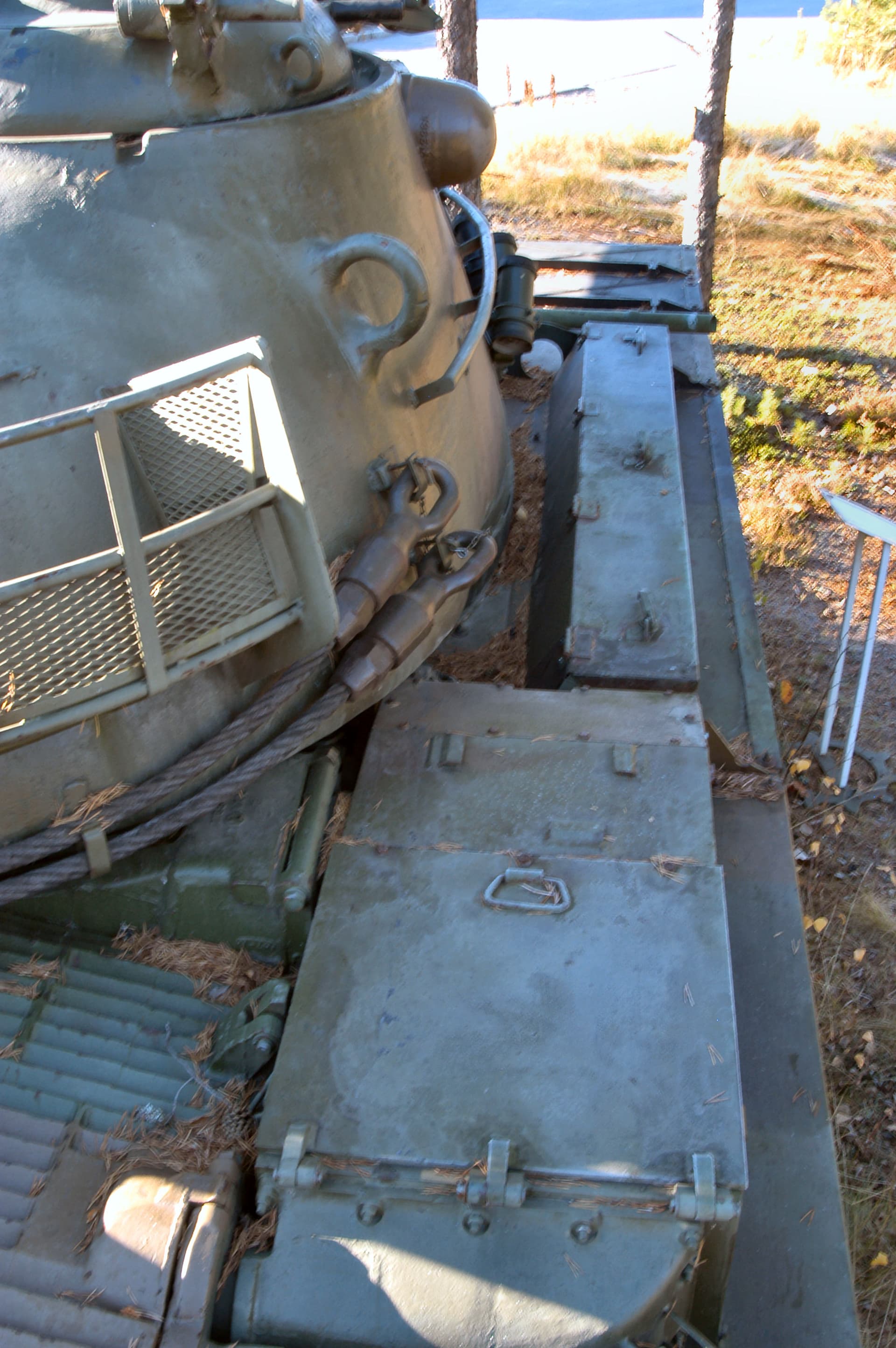

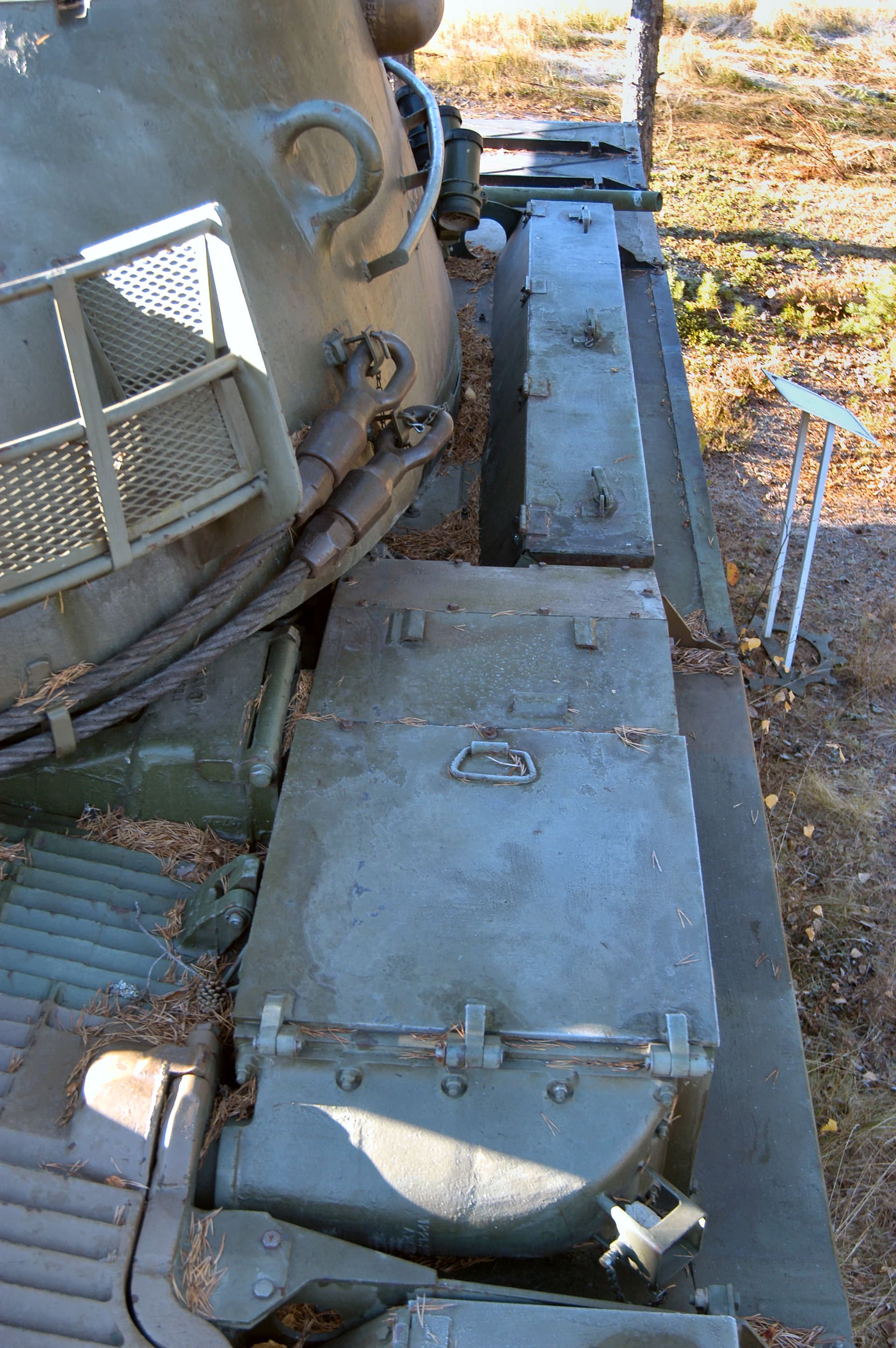

You get the M48A5 kit and build almost out of the box. You need to add the Wegman smoke launchers (they are included in the Revell M48A2GA2 kit or some after market company or source the launchers from a Leopard kit and scratchbuild the mount). You also need to add a holder for something that I have no knowledge of on the left side of the bustle rack.
In step 16 of the instructions do not use the .50 cal mount but the scissor mount for the M60 MG
And you also need the license plates.

Nice to see my old walkaround is still useful. I think the holder you are referring to is for a fire extinguisher (but not sure…)
It is a great walkaround, showing many details. I always look it up when building a M48.
Ah, that makes sense. I guess the missing fenders and other extra parts are from the CM-11 as well. Wishful thinking for a Magach 3 coming.
It looks like it could be a chemical decontamination sprayer.
