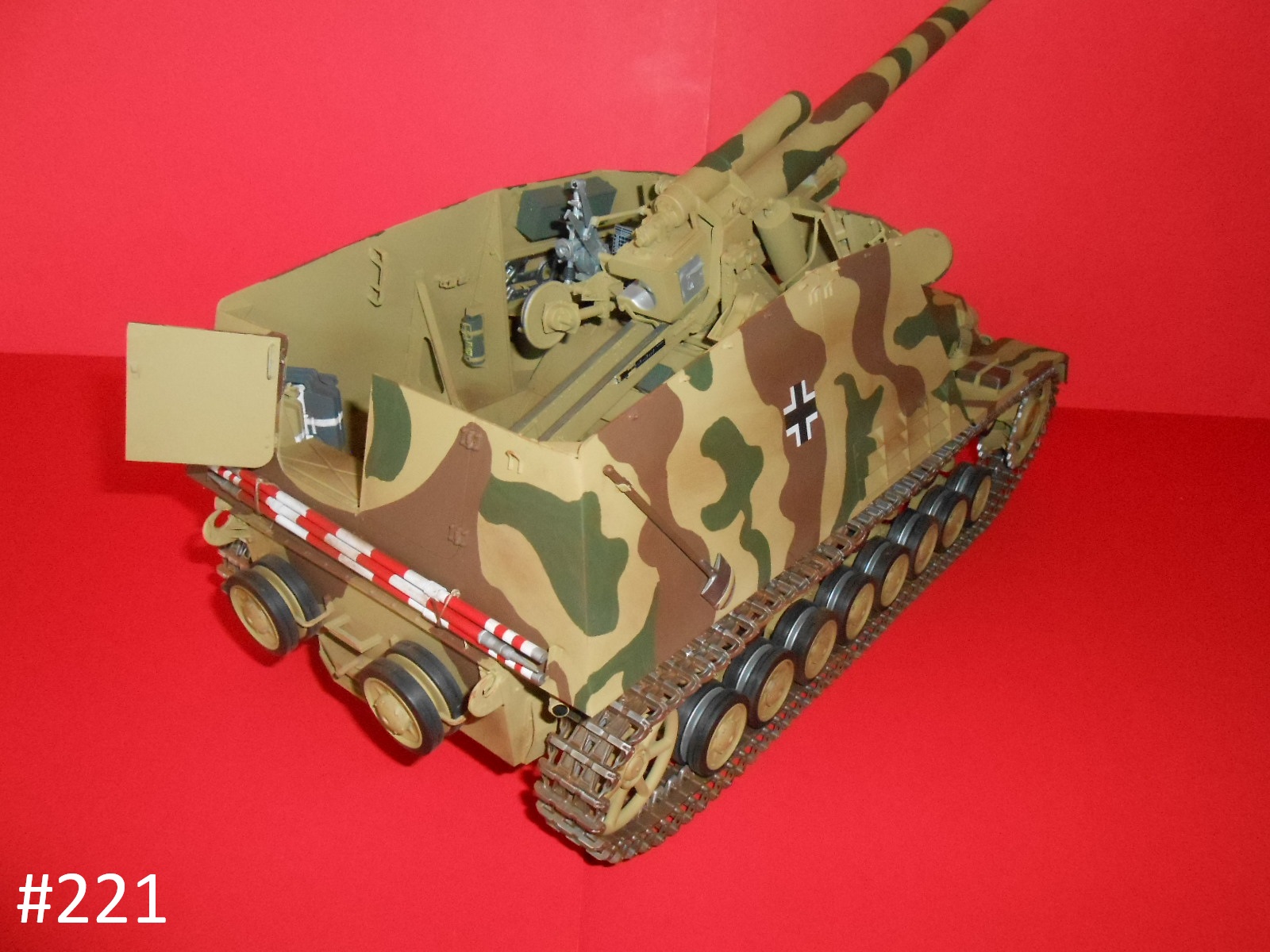

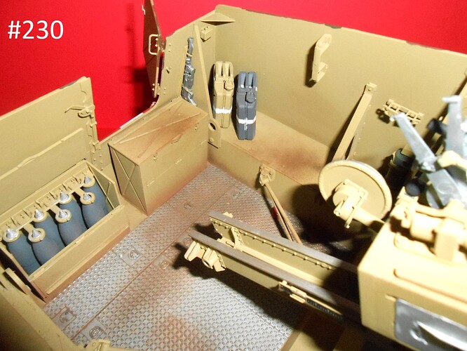

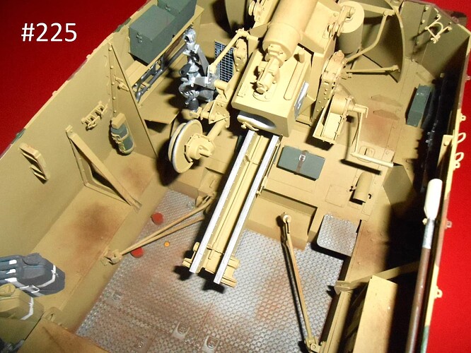

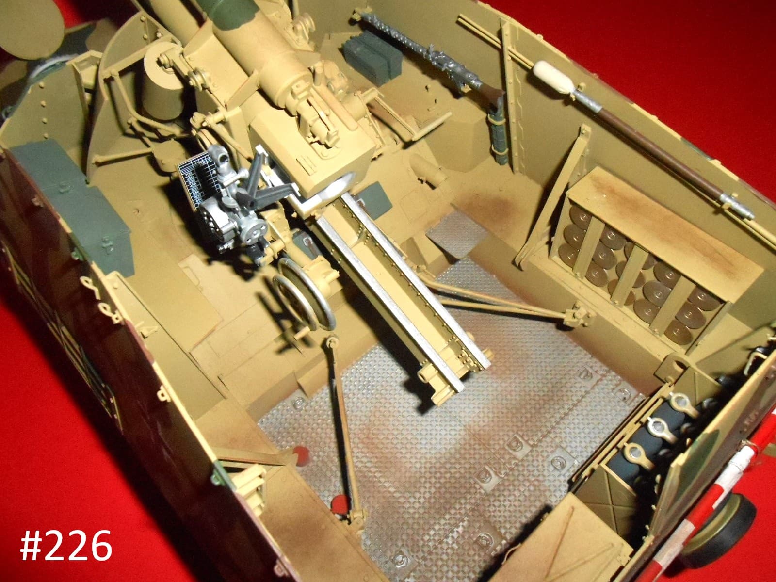

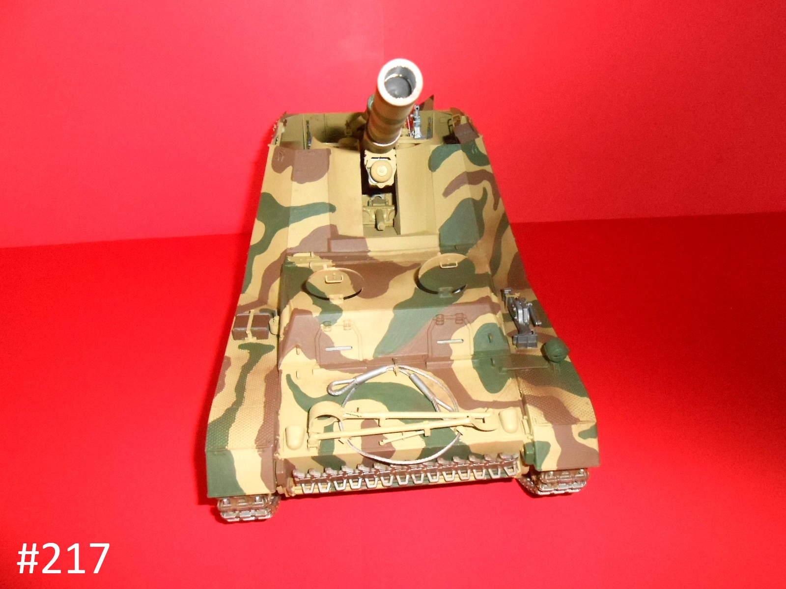

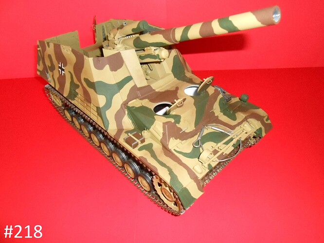

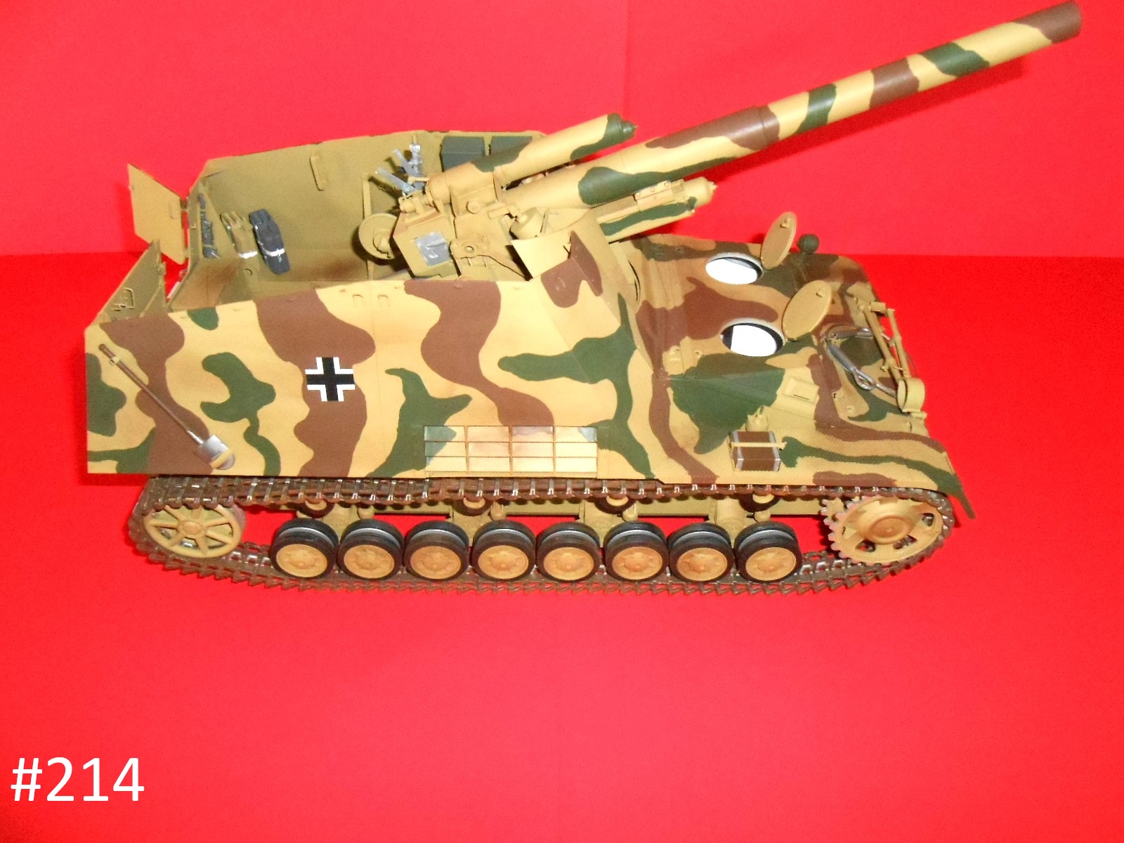

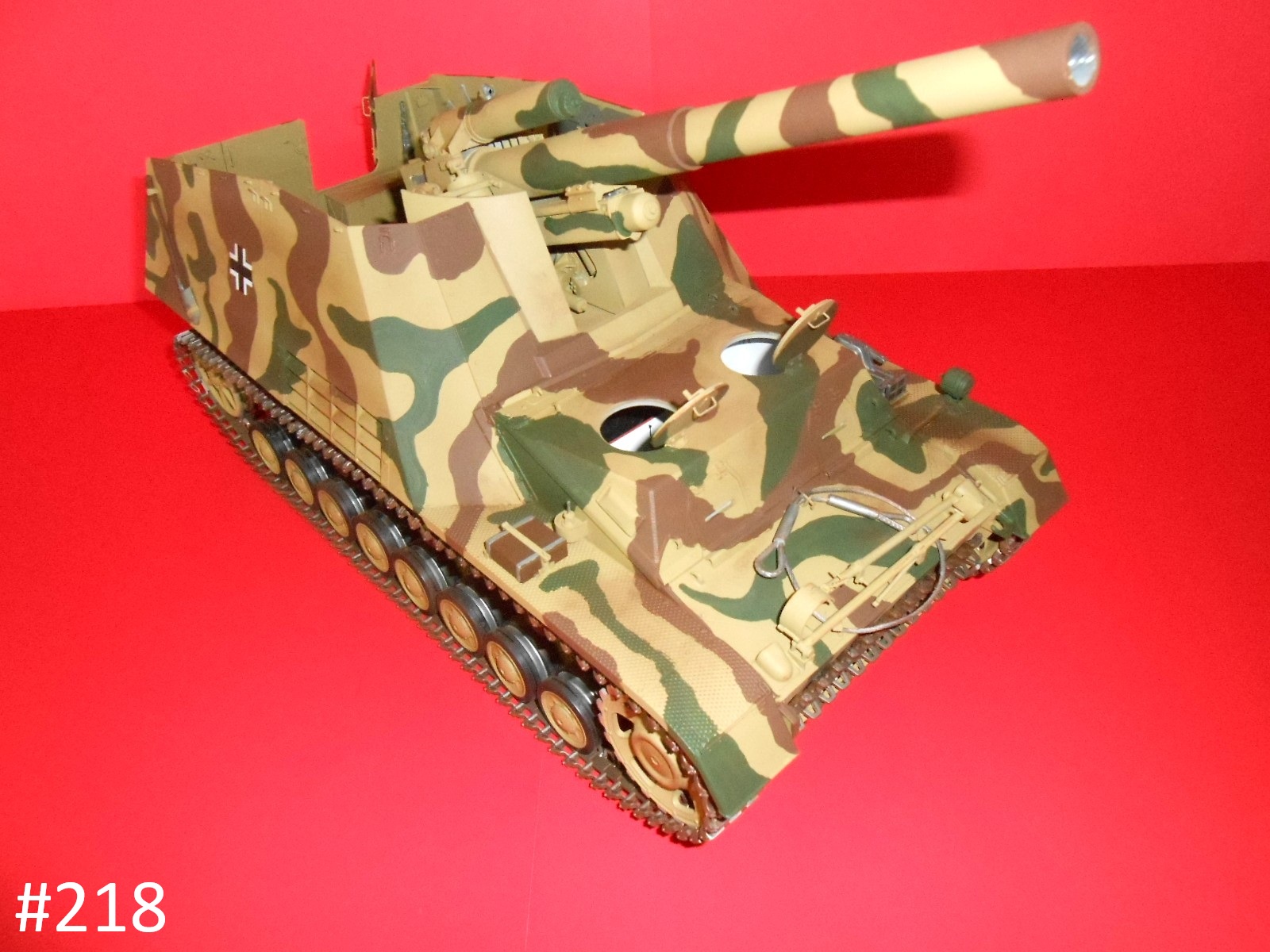

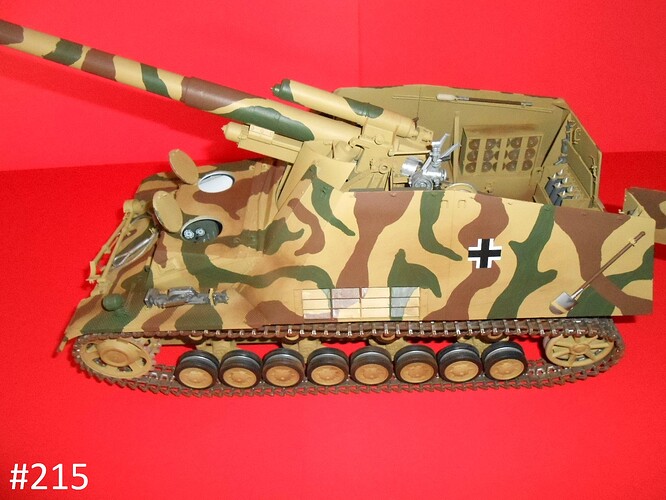

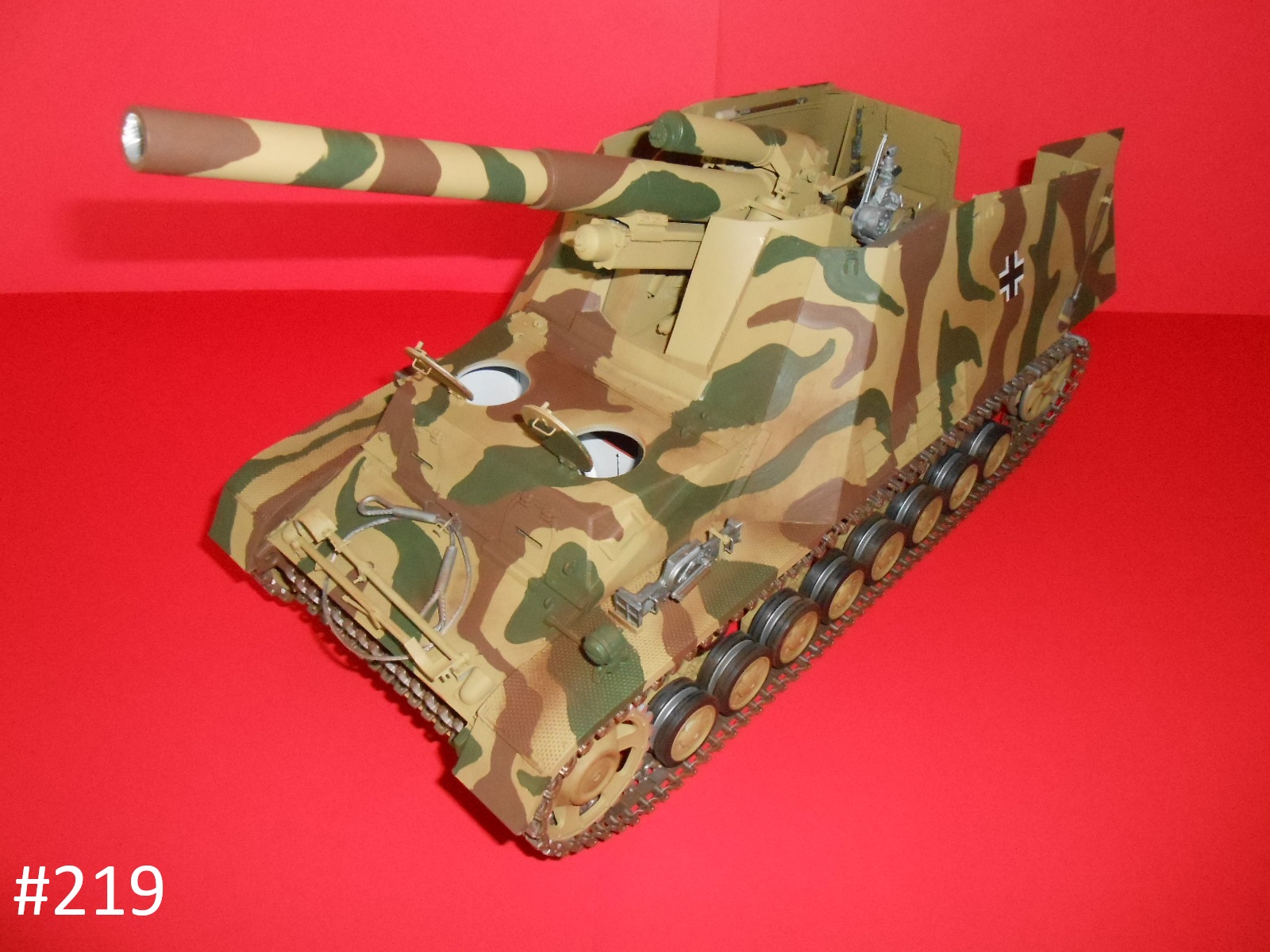

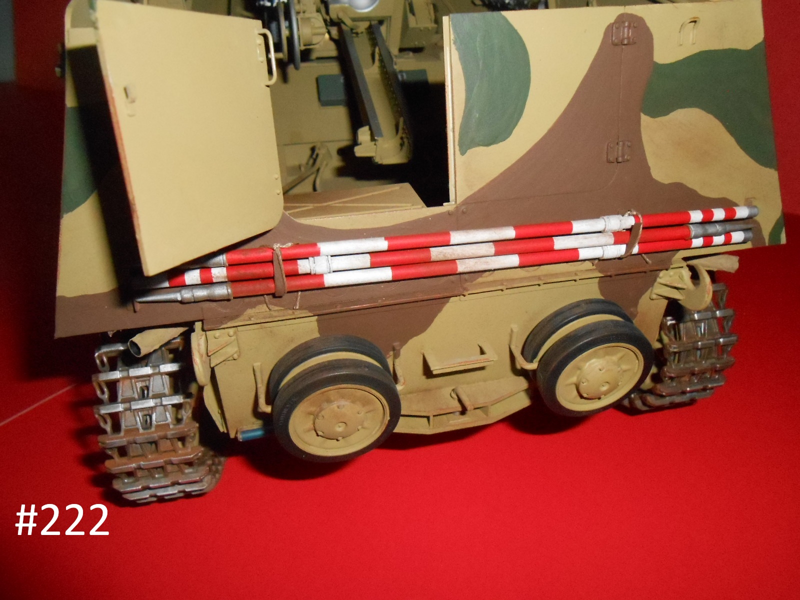

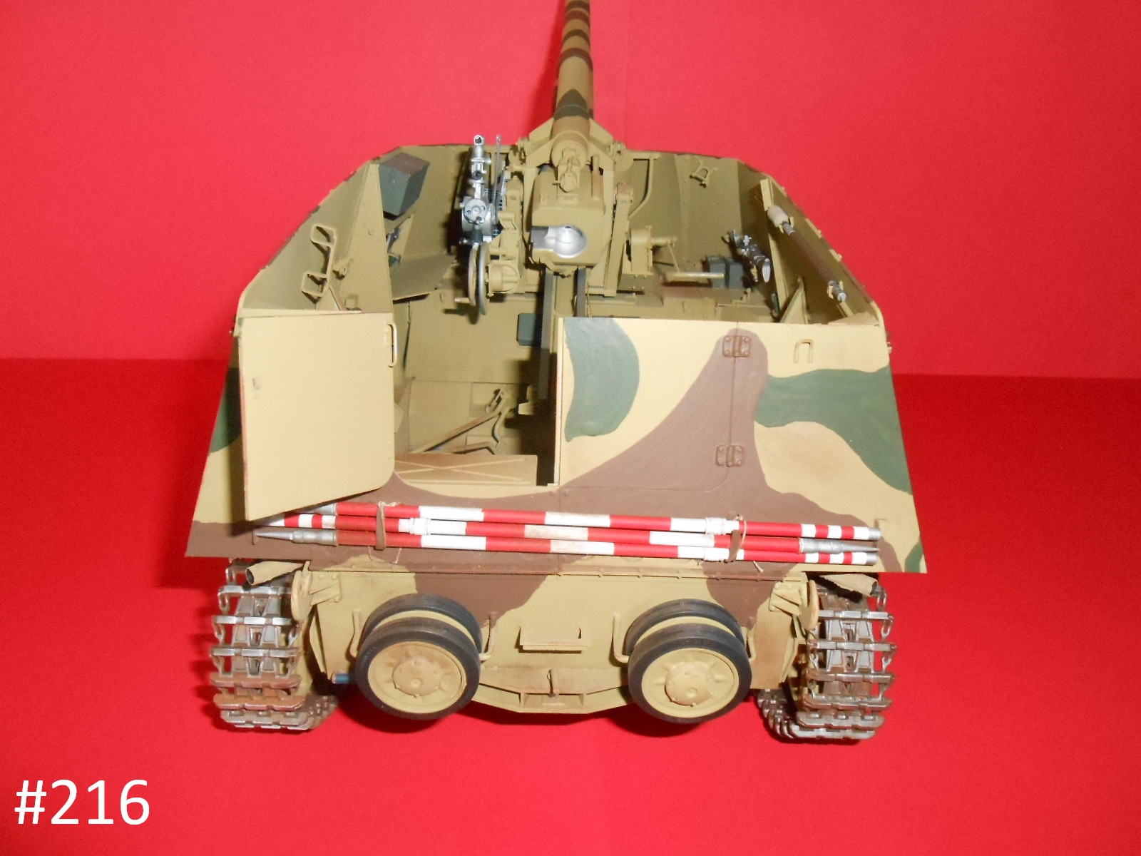

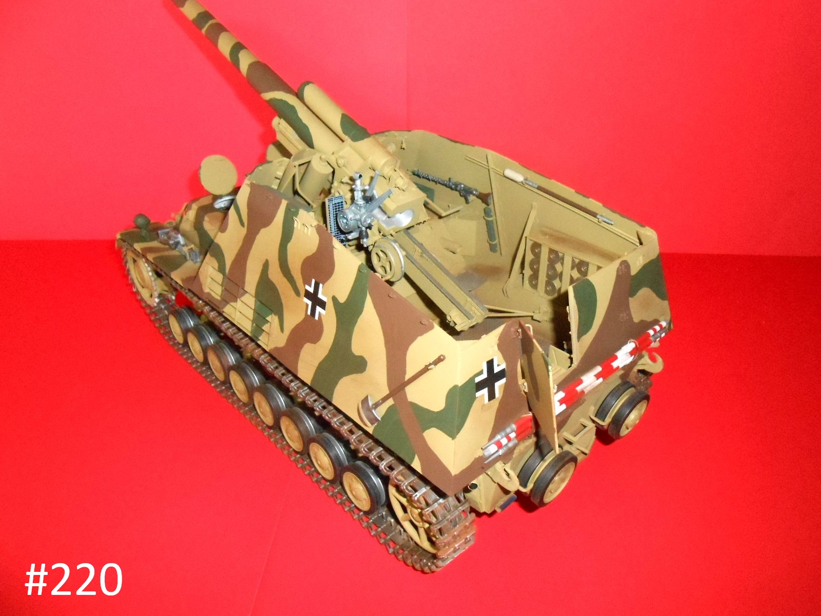

Well I finally finished it, I almost lost it when doing the Weathering.
I forgot about the snap together track, and it came apart in two places.
Luckily I caught it before it hit the Floor (CRUNCH)
The Track snapped back together, and here are the finished Pics.

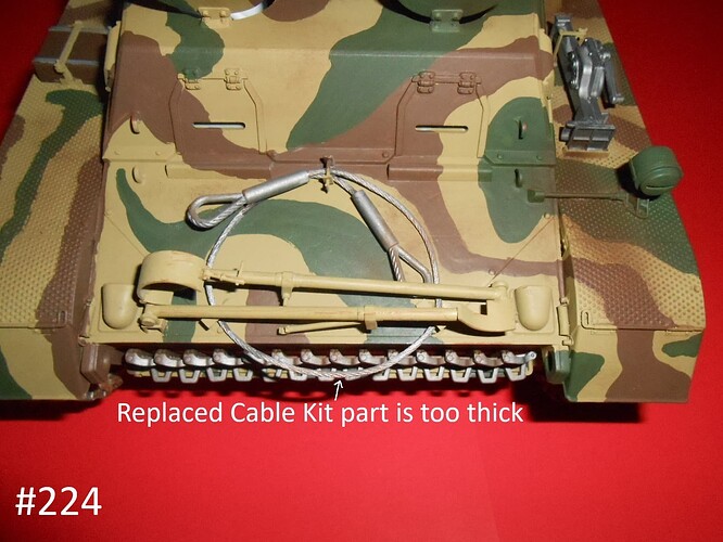

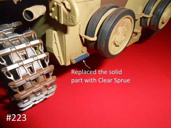

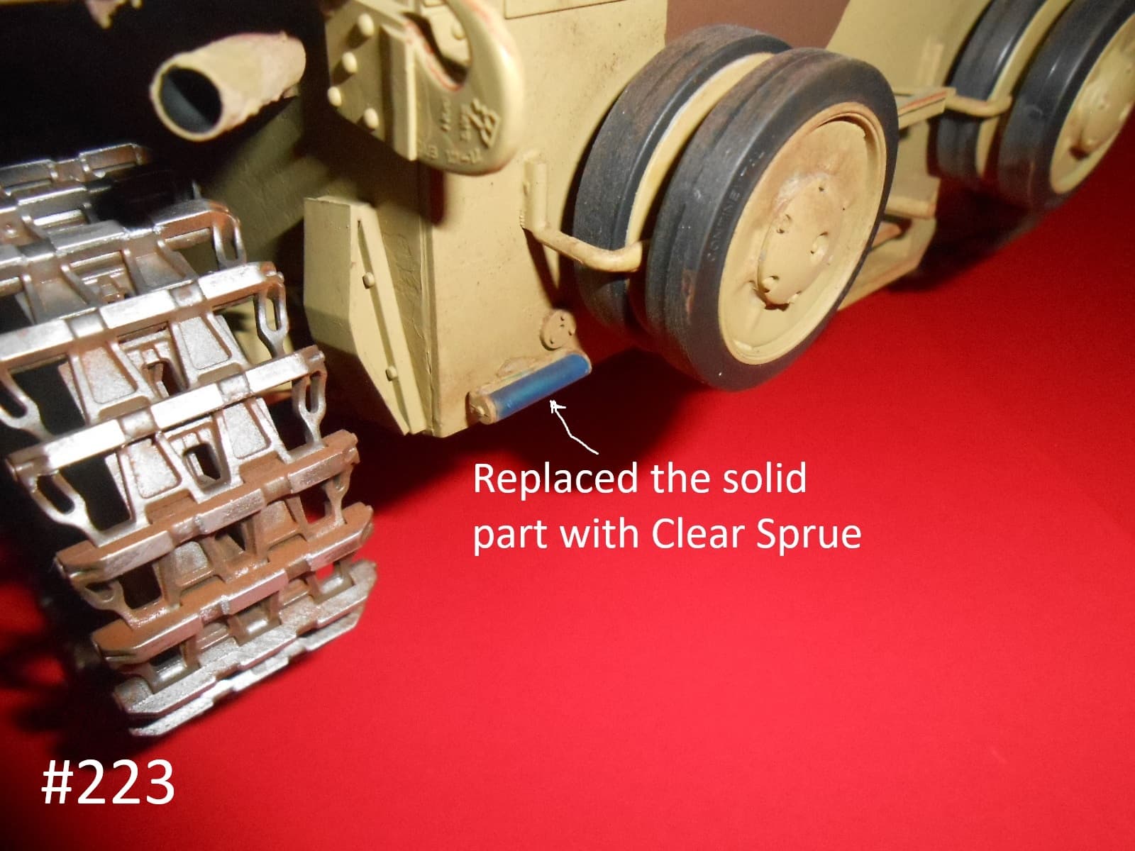

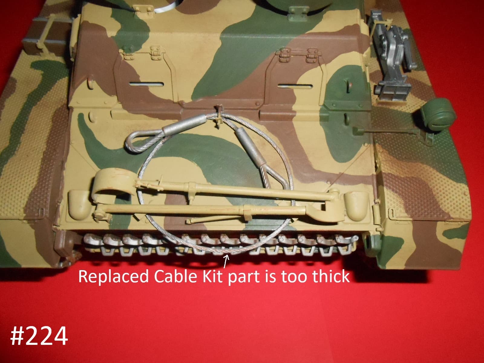

This was mostly strait out of the Box. The only things I added were the Water Cans inside, I replaced the Tow Cable, it looked too thick, and finally I used a piece of Clear Sprue to update the Tube Tail Light.
Regards
Donald

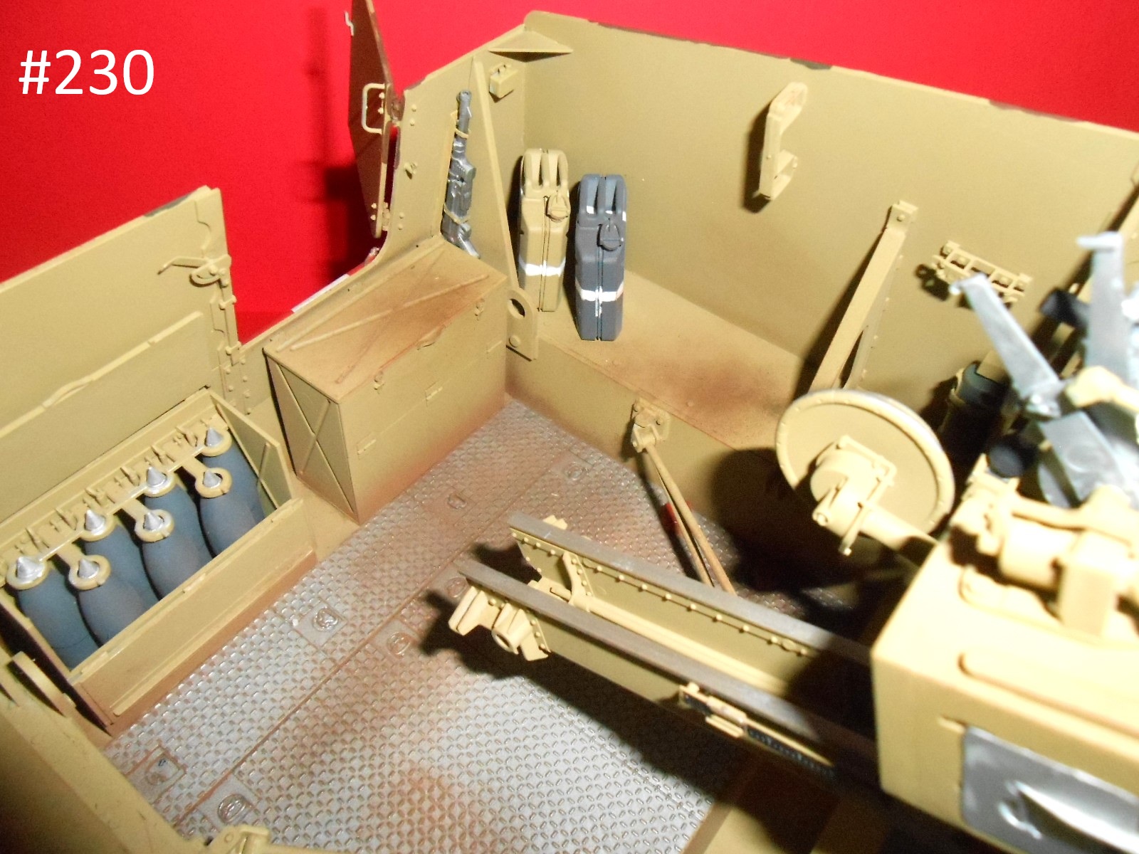

I have a few thoughts and comments about this Kit.
#1 For me the subject was un expected,
#2 I like open top Vehicles
#3 I had a lot of fit issues, Warping and such
#4 The Instructions are terrible, it is hard to tell exactly where and how the parts are positioned

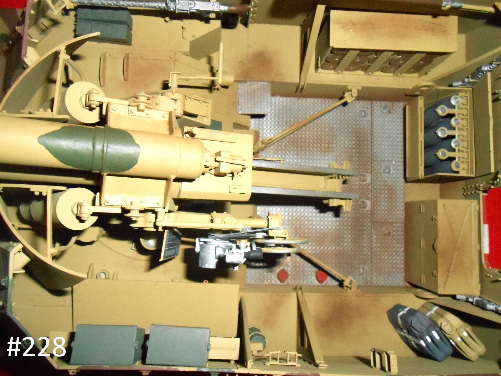

#5 I built the Engine just to show what you can see of it, as expected Nothing Visible of it
#6 The Drivers area, a waste of time and effort, not much visible through the Hatches
#7 The Tracks were a Bitch to clean up but went together rather easily

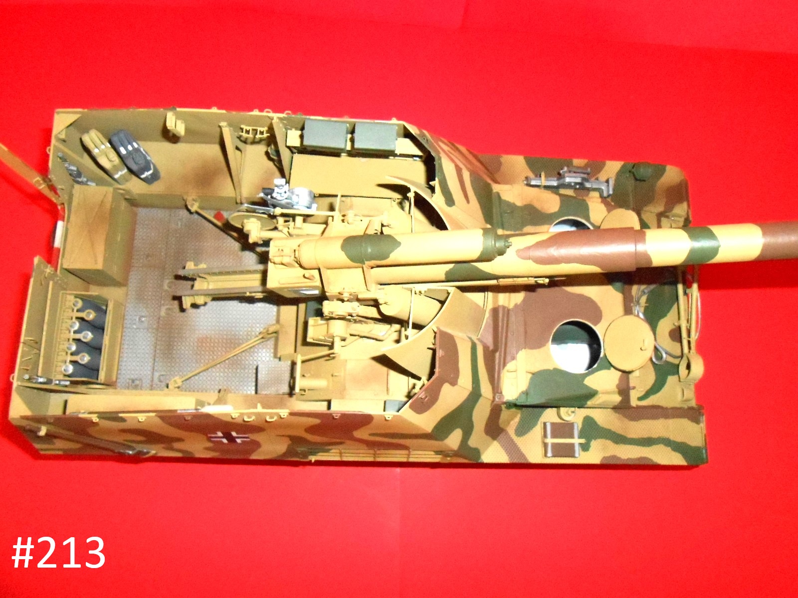

#8 The Kit was designed to be built in Travel Mode, but as I have shown can be converted to Firing
#9 There is a lot of wasted detail The Track tensioners, under the Deck & Ammo Storage Boxes
#10 This kit could have used More stowage, Ammo Containers, Tarps, and other addons
#11 At least there was no useless figures for me like in the Takom Kits, I’m no good with figures they always look like mannequins
#12 I’ll be doing the Nashorn if it ever gets out, I have the Winter track for it allready.
#13 I think that if you look through my build up above , that I have shown really all that you need to know about this kit.
#14 Hey I tried?
Regards
Donald
Hi, I am building this at present and agree about the interior, I didn’t bother. I will build the transmission and engine as a separate display piece. Aluminium barrels have their place but in this scale a plastic item would have been preferable just too heavy. In summary I would give this 7 out of ten and when compared to Takom 1/16 kits they win hands down.

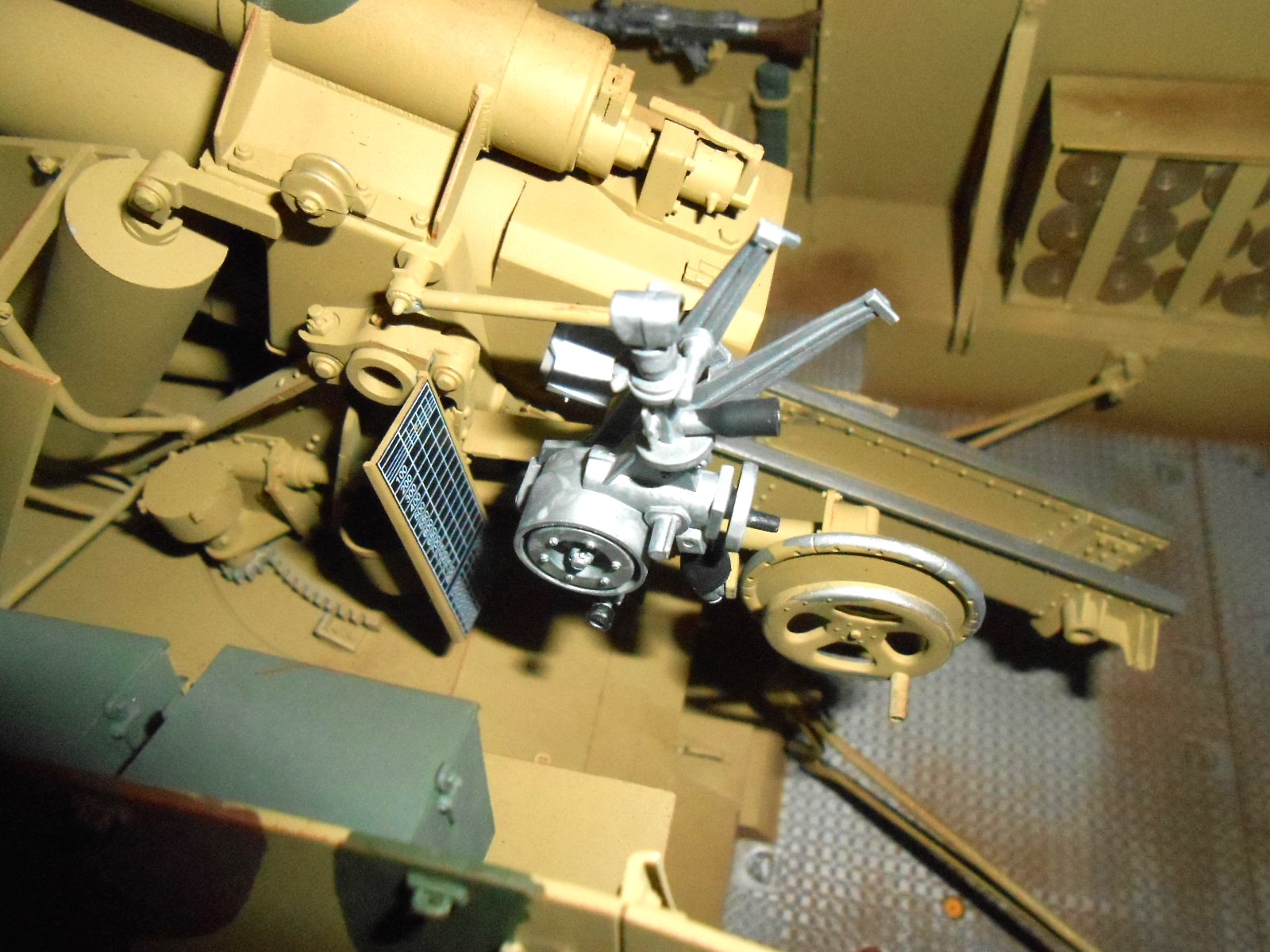

Thanks for taking the time to document you build. I really liked it. How hard was it to modify the barrel /carriage to make it into a firing position?
I built a 1/12 Das Werk’s Stug 3.
While I like the large scale models, because you can really detail it out. I only have a limited space (My wife gave me) to display them. I might have to blow up my large T34 to make room!
The only modifying I did is shown on Pic.204 &205 The gun fit right in. Just the sight needs adjusting for the firing position. All the Info. should be in that area of the Pic. story, not really hard to do.
